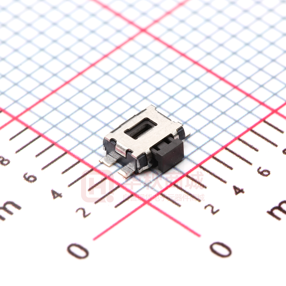

TACT SwitchTM
1.25mm Height Low-profile SidepushTM (Surface Mount Type)
SKSC Series
Combination of excellent solder strength & size merit (3.5G3.55mm with hight of 1.25mm).

Horizontal type Product No. SKSCLCE010 SKSCLAE010 SKSCLDE010 SKSCLBE010 Operating Operating Travel Rating Rating Operating life Initial contact force direction (mm) (max.) (min.)(5mA 5V DC) resistance
1.6N 2.2N Horizontal 1.6N 2.2N 0.2 50mA 12V DC 10BA 1V DC 100,000cycles 100mΩ max.

With Ground Terminal type Product No. SKSCPCE010 SKSCPAE010 SKSCPDE010 SKSCPBE010 Operating Operating Travel Rating Rating Operating life Initial contact force direction (mm) (max.) (min.)(5mA 5V DC) resistance
