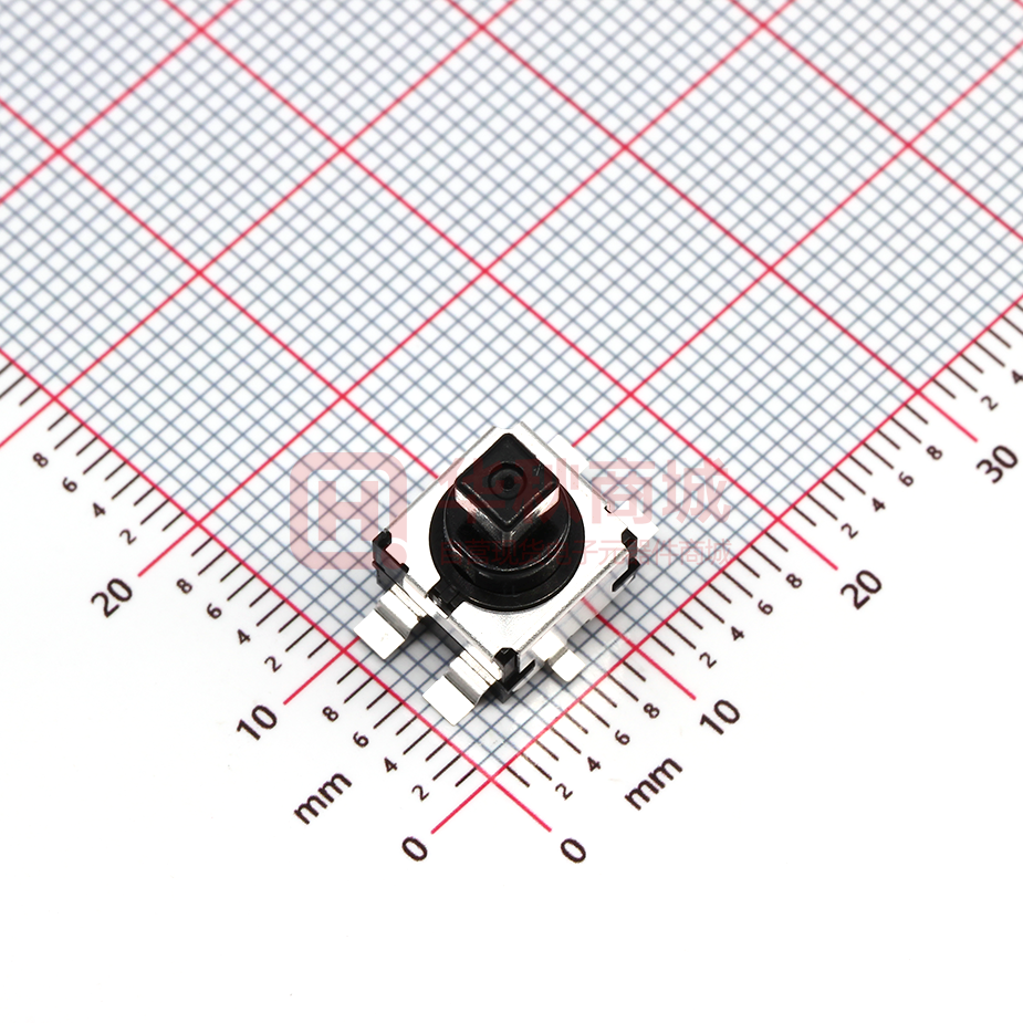

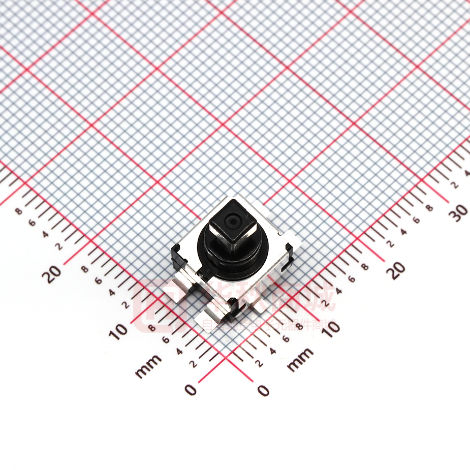

    按动开关 3万次 SMT 单刀双掷 1A 3N 14.5V -40℃~+85℃
SPEF210101 数据手册
Push Switch Surface Mount Type Push Switch SPEF Series Surface mountable lead-free soldering push switch. Typical Specifications Items Rating (max) (Resistive load) Initial contact resistance Operating force Operating life Without load) ( Poles-Positions Specifications Push 1A 14.5V DC Detector Slide 100mΩ max. 3N,5N 30,000cycles 1-pole,2-positions Rotary Encoders Power Dual-in-line Package Type Product Line Changeover timing Travel Total travel Operating (mm) (mm) force 3N Non shorting 1.5 2.7 5N PC board Latching TACT SwitchTM Mounting method Operating Terminal type Reflow Dip Reflow Dip Minimum order unit (pcs.) 1,320 2,100 1,320 2,100 Drawing Product No. No. SPEF210101 SPEF110100 SPEF210200 SPEF110200 1 2 1 2 CustomProducts Taping Specifications (Taping Packaging) Reel Size Unit:mm Number of packages pcs.) ( 1 reel 1 case /Japan 1 case /export packing Tape width (mm) Horizontal Type Vertical Type 165 ø380 33.5 660 1,320 32 Note Please place purchase orders per minimum order unit (integer). 105 Push Switch Surface MountType Push Switch SPEF Series Dimensions No. Reflow Soldering Type Detector Push Slide Rotary 2.1 4.6 Terminal No. C 2 1.2 Terminal No.1 Terminal No.2 2.1 Unit:mm Style PC board mounting hole dimensions 14.3 9.5 6 3.7 0.3 11.3 9 3.5 2.5 2.5 2.5 A Power Dual-in-line Package Type TACT SwitchTM 1 13.6 9.4 3.5 2.5 Full stroke position Lock position 1.8 11.86 13.1 14.6 6.9 Terminal No.1 Terminal No.2 Encoders 1.2 CustomProducts ¿1.4 6 Dip Soldering Type Horizontal Type Vertical Type Terminal No. C 1.3 ¿0.9 6.7 12.2 9.8 A 9.4 3.5 2.5 9 3.5 2.5 2.5 2.5 6 4-¿ 2-¿ hol 1.3 (h e) o 1.5 le) (h ole ) ¿1 .6 ( Full stroke position Lock position 2 5.7 6.7 7.4 8.85 12 ¿1 ¿1 .1 ( 6.7 ( .1 ( 6 ¿1. ho le) hol e) 11.86 13.1 14.6 6.9 ho le) 3.2 3.5 1 5.7 6.7 1 1.2 ø1.4 6 9.8 12.2 ø0.9 PC board mounting face ( Circuit Diagram Viewed from Direction A) 1 C 2 106 1.3 Push Switches List of Varieties Series SPPH4 SPPH1 SPEC SPED2 SPED3 SPED4 SPED5 SPEF Photo Detector Push Travel mm) ( Total travel (mm) Number of poles W Dimensions (mm) D H Operating temperature range Rating max.) Resistive load) (( Rating min.) Resistive load) (( Initial contact resistance Insulation resistance Voltage proof Terminal strength Operating direction Pulling direction Electrical performance Mechanical performance Durability Environmental performance Soldering 2.2 3 1.5 2.5 2 2.5 3.4 4.5 ― 3.8 1 1.5 2.7 Slide Rotary Encoders 8.5 6.5 8.5 −10˚C to +60˚C 10 10 12 16.8 12.5 26.7 14 18 20.7 −40˚C to +85˚C 13.5 18.2 9.4 9 6.9 Power Dual-in-line Package Type TACT SwitchTM CustomProducts 0.1A 30V DC 1A 14.5V DC 50BA 3V DC 100mΩ max. 20mΩ max. 30mΩ max. 100mΩ max. 3MΩ min. 500V DC 100V AC for 1minute 3M Ω min. 100V DC 100MΩ min. 500V DC 500V AC for 1minute 5N for 1minute 30N 3N for 1minute Horizontal Type 50N 90N Vertical Type Actuator strength 10N ― 50N 30N Operating life without load Operating life without load Load:as rating Cold Dry heat Damp heat Manual soldering Dip soldering Reflow soldering Page 10,000cycles 100mΩ max. 10,000cycles 40mΩ max. 10,000cycles 50mΩ max. 30,000cycles 100mΩ max. –20±2℃ for 96h 85±2℃ for 96h –40±2℃ for 96h 40±2℃, 90 to 95%RH for 96h 350±10℃ 3+1s 0 260±5℃ 5±1s 260±5℃ 10±1s 350±10℃ 3±0.5s ※3 260℃ max. 260±5℃ 10±1s ※3 5s max. ― ― 350±10℃ 3±0.5s 260±5℃ 10±1s ― ― 350±5℃ 3s max. 260±5℃10±1s ※4 Please see P.108 98 99 101 102 103 105 ● Push Switches Attached Parts ………………………………………………………………………………………………107 ● Push Switches Products Caution ……………………………………………………………………………………………109 Notes 1. ※3. Applicable to SPED220200 PC board type) ( only. 2. ※4. Applicable to SPEF110100 only. 83 Push Switches Soldering Conditions Example of Reflow Soldering Condition 1. Heating method: Double heating method with infrared heater. 2. Temperature measurement: Thermocouple 0.1 to 0.2φ CA (K) or CC (T) at soldering portion (copper foil surface). A heat resisting tape Detector Push Slide Rotary Encoders Power Dual-in-line Package Type TACT SwitchTM CustomProducts Series Reflow type) ( SPEE 260 230 40 180 150 120 should be used for fixed measurement. 3. Temperature profile 300 Temperature (˚C ) A max. B 200 D E 100 Time (s) Pre-heating F max. C Room temperature A (℃) 3s max. B (℃) C s) ( D (℃) E (℃) F s) ( SPEF, SPEG Notes Horizontal Type Vertical Type 1. The condition mentioned above is the temperature on the mounting surface of a PC board. There are cases where the PC board's temperature greatly differs from that of the switch, depending on the PC board's material, size, thickness, etc. The above-stated conditions shall also apply to switch surface temperatures. 2. Soldering conditions differ depending on reflow soldering machines. Prior verification of soldering condition is highly recommended. 108
