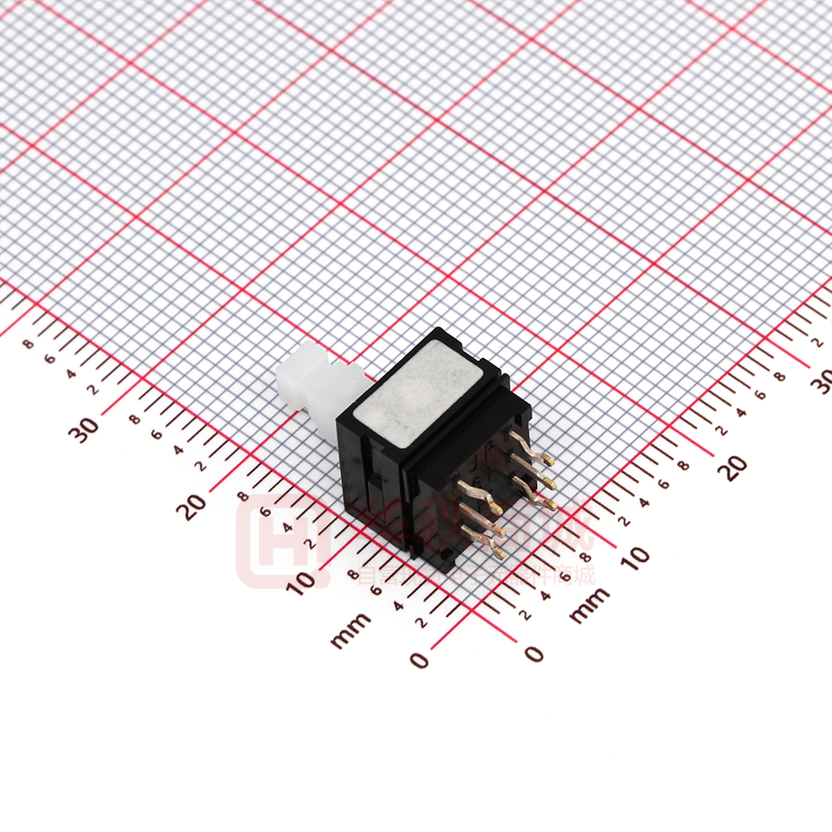

    按动开关 1万次 直插 100mA 3N 30V -10℃~+60℃
SPPH130500 数据手册
SPPH1 1.5mm-travel Vertical Type Vertical push switch with two types of knob available Detector ■ Typical Specifications Items Specifications Slide Rating(max.)( / min.) (Resistive load) 0.1A 30V DC / 50μA 3V DC Contact resistance (Initial/After operating life) 20mΩ max. / 40mΩ max. Operating force Refer to the products line Push Without load 10,000 cycles Operating life With load 10,000 cycles(0.1A 30V DC) Rotary Product Line Changeover timing Travel Total travel Mounting (mm) (mm) method Poles knob style Operating force Operation Terminal type Minimum order unit(pcs.) Japan Export Product No. Power Latching SPPH110800 Momentary SPPH110300 Drawing No. 1 Standard Dual-in-line Package Type Straight Latching SPPH120400 Momentary SPPH120100 Latching SPPH130400 Short 2 1 2+ − 0.7 N Non shorting 1.5 PC board 2.5 1 Standard 800 Momentary 2 4,000 SPPH130100 Snap-in Horizontal Type Latching SPPH140300 Momentary SPPH140100 Short 2 Straight Standard Vertical Type 1 3+ N − 0.7 SPPH110900 1 Latching Short SPPH130500 Snap-in SPPH140400 2 Packing Specifications Bulk Number of packages(pcs.) 1 case / Japan 1 case / export packing Export package measurements (mm) 800 4,000 400×270×290 Refer to P.130 for soldering conditions. 122 SPPH1/1.5mm-travel Vertical Type Unit:mm No. PC board mounting hole dimensions (Viewed from the direction A) Style A 10 4 10 7 Travel Total travel (5) 5 ø0.9 hole 2.5 ø0.9 hole 8.5 2.5 2.5 2.5 Thickness of PC board t=1.6mm 0.6 3.5 0.35 Terminal No.4 2.5 5 2.5 Power Straight terminal Snap-in terminal Total travel (5) 4.1 0.4 2.5 2 1.5 (0.2) 2.2 13.5 2.5 ø0.9 hole 0.6 2.5 Thickness of PC board t=1.6mm 2.5 Terminal Configuration Straight terminal Unit:mm Vertical Type Snap-in terminal R1 1.9 (3.5) 0.8 1 2 3 3.9 0.35 5 5 2.8 Circuit Diagram(Viewed from Direction A) 4 5 6 2.5 (3.5) 2.5 5 2.5 Horizontal Type 0.35 ø0.9 hole Terminal No.4 3.5 8.5 5 2 Travel 10 7 4 5 10 Dual-in-line Package Type A (1.5) Rotary 17.5 9 1.5 .5 4.1 2.5 R0 5 11 2 1 2- (0.2) (1.8) .5 3.3 Push 2.5 2.5 3.3 R0 Snap-in terminal Slide Straight terminal 2- Detector Dimensions 0.35 123 SPEH SPEJ SPPH4 SPPH1 W 6 7 6.5 10 D 6 7 8.5 10 H 5 5.95 Travel(mm) — — 2.2 1.5 Total travel(mm) 1.6 1.7 3 2.5 Number of poles 1 Operating temperature range −40℃ to +90℃ −40℃ to +85℃ Automotive use ● ● Rating(max.) (Resistive load) 50mA 16V DC 0.2A 14V DC 0.1A 30V DC Rating(min.) (Resistive load) 10μA 1V DC — 50μA 3V DC Operating life without load 100,000cycles 400mΩ max. 10,000cycles 150mΩ max. 10,000cycles 100mΩ max. 10,000cycles 40mΩ max. Operating life with load (at max. rated load) 100,000cycles 400mΩ max. 10,000cycles 150mΩ max. 10,000cycles 100mΩ max. 10,000cycles 40mΩ max. Initial contact resistance 200mΩ max. 150mΩ max. 100mΩ max. 20mΩ max. Insulation resistance 100MΩ min. 100V DC 100MΩ min. 500V DC Voltage proof 250V AC for 1minute 500V AC for 1minute Terminal strength — — 50N 49N 30N 50N — — 10N — Cold –40℃ 1000h –40℃ 500h –20℃ 96h Dry heat 90℃ 1000h 85℃ 500h 85℃ 96h Damp heat 60℃,  90 to 95%RH  1000h 60℃,  90 to 95%RH  500h 40℃, 90 to 95%RH  96h 119 120 Detector Vertical Series Photo Push 8.5 −10℃ to +60℃ — ● Vertical Type Page Horizontal Type Environmental performance Dual-in-line Package Type Mechanical Operating performance Actuator direction strength Pulling direction Power Electrical performance Rotary 2 Life cycle Durability Slide Dimensions (mm) 5N for 1minute 121 122 Push Switches Soldering Conditions・・・・・・・・・・・・・・・・・・・・・・・・・・・・・・・・・・・・・・・・・・・・・・・・ 130 Push Switches Cautions・・・・・・・・・・・・・・・・・・・・・・・・・・・・・・・・・・・・・・・・・・・・・・・・・・・・・・ 131 Note ● Indicates applicability to all products in the series. 109 Push Switches / Soldering Conditions Detector Example of Reflow Soldering Condition 1. Heating method: Double heating method with infrared heater. 2. Temperature measurement: Thermocouple φ 0.1 to 0.2 CA (K) or CC (T) at soldering portion (copper foil surface). A heat resisting tape should be used for fixed measurement. 3. Temperature profile Slide Push Temperature (˚C ) 300 A max. B 200 D E 100 Rotary Room temperature Time (s) Pre-heating F max. C Power Dual-in-line Package Type Series(Reflow type) A(℃) 3s max. B(℃) C(s) D(℃) E(℃) F(s) 260 230 40 180 150 120 SPEJ SPEF SPEH Horizontal Type Notes 1. The condition mentioned above is the temperature on the mounting surface of a PC board. There are cases where the PC board's   temperature greatly differs from that of the switch, depending on the PC board's material, size, thickness, etc. The above-stated conditions shall also apply to switch surface temperatures. 2. Soldering conditions differ depending on reflow soldering machines. Prior verification of soldering condition is highly recommended. Vertical Type Reference for Hand Soldering Series Soldering temperature Soldering time SPPJ3, SPPJ2, SPUN, SPUJ, SPPH4, SPPH1 350±10℃ 3+1/0s SPED2, SPED4 350±10℃ 3±0.5s SPEJ 350±10℃ 4s max. SPEF 350±5℃ 3s max. SPEH 350℃ max. 3s max. Reference for Dip Soldering (For PC board terminal types) Series 130 For PC board 端子タイプに適用 Items Dip soldering Preheating temperature Preheating time Soldering temperature Duration of immersion SPPJ3 100℃ max. 60s max. 260±5℃ 5±1s SPUN 100℃ max. 60s max. 260±5℃ 10±1s SPUJ, SPPH4 — 260±5℃ 5±1s SPPJ2, SPPH1, SPED2, SPED4, SPEF — 260±5℃ 10±1s
