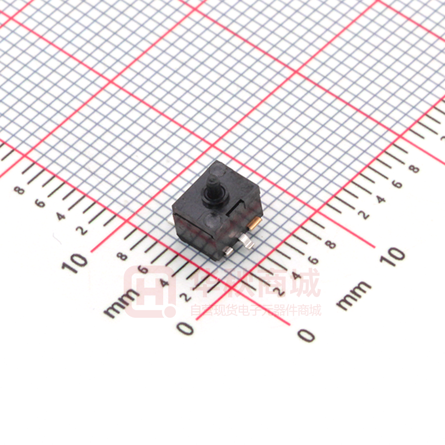

    按动开关 10万次 SMT 100mA 30gf 30V -10℃~+60℃
SPPW812302 数据手册
Detector Switch One-way Operation Type SPPW8 Series One-way operation detector switch ideal for media detection. Detector Push Slide Rotary Encoders Operating life Power Dual-in-line Package Type TACT SwitchTM CustomProducts With load 100,000cycles 0.1A 30V DC) ( Typical Specifications Items Rating max.) min.) ( ( / (Resistive load) Contact resistance (Initial /After operating life) Operating force Without load Specifications 0.1A 30V DC/100BA 3V DC 1Ω max./2Ω max. 0.3N max. 100,000cycles Product Line Poles Positions Terminal type For PC board (Reflow) For PC board (Dip) For PC board (Reflow) 1 1 For PC board (Dip) For PC board (Reflow) For PC board (Dip) For PC board (Reflow) For PC board (Dip) Slider height Total travel ON start (mm) position mm) (mm) ( h=6.1 h1=5.6 h2=4.45 Minimum order unit pcs) ( 4,000 20,000 4,000 Product No. SPPW812302 SPPW812300 SPPW810201 SPPW810203 SPPW811203 SPPW811200 Drawing No. 1 2 1 2 1 2 3 4 h=6.55 h1=6.05 h2=4.85 20,000 3,400 h=7.6 h1=7.1 h2=5.9 20,000 10.3 9.8 8.6 SPPW810401 SPPW810400 Taping Specifications (Taping Packaging) Reel Size Unit:mm Number of packages pcs.) ( Series 1 reel 1 case /Japan Tape width 1 case /export packing (mm) h = 6.1 Reflow) ( 1,000 2,000 4,000 24 850 1,700 3,400 h = 6.55(Reflow) ø380 25.4 h = 7.6(Reflow) Notes 1. Standard type dimensions indicate "with location lug" version. 2. Products other than those listed in the above chart are also available. Please contact us for details. 3. Please place purchase orders per minimum order unit integer) ( . 36 Detector Switch One-way Operation Type SPPW8 Series Dimensions No. Reflow 5 1.5 1.5 5-0.6 1.5 h 0.25 0.6 0.7 1.5 1.5 1.1 2 Unit:mm Style Location lug PC board mounting hole dimensions (Viewed from direction A) Detector Push Slide Rotary Encoders Power 0.25 ø1 1 A 4 Terminal No.1 ON starting position 4.3 h2 h1 1.1 Dip 1.5 5 1.5 5-0.6 h 0.6 2.5 1.5 Total travel position 0.3 4 ø1.5 1 ø1.6 hole 4 2-ø1 holes 5.2 Dual-in-line Package Type TACT SwitchTM CustomProducts 2 Terminal No.1 A 5.2 ø1 4 4 Total travel position ON starting position 4.3 h2 Location lug h1 Reflow 1.5 5 1.5 5-0.6 10.3 0.6 0.25 Location lug 0.7 1.5 1.5 1.1 2 4 3 1.5 A ø1.5 4 ø1.6 hole 1.1 ø1.5 ø1.6 hole 1 Terminal No.1 Total travel position ON starting position 8.6 9.8 6 Dip 5 1.5 1.5 5-0.6 10.3 0.6 2.5 0.25 0.3 2-ø1 holes 5.2 Terminal No. A 4 ø1.5 5.2 4 4 ø1.6 hole Terminal No.1 Total travel position ON starting position 8.6 9.8 6 Location lug Note Above dimensions indicate "with locating lug" versions. ( Terminal Layout Viewed from Direction A) Reflow 654 Circuit Diagram Reflow Dip Terminal No. Dip 654 1 2 5 6 3 1 2 3 4 5 6 123 123 4 Notes 1. 2. 3. 4. Products without location lug are also available. Contact us for other slider height variations. □ mark shows a cutting terminal. Contact us for other terminal types. 1.5 4 37 Detector Switches List of Varieties(General-purpose Type) General-purpose Type Series SPPB SPVE SPPW8 SPVM SPVR SPVF SSCU SSCT Detector Photo Push Slide Rotary Encoders Operating temperature range Rating max.) ( (Resistive load) Rating min.) ( (Resistive load) Initial contact resistance Insulation resistance Voltage proof Electrical Mechanical Environmental performance performance Durability performance Terminal strength Power Dual-in-line Package Type TACT SwitchTM CustomProducts Operation type ー40℃ to +85℃ ー10℃ to +60℃ 0.1A 30V DC ー40℃ to +85℃ 1mA 5V DC ー10℃ to +60℃ ー40℃ to +85℃ 0.1A 12V DC 50BA 3V DC 50BA 3V DC 1Ω max. 500mΩ max. 100BA 3V DC 1Ω max. 50BA 3V DC 2Ω max. 100BA 3V DC 3Ω max. 500mΩ max. 70mΩ max. 20mΩ max. 100MΩ min. 250V DC 250V AC for 1 minute 100MΩ min. 100V DC 100V AC for 1 minute 3N for 1 minute 0.5N for 1 minute 3N for 1 minute 1N for 1 minute 5N 0.5N for 1 minute 2N 3N for 30s 1N 3N for 1 minute 5N 10N Actuator 5N 10N 10N strength Operating life 50,000cycles 50,000cycles 100,000cycles without Load 2Ω max. 1Ω max. 2Ω max. Operating life (0.1A 30V DC) (0.1A 30V DC) (0.1A 30V DC) with Load 50,000cycles 2Ω max. 50,000cycles 1Ω max. 100,000cycles 2Ω max. Cold ー20±2℃ for 96h 50,000cycles 5Ω max. (1mA 5V DC) 50,000cycles 5Ω max. 100,000cycles 10,000cycles 10,000cycles 1Ω max. 100mΩ max. 40mΩ max. (1mA 5V DC) (0.1A 12V DC) (0.1A 12V DC) 100,000cycles 1Ω max. 10,000cycles 150mΩ max. 10,000cycles 60mΩ max. ー40±2℃ for 96h ー20±2℃ for 96h Dry heat Damp heat W Dimensions D (mm) H Manual soldering Dip Soldering soldering Reflow soldering Number of poles 85±2℃ for 96h 40±2℃, 90 to 95%RH for 96h 6.3 3 4.9 300±5℃, 5s max. 260±5℃, 5±1s 2.3 3.4 5 4 2.8 3.5 1.5 3.6 4.2 1.2 9 3.5 4.5 300±10℃, +1 3 0s 11 5.8 7 12.5 5 11.5 350±5℃, 3s max. 350±5℃, 3s max. ― 255±5℃, 5±1s Please see P.79 1 ― 245±5℃, 5±1s ― ― 1 0.5N max. 44 260±5℃, 5±1s 1.2 0.4N max. 0.35N max. 40 0.3N max. 41 Operation force 0.35N max. Page 28 34 0.3N max. 36 0.7±0.3N 45 38 ● Detector Switches Soldering Conditions ……………………………………………………………………………………79 ● Detector Switches Cautions ……………………………………………………………………………………………………80 25 Detector Switches Soldering Conditions Example of Reflow Soldering Condition 1. Heating method: Double heating method with infrared heater. 2. Temperature measurement: Thermocouple 0.1 to 0.2φ CA K) CC T) soldering portion copper foil surface) A heat resisting tape ( or ( at ( . should be used for fixed measurement. 3. Temperature profile Detector Push 300 Temperature (˚C ) A max. B Slide Rotary Encoders Power Dual-in-line Package Type TACT SwitchTM 200 D E 100 Time (s) Pre-heating F max. C Room temperature CustomProducts Series Reflow type) ( SPPB A (℃) 3s max. B (℃) 230 C s) ( 40 20 D (℃) E (℃) F s) ( 250 SPPW8 SPVE SPVG SPVL SPVM SPVN SPVP SPVR SPVS SSCM SPPY5 240 260 200 180 40 230 150 120 20 150 Room temperature 180 Notes 1. The condition mentioned above is the temperature on the mounting surface of a PC board. There are cases where the PC board's temperature greatly differs from that of the switch, depending on the PC board's material, size, thickness, etc. The above-stated conditions shall also apply to switch surface temperatures. 2. Soldering conditions differ depending on reflow soldering machines. Prior verification of soldering condition is highly recommended. 79
