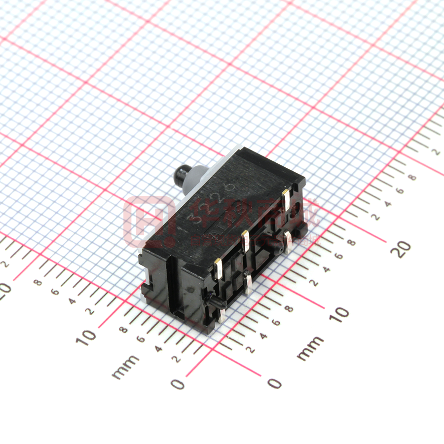

SPVQC Water-proof Type(Surface Mount) Detector Surface mount two-pole simultaneous changeover type achieving stable contact ■ Typical Specifications Items Specifications 50mA 18V DC / 50BA 5V DC Contact resistance (Initial / After operating life) Slide Rating(max.)( / min.) (Resistive load) 75mΩ max. / 200mΩ max. Operating force 1±0.5N Push Without load 300,000cycles Operating life With load 300,000cycle(50mA 18V DC) Rotary Product Line Positions Changeover timing Operating part shape Terminal type 2 2 Non shorting Push For PC board (Reflow) Minimum order unit(pcs) Japan Export 300 2,400 Product No. SPVQC10100 Dual-in-line Package Type Note Power Poles This unit cannot be used in water (IP67 rating, except for terminal). Packing Specifications Taping Unit:mm Number of packages(pcs.) 1 case /Japan 1 case /export packing 300 1,200 2,400 32 Export package measurements (mm) 403×403×360 Reel size Generalpurpose Type 1 reel Tape width (mm) ø380 Unit:mm PC Board Mounting Hole and Land Dimensions Style 4.08 Unit:mm 6.08 Water-proof Type Dimensions 33.5 .1 Φ1 le ho .6 Φ1 7.5 8.3 9.6max. 11 11.7 12.2 Terminal No.② 6.08 2.82 Terminal No.① 8 Terminal No.③ 4.08 0.6 le ho 8.3 3.04 Circuit Diagram 0.4 3.425 Ø1.4 2-1.4 2.435 Ø0.9 8.8 2.6 1.4 Terminal No.①-③&④-⑥ Off position Terminal No.①-②&④-⑤ On position Total travel position (The top of the plunger) (The top of the plunger) Terminal No.①-③&④-⑥ On position Terminal No.①-②&④-⑤ Off position (The top of the plunger) Free position 15.4 (The top of the plunger) 7.4 ② ③ ① ⑤ ④ 8.3 3.04 Terminal No.④ Terminal No.⑥ Terminal No.⑤ ⑥ Refer to P.71 for soldering conditions. 69 SPVQ8 SPVQ9 SPVQA SPVQC SSCN 15.2 15.4 13 Slide Photo Operation type Two-way 8.3 15.4 D 5.3 8.4 6.4 7.4 5 H 6.5 7.5 7.95 7.5 15 Automotive use Rotary Operating temperature range −40℃ to +85℃ ● ● ● ● ● Poles / Positions 1/1 2/2 1/1 1/2 2/2 1/2 Rating(max.) (Resistive load) 0.1A 12V DC 50mA 26V DC 0.1A 12V DC 50mA 18V DC 0.1A 12V DC Operating life without load 300,000cycles 1Ω max. or 1,000,000cycles 3Ω max. 300,000cycles 200mΩ max. 300,000cycles 1Ω max. 300,000cycles 200mΩ max. 100,000cycles 1Ω max. Operating life with load Rating(max.) (Resistive load) 300,000cycles 1Ω max. or 1,000,000cycles 3Ω max. 300,000cycles 200mΩ max. 300,000cycles 1Ω max. 300,000cycles 200mΩ max. 100,000cycles 1Ω max. Initial contact resistance 500mΩ max. 75mΩ max. 500mΩ max. 75mΩ max. 500mΩ max. Insulation resistance 100MΩ min. 500V DC 100MΩ min. 250V DC 100MΩ min. 500V DC Voltage proof 500V AC for 1minute 250V AC for 1minute 500V AC for 1minute Terminal strength 3N for 1minute (with terminal) Wire strength 30N for 1minute (with wire) 3N for 1minute Actuator strength 20N 10N Cold −40℃ 500h Dry heat 85℃ 500h Damp heat 60℃, 90 to 95% RH 500h Operation force Page 1±0.5N 60 Water-proof Type Environmental performance 100μA 5V DC Generalpurpose Type Mechanical performance 50μA 5V DC Dual-in-line Package Type Electrical performance Power Life cycle (availability) Rating(min.) (Resistive load) Push W Dimensions (mm) Durability Detector Water-proof Type Series 65 2N max. 66 69 70 Detector Switches Soldering Conditions・・・・・・・・・・・・・・・・・・・・・・・・・・・・・・・・・・・・・・・・・・・・・・ 71 Detector Switches Cautions・・・・・・・・・・・・・・・・・・・・・・・・・・・・・・・・・・・・・・・・・・・・・・・・・・・・ 72 Note ● Indicates applicability to all products in the series. 15 Detector Switches Soldering Conditions 1. 2.   3. Heating method: Double heating method with infrared heater. Temperature measurement: Thermocouple φ0.1 to 0.2 CA(K)or CC(T)at soldering portion(copper foil surface). A heat resisting tape should be used for fixed measurement. Temperature profile Detector Example of Reflow Soldering Condition Slide A max. B 200 Push D E 100 Rotary Temperature (˚C ) 300 Room temperature Time (s) A(℃)3s max. SPPB SPPW8 B(℃) C C(s) D(℃) E(℃) F(s) 180 150 120 40 250 Dual-in-line Package Type Series(Reflow type) Power Pre-heating F max. 35 SPVE SPVL SPVN SPVR 40 260 Water-proof Type SPVS 230 Generalpurpose Type SPVM SPVT SSCM SSCQ SPVQC 250 Notes 1. The condition mentioned above is the temperature on the mounting surface of a PC board. There are cases where the PC board's temperature greatly differs from that of the switch, surface depending on the PC board's material, size, thickness, etc. The above-stated conditions shall also apply to switch surface temperatures. 2. Soldering conditions differ depending on reflow soldering machines. Prior verification of soldering condition is highly recommended. Reference for Hand Soldering Series Soldering temperature Reference for Dip Soldering Soldering time (For PC board terminal types) Items Series SPVS, SPVN, SPVT, SPVM, SPVR, SPVE, SPPW8,SSCQ, SSCM, SPVL, SSCT, SPVQC 350±5℃ SPVQ1, SPVQ3, SPVQ6, SPVQ7, SPVQ8, SPVQ9, SSCN, SPVQA 300±10℃ 3 +1 / 0s SPPB(Reflow) 300±5℃ 5s max. SSCF, SPPB(For Lead, Dip) 350±10℃ 3 +1 / 0s 3s max. Preheating temperature Preheating time Dip soldering Soldering temperature SSCT, SPVQ1, SPVQ3, SPVQ6, SPVQ7, SPVQ8, 100±10℃ 60s max. 260±5℃ SPVQ9, SPVQA SPPW8, SPPB SSCF 100 ℃ max. 60s max. 255±5℃ ー 260±5℃ Duration of immersion 5±1s 5±1s 5±1s 71
