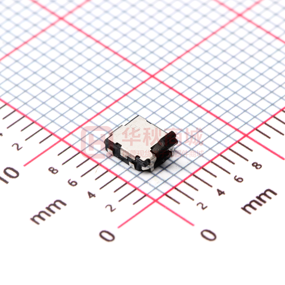

SPVR Low-profile Lever Type Low-profile, 1.2mm height, long travel type Detector ■ Typical Specifications Items Specifications Slide Rating(max.)( / min.) (Resistive load) 1mA 5V DC / 100μA 3V DC Contact resistance (Initial / After operating life) 3Ω max. / 5Ω max. Operating force 0.35N max. Push Without load 50,000cycles Operating life With load 50,000cycles(1mA 5V DC) Rotary Product Line Positions Total travel(mm) Terminal type 1 1 1.93 For PC board (Reflow) Power Poles Location lug Minimum order unit(pcs) Japan Export 2,500 10,000 Product No. With SPVR110102 Without SPVR120102 Dual-in-line Package Type Packing Specifications Taping Unit:mm 1 reel 1 case /Japan 1 case /export packing Tape width (mm) Export package measurements (mm) 2,500 5,000 10,000 16 417×409×139 Number of packages(pcs.) Generalpurpose Type Water-proof Type Dimensions Unit:mm PC board mounting hole and land dimensions (Viewed from direction A) Style Terminal Layout (Viewed from Direction A) 2 1 3 4 4.2 1.05 Terminal No.1 0.8 Frame 1.2 3.6 Fast Switching Type With boss Reel size 2 0.8 4-0.5 0.2 2ø0 ˚) 0.3 ON starting position .7 R 0.2 2 1 3 4 0.4 (0.95) 1 Total travel position 0. 2 (2.98) C (0.92) 1.2 2.7 2.2 le ho 4 A 3.13 Circuit Diagram (60 1.72 (0.31) 2.9 4.5 0.9 5 0.6 0.5 2.2 ø0.6 Center of rotation Note Dimensions drawing is for type with location lugs. 26 Refer to P.68 for soldering conditions. Detector Switches List of Varieties SPVS SPVN SPVT SPVM SPVR SPVE Slide Photo Operation type Two-way W 3.5 D 3.3 H 3.8 5.6 2.8 3.6 3.6 4.7 3.5 4.2 3 1.9 1.5 1.2 2.3 1 −40℃ to +85℃ ● ● 3.4 −10℃ to +60℃ ● ● ● — Power Life cycle (availability) Poles / Positions 1/1 50mA 20V DC Rating(min.) (Resistive load) 50μA 3V DC 100μA 3V DC Operating life without load 50,000cycles 5Ω max. 100,000cycles 1Ω max. 50,000cycles 5Ω max. 50,000cycles 1Ω max. Operating life with load Rating(max.) (Resistive load) 50,000cycles 5Ω max. 100,000cycles 1Ω max. 50,000cycles 5Ω max. 50,000cycles 1Ω max. Initial contact resistance 2Ω max. 500mΩ max. 2Ω max. Insulation resistance 100MΩ min. 100V DC Voltage proof 100V AC for 1 minute 0.5N for 1minute Actuator strength 5N 1N for  1minute 10N 5N 3Ω max. Damp heat 40℃, 90 to 95%RH 96h 0.35N max. 16 0.4N max. 19 21 500mΩ max. 2N 5N −20℃ 96h 85℃ 96h Operation force 50μA 3V DC 0.5N for 1minute −40℃ 96h Dry heat Page 100μA 3V DC Fast Switching Type Terminal strength Cold Environmental performance 50μA 3V DC 0.1A 30V DC Water-proof Type Mechanical performance 1mA 5V DC Generalpurpose Type 1mA 5V DC Dual-in-line Package Type Rating(max.) (Resistive load) Electrical performance Rotary Operating temperature range Automotive use One-way Push Dimensions (mm) Durability Detector General-purpose Type Series 24 0.35N max. 0.3N max. 26 27 Detector Switches Soldering Conditions・・・・・・・・・・・・・・・・・・・・・・・・・・・・・・・・・・・・・・・・・・・・・・ 68 Detector Switches Cautions・・・・・・・・・・・・・・・・・・・・・・・・・・・・・・・・・・・・・・・・・・・・・・・・・・・・ 69 Note ● Indicates applicability to all products in the series. 11 Detector Switches / Soldering Conditions Detector Example of Reflow Soldering Condition 1. 2.   3. Heating method: Double heating method with infrared heater. Temperature measurement: Thermocouple φ0.1 to 0.2 CA(K)or CC(T)at soldering portion(copper foil surface). A heat resisting tape should be used for fixed measurement. Temperature profile Slide Push Temperature (˚C ) 300 A max. B 200 D E Rotary 100 Room temperature Time (s) Power Pre-heating F max. Dual-in-line Package Type Series(Reflow type) A(℃)3s max. SPPB C B(℃) C(s) D(℃) E(℃) F(s) 230 40 180 150 120 250 SPVE SPVL SPVM Generalpurpose Type SPVN SPVR 260 SPVS Water-proof Type SPVT SSCM SSCQ Fast Switching Type SPVQC 250 Notes 1. The condition mentioned above is the temperature on the mounting surface of a PC board. There are cases where the PC board's temperature greatly differs from that of the switch, surface depending on the PC board's material, size, thickness, etc. The above-stated conditions shall also apply to switch surface temperatures. 2. Soldering conditions differ depending on reflow soldering machines. Prior verification of soldering condition is highly recommended. Reference for Hand Soldering Series 68 Soldering temperature Reference for Dip Soldering Soldering time (For PC board terminal types) Items Series SPVS, SPVN, SPVT, SPVM, SPVR, SPVE, SSCQ, SSCM, SPVL, SSCT, SPVQC 350±5℃ SPVQ3, SPVQ6, SPVQ7, SPVQ8, SPVQ9, SSCN, SPVQA 300±10℃ 3 +1 / 0s SPPB(Reflow) 300±5℃ 5s max. SSCF, SPPB(For Lead, Dip) 350±10℃ 3 +1 / 0s 3s max. Preheating temperature Preheating time Dip soldering Soldering temperature SSCT, SPVQ3, SPVQ6, SPVQ7, SPVQ8, SPVQ9, 100±10℃ 60s max. 260±5℃ SPVQA SPPW8, SPPB SSCF 100 ℃ max. 60s max. 255±5℃ ー 260±5℃ Duration of immersion 5±1s 5±1s 5±1s
