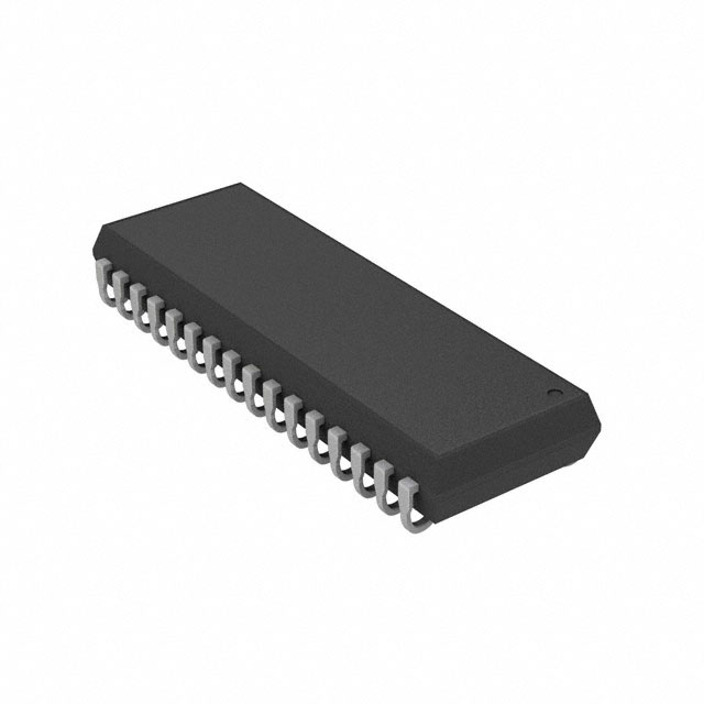

AS7C4096A-20JIN 数据手册
February 2006 AS7C4096A ® 5.0V 512K × 8 CMOS SRAM • Equal access and cycle times • Easy memory expansion with CE, OE inputs • TTL-compatible, three-state I/O • JEDEC standard packages Features • Pin compatible to AS7C4096 • Industrial and commercial temperature • Organization: 524,288 words × 8 bits • Center power and ground pins • High speed - 400 mil 36-pin SOJ - 44-pin TSOP 2 • ESD protection ≥ 2000 volts • Latch-up current ≥ 200 mA - 10/12/15/20 ns address access time - 5/6 ns output enable access time • Low power consumption: ACTIVE - 880mW/max @ 10 ns • Low power consumption: STANDBY - 55mW/max CMOS Pin arrangements Logic block diagram 36-pin SOJ (400 mil) VCC GND 524,288 × 8 Array (4,194,304) I/O1 Sense amp A0 A1 A2 A3 A4 A5 A6 A7 A8 A9 Row decoder Input buffer I/O8 Control Circuit 1 2 3 4 5 6 7 8 9 10 11 12 13 14 15 16 17 18 36 35 34 33 32 31 30 29 28 27 26 25 24 23 22 21 20 19 NC A18 A17 A16 A15 OE I/O8 I/O7 GND VCC I/O6 I/O5 A14 A13 A12 A11 A10 NC WE OE CE NC NC A0 A1 A2 A3 A4 CE I/O1 I/O2 VCC GND I/O3 I/O4 WE A5 A6 A7 A8 A9 NC NC 1 2 3 4 5 6 7 8 9 10 11 12 13 14 15 16 17 18 19 20 21 22 44 43 42 41 40 39 38 37 36 35 34 33 32 31 30 29 28 27 26 25 24 23 NC NC NC A18 A17 A16 A15 OE I/O8 I/O7 GND VCC I/O6 I/O5 A14 A13 A12 A11 A10 NC NC NC A10 A11 A12 A13 A14 A15 A16 A17 A18 Column decoder A0 A1 A2 A3 A4 CE I/O1 I/O2 VCC GND I/O3 I/O4 WE A5 A6 A7 A8 A9 44-pin TSOP 2 Selection guide Maximum address access time Maximum outputenable access time Maximum operating current Maximum CMOS standby current 2/21/06, v 1.2 –10 10 5 160 10 Alliance Semiconductor –12 12 6 140 10 –15 15 6 120 10 –20 20 6 100 10 Unit ns ns mA mA P. 1 of 10 Copyright © Alliance Semiconductor. All rights reserved. AS7C4096A ® Functional description The AS7C4096A is a high-performance CMOS 4,194,304-bit Static Random Access Memory (SRAM) device organized as 524,288 words × 8 bits. It is designed for memory applications where fast data access, low power, and simple interfacing are desired. Equal address access and cycle times (tAA, tRC, tWC) of 10/12/15/20 ns with output enable access times (tOE) of 5/6 ns are ideal for high-performance applications. The chip enable input CE permits easy memory expansion with multiple-bank memory systems. When CE is high the device enters standby mode. The device is guaranteed not to exceed 55mW power consumption in CMOS standby mode. A write cycle is accomplished by asserting write enable (WE) and chip enable (CE). Data on the input pins I/O1–I/O8 is written on the rising edge of WE (write cycle 1) or CE (write cycle 2). To avoid bus contention, external devices should drive I/O pins only after outputs have been disabled with output enable (OE) or write enable (WE). A read cycle is accomplished by asserting output enable (OE) and chip enable (CE), with write enable (WE) high. The chip drives I/O pins with the data word referenced by the input address. When either chip enable or output enable is inactive, or write enable is active, output drivers stay in high-impedance mode. All chip inputs and outputs are TTL-compatible, and operation is from a single 5.0V supply voltage. This device is available as per industry standard 400-mil 36-pin SOJ and 44-pin TSOP 2 packages. Absolute maximum ratings Parameter Voltage on VCC relative to GND Voltage on any pin relative to GND Power dissipation Storage temperature (plastic) Temperature with VCC applied DC current into output (low) Symbol Vt1 Vt2 PD Tstg Tbias IOUT Min –0.5 –0.5 – –65 –55 – Max +7.0 VCC +0.5 1.0 +150 +125 20 Unit V V W °C °C mA NOTE: Stresses greater than those listed under Absolute Maximum Ratings may cause permanent damage to the device. This is a stress rating only and functional operation of the device at these or any other conditions outside those indicated in the operational sections of this specification is not implied. Exposure to absolute maximum rating conditions for extended periods may affect reliability. Truth table CE WE OE Data Mode H X X High Z Standby (ISB, ISB1) L H H High Z Output disable (ICC) L H L DOUT Read (ICC) L L X DIN Write (ICC) 2/21/06, v 1.2 Alliance Semiconductor P. 2 of 10 AS7C4096A ® Recommended operating condition Parameter Symbol VCC(10/12/15/20) VIH* VIL** TA TA Supply voltage Input voltage commercial industrial Ambient operating temperature Min 4.5 2.2 –0.5 0 –40 Nominal 5.0 – – – – Max 5.5 VCC + 0.5 0.8 70 85 Unit V V V °C °C * VIH max = VCC + 1.5V for pulse width less than 5 nS. ** VIL min = –1.0V for pulse width less than 5 nS. . DC operating characteristics (over the operating range)1 Parameter Input leakage current Symbol |ILI| –10 –12 –15 –20 Min Max Min Max Min Max Min Max Unit Notes Test conditions VCC = Max, VIN = GND to VCC – 1 – 1 – 1 – 1 µA Output leakage current |ILO| VCC = Max, CE = VIH VOUT= GND to VCC – 1 – 1 – 1 – 1 µA Operating power supply current ICC VCC = Max, CE < VIL f = fMax, IOUT = 0mA – 160 – 140 – 120 – 100 mA ISB VCC = Max, CE > VIH f = fMax, IOUT = 0mA – 60 – 55 – 50 – 40 mA ISB1 VCC = Max, CE ≥ VCC – 0.2V, VIN ≤ 0.2V or VIN ≥ VCC – 0.2V, f=0 – 10 – 10 – 10 – 10 mA IOL = 6 mA, VCC = Min – 0.4 – 0.4 – 0.4 – 0.4 IOL = 8 mA, VCC = Min – 0.5 – 0.5 – 0.5 – 0.5 IOH = –4 mA, VCC = Min 2.4 – 2.4 – 2.4 – 2.4 – Standby power supply current VOL Output voltage VOH V 4 V 4 Capacitance (f = 1MHz, Ta = 25° C, VCC = NOMINAL)4 Parameter Symbol Signals Test conditions Max Unit Input capacitance CIN A, CE, WE, OE VIN = 0V 5 pF I/O capacitance CI/O I/O VIN = VOUT = 0V 7 pF 2/21/06, v 1.2 Alliance Semiconductor P. 3 of 10 AS7C4096A ® Read cycle (over the operating range)2,8 Parameter –10 Max Min –12 Max Min –15 Max Min –20 Max Symbol Min Unit Notes Read cycle time tRC 10 – 12 – 15 – 20 – ns Address access time tAA – 10 – 12 – 15 – 20 ns 2 Chip enable (CE) access time tACE – 10 – 12 – 15 – 20 ns 2 Output enable (OE) access time tOE – 5 – 6 – 6 – 6 ns Output hold from address change tOH 3 – 3 – 3 – 3 – ns 4 CE Low to output in low Z tCLZ 3 – 3 – 3 – 3 – ns 3,4 CE High to output in high Z tCHZ – 5 – 6 – 7 – 9 ns 3,4 OE Low to output in low Z tOLZ 0 – 0 – 0 – 0 – ns 3,4 OE High to output in high Z tOHZ – 5 – 6 – 7 – 9 ns 3,4 Power up time tPU 0 – 0 – 0 – 0 – ns 3,4 Power down time tPD – 10 – 12 – 15 – 20 ns 3,4 Key to switching waveforms Rising input Falling input Undefined/don’t care Read waveform 1 (address controlled)2,5,6,8 tRC Address tAA tOH DOUT Data valid Read waveform 2 (CE, OE controlled)2,5,7,8 tRC1 CE tOE OE tOLZ tOHZ tACE tCHZ DOUT Data valid tCLZ Supply current 2/21/06, v 1.2 tPU tPD 50% 50% Alliance Semiconductor ICC ISB P. 4 of 10 AS7C4096A ® Write cycle (over the operating range)9 –10 Symbol Min Max Parameter –12 Min Max –15 Min Max –20 Min Max Unit Notes Write cycle time tWC 10 – 12 – 15 – 20 – ns Chip enable (CE) to write end tCW 7 – 8 – 10 – 12 – ns Address setup to write end tAW 7 – 8 – 10 – 12 – ns Address setup time tAS 0 – 0 – 0 – 0 – ns Write pulse width (OE = high) tWP1 7 – 8 – 10 – 12 – ns Write pulse width (OE = low tWP2 10 – 12 – 15 – 20 – ns Address hold from end of write tAH 0 – 0 – 0 – 0 – ns Write recovery time tWR 0 – 0 – 0 – 0 – ns Data valid to write end tDW 5 – 6 – 7 – 9 – ns Data hold time tDH 0 – 0 – 0 – 0 – ns 3,4 Write enable to output in high Z tWZ 2 5 2 6 2 7 2 9 ns 3,4 Output active from write end tOW 3 – 3 – 3 – 3 – ns 3,4 Write waveform 1 (WE controlled)9 tWC tWR tAH tAW Address tWP WE tAS tDW DIN tDH Data valid tWZ tOW DOUT 2/21/06, v 1.2 Alliance Semiconductor P. 5 of 10 AS7C4096A ® Write waveform 2 (CE controlled)9 tWC tWR tAH tAW Address tAS tCW CE tWP WE tDW DIN tDH Data valid AC test conditions - Output load: see Figure B. Input pulse level: GND to VCC - 0.5V. See Figures A and B. Input rise and fall times: 2 ns. See Figure A. Input and output timing reference levels: 1.5V. VCC - 0.5V GND 90% 10% 90% 10% 2 ns Figure A: Input pulse DOUT 255Ω +5.0V Thevenin equivalent: 480Ω 168Ω C10 DOUT +1.728V GND Figure B: 5.0V Output load Notes 1 2 3 4 5 6 7 8 9 10 During VCC power-up, a pull-up resistor to VCC on CE is required to meet ISB specification. For test conditions, see AC Test Conditions. tCLZ and tCHZ are specified with CL = 5pF as in Figure B. Transition is measured ±500 mV from steady-state voltage. This parameter is guaranteed, but not tested. WE is HIGH for read cycle. CE and OE are LOW for read cycle. Address valid prior to or coincident with CE transition Low. All read cycle timings are referenced from the last valid address to the first transitioning address. All write cycle timings are referenced from the last valid address to the first transitioning address. C = 30pF, except at high Z and low Z parameters, where C = 5pF. 2/21/06, v 1.2 Alliance Semiconductor P. 6 of 10 AS7C4096A ® Package dimensions c 44434241403938 37 36 35 34333231 30 29 28 2726 2524 23 44-pin TSOP 2 A A1 A2 b c d E1 E e L E1 E 1 2 3 4 5 6 7 8 9 10 111213 14 15 16 17 1819 20 21 22 d A2 A A1 e b e L 0–5° D b1 36-pin SOJ E1 E2 A A1 b Pin 1 Seating Plane c A2 E 2/21/06, v 1.2 Alliance Semiconductor A A1 A2 b b1 c D e E E1 E2 44-pin TSOP 2 Min(mm) Max(mm) 1.2 0.05 0.15 0.95 1.05 0.30 0.45 0.21 0.12 18.31 18.52 10.06 10.26 11.68 11.94 0.80 (typical) 0.40 0.60 36-pin SOJ 400 Min(mils) Max(mils) 0.128 0.148 0.025 – 0.105 0.115 0.015 0.020 0.026 0.032 0.007 0.013 .920 .930 0.045 0.055 0.370 BSC 0.395 0.405 0.435 0.445 P. 7 of 10 AS7C4096A ® Ordering codes Package SOJ TSOP 2 Version Commercial Industrial Commercial Industrial 10 ns AS7C4096A-10JC AS7C4096A-10JI AS7C4096A-10TC AS7C4096A-10TI 12 ns AS7C4096A-12JC AS7C4096A-12JI AS7C4096A-12TC AS7C4096A-12TI 15 ns AS7C4096A-15JC AS7C4096A-15JI AS7C4096A-15TC AS7C4096A-15TI 20 ns AS7C4096A-20JC AS7C4096A-20JI AS7C4096A-20TC AS7C4096A-20TI Note: Add suffix ‘N’ to the above part number for Lead Free Parts. (Ex: AS7C4096A - 10 TIN) Part numbering system AS7C 4096A –XX SRAM prefix Device number Access time 2/21/06, v 1.2 J or T Packages: J: SOJ 400 mil T: TSOP 2 X Temperature ranges: C: Commercial, 0°C to 70°C I: Industrial, –40°C to 85°C Alliance Semiconductor X N=Lead Free Parts P. 8 of 10 AS7C4096A ® Revision History Rev. No. v1.0 v1.1 v1.2 History Initial release 11/08/04 Included ICC, ISB & ISB1 parameters Corrected the following: TOE, VIH, VOL & tWZ Removed the title ”PRELIMINARY INFORMATION” 2/21/06, v 1.2 Revised Date Alliance Semiconductor 05/27/05 02/21/06 P. 9 of 10 ® AS7C4096A ® Alliance Semiconductor Corporation 2575, Augustine Drive, Santa Clara, CA 95054 Tel: 408 - 855 - 4900 Fax: 408 - 855 - 4999 Copyright © Alliance Semiconductor All Rights Reserved Part Number: AS7C4096A Document Version: v 1.2 www.alsc.com © Copyright 2003 Alliance Semiconductor Corporation. All rights reserved. Our three-point logo, our name and Intelliwatt are trademarks or registered trademarks of Alliance. All other brand and product names may be the trademarks of their respective companies. Alliance reserves the right to make changes to this document and its products at any time without notice. Alliance assumes no responsibility for any errors that may appear in this document. The data contained herein represents Alliance's best data and/or estimates at the time of issuance. Alliance reserves the right to change or correct this data at any time, without notice. If the product described herein is under development, significant changes to these specifications are possible. The information in this product data sheet is intended to be general descriptive information for potential customers and users, and is not intended to operate as, or provide, any guarantee or warrantee to any user or customer. Alliance does not assume any responsibility or liability arising out of the application or use of any product described herein, and disclaims any express or implied warranties related to the sale and/or use of Alliance products including liability or warranties related to fitness for a particular purpose, merchantability, or infringement of any intellectual property rights, except as express agreed to in Alliance's Terms and Conditions of Sale (which are available from Alliance). All sales of Alliance products are made exclusively according to Alliance's Terms and Conditions of Sale. The purchase of products from Alliance does not convey a license under any patent rights, copyrights; mask works rights, trademarks, or any other intellectual property rights of Alliance or third parties. Alliance does not authorize its products for use as critical components in life-supporting systems where a malfunction or failure may reasonably be expected to result in significant injury to the user, and the inclusion of Alliance products in such lifesupporting systems implies that the manufacturer assumes all risk of such use and agrees to indemnify Alliance against all claims arising from such use.
AS7C4096A-20JIN
物料型号:AS7C4096A
器件简介:AS7C4096A是一款高性能CMOS 4,194,304位静态随机存取存储器(SRAM),组织为524,288字×8位。它设计用于需要快速数据访问、低功耗和简单接口的存储应用。
引脚分配:该芯片有36引脚SOJ和44引脚TSOP 2两种封装形式,具有中心电源和地引脚,以及输入/输出引脚。
参数特性: - 工作电压:5.0V - 访问时间:地址访问时间10/12/15/20纳秒,输出使能访问时间5/6纳秒 - 功耗:活动模式下最大880毫瓦,待机模式下最大55毫瓦 - 封装:符合JEDEC标准的400 mil 36引脚SOJ和44引脚TSOP 2 - ESD保护:≥2000伏 - 闩锁电流:≥200毫安
功能详解: - 地址访问时间和周期时间相等,适用于高性能应用。 - 芯片使能输入CE允许在多银行存储系统中轻松扩展存储器。 - 写入周期通过使能写入(WE)和芯片使能(CE)来完成。 - 读取周期通过使能输出(OE)和芯片使能(CE),WE保持高电平来完成。
应用信息:适用于需要快速数据访问和低功耗的存储应用。
封装信息:提供工业标准400 mil 36引脚SOJ和44引脚TSOP 2封装。
