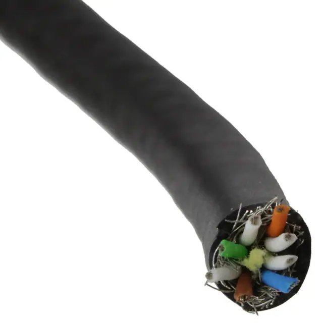

ROHS NEW CAT 6 CABLE compliant High reliability Cat 6 Ethernet cable & cordsets General construction A 4 pairs, 26 AWG, 100 Ohm SFTP round patch cable, designed to the ISO / IEC 11801 Category 6 requirements. The cable contains 4 twisted pairs individually shielded, cabled, double shielded with kevlar reinforcement strands, jacketed in black UV resistant Polyurethane HFFR. Designed for fixed or portable applications in harsh environments. HFFR: Halogen Free Flame Retardant Jacket compound specification: - Halogen free flame retardant polyether-based polyurethane - Excellent hydrolysis resistance - High microbial resistance - Glossy finish - UV resistant - High flexibility Datas for th e cable alone only (without RJ4 5 plug) Applications n Robotics n CNC machines Physical characteristics n Motion control n Battlefield communication Conductors 26 AWG (0,14 mm²) tinned copper n Railways n Industrial process control Insulation Polyethylene Nom. Dia. 0,039” (1mm) Assembly Pairs cabled with Kevlar strength members and separation tape wrapped Shields Inner: aluminium mylar 100% coverage Outer: t inned copper braid 80% coverage Jacket Black, special PUR compound Electrical characteristics (at 20°C - 68°F) DC Resistance 290 Ohm/Km Impedance (100 MHz) 100 +/- 5 Ohm Attenuation (dB/100m) N.E.X.T. (Near-End Crosstalk Loss) Weight 36.9 lbs / mft (55 kg/km) 1 MHz 3.1 dB 75.3 dB min. Outside diam. 0.272” (6.9 mm) nom. 4 MHz 5.8 dB 66.3 dB min. 8 MHz 8.0 dB 61.8 dB min. 72mm (10x O. D.) 10 MHz 9.0 dB 60.3 dB min. Min bend radius (During installation) 16 MHz 11.4 dB 57.2 dB min. 36mm (5 x O.D.) 20 MHz 12.8 dB 55.8 dB min. MIn bend radius (During operation) 25 MHz 14.1 dB 54.3 dB min. Min flexes to failure Passes IEC 61156-6 requirements 31.25 MHz 16.1 dB 52.8 dB min. Temperature -40°C (-40°F) / + 85°C (185°F) 62.5 MHz 23.2 dB 48.4 dB min. 100 MHz 29.9 dB 45.3 dB min. 200 MHz 43.7 dB 40.8 dB min. 250 MHz 49.7 dB 39.3 dB min. Frequency Amphenol Capacitance (1 kHz) 50nF/km nom. Capacitance unbalance 1600 pF/km max. Insulation resistance 5 GOhm/km Voltage rating (peak) 230 V Dielectric strength VAC/1 min - 700 V/Min Propagation delay 4.6 ns/m Skew 45 ns/100m Resistance unbalance 2% Return loss (250 MHz) 15.6dB Velocity of propagation 72% nom. Reel of cable (without RJ45 plug on ends) 42 Length (m / ft) Part number 100 m / ~328 ft 191-031179-00 300 m / ~984 ft 191-031179-01 Cordsets with a RJ45 plug overmolded on each end Length (m/ft) 0,75 m / 2,46 ft 1,00 m / 3,28 ft 1,50 m / 4,92 ft 2,00 m / 6,56 ft 2,50 m / 8,20 ft 3,00 m / 9,84 ft 3,50 m / 11,48 ft 4,00 m / 13,12 ft 4,50 m / 14,76 ft 5,00 m / 16,40 ft 6,00 m / 19,68 ft 7,00 m / 22,96ft 8,00 m / 26,24 ft 9,00 m / 29,52 ft 10,00 m / 32,80 ft 15,00 m / 49,20 ft 20,00 m / 65,60 ft 25,00 m / 82,00 ft 30,00 m / 98,40 ft 35,00 m / 114,80 ft 40,00 m / 131,20 ft 45,00 m / 147,60 ft 50,00 m / 164,00 ft 60,00 m / 196,80 ft Part number RJF SFTP 6 0075 RJF SFTP 6 0100 RJF SFTP 6 0150 RJF SFTP 6 0200 RJF SFTP 6 0250 RJF SFTP 6 0300 RJF SFTP 6 0350 RJF SFTP 6 0400 RJF SFTP 6 0450 RJF SFTP 6 0500 RJF SFTP 6 0600 RJF SFTP 6 0700 RJF SFTP 6 0800 RJF SFTP 6 0900 RJF SFTP 6 1000 RJF SFTP 6 1500 RJF SFTP 6 2000 RJF SFTP 6 2500 RJF SFTP 6 3000 RJF SFTP 6 3500 RJF SFTP 6 4000 RJF SFTP 6 4500 RJF SFTP 6 5000 RJF SFTP 6 6000
