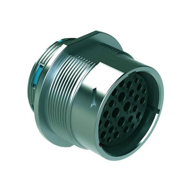

    29 针位圆形连接器 插座外壳 面板安装
AHDM04-24-29SR 数据手册
REVISIONS MAIN POLARIZING KEYWAY 41.5 Ø50.8 12.8 2.6 6 110°REF REV ECO DESCRIPTION DATE BY APPR A1 -- RELEASE NEW DRAWING 18/OCT/18 BROOK TOMMY A2 -- ADD MORE MATERIAL NOTES 25/OCT/18 BROOK TOMMY SIZE 16 CONTACTS (19 PLACES) SIZE 20 CONTACTS (6 PLACES) 6 TITLE: Amphenol AHDM04-24-29SR YYMMDD 110°REF RECPT, 24 SZ 29 SOC, RD, WIDE THD Ø40.1 1 11/16-18 UNEF 2A THREAD SIZE 12 CONTACTS (4 PLACES) M38X1.5 6g THREAD 6 NOTES: UNLESS OTHERWISE SPECIFIED DWG NO: 1. MATERIAL: SHELL: ZINC ALLOY, NICKEL PLATED INSERT AND RETAINING RING: THERMOPLASTIC SEAL: SILICONE RUBBER AHDM04-24-29SR 2. MODIFICATIONS: THREADED HOUSING; REDUCED DIA. WIRE SEAL TYPICAL WIRE RANGE QUANTITY MAX. INSUL O.D. CURRENT RATING 12 2.46 mm (.097 in) 4.01 mm (.158 in) 10-14 AWG 16 1.35 mm (.053 in) 2.62 mm (.103 in) 14-20 AWG 13 AMPS RECOMMENDED PANEL MOUNTING HOLE 20 1.02 mm (.040 in) 2.10 mm (.083 in) 16-22 AWG 7.5 AMPS RECOMMENDED PANEL THICKNESS:1.6 TO 4.7MM UNLESS OTHERWISE SPECIFIED 1) 2) 1 2 3 25 AMPS All dimensions are in metric(mm). Tolerances are as follows: PL DEC ±0.30 Fractions ±1/64 PL DEC ±0.15 Angles ±1° PL DEC ±0.08 3) Note reference = X SIGNATURES DRAWN: CHECKED: 25/OCT/18 25/OCT/18 TOMMY 25/OCT/18 Sine Systems - www.amphenol-sine.com 44724 Morley Drive Clinton Township, MI 48036 ENGINEER: APPROVAL: MATERIAL SPECIFICATIONS: CUSTOMER: PROCESS SPECIFICATIONS: Amphenol DATE BROOK ORION RECPT, 24 SZ 29 SOC, RD, WIDE THD THIS DRAWING IS SUPPLIED FOR INFORMATION ONLY. DESIGN FEATURES, SPECIFICATIONS AND PERFORMANCE DATA SIZE SHOWN HEREON ARE THE PROPERTY OF THE AMPHENOL CORPORATION. NO RIGHTS OF REPRODUCTION ARE IMPLIED. ALL DIMENSIONS ARE SUBJECT TO NORMAL SCALE: MANUFACTURING VARIATIONS. TYPE B C- NEXT ASS'Y: ITEM NONE DWG NO: REVISION AHDM04-24-29SR SHEET 1 A2 OF 1 1 AHDM04-24-29SR DESCRIPTION PART NUMBER MATERIALS LIST 6 CONTACT SIZE AND WIRE RANGE: MIN. INSUL O.D. OF: 5. ALL DIMENSIONS ARE FOR REFERENCE USE ONLY. 1 RETAINIGN RING - BLUE 41.45 +0.2 -0 CONTACT SIZE SH: ( * = SEAL TYPE ) A2 4. MATING PART: AHDM06-24-29P* Ø43.08±0.12 REV: 3. SPECIFICATIONS: 3.1 OPERATING TEMPERATURE: -55℃ TO +125℃. 3.2 DIELECTRIC WITHSTANDING VOLTAGE: LESS THAN 2 MILLIAMPS CURRENT LEAKAGE @ 1500 VOLTS AC. 3.3 INSULATION RESISTANCE: 1000 MEGOHM MIN @ 25℃. 3.4 MOISTURE RESISTANCE: IP67&IP69K ( MATED CONDITION ). 3.5 MATING CYCLE DURABILITY: 100 CYCLES 3.6 RoHS COMPLIANT A Series™ - Contact Size 12 Options (Works with: AHD-6, ATP, ATHD, DuraMate and PanelMate Series) Machined Contacts, Sockets & Pins Part Number Description Stamped & Formed Contacts, Sockets & Pins Size AWG Type Part Number Description Size AWG Type *AT60-204-12141-10 Male Contact - Pin, Nickel-plated 12 10-12 Machined AT60-12-0244 Male Contact - Pin, Gold-plated 12 10-12 Stamped & Formed *AT62-203-12141-10 Female Contact - Socket, Nickel-plated 12 10-12 Machined AT62-12-0244 Female Contact - Socket, Gold-plated 12 10-12 Stamped & Formed AT60-220-1231 Male Contact - Pin, Gold-plated 12 12-14 Machined AT60-12-0222 Male Contact - Pin, Nickel-plated 12 10-12 Stamped & Formed AT62-210-1231 Female Contact - Socket, Gold-plated 12 12-14 Machined AT62-12-0222 Female Contact - Socket, Nickel-plated 12 10-12 Stamped & Formed AT60-204-12141 Male Contact - Pin, Nickel-plated 12 12-14 Machined AT60-12-0144 Male Contact - Pin, Gold-plated 12 12-14 Stamped & Formed AT62-203-12141 Female Contact - Socket, Nickel-plated 12 12-14 Machined AT62-12-0144 Female Contact - Socket, Gold-plated 12 12-14 Stamped & Formed AT60-12-0166 Male Contact - Pin, Nickel-plated 12 12-14 Stamped & Formed AT62-12-0166 Female Contact - Socket, Nickel-plated 12 12-14 Stamped & Formed Part Number Description *Works with ATP Series only DiagnosticGrade™ Machined Contacts, Sockets & Pins • Smaller AWG for Diagnostic Applications • Gold-plated • Increased Mating Cycles • Cost-effective Part Number Description 65-54749 AT62-210-1231-1820 Size AWG Type Male Contact - DiagnosticGrade™, Pin, Gold-plated 12 20 Machined Female Contact - DiagnosticGrade™, Socket, Gold-plated 12 20 Machined Tooling - Machined Contacts Part Number Tooling - Stamped & Formed Contacts MFX-3973 Crimp Die - Size 12 MFX-3985 Crimp Die - Svize 12, 10-12AWG -02XX Series ATT-12-00 Hand Crimp Tool - Size 12, 12AWG ATT-12-01 Hand Crimp Tool - Size 12, 10AWG Description AUTK-12 Hand Crimp Tool, Size 12 AUTK-100 Universal Heavy Duty Contact Crimping Tool Kit, Size 12/16/20 CA-5D12 Universal Hand Crimp Tool, Size 12/16/20 CA-5E12 Pneumatic Crimp Tool, Size 12/16/20 M300-25A Hand Crimp Tool used with Crimp Locator MFX-3966, Size 12, 10AWG MFX-3966 Contact Locator used with Hand Crimp Tool M300-25A, Size 12, 10AWG Contact Removal Tools (For both Machined or Stamped & Formed Contacts) Part Number ATRT-100 AT11-337-1205 Description Contact and Wedgelock Extraction Tool Contact Removal Tool, Plastic, Size 12 Sealing Plugs (For both Machined or Stamped & Formed Contacts) Part Number A114017 Description Sealing Plug, Size 12, White Amphenol Sine Systems 44724 Morley Drive, Clinton Township, MI 48036 USA www.amphenol-sine.com 10/2023 A Series™ - Contact Size 16 Options (Works with: AT, ATV, AHD-9, ARC, DuraMate and PanelMate Series) Stamped & Formed Contacts, Sockets & Pins Machined Contacts, Sockets & Pins Size AWG Type AT60-215-1631 Male Contact - Pin, Gold-plated 16 14 Machined AT60-14-0122 Male Contact - Pin, Nickel-plated 16 14-18 Stamped & Formed Part Number Description Size AWG Type Part Number Description AT62-209-1631 Female Contact - Socket, Gold-plated 16 14 Machined AT62-14-0122 Female Contact - Socket, Nickel-plated 16 14-18 Stamped & Formed AT60-215-16141 Male Contact - Pin, Nickel-plated 16 14 Machined AT60-14-0144 Male Contact - Pin, Gold-plated 16 14-18 Stamped & Formed AT62-209-16141 Female Contact - Socket, Nickel-plated 16 14 Machined AT62-14-0144 Female Contact - Socket, Gold-plated 16 14-18 Stamped & Formed AT60-202-1631 Male Contact - Pin, Gold-plated 16 16-20 Machined AT60-16-0122 Male Contact - Pin, Nickel-plated 16 16-18 Stamped & Formed Machined AT62-16-0122 Female Contact - Socket, Nickel-plated 16 16-18 Stamped & Formed Male Contact - Pin, Gold-plated 16 16-18 Stamped & Formed AT62-201-1631 Female Contact - Socket, Gold-plated 16 16-20 AT60-202-16141 Male Contact - Pin, Nickel-plated 16 16-20 Machined AT60-16-0144 AT62-201-16141 Female Contact - Socket, Nickel-plated 16 16-20 Machined AT62-16-0144 Female Contact - Socket, Gold-plated 16 16-18 Stamped & Formed AT60-202-1631-22 Male Contact - Pin, Gold-plated 16 22-24 Machined AT60-16-0622 Male Contact - Pin, Nickel-plated 16 16-20 Stamped & Formed AT62-201-1631-22 Female Contact - Socket, Gold-plated 16 22-24 Machined AT62-16-0622 Female Contact - Socket, Nickel-plated 16 16-20 Stamped & Formed AT60-202-16141-22 Male Contact - Pin, Nickel-plated 16 22-24 Machined AT60-16-0644 Male Contact - Pin, Gold-plated 16 16-20 Stamped & Formed AT62-201-16141-22 Female Contact - Socket, Nickel-plated 16 22-24 Machined AT62-16-0644 Female Contact - Socket, Gold-plated 16 16-20 Stamped & Formed AT60-16-0677 Male Contact - Pin, Tin-plated 16 16-20 Stamped & Formed AT62-16-0677 Female Contact - Socket, Tin-plated 16 16-20 Stamped & Formed Description AT60-16-0822 Male Contact - Pin, Nickel-plated 16 20-22 Stamped & Formed AUTK-16 Hand Crimp Tool, Size 16 AT62-16-0822 Female Contact - Socket, Nickel-plated 16 20-22 Stamped & Formed AUTK-100 Universal Heavy Duty Contact Crimping Tool Kit, Size 12/16/20 AT60-16-0844 Male Contact - Pin, Gold-plated 16 20-22 Stamped & Formed CA-5D12 Universal Hand Crimp Tool, Size 12/16/20 AT62-16-0844 Female Contact - Socket, Gold-plated 16 20-22 Stamped & Formed CA-5E12 Pneumatic Crimp Tool, Size 12/16/20 Tooling - Machined Contacts Part Number Tooling - Stamped & Formed Contacts Contact Removal Tools (For both Machined or Stamped & Formed Contacts) Part Number ATRT-100 AT11-310-1605 Description MFX-3950 Crimp Die - Size 16, 18-20AWG MFX-3953 Crimp Die - Size 16, 16-18AWG MFX-3975 Crimp Die - Size 16, 14-16AWG MFX-3990 Crimp Die - Size 16, 20-22AWG ATT-16-00 Hand Crimp Tool - Size 16, 14-16AWG ATT-16-01 Hand Crimp Tool - Size 16, 18-20AWG ATT-1612-03 Hand Crimp Tool - Size 16, 20-22AWG Contact and Wedgelock Extraction Tool Contact Removal Tool, Plastic, Size 16 Sealing Plugs (For both Machined or Stamped & Formed Contacts) Part Number A114017 A114017-SR AT13-217-1605 AT13-217-1605-SR Description Sealing Plug, Size 16, White Sealing Plug, Size 16, SR01 Series, Black Locking Sealing Plug, Size 16, Grey Locking Sealing Plug, Size 16, SR01 Series, Red Amphenol Sine Systems 44724 Morley Drive, Clinton Township, MI 48036 USA www.amphenol-sine.com 10-2023 A Series™ - Contact Size 20 Options (Works with: ATM, DuraMate and PanelMate Series) Stamped & Formed Contacts, Sockets & Pins Machined Contacts, Sockets & Pins Size AWG Type AT60-010-2031 Male Contact - Pin, Gold-plated 20 16-18 Machined AT60-20-0144 Male Contact - Pin, Gold-plated 20 16-22 Stamped & Formed AT62-005-20141 Female Contact - Socket, Gold-plated 20 16-18 Machined AT62-20-0144 Female Contact - Socket, Gold-plated 20 16-22 Stamped & Formed AT60-010-20141 Male Contact - Pin, Nickel-plated 20 16-18 Machined AT60-20-0244 Male Contact - Socket, Gold-plated 20 16-22 Stamped & Formed AT62-005-2031 Female Contact - Socket, Nickel-plated 20 16-18 Machined AT62-20-0244 Female Contact - Socket, Gold-plated 20 16-22 Stamped & Formed AT60-202-2031 Male Contact - Pin, Gold-plated 20 20-22 Machined AT60-20-0122 Male Contact - Pin, Nickel-plated 20 16-22 Stamped & Formed AT62-201-2031 Female Contact - Socket, Gold-plated 20 20-22 Machined AT62-20-0122 Female Contact - Socket, Nickel-plated 20 16-22 Stamped & Formed AT60-202-20141 Male Contact - Pin, Nickel-plated 20 20-22 Machined AT60-20-0222 Male Contact - Socket, Nickel-plated 20 16-22 Stamped & Formed Machined AT62-20-0222 Female Contact - Socket, Nickel-plated 20 16-22 Stamped & Formed AT60-20-0277 Male Contact - Socket, Tin-plated 20 16-22 Stamped & Formed AT62-20-0277 Female Contact - Socket, Tin-plated 20 16-22 Stamped & Formed Description AT60-20-0422 Male Contact - Socket, Nickel-plated 20 20-22 Stamped & Formed AUTK-20 Hand Crimp Tool, Size 20 AT62-20-0444 Female Contact - Socket, Gold-plated 20 20-22 Stamped & Formed AUTK-100 Universal Heavy Duty Contact Crimping Tool Kit, Size 12/16/20 CA-5D12 Universal Hand Crimp Tool, Size 12/16/20 CA-5E12 Pneumatic Crimp Tool, Size 12/16/20 Part Number AT62-201-20141 Description Female Contact - Socket, Nickel-plated Size AWG Type Part Number Description 20 20-22 Tooling - Machined Contacts Part Number Tooling - Stamped & Formed Contacts MFX-3974 Crimp Die - Size 20 MFX-3976 Crimp Die - Size 20 (20-22AWG -04XX Series) MFX-3978 Crimp Die - Size 20 (20-22AWG -02XX Series) ATT-20-00 Hand Crimp Tool - Size 20 (20AWG) Contact Removal Tools (For both Machined or Stamped & Formed Contacts) Part Number ATRT-100 AT11-240-2005 Description Contact and Wedgelock Extraction Tool Contact Removal Tool, Plastic, Size 20 Sealing Plugs (For both Machined or Stamped & Formed Contacts) Part Number AT13-204-2005 Description Sealing Plug, Size 20, White AT13-204-2005-SR Sealing Plug, Size 20, SR01 Series, Black ATM13-217-2005 Locking Sealing Plug, Size 20, Grey ATM13-217-2005-SR Locking Sealing Plug, Size 20, SR01 Series, Blue Amphenol Sine Systems 44724 Morley Drive, Clinton Township, MI 48036 USA www.amphenol-sine.com 10/2023
