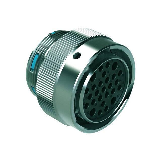

    27 针位圆形连接器 插头外壳 自由悬挂 耦合螺母
AHDM06-24-27SR 数据手册
REVISIONS REV ECO DESCRIPTION DATE BY APPR A1 -- RELEASE NEW DRAWING 18/OCT/18 BROOK TOMMY A2 -- ADD MORE MATERIAL NOTES 25/OCT/18 BROOK TOMMY 37.8 6 SIZE 16 CONTACTS (23 PLACES) MAIN POLARIZING KEYWAY SIZE 12 CONTACTS (4 PLACES) NOTES: UNLESS OTHERWISE SPECIFIED 6 Amphenol AHDM06-24-27SR YYMMDD Ø47.8±0.5 110°REF PLUG, 24 SZ 27 SCO, RD, WIDE THD Ø36.3 TITLE: 110°REF M38X1.5 6g THREAD DWG NO: AHDM06-24-27SR 1. MATERIAL: SHELL: ZINC ALLOY, NICKEL PLATED COUPLING RING: ALUMINUM ALLOY, NICKEL PLATED INSERT AND RETAINING RING: THERMOPLASTIC SEAL: SILICONE RUBBER 2. MODIFICATIONS: THREADED HOUSING; REDUCED DIA. WIRE SEAL A2 SH: RETAINING RING -BLUE UNLESS OTHERWISE SPECIFIED 6 CONTACT SIZE AND WIRE RANGE: CONTACT SIZE MIN. INSUL O.D. MAX. INSUL O.D. 16 1.35 mm (.053in) 2.62 mm (.103 in) 14-20 AWG 2.46 mm (.097 in) 4.01 mm (.158 in) 10-14 AWG 12 TYPICAL WIRE RANGE CURRENT RATING All dimensions are in metric(mm). Tolerances are as follows: PL DEC ±0.30 Fractions ±1/64 PL DEC ±0.15 Angles ±1° PL DEC ±0.08 3) Note reference = X SIGNATURES DRAWN: CHECKED: Amphenol DATE BROOK ORION 25/OCT/18 25/OCT/18 TOMMY 25/OCT/18 Sine Systems - www.amphenol-sine.com 44724 Morley Drive Clinton Township, MI 48036 ENGINEER: APPROVAL: MATERIAL SPECIFICATIONS: CUSTOMER: 13 AMPS PROCESS SPECIFICATIONS: PLUG, 24 SZ 27 SOC, RD, WIDE THD THIS DRAWING IS SUPPLIED FOR INFORMATION ONLY. DESIGN FEATURES, SPECIFICATIONS AND PERFORMANCE DATA SIZE SHOWN HEREON ARE THE PROPERTY OF THE AMPHENOL CORPORATION. NO RIGHTS OF REPRODUCTION ARE IMPLIED. ALL DIMENSIONS ARE SUBJECT TO NORMAL SCALE: MANUFACTURING VARIATIONS. TYPE B C- 25 AMPS NEXT ASS'Y: ITEM NONE DWG NO: REVISION AHDM06-24-27SR SHEET 1 A2 OF 1 1 QUANTITY 1) 2) 1 2 3 OF: AHDM06-24-27SR DESCRIPTION PART NUMBER MATERIALS LIST ( * = SEAL TYPE ) 5. ALL DIMENSIONS ARE FOR REFERENCE USE ONLY. 1 4. MATING PART: AHDM04-24-27P* REV: 3. SPECIFICATIONS: 3.1 OPERATING TEMPERATURE: -55℃ TO +125℃. 3.2 DIELECTRIC WITHSTANDING VOLTAGE: LESS THAN 2 MILLIAMPS CURRENT LEAKAGE @ 1500 VOLTS AC. 3.3 INSULATION RESISTANCE: 1000 MEGOHM MIN @ 25℃. 3.4 MOISTURE RESISTANCE: IP67&IP69K ( MATED CONDITION ). 3.5 MATING CYCLE DURABILITY: 100 CYCLES 3.6 RoHS COMPLIANT A Series™ - Contact Size 16 Options (Works with: AT, ATV, AHD-9, ARC, DuraMate and PanelMate Series) Stamped & Formed Contacts, Sockets & Pins Machined Contacts, Sockets & Pins Size AWG Type AT60-215-1631 Male Contact - Pin, Gold-plated 16 14 Machined AT60-14-0122 Male Contact - Pin, Nickel-plated 16 14-18 Stamped & Formed Part Number Description Size AWG Type Part Number Description AT62-209-1631 Female Contact - Socket, Gold-plated 16 14 Machined AT62-14-0122 Female Contact - Socket, Nickel-plated 16 14-18 Stamped & Formed AT60-215-16141 Male Contact - Pin, Nickel-plated 16 14 Machined AT60-14-0144 Male Contact - Pin, Gold-plated 16 14-18 Stamped & Formed AT62-209-16141 Female Contact - Socket, Nickel-plated 16 14 Machined AT62-14-0144 Female Contact - Socket, Gold-plated 16 14-18 Stamped & Formed AT60-202-1631 Male Contact - Pin, Gold-plated 16 16-20 Machined AT60-16-0122 Male Contact - Pin, Nickel-plated 16 16-18 Stamped & Formed Machined AT62-16-0122 Female Contact - Socket, Nickel-plated 16 16-18 Stamped & Formed Male Contact - Pin, Gold-plated 16 16-18 Stamped & Formed AT62-201-1631 Female Contact - Socket, Gold-plated 16 16-20 AT60-202-16141 Male Contact - Pin, Nickel-plated 16 16-20 Machined AT60-16-0144 AT62-201-16141 Female Contact - Socket, Nickel-plated 16 16-20 Machined AT62-16-0144 Female Contact - Socket, Gold-plated 16 16-18 Stamped & Formed AT60-202-1631-22 Male Contact - Pin, Gold-plated 16 22-24 Machined AT60-16-0622 Male Contact - Pin, Nickel-plated 16 16-20 Stamped & Formed AT62-201-1631-22 Female Contact - Socket, Gold-plated 16 22-24 Machined AT62-16-0622 Female Contact - Socket, Nickel-plated 16 16-20 Stamped & Formed AT60-202-16141-22 Male Contact - Pin, Nickel-plated 16 22-24 Machined AT60-16-0644 Male Contact - Pin, Gold-plated 16 16-20 Stamped & Formed AT62-201-16141-22 Female Contact - Socket, Nickel-plated 16 22-24 Machined AT62-16-0644 Female Contact - Socket, Gold-plated 16 16-20 Stamped & Formed AT60-16-0677 Male Contact - Pin, Tin-plated 16 16-20 Stamped & Formed AT62-16-0677 Female Contact - Socket, Tin-plated 16 16-20 Stamped & Formed Description AT60-16-0822 Male Contact - Pin, Nickel-plated 16 20-22 Stamped & Formed AUTK-16 Hand Crimp Tool, Size 16 AT62-16-0822 Female Contact - Socket, Nickel-plated 16 20-22 Stamped & Formed AUTK-100 Universal Heavy Duty Contact Crimping Tool Kit, Size 12/16/20 AT60-16-0844 Male Contact - Pin, Gold-plated 16 20-22 Stamped & Formed CA-5D12 Universal Hand Crimp Tool, Size 12/16/20 AT62-16-0844 Female Contact - Socket, Gold-plated 16 20-22 Stamped & Formed CA-5E12 Pneumatic Crimp Tool, Size 12/16/20 Tooling - Machined Contacts Part Number Tooling - Stamped & Formed Contacts Contact Removal Tools (For both Machined or Stamped & Formed Contacts) Part Number ATRT-100 AT11-310-1605 Description MFX-3950 Crimp Die - Size 16, 18-20AWG MFX-3953 Crimp Die - Size 16, 16-18AWG MFX-3975 Crimp Die - Size 16, 14-16AWG MFX-3990 Crimp Die - Size 16, 20-22AWG ATT-16-00 Hand Crimp Tool - Size 16, 14-16AWG ATT-16-01 Hand Crimp Tool - Size 16, 18-20AWG ATT-1612-03 Hand Crimp Tool - Size 16, 20-22AWG Contact and Wedgelock Extraction Tool Contact Removal Tool, Plastic, Size 16 Sealing Plugs (For both Machined or Stamped & Formed Contacts) Part Number A114017 A114017-SR AT13-217-1605 AT13-217-1605-SR Description Sealing Plug, Size 16, White Sealing Plug, Size 16, SR01 Series, Black Locking Sealing Plug, Size 16, Grey Locking Sealing Plug, Size 16, SR01 Series, Red Amphenol Sine Systems 44724 Morley Drive, Clinton Township, MI 48036 USA www.amphenol-sine.com 10-2023 A Series™ - Contact Size 12 Options (Works with: AHD-6, ATP, ATHD, DuraMate and PanelMate Series) Machined Contacts, Sockets & Pins Part Number Description Stamped & Formed Contacts, Sockets & Pins Size AWG Type Part Number Description Size AWG Type *AT60-204-12141-10 Male Contact - Pin, Nickel-plated 12 10-12 Machined AT60-12-0244 Male Contact - Pin, Gold-plated 12 10-12 Stamped & Formed *AT62-203-12141-10 Female Contact - Socket, Nickel-plated 12 10-12 Machined AT62-12-0244 Female Contact - Socket, Gold-plated 12 10-12 Stamped & Formed AT60-220-1231 Male Contact - Pin, Gold-plated 12 12-14 Machined AT60-12-0222 Male Contact - Pin, Nickel-plated 12 10-12 Stamped & Formed AT62-210-1231 Female Contact - Socket, Gold-plated 12 12-14 Machined AT62-12-0222 Female Contact - Socket, Nickel-plated 12 10-12 Stamped & Formed AT60-204-12141 Male Contact - Pin, Nickel-plated 12 12-14 Machined AT60-12-0144 Male Contact - Pin, Gold-plated 12 12-14 Stamped & Formed AT62-203-12141 Female Contact - Socket, Nickel-plated 12 12-14 Machined AT62-12-0144 Female Contact - Socket, Gold-plated 12 12-14 Stamped & Formed AT60-12-0166 Male Contact - Pin, Nickel-plated 12 12-14 Stamped & Formed AT62-12-0166 Female Contact - Socket, Nickel-plated 12 12-14 Stamped & Formed Part Number Description *Works with ATP Series only DiagnosticGrade™ Machined Contacts, Sockets & Pins • Smaller AWG for Diagnostic Applications • Gold-plated • Increased Mating Cycles • Cost-effective Part Number Description 65-54749 AT62-210-1231-1820 Size AWG Type Male Contact - DiagnosticGrade™, Pin, Gold-plated 12 20 Machined Female Contact - DiagnosticGrade™, Socket, Gold-plated 12 20 Machined Tooling - Machined Contacts Part Number Tooling - Stamped & Formed Contacts MFX-3973 Crimp Die - Size 12 MFX-3985 Crimp Die - Svize 12, 10-12AWG -02XX Series ATT-12-00 Hand Crimp Tool - Size 12, 12AWG ATT-12-01 Hand Crimp Tool - Size 12, 10AWG Description AUTK-12 Hand Crimp Tool, Size 12 AUTK-100 Universal Heavy Duty Contact Crimping Tool Kit, Size 12/16/20 CA-5D12 Universal Hand Crimp Tool, Size 12/16/20 CA-5E12 Pneumatic Crimp Tool, Size 12/16/20 M300-25A Hand Crimp Tool used with Crimp Locator MFX-3966, Size 12, 10AWG MFX-3966 Contact Locator used with Hand Crimp Tool M300-25A, Size 12, 10AWG Contact Removal Tools (For both Machined or Stamped & Formed Contacts) Part Number ATRT-100 AT11-337-1205 Description Contact and Wedgelock Extraction Tool Contact Removal Tool, Plastic, Size 12 Sealing Plugs (For both Machined or Stamped & Formed Contacts) Part Number A114017 Description Sealing Plug, Size 12, White Amphenol Sine Systems 44724 Morley Drive, Clinton Township, MI 48036 USA www.amphenol-sine.com 10/2023
