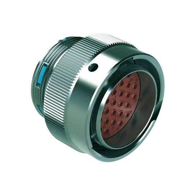

    31 针位圆形连接器 插头外壳 自由悬挂 耦合螺母
AHDM06-24-31PR 数据手册
REVISIONS REV ECO DESCRIPTION DATE BY APPR A1 -- RELEASE NEW DRAWING 18/OCT/18 BROOK TOMMY A2 -- ADD MORE MATERIAL NOTES 25/OCT/18 BROOK TOMMY 37.8 MAIN POLARIZING KEYWAY 6 SIZE 16 CONTACTS (31 PLACES) Amphenol AHDM06-24-31PR YYMMDD Ø47.8±0.5 110°REF PLUG, 24 SZ 31 PIN, RD, WIDE THD Ø36.3 TITLE: 110°REF M38X1.5 6g THREAD DWG NO: NOTES: UNLESS OTHERWISE SPECIFIED AHDM06-24-31PR 1. MATERIAL: SHELL: ZINC ALLOY, NICKEL PLATED COUPLING RING: ALUMINUM ALLOY, NICKEL PLATED INSERT AND RETAINING RING: THERMOPLASTIC SEAL: SILICONE RUBBER 2. MODIFICATIONS: THREADED HOUSING; REDUCED DIA. WIRE SEAL REV: A2 3. SPECIFICATIONS: 3.1 OPERATING TEMPERATURE: -55℃ TO +125℃. 3.2 DIELECTRIC WITHSTANDING VOLTAGE: LESS THAN 2 MILLIAMPS CURRENT LEAKAGE @ 1500 VOLTS AC. 3.3 INSULATION RESISTANCE: 1000 MEGOHM MIN @ 25℃. 3.4 MOISTURE RESISTANCE: IP67&IP69K ( MATED CONDITION ). 3.5 MATING CYCLE DURABILITY: 100 CYCLES 3.6 RoHS COMPLIANT 5. ALL DIMENSIONS ARE FOR REFERENCE USE ONLY. 3) Note reference = 6 CONTACT SIZE AND WIRE RANGE: CONTACT SIZE MIN. INSUL O.D. MAX. INSUL O.D. 16 1.35 mm (.053 in) 2.62 mm (.103 in) All dimensions are in metric(mm). Tolerances are as follows: PL DEC ±0.30 Fractions ±1/64 PL DEC ±0.15 Angles ±1° PL DEC ±0.08 X SIGNATURES DRAWN: CHECKED: CURRENT RATING MATERIAL SPECIFICATIONS: TOMMY 25/OCT/18 Sine Systems - www.amphenol-sine.com 44724 Morley Drive Clinton Township, MI 48036 CUSTOMER: PROCESS SPECIFICATIONS: 14-20 AWG 25/OCT/18 25/OCT/18 ENGINEER: APPROVAL: TYPICAL WIRE RANGE Amphenol DATE BROOK ORION 13 AMPS PLUG, 24 SZ 31 PIN, RD, WIDE THD THIS DRAWING IS SUPPLIED FOR INFORMATION ONLY. DESIGN FEATURES, SPECIFICATIONS AND PERFORMANCE DATA SIZE SHOWN HEREON ARE THE PROPERTY OF THE AMPHENOL CORPORATION. NO RIGHTS OF REPRODUCTION ARE IMPLIED. ALL DIMENSIONS ARE SUBJECT TO NORMAL SCALE: MANUFACTURING VARIATIONS. TYPE B C- NEXT ASS'Y: ITEM NONE DWG NO: REVISION AHDM06-24-31PR SHEET 1 A2 OF 1 1 UNLESS OTHERWISE SPECIFIED 1) 2) 1 2 3 OF: ( * = SEAL TYPE ) 1 AHDM06-24-31PR DESCRIPTION PART NUMBER MATERIALS LIST QUANTITY 4. MATING PART: AHDM04-24-31S* SH: RETAINING RING -BLUE A Series™ - Contact Size 16 Options (Works with: AT, ATV, AHD-9, ARC, DuraMate and PanelMate Series) Stamped & Formed Contacts, Sockets & Pins Machined Contacts, Sockets & Pins Size AWG Type AT60-215-1631 Male Contact - Pin, Gold-plated 16 14 Machined AT60-14-0122 Male Contact - Pin, Nickel-plated 16 14-18 Stamped & Formed Part Number Description Size AWG Type Part Number Description AT62-209-1631 Female Contact - Socket, Gold-plated 16 14 Machined AT62-14-0122 Female Contact - Socket, Nickel-plated 16 14-18 Stamped & Formed AT60-215-16141 Male Contact - Pin, Nickel-plated 16 14 Machined AT60-14-0144 Male Contact - Pin, Gold-plated 16 14-18 Stamped & Formed AT62-209-16141 Female Contact - Socket, Nickel-plated 16 14 Machined AT62-14-0144 Female Contact - Socket, Gold-plated 16 14-18 Stamped & Formed AT60-202-1631 Male Contact - Pin, Gold-plated 16 16-20 Machined AT60-16-0122 Male Contact - Pin, Nickel-plated 16 16-18 Stamped & Formed Machined AT62-16-0122 Female Contact - Socket, Nickel-plated 16 16-18 Stamped & Formed Male Contact - Pin, Gold-plated 16 16-18 Stamped & Formed AT62-201-1631 Female Contact - Socket, Gold-plated 16 16-20 AT60-202-16141 Male Contact - Pin, Nickel-plated 16 16-20 Machined AT60-16-0144 AT62-201-16141 Female Contact - Socket, Nickel-plated 16 16-20 Machined AT62-16-0144 Female Contact - Socket, Gold-plated 16 16-18 Stamped & Formed AT60-202-1631-22 Male Contact - Pin, Gold-plated 16 22-24 Machined AT60-16-0622 Male Contact - Pin, Nickel-plated 16 16-20 Stamped & Formed AT62-201-1631-22 Female Contact - Socket, Gold-plated 16 22-24 Machined AT62-16-0622 Female Contact - Socket, Nickel-plated 16 16-20 Stamped & Formed AT60-202-16141-22 Male Contact - Pin, Nickel-plated 16 22-24 Machined AT60-16-0644 Male Contact - Pin, Gold-plated 16 16-20 Stamped & Formed AT62-201-16141-22 Female Contact - Socket, Nickel-plated 16 22-24 Machined AT62-16-0644 Female Contact - Socket, Gold-plated 16 16-20 Stamped & Formed AT60-16-0677 Male Contact - Pin, Tin-plated 16 16-20 Stamped & Formed AT62-16-0677 Female Contact - Socket, Tin-plated 16 16-20 Stamped & Formed Description AT60-16-0822 Male Contact - Pin, Nickel-plated 16 20-22 Stamped & Formed AUTK-16 Hand Crimp Tool, Size 16 AT62-16-0822 Female Contact - Socket, Nickel-plated 16 20-22 Stamped & Formed AUTK-100 Universal Heavy Duty Contact Crimping Tool Kit, Size 12/16/20 AT60-16-0844 Male Contact - Pin, Gold-plated 16 20-22 Stamped & Formed CA-5D12 Universal Hand Crimp Tool, Size 12/16/20 AT62-16-0844 Female Contact - Socket, Gold-plated 16 20-22 Stamped & Formed CA-5E12 Pneumatic Crimp Tool, Size 12/16/20 Tooling - Machined Contacts Part Number Tooling - Stamped & Formed Contacts Contact Removal Tools (For both Machined or Stamped & Formed Contacts) Part Number ATRT-100 AT11-310-1605 Description MFX-3950 Crimp Die - Size 16, 18-20AWG MFX-3953 Crimp Die - Size 16, 16-18AWG MFX-3975 Crimp Die - Size 16, 14-16AWG MFX-3990 Crimp Die - Size 16, 20-22AWG ATT-16-00 Hand Crimp Tool - Size 16, 14-16AWG ATT-16-01 Hand Crimp Tool - Size 16, 18-20AWG ATT-1612-03 Hand Crimp Tool - Size 16, 20-22AWG Contact and Wedgelock Extraction Tool Contact Removal Tool, Plastic, Size 16 Sealing Plugs (For both Machined or Stamped & Formed Contacts) Part Number A114017 A114017-SR AT13-217-1605 AT13-217-1605-SR Description Sealing Plug, Size 16, White Sealing Plug, Size 16, SR01 Series, Black Locking Sealing Plug, Size 16, Grey Locking Sealing Plug, Size 16, SR01 Series, Red Amphenol Sine Systems 44724 Morley Drive, Clinton Township, MI 48036 USA www.amphenol-sine.com 10-2023
