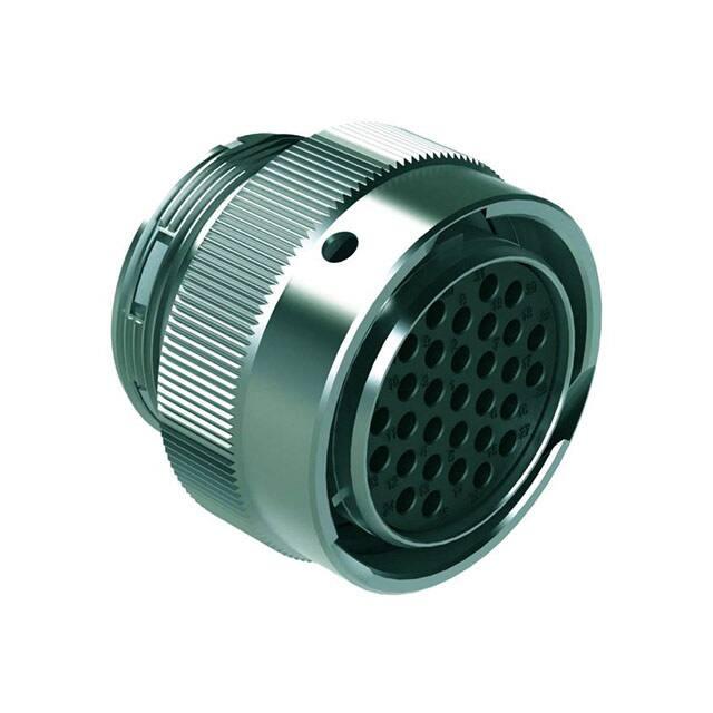

    CONN PLUG HSNG FMALE 31POS INLIN
AHDM06-24-31ST 数据手册
REVISIONS REV ECO DESCRIPTION DATE BY APPR A1 -- RELEASE NEW DRAWING 18/OCT/18 BROOK TOMMY A2 -- ADD MORE MATERIAL NOTES 25/OCT/18 BROOK TOMMY 37.8 MAIN POLARIZING KEYWAY SIZE 16 CONTACTS (31 PLACES) 110°REF PLUG, 24 SZ 31 SOC, THIN, WIDE THD Ø47.8±0.5 TITLE: Ø36.3 110°REF Amphenol AHDM06-24-31ST YYMMDD 6 M38X1.5 6g THREAD DWG NO: NOTES: UNLESS OTHERWISE SPECIFIED AHDM06-24-31ST 1. MATERIAL: SHELL: ZINC ALLOY, NICKEL PLATED COUPLING RING: ALUMINUM ALLOY, NICKEL PLATED INSERT AND RETAINING RING: THERMOPLASTIC SEAL: SILICONE RUBBER 2. MODIFICATIONS: THREADED HOUSING; THIN WALL DIA. WIRE SEAL A2 SH: RETAINING RING -GREY 6 CONTACT SIZE AND WIRE RANGE: All dimensions are in metric(mm). Tolerances are as follows: PL DEC ±0.30 Fractions ±1/64 PL DEC ±0.15 Angles ±1° PL DEC ±0.08 3) Note reference = CONTACT SIZE MIN. INSUL O.D. MAX. INSUL O.D. TYPICAL WIRE RANGE CURRENT RATING 16 2.23 mm (.088 in) 2.69 mm (.106 in) 14-20 AWG 13 AMPS X SIGNATURES DRAWN: CHECKED: 25/OCT/18 25/OCT/18 TOMMY 25/OCT/18 Sine Systems - www.amphenol-sine.com 44724 Morley Drive Clinton Township, MI 48036 ENGINEER: APPROVAL: MATERIAL SPECIFICATIONS: CUSTOMER: PROCESS SPECIFICATIONS: Amphenol DATE BROOK ORION PLUG, 24 SZ 31 SOC, THIN, WIDE THD THIS DRAWING IS SUPPLIED FOR INFORMATION ONLY. DESIGN FEATURES, SPECIFICATIONS AND PERFORMANCE DATA SIZE SHOWN HEREON ARE THE PROPERTY OF THE AMPHENOL CORPORATION. NO RIGHTS OF REPRODUCTION ARE IMPLIED. ALL DIMENSIONS ARE SUBJECT TO NORMAL SCALE: MANUFACTURING VARIATIONS. TYPE B C- NEXT ASS'Y: ITEM NONE DWG NO: REVISION AHDM06-24-31ST SHEET 1 A2 OF 1 1 UNLESS OTHERWISE SPECIFIED 1) 2) 1 2 3 5. ALL DIMENSIONS ARE FOR REFERENCE USE ONLY. OF: AHDM06-24-31ST DESCRIPTION PART NUMBER MATERIALS LIST QUANTITY ( * = SEAL TYPE ) 1 4. MATING PART: AHDM04-24-31P* REV: 3. SPECIFICATIONS: 3.1 OPERATING TEMPERATURE: -55℃ TO +125℃. 3.2 DIELECTRIC WITHSTANDING VOLTAGE: LESS THAN 2 MILLIAMPS CURRENT LEAKAGE @ 1500 VOLTS AC. 3.3 INSULATION RESISTANCE: 1000 MEGOHM MIN @ 25℃. 3.4 MOISTURE RESISTANCE: IP67&IP69K ( MATED CONDITION ). 3.5 MATING CYCLE DURABILITY: 100 CYCLES 3.6 RoHS COMPLIANT A Series™ - Contact Size 16 Options (Works with: AT, ATV, AHD-9, ARC, DuraMate and PanelMate Series) Stamped & Formed Contacts, Sockets & Pins Machined Contacts, Sockets & Pins Size AWG Type AT60-215-1631 Male Contact - Pin, Gold-plated 16 14 Machined AT60-14-0122 Male Contact - Pin, Nickel-plated 16 14-18 Stamped & Formed Part Number Description Size AWG Type Part Number Description AT62-209-1631 Female Contact - Socket, Gold-plated 16 14 Machined AT62-14-0122 Female Contact - Socket, Nickel-plated 16 14-18 Stamped & Formed AT60-215-16141 Male Contact - Pin, Nickel-plated 16 14 Machined AT60-14-0144 Male Contact - Pin, Gold-plated 16 14-18 Stamped & Formed AT62-209-16141 Female Contact - Socket, Nickel-plated 16 14 Machined AT62-14-0144 Female Contact - Socket, Gold-plated 16 14-18 Stamped & Formed AT60-202-1631 Male Contact - Pin, Gold-plated 16 16-20 Machined AT60-16-0122 Male Contact - Pin, Nickel-plated 16 16-18 Stamped & Formed Machined AT62-16-0122 Female Contact - Socket, Nickel-plated 16 16-18 Stamped & Formed Male Contact - Pin, Gold-plated 16 16-18 Stamped & Formed AT62-201-1631 Female Contact - Socket, Gold-plated 16 16-20 AT60-202-16141 Male Contact - Pin, Nickel-plated 16 16-20 Machined AT60-16-0144 AT62-201-16141 Female Contact - Socket, Nickel-plated 16 16-20 Machined AT62-16-0144 Female Contact - Socket, Gold-plated 16 16-18 Stamped & Formed AT60-202-1631-22 Male Contact - Pin, Gold-plated 16 22-24 Machined AT60-16-0622 Male Contact - Pin, Nickel-plated 16 16-20 Stamped & Formed AT62-201-1631-22 Female Contact - Socket, Gold-plated 16 22-24 Machined AT62-16-0622 Female Contact - Socket, Nickel-plated 16 16-20 Stamped & Formed AT60-202-16141-22 Male Contact - Pin, Nickel-plated 16 22-24 Machined AT60-16-0644 Male Contact - Pin, Gold-plated 16 16-20 Stamped & Formed AT62-201-16141-22 Female Contact - Socket, Nickel-plated 16 22-24 Machined AT62-16-0644 Female Contact - Socket, Gold-plated 16 16-20 Stamped & Formed AT60-16-0677 Male Contact - Pin, Tin-plated 16 16-20 Stamped & Formed AT62-16-0677 Female Contact - Socket, Tin-plated 16 16-20 Stamped & Formed Description AT60-16-0822 Male Contact - Pin, Nickel-plated 16 20-22 Stamped & Formed AUTK-16 Hand Crimp Tool, Size 16 AT62-16-0822 Female Contact - Socket, Nickel-plated 16 20-22 Stamped & Formed AUTK-100 Universal Heavy Duty Contact Crimping Tool Kit, Size 12/16/20 AT60-16-0844 Male Contact - Pin, Gold-plated 16 20-22 Stamped & Formed CA-5D12 Universal Hand Crimp Tool, Size 12/16/20 AT62-16-0844 Female Contact - Socket, Gold-plated 16 20-22 Stamped & Formed CA-5E12 Pneumatic Crimp Tool, Size 12/16/20 Tooling - Machined Contacts Part Number Tooling - Stamped & Formed Contacts Contact Removal Tools (For both Machined or Stamped & Formed Contacts) Part Number ATRT-100 AT11-310-1605 Description MFX-3950 Crimp Die - Size 16, 18-20AWG MFX-3953 Crimp Die - Size 16, 16-18AWG MFX-3975 Crimp Die - Size 16, 14-16AWG MFX-3990 Crimp Die - Size 16, 20-22AWG ATT-16-00 Hand Crimp Tool - Size 16, 14-16AWG ATT-16-01 Hand Crimp Tool - Size 16, 18-20AWG ATT-1612-03 Hand Crimp Tool - Size 16, 20-22AWG Contact and Wedgelock Extraction Tool Contact Removal Tool, Plastic, Size 16 Sealing Plugs (For both Machined or Stamped & Formed Contacts) Part Number A114017 A114017-SR AT13-217-1605 AT13-217-1605-SR Description Sealing Plug, Size 16, White Sealing Plug, Size 16, SR01 Series, Black Locking Sealing Plug, Size 16, Grey Locking Sealing Plug, Size 16, SR01 Series, Red Amphenol Sine Systems 44724 Morley Drive, Clinton Township, MI 48036 USA www.amphenol-sine.com 10-2023
