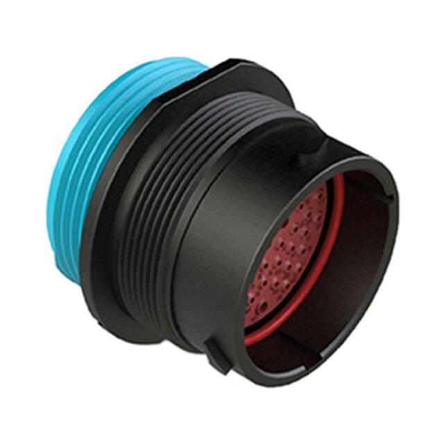

    47(Radsok) 针位圆形连接器 插座外壳 面板安装
AHDP04-24-47PR-WTA 数据手册
REVISIONS REV MAIN POLARIZING KEYWAY 41.5 ECO DESCRIPTION DATE BY APPR RELEASE NEW DRAWING 28JUL16 JONY TOMMY Change the appearance of the retaining ring 27JUN18 KASOON TOMMY A1 C0870S A2 10.7 SIZE 16 CONTACTS 6 (5 PLACES) 12.8 2.6 110°REF 110°REF A HD P0 4 -2 4 - 4 7 PR W RECEP.,24-47 POS, PIN CONT.,REDUCED DIA. SEAL, AHDP 40.1 TITLE: Y Y MMD D Am phenol | 47.6 TA Ø50.8 NOTES: UNLESS OTHERWISE SPECIFIED 1. MATERIAL: HOUSING: THERMOPLASTIC; BLACK SEAL: SILICONE RUBBER 1 11/16-18 UNEF THREAD SIZE 20 CONTACTS 6 (42 PLACES) 1 11/16-12 UN THREAD DWG NO: 2. MODIFICATIONS: THREADED ADAPTER; REDUCED DIA. WIRE SEAL THREADED ADAPTER - BLUE REV: A2 41.45 +0.2 -0 SH: ( * = SEAL TYPE ) 1 4. MATING PART: AHDP06-24-47S* Ø43.08±0.12 AHDP04-24-47PR-WTA 3. SPECIFICATIONS: 3.1 OPERATING TEMPERATURE: -55℃ TO +125℃. 3.2 DIELECTRIC WITHSTANDING VOLTAGE: LESS THAN 2 MILLIAMPS CURRENT LEAKAGE @ 1500 VOLTS AC. 3.3 INSULATION RESISTANCE: 1000 MEGOHM MIN @ 25℃. 3.4 MOISTURE RESISTANCE: IP67&IP69K ( MATED CONDITION ). 3.5 MATING CYCLE DURABILITY: 100 CYCLES 3.6 RoHS COMPLIANT QUANTITY AHDP04-24-47PR-WTA DESCRIPTION PART NUMBER MATERIALS LIST UNLESS OTHERWISE SPECIFIED CONTACT SIZE MIN. INSUL O.D. MAX. INSUL O.D. TYPICAL WIRE RANGE CURRENT RATING RECOMMENDED PANEL MOUNTING HOLE 20 1.02 mm (.040 in) 2.10 mm (.083 in) 16-22 AWG 7.5 AMPS 16 1.35 mm (.053in) 2.62 mm (.103 in) RECOMMENDED PANEL THICKNESS:1.6 TO 4.7MM 14-20 AWG 13 AMPS 1) 2) 1 2 3 All dimensions are in metric(mm). Tolerances are as follows: PL DEC ±0.30 Fractions ±1/64 PL DEC ±0.15 Angles ±1° PL DEC ±0.08 3) Note reference = X SIGNATURES DRAWN: CHECKED: Amphenol DATE KASOON ORION.LI 27JUN18 27JUN18 TOMMY.XIE 27JUN18 Sine Systems - www.amphenol-sine.com 44724 Morley Drive Clinton Township, MI 48036 ENGINEER: APPROVAL: MATERIAL SPECIFICATIONS: CUSTOMER: PROCESS SPECIFICATIONS: ITEM THIS DRAWING IS SUPPLIED FOR INFORMATION ONLY. DESIGN FEATURES, SPECIFICATIONS AND PERFORMANCE DATA SIZE SHOWN HEREON ARE THE PROPERTY OF THE AMPHENOL CORPORATION. NO RIGHTS OF REPRODUCTION ARE IMPLIED. ALL DIMENSIONS ARE SUBJECT TO NORMAL SCALE: MANUFACTURING VARIATIONS. RECEP.,24-47 POS, PIN CONTACT REDUCED DIA. SEAL, AHDP SERIES TYPE DWG NO: REVISION B C- AHDP04-24-47PR-WTA A2 NEXT ASS'Y: NONE SHEET 1 OF 1 1 6 CONTACT SIZE AND WIRE RANGE: OF: 5. ALL DIMENSIONS ARE FOR REFERENCE USE ONLY. A Series™ - Contact Size 20 Options (Works with: ATM, DuraMate and PanelMate Series) Stamped & Formed Contacts, Sockets & Pins Machined Contacts, Sockets & Pins Size AWG Type AT60-010-2031 Male Contact - Pin, Gold-plated 20 16-18 Machined AT60-20-0144 Male Contact - Pin, Gold-plated 20 16-22 Stamped & Formed AT62-005-20141 Female Contact - Socket, Gold-plated 20 16-18 Machined AT62-20-0144 Female Contact - Socket, Gold-plated 20 16-22 Stamped & Formed AT60-010-20141 Male Contact - Pin, Nickel-plated 20 16-18 Machined AT60-20-0244 Male Contact - Socket, Gold-plated 20 16-22 Stamped & Formed AT62-005-2031 Female Contact - Socket, Nickel-plated 20 16-18 Machined AT62-20-0244 Female Contact - Socket, Gold-plated 20 16-22 Stamped & Formed AT60-202-2031 Male Contact - Pin, Gold-plated 20 20-22 Machined AT60-20-0122 Male Contact - Pin, Nickel-plated 20 16-22 Stamped & Formed AT62-201-2031 Female Contact - Socket, Gold-plated 20 20-22 Machined AT62-20-0122 Female Contact - Socket, Nickel-plated 20 16-22 Stamped & Formed AT60-202-20141 Male Contact - Pin, Nickel-plated 20 20-22 Machined AT60-20-0222 Male Contact - Socket, Nickel-plated 20 16-22 Stamped & Formed Machined AT62-20-0222 Female Contact - Socket, Nickel-plated 20 16-22 Stamped & Formed AT60-20-0277 Male Contact - Socket, Tin-plated 20 16-22 Stamped & Formed AT62-20-0277 Female Contact - Socket, Tin-plated 20 16-22 Stamped & Formed Description AT60-20-0422 Male Contact - Socket, Nickel-plated 20 20-22 Stamped & Formed AUTK-20 Hand Crimp Tool, Size 20 AT62-20-0444 Female Contact - Socket, Gold-plated 20 20-22 Stamped & Formed AUTK-100 Universal Heavy Duty Contact Crimping Tool Kit, Size 12/16/20 CA-5D12 Universal Hand Crimp Tool, Size 12/16/20 CA-5E12 Pneumatic Crimp Tool, Size 12/16/20 Part Number AT62-201-20141 Description Female Contact - Socket, Nickel-plated Size AWG Type Part Number Description 20 20-22 Tooling - Machined Contacts Part Number Tooling - Stamped & Formed Contacts MFX-3974 Crimp Die - Size 20 MFX-3976 Crimp Die - Size 20 (20-22AWG -04XX Series) MFX-3978 Crimp Die - Size 20 (20-22AWG -02XX Series) ATT-20-00 Hand Crimp Tool - Size 20 (20AWG) Contact Removal Tools (For both Machined or Stamped & Formed Contacts) Part Number ATRT-100 AT11-240-2005 Description Contact and Wedgelock Extraction Tool Contact Removal Tool, Plastic, Size 20 Sealing Plugs (For both Machined or Stamped & Formed Contacts) Part Number AT13-204-2005 Description Sealing Plug, Size 20, White AT13-204-2005-SR Sealing Plug, Size 20, SR01 Series, Black ATM13-217-2005 Locking Sealing Plug, Size 20, Grey ATM13-217-2005-SR Locking Sealing Plug, Size 20, SR01 Series, Blue Amphenol Sine Systems 44724 Morley Drive, Clinton Township, MI 48036 USA www.amphenol-sine.com 10/2023 A Series™ - Contact Size 16 Options (Works with: AT, ATV, AHD-9, ARC, DuraMate and PanelMate Series) Stamped & Formed Contacts, Sockets & Pins Machined Contacts, Sockets & Pins Size AWG Type AT60-215-1631 Male Contact - Pin, Gold-plated 16 14 Machined AT60-14-0122 Male Contact - Pin, Nickel-plated 16 14-18 Stamped & Formed Part Number Description Size AWG Type Part Number Description AT62-209-1631 Female Contact - Socket, Gold-plated 16 14 Machined AT62-14-0122 Female Contact - Socket, Nickel-plated 16 14-18 Stamped & Formed AT60-215-16141 Male Contact - Pin, Nickel-plated 16 14 Machined AT60-14-0144 Male Contact - Pin, Gold-plated 16 14-18 Stamped & Formed AT62-209-16141 Female Contact - Socket, Nickel-plated 16 14 Machined AT62-14-0144 Female Contact - Socket, Gold-plated 16 14-18 Stamped & Formed AT60-202-1631 Male Contact - Pin, Gold-plated 16 16-20 Machined AT60-16-0122 Male Contact - Pin, Nickel-plated 16 16-18 Stamped & Formed Machined AT62-16-0122 Female Contact - Socket, Nickel-plated 16 16-18 Stamped & Formed Male Contact - Pin, Gold-plated 16 16-18 Stamped & Formed AT62-201-1631 Female Contact - Socket, Gold-plated 16 16-20 AT60-202-16141 Male Contact - Pin, Nickel-plated 16 16-20 Machined AT60-16-0144 AT62-201-16141 Female Contact - Socket, Nickel-plated 16 16-20 Machined AT62-16-0144 Female Contact - Socket, Gold-plated 16 16-18 Stamped & Formed AT60-202-1631-22 Male Contact - Pin, Gold-plated 16 22-24 Machined AT60-16-0622 Male Contact - Pin, Nickel-plated 16 16-20 Stamped & Formed AT62-201-1631-22 Female Contact - Socket, Gold-plated 16 22-24 Machined AT62-16-0622 Female Contact - Socket, Nickel-plated 16 16-20 Stamped & Formed AT60-202-16141-22 Male Contact - Pin, Nickel-plated 16 22-24 Machined AT60-16-0644 Male Contact - Pin, Gold-plated 16 16-20 Stamped & Formed AT62-201-16141-22 Female Contact - Socket, Nickel-plated 16 22-24 Machined AT62-16-0644 Female Contact - Socket, Gold-plated 16 16-20 Stamped & Formed AT60-16-0677 Male Contact - Pin, Tin-plated 16 16-20 Stamped & Formed AT62-16-0677 Female Contact - Socket, Tin-plated 16 16-20 Stamped & Formed Description AT60-16-0822 Male Contact - Pin, Nickel-plated 16 20-22 Stamped & Formed AUTK-16 Hand Crimp Tool, Size 16 AT62-16-0822 Female Contact - Socket, Nickel-plated 16 20-22 Stamped & Formed AUTK-100 Universal Heavy Duty Contact Crimping Tool Kit, Size 12/16/20 AT60-16-0844 Male Contact - Pin, Gold-plated 16 20-22 Stamped & Formed CA-5D12 Universal Hand Crimp Tool, Size 12/16/20 AT62-16-0844 Female Contact - Socket, Gold-plated 16 20-22 Stamped & Formed CA-5E12 Pneumatic Crimp Tool, Size 12/16/20 Tooling - Machined Contacts Part Number Tooling - Stamped & Formed Contacts Contact Removal Tools (For both Machined or Stamped & Formed Contacts) Part Number ATRT-100 AT11-310-1605 Description MFX-3950 Crimp Die - Size 16, 18-20AWG MFX-3953 Crimp Die - Size 16, 16-18AWG MFX-3975 Crimp Die - Size 16, 14-16AWG MFX-3990 Crimp Die - Size 16, 20-22AWG ATT-16-00 Hand Crimp Tool - Size 16, 14-16AWG ATT-16-01 Hand Crimp Tool - Size 16, 18-20AWG ATT-1612-03 Hand Crimp Tool - Size 16, 20-22AWG Contact and Wedgelock Extraction Tool Contact Removal Tool, Plastic, Size 16 Sealing Plugs (For both Machined or Stamped & Formed Contacts) Part Number A114017 A114017-SR AT13-217-1605 AT13-217-1605-SR Description Sealing Plug, Size 16, White Sealing Plug, Size 16, SR01 Series, Black Locking Sealing Plug, Size 16, Grey Locking Sealing Plug, Size 16, SR01 Series, Red Amphenol Sine Systems 44724 Morley Drive, Clinton Township, MI 48036 USA www.amphenol-sine.com 10-2023
