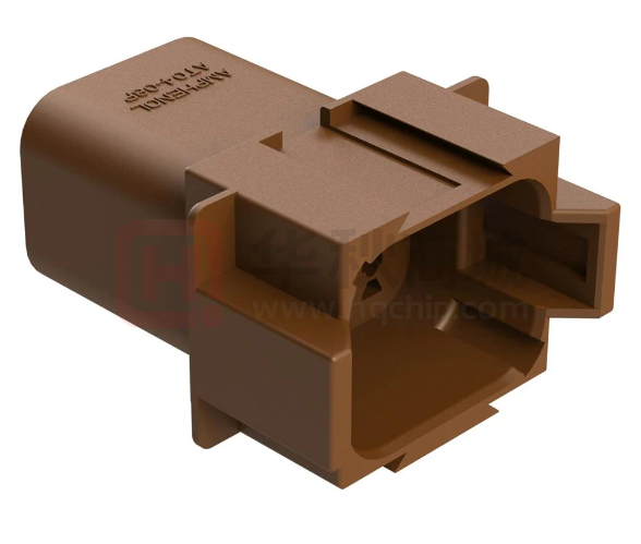

AT04-08PD-RD01
AT04-08PD-RD01
    AMPHENOL(安费诺)
    Housings
    胶壳 棕色 2排 针位数:8 13A
AT04-08PD-RD01 数据手册
REVISIONS REV ECO A3 - DESCRIPTION RELEASE NEW DRAWING FORMAT DATE BY APPR 12NOV13 DRP - 36.5 TITLE: RECEPTACLE, 8 PIN, AT SERIES, KEYED, REDUCED DIAMETER SEAL 7 REDUCED DIAMETER WIRE SEAL REQUIRES CONTACT RETENTION WEDGE AW8P 23.7 1 KEYWAY (2) PLACES DWG NO: AT04-08PX-RDXXX NOTES: UNLESS OTHERWISE SPECIFIED 1 SEE SHEET 2 FOR KEY ARRANGEMENTS AND COLORS. REV: 2. MATERIAL: HOUSING: THERMOPLASTIC SEAL: SILICONE RUBBER REFER TO SHEET 2 FOR AVAILABLE CONNECTOR COLORS SH: 3. MODIFICATIONS: REDUCED DIAMETER WIRE SEAL A3 1 1 6. ALL DIMENSIONS ARE FOR REFERENCE USE ONLY. SEE SHEET 2 DESCRIPTION PART NUMBER MATERIALS LIST QUANTITY UNLESS OTHERWISE SPECIFIED 1) All dimensions are in metric(mm). 2) Tolerances are as follows: 1 PL DEC ±0.30 Fractions ±1/64 2 PL DEC ±0.15 Angles ±1° 3 PL DEC ±0.08 7 CONTACT SIZE AND REAR SEAL WIRE RANGE: CONTACT SIZE MIN. INSUL O.D. MAX. INSUL O.D. TYPICAL WIRE RANGE 16 1.35 mm (.053 in) 3.05 mm (.120 in) 14 - 20 AWG 3) Note reference = X SIGNATURES DRAWN: D.PARKS ITEM Amphenol DATE 12NOV13 CHECKED: Sine Systems - www.amphenol-sine.com 44724 Morley Drive Clinton Township, MI 48036 ENGINEER: APPROVAL: MATERIAL SPECIFICATIONS: CUSTOMER: PROCESS SPECIFICATIONS: THIS DRAWING IS SUPPLIED FOR INFORMATION ONLY. DESIGN FEATURES, SPECIFICATIONS AND PERFORMANCE DATA SIZE SHOWN HEREON ARE THE PROPERTY OF THE AMPHENOL CORPORATION. NO RIGHTS OF REPRODUCTION ARE IMPLIED. ALL DIMENSIONS ARE SUBJECT TO NORMAL SCALE: MANUFACTURING VARIATIONS. RECEPTACLE, 8 PIN, AT SERIES, KEYED, REDUCED DIAMETER SEAL TYPE B C- NEXT ASS'Y: NONE DWG NO: REVISION AT04-08PX-RDXXX SHEET 1 A3 OF 2 2 5. MATING PART: AT06-08SX* PLUG ( X = A,B,C,D KEYS; * = MODIFICATIONS AND COLORS ) 45.7 OF: 4. SPECIFICATIONS: 4.1 CURRENT RATING: 13 AMPS 4.2 OPERATING TEMPERATURE: -55°C TO +125°C 4.3 DIELECTRIC WITHSTANDING VOLTAGE: LESS THAN 2 MILLIAMPS CURRENT LEAKAGE @ 1500 VOLTS AC. 4.4 INSULATION RESISTANCE: 1000 MEGOHMS MIN @ 25°C. 4.5 MOISTURE RESISTANCE: IP67 ( MATED CONDITION ) 4.6 MATING CYCLE DURABILITY: 100 CYCLES 4.7 RoHS COMPLIANT REVISIONS REV P/N AT04-08PB-RD01 KEY-B CONFIGURATION STANDARD COLOR: BLACK DESCRIPTION DATE BY APPR P/N AT04-08PD-RD01 KEY-D CONFIGURATION STANDARD COLOR: BROWN P/N AT04-08PC-RD01 KEY-C CONFIGURATION STANDARD COLOR: GREEN TITLE: P/N AT04-08PA-RD01 KEY-A CONFIGURATION STANDARD COLOR: GREY ECO KEYWAY (2) PLACES RECEPTACLE, 8 PIN, AT SERIES, KEYED, REDUCED DIAMETER SEAL KEYWAY (2) PLACES KEYWAY (2) PLACES COLOR GREY * BLACK PART NUMBER AT04-08PA-RD01 AT04-08PA-RDBLK KEY-B CONFIGURATION COLOR GREY BROWN AT04-08PA-RDBRN BROWN PART NUMBER PART NUMBER COLOR AT04-08PB-RDGRY GREY AT04-08PC-RDGRY GREY AT04-08PD-RDGRY AT04-08PB-RD01 BLACK AT04-08PC-RDBLK BLACK AT04-08PD-RDBLK AT04-08PC-RD01 GREEN AT04-08PD-RDGRN AT04-08PB-RDGRN AT04-08PB-RDBRN GREEN * BROWN AT04-08PC-RDBRN A3 AT04-08PA-RDGRN COLOR KEY-D CONFIGURATION REV: GREEN * BLACK GREEN PART NUMBER KEY-C CONFIGURATION AT04-08PX-RDXXX KEY-A CONFIGURATION DWG NO: KEYWAY (2) PLACES AT04-08PD-RD01 SH: * BROWN 2 OTHER COLORS SHOWN ARE AVAILABLE VIA SPECIAL ORDER. DESCRIPTION PART NUMBER MATERIALS LIST QUANTITY UNLESS OTHERWISE SPECIFIED 1) All dimensions are in metric(mm). 2) Tolerances are as follows: 1 PL DEC ±0.30 Fractions ±1/64 2 PL DEC ±0.15 Angles ±1° 3 PL DEC ±0.08 3) Note reference = X SIGNATURES DRAWN: D.PARKS ITEM Amphenol DATE 12NOV13 CHECKED: Sine Systems - www.amphenol-sine.com 44724 Morley Drive Clinton Township, MI 48036 ENGINEER: APPROVAL: MATERIAL SPECIFICATIONS: CUSTOMER: PROCESS SPECIFICATIONS: THIS DRAWING IS SUPPLIED FOR INFORMATION ONLY. DESIGN FEATURES, SPECIFICATIONS AND PERFORMANCE DATA SIZE SHOWN HEREON ARE THE PROPERTY OF THE AMPHENOL CORPORATION. NO RIGHTS OF REPRODUCTION ARE IMPLIED. ALL DIMENSIONS ARE SUBJECT TO NORMAL SCALE: MANUFACTURING VARIATIONS. RECEPTACLE, 8 PIN, AT SERIES, KEYED, REDUCED DIAMETER SEAL TYPE B C- NEXT ASS'Y: NONE DWG NO: REVISION AT04-08PX-RDXXX SHEET 2 A3 OF 2 2 AN ASTERISKS ( * ) PLACED BEFORE THE COLOR DENOTES THE STANDARD MOLDED COLOR OF THE CONNECTORS SHOWN ABOVE. OF: NOTE: A Series™ - Contact Size 16 Options (Works with: AT, ATV, AHD-9, ARC, DuraMate and PanelMate Series) Stamped & Formed Contacts, Sockets & Pins Machined Contacts, Sockets & Pins Size AWG Type AT60-215-1631 Male Contact - Pin, Gold-plated 16 14 Machined AT60-14-0122 Male Contact - Pin, Nickel-plated 16 14-18 Stamped & Formed Part Number Description Size AWG Type Part Number Description AT62-209-1631 Female Contact - Socket, Gold-plated 16 14 Machined AT62-14-0122 Female Contact - Socket, Nickel-plated 16 14-18 Stamped & Formed AT60-215-16141 Male Contact - Pin, Nickel-plated 16 14 Machined AT60-14-0144 Male Contact - Pin, Gold-plated 16 14-18 Stamped & Formed AT62-209-16141 Female Contact - Socket, Nickel-plated 16 14 Machined AT62-14-0144 Female Contact - Socket, Gold-plated 16 14-18 Stamped & Formed AT60-202-1631 Male Contact - Pin, Gold-plated 16 16-20 Machined AT60-16-0122 Male Contact - Pin, Nickel-plated 16 16-18 Stamped & Formed Machined AT62-16-0122 Female Contact - Socket, Nickel-plated 16 16-18 Stamped & Formed Male Contact - Pin, Gold-plated 16 16-18 Stamped & Formed AT62-201-1631 Female Contact - Socket, Gold-plated 16 16-20 AT60-202-16141 Male Contact - Pin, Nickel-plated 16 16-20 Machined AT60-16-0144 AT62-201-16141 Female Contact - Socket, Nickel-plated 16 16-20 Machined AT62-16-0144 Female Contact - Socket, Gold-plated 16 16-18 Stamped & Formed AT60-202-1631-22 Male Contact - Pin, Gold-plated 16 22-24 Machined AT60-16-0622 Male Contact - Pin, Nickel-plated 16 16-20 Stamped & Formed AT62-201-1631-22 Female Contact - Socket, Gold-plated 16 22-24 Machined AT62-16-0622 Female Contact - Socket, Nickel-plated 16 16-20 Stamped & Formed AT60-202-16141-22 Male Contact - Pin, Nickel-plated 16 22-24 Machined AT60-16-0644 Male Contact - Pin, Gold-plated 16 16-20 Stamped & Formed AT62-201-16141-22 Female Contact - Socket, Nickel-plated 16 22-24 Machined AT62-16-0644 Female Contact - Socket, Gold-plated 16 16-20 Stamped & Formed AT60-16-0677 Male Contact - Pin, Tin-plated 16 16-20 Stamped & Formed AT62-16-0677 Female Contact - Socket, Tin-plated 16 16-20 Stamped & Formed Description AT60-16-0822 Male Contact - Pin, Nickel-plated 16 20-22 Stamped & Formed AUTK-16 Hand Crimp Tool, Size 16 AT62-16-0822 Female Contact - Socket, Nickel-plated 16 20-22 Stamped & Formed AUTK-100 Universal Heavy Duty Contact Crimping Tool Kit, Size 12/16/20 AT60-16-0844 Male Contact - Pin, Gold-plated 16 20-22 Stamped & Formed CA-5D12 Universal Hand Crimp Tool, Size 12/16/20 AT62-16-0844 Female Contact - Socket, Gold-plated 16 20-22 Stamped & Formed CA-5E12 Pneumatic Crimp Tool, Size 12/16/20 Tooling - Machined Contacts Part Number Tooling - Stamped & Formed Contacts Contact Removal Tools (For both Machined or Stamped & Formed Contacts) Part Number ATRT-100 AT11-310-1605 Description MFX-3950 Crimp Die - Size 16, 18-20AWG MFX-3953 Crimp Die - Size 16, 16-18AWG MFX-3975 Crimp Die - Size 16, 14-16AWG MFX-3990 Crimp Die - Size 16, 20-22AWG ATT-16-00 Hand Crimp Tool - Size 16, 14-16AWG ATT-16-01 Hand Crimp Tool - Size 16, 18-20AWG ATT-1612-03 Hand Crimp Tool - Size 16, 20-22AWG Contact and Wedgelock Extraction Tool Contact Removal Tool, Plastic, Size 16 Sealing Plugs (For both Machined or Stamped & Formed Contacts) Part Number A114017 A114017-SR AT13-217-1605 AT13-217-1605-SR Description Sealing Plug, Size 16, White Sealing Plug, Size 16, SR01 Series, Black Locking Sealing Plug, Size 16, Grey Locking Sealing Plug, Size 16, SR01 Series, Red Amphenol Sine Systems 44724 Morley Drive, Clinton Township, MI 48036 USA www.amphenol-sine.com 10-2023
