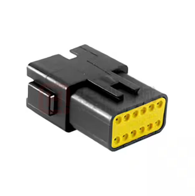

    胶壳 黑色 2排 针位数:12 13A
AT04-12PB-RD01 数据手册
REVISIONS REV ECO A3 A4 C1403S DESCRIPTION DATE BY RELEASE NEW DRAWING FORMAT 12NOV13 DRP UPDATE THE APPEARANCE 16NOV21 LOUIE APPR TOMMY 40.5±0.5 TITLE: REQUIRES CONTACT RETENTION WEDGE AW12P 7 REDUCED DIAMETER WIRE SEAL 22.2±0.5 1 KEYWAY (3) PLACES DWG NO: 1 REFER TO SHEET 2 FOR AVAILABLE CONNECTOR COLORS NOTES: UNLESS OTHERWISE SPECIFIED 1 SEE SHEET 2 FOR KEY ARRANGEMENTS AND COLORS. REV: 2. MATERIAL: HOUSING: THERMOPLASTIC SEAL: SILICONE RUBBER SH: 3. MODIFICATIONS: REDUCED DIAMETER WIRE SEAL 5. MATING PART: AT06-12SX* PLUG ( X = A,B,C,D KEYS; * = MODIFICATIONS AND COLORS ) 6. ALL DIMENSIONS ARE FOR REFERENCE USE ONLY. 50.6±0.5 SEE SHEET 2 PART NUMBER OF: 4. SPECIFICATIONS: 4.1 CURRENT RATING: 13 AMPS 4.2 OPERATING TEMPERATURE: -55°C TO +125°C 4.3 DIELECTRIC WITHSTANDING VOLTAGE: LESS THAN 2 MILLIAMPS CURRENT LEAKAGE @ 1500 VOLTS AC. 4.4 INSULATION RESISTANCE: 1000 MEGOHMS MIN @ 25°C. 4.5 MOISTURE RESISTANCE: IP69K&IP68 ( 1M OF WATER FOR A PERIOD OF 24 HOURS, MATED CONDITION ) 4.6 MATING CYCLE DURABILITY: 100 CYCLES 4.7 RoHS COMPLIANT REF: DT04-12PA-CE08 、 DT04-12PB-CE08 、 DT04-12PC-CE08 、DT04-12PD-CE08 DESCRIPTION QUANTITY DRAWN: CHECKED: X 7 CONTACT SIZE AND REAR SEAL WIRE RANGE: Sine Systems - www.amphenol-sine.com 44724 Morley Drive Clinton Township, MI 48036 ENGINEER: APPROVAL: MATERIAL SPECIFICATIONS: CONTACT MIN. INSUL MAX. INSUL TYPICAL SIZE O.D. O.D. WIRE RANGE 16 1.35 mm (.053 in) 3.05 mm (.120 in) CUSTOMER: WEIGHT:17.7g PROCESS SPECIFICATIONS: 14 - 20 AWG RECEPTACLE, 12 PIN, AT SERIES, KEYED, REDUCED DIAMETER WIRE SEAL THIS DRAWING IS SUPPLIED FOR INFORMATION ONLY. DESIGN FEATURES, SPECIFICATIONS AND PERFORMANCE DATA SHOWN HEREON ARE THE PROPERTY OF THE AMPHENOL CORPORATION. NO RIG HTS OF REPRODUCTION ARE IMPLIED. ALL DIMENSIONS ARE SUBJECT TO NORMAL SCALE: MANUFACTURING VARIATIONS. TYPE DWG NO: B NEXT ASS'Y: NONE A4 SHEET 1 OF 2 REVISIONS REV ECO A3 A4 P/N AT04-12PA-RD01 KEY-A CONFIGURATION STANDARD COLOR: GREY P/N AT04-12PB-RD01 KEY-B CONFIGURATION STANDARD COLOR: BLACK C1403S DESCRIPTION DATE BY RELEASE NEW DRAWING FORMAT 12NOV13 DRP UPDATE THE APPEARANCE 16NOV21 LOUIE P/N AT04-12PC-RD01 KEY-C CONFIGURATION STANDARD COLOR: GREEN APPR TOMMY P/N AT04-12PD-RD01 KEY-D CONFIGURATION STANDARD COLOR: BROWN TITLE: KEYWAY (3) PLACES KEYWAY (3) PLACES KEYWAY (3) PLACES KEYWAY (3) PLACES DWG NO: KEY-A CONFIGURATION AT04-12PA-RDBLK COLOR GREY GREEN AT04-12PA-RDGRN * BLACK GREEN BROWN AT04-12PA-RDBRN BROWN PART NUMBER COLOR AT04-12PB-RDGRY GREY AT04-12PB-RD01 AT04-12PB-RDGRN AT04-12PB-RDBRN KEY-D CONFIGURATION PART NUMBER COLOR PART NUMBER AT04-12PC-RDGRY GREY AT04-12PD-RDGRY BLACK AT04-12PC-RDBLK BLACK AT04-12PD-RDBLK GREEN AT04-12PC-RD01 GREEN AT04-12PD-RDGRN AT04-12PC-RDBRN BROWN AT04-12PD-RD01 * BROWN OF: * SH: * BLACK PART NUMBER AT04-12PA-RD01 KEY-C CONFIGURATION REV: COLOR GREY KEY-B CONFIGURATION PART NUMBER DESCRIPTION QUANTITY NOTE: DRAWN: AN ASTERISKS ( * ) PLACED BEFORE THE COLOR DENOTES THE STANDARD MOLDED COLOR OF THE CONNECTORS SHOWN ABOVE. CHECKED: X Sine Systems - www.amphenol-sine.com 44724 Morley Drive Clinton Township, MI 48036 ENGINEER: APPROVAL: OTHER COLORS SHOWN ARE AVAILABLE VIA SPECIAL ORDER. MATERIAL SPECIFICATIONS: CUSTOMER: WEIGHT:17.7g PROCESS SPECIFICATIONS: RECEPTACLE, 12 PIN, AT SERIES, KEYED, REDUCED DIAMETER WIRE SEAL THIS DRAWING IS SUPPLIED FOR INFORMATION ONLY. DESIGN FEATURES, SPECIFICATIONS AND PERFORMANCE DATA SHOWN HEREON ARE THE PROPERTY OF THE AMPHENOL CORPORATION. NO RIG HTS OF REPRODUCTION ARE IMPLIED. ALL DIMENSIONS ARE SUBJECT TO NORMAL SCALE: MANUFACTURING VARIATIONS. TYPE DWG NO: B NEXT ASS'Y: NONE A4 SHEET 2 OF 2 A Series™ - Contact Size 16 Options (Works with: AT, ATV, AHD-9, ARC, DuraMate and PanelMate Series) Stamped & Formed Contacts, Sockets & Pins Machined Contacts, Sockets & Pins Size AWG Type AT60-215-1631 Male Contact - Pin, Gold-plated 16 14 Machined AT60-14-0122 Male Contact - Pin, Nickel-plated 16 14-18 Stamped & Formed Part Number Description Size AWG Type Part Number Description AT62-209-1631 Female Contact - Socket, Gold-plated 16 14 Machined AT62-14-0122 Female Contact - Socket, Nickel-plated 16 14-18 Stamped & Formed AT60-215-16141 Male Contact - Pin, Nickel-plated 16 14 Machined AT60-14-0144 Male Contact - Pin, Gold-plated 16 14-18 Stamped & Formed AT62-209-16141 Female Contact - Socket, Nickel-plated 16 14 Machined AT62-14-0144 Female Contact - Socket, Gold-plated 16 14-18 Stamped & Formed AT60-202-1631 Male Contact - Pin, Gold-plated 16 16-20 Machined AT60-16-0122 Male Contact - Pin, Nickel-plated 16 16-18 Stamped & Formed Machined AT62-16-0122 Female Contact - Socket, Nickel-plated 16 16-18 Stamped & Formed Male Contact - Pin, Gold-plated 16 16-18 Stamped & Formed AT62-201-1631 Female Contact - Socket, Gold-plated 16 16-20 AT60-202-16141 Male Contact - Pin, Nickel-plated 16 16-20 Machined AT60-16-0144 AT62-201-16141 Female Contact - Socket, Nickel-plated 16 16-20 Machined AT62-16-0144 Female Contact - Socket, Gold-plated 16 16-18 Stamped & Formed AT60-202-1631-22 Male Contact - Pin, Gold-plated 16 22-24 Machined AT60-16-0622 Male Contact - Pin, Nickel-plated 16 16-20 Stamped & Formed AT62-201-1631-22 Female Contact - Socket, Gold-plated 16 22-24 Machined AT62-16-0622 Female Contact - Socket, Nickel-plated 16 16-20 Stamped & Formed AT60-202-16141-22 Male Contact - Pin, Nickel-plated 16 22-24 Machined AT60-16-0644 Male Contact - Pin, Gold-plated 16 16-20 Stamped & Formed AT62-201-16141-22 Female Contact - Socket, Nickel-plated 16 22-24 Machined AT62-16-0644 Female Contact - Socket, Gold-plated 16 16-20 Stamped & Formed AT60-16-0677 Male Contact - Pin, Tin-plated 16 16-20 Stamped & Formed AT62-16-0677 Female Contact - Socket, Tin-plated 16 16-20 Stamped & Formed Description AT60-16-0822 Male Contact - Pin, Nickel-plated 16 20-22 Stamped & Formed AUTK-16 Hand Crimp Tool, Size 16 AT62-16-0822 Female Contact - Socket, Nickel-plated 16 20-22 Stamped & Formed AUTK-100 Universal Heavy Duty Contact Crimping Tool Kit, Size 12/16/20 AT60-16-0844 Male Contact - Pin, Gold-plated 16 20-22 Stamped & Formed CA-5D12 Universal Hand Crimp Tool, Size 12/16/20 AT62-16-0844 Female Contact - Socket, Gold-plated 16 20-22 Stamped & Formed CA-5E12 Pneumatic Crimp Tool, Size 12/16/20 Tooling - Machined Contacts Part Number Tooling - Stamped & Formed Contacts Contact Removal Tools (For both Machined or Stamped & Formed Contacts) Part Number ATRT-100 AT11-310-1605 Description MFX-3950 Crimp Die - Size 16, 18-20AWG MFX-3953 Crimp Die - Size 16, 16-18AWG MFX-3975 Crimp Die - Size 16, 14-16AWG MFX-3990 Crimp Die - Size 16, 20-22AWG ATT-16-00 Hand Crimp Tool - Size 16, 14-16AWG ATT-16-01 Hand Crimp Tool - Size 16, 18-20AWG ATT-1612-03 Hand Crimp Tool - Size 16, 20-22AWG Contact and Wedgelock Extraction Tool Contact Removal Tool, Plastic, Size 16 Sealing Plugs (For both Machined or Stamped & Formed Contacts) Part Number A114017 A114017-SR AT13-217-1605 AT13-217-1605-SR Description Sealing Plug, Size 16, White Sealing Plug, Size 16, SR01 Series, Black Locking Sealing Plug, Size 16, Grey Locking Sealing Plug, Size 16, SR01 Series, Red Amphenol Sine Systems 44724 Morley Drive, Clinton Township, MI 48036 USA www.amphenol-sine.com 10-2023
