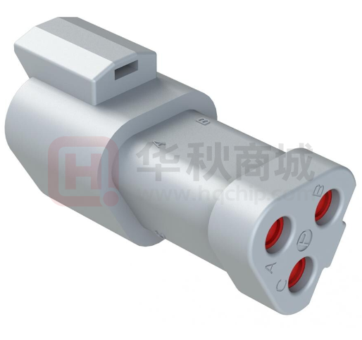

    胶壳 灰色 2排 针位数:3 13A
AT04-3P-EC01 数据手册
REVISIONS REV 44.8±0.6 ECO A3 A4 DESCRIPTION DATE BY RELEASE NEW DWG FORMAT 02JAN14 JARRY UPDATE DIMENSIONS 05AUG16 JONY TOMMY ADD COLOR OPTION 23NOV20 LOUIE TOMMY C0540S A5 APPR TITLE: REQUIRES CONTACT RETENTION WEDGE AW3P 6 24.4 DWG NO: STANDARD COLOR IS GREY, ADDITION COLOR SHOWN IN PART NUMBER CHART NOTES: UNLESS OTHERWISE SPECIFIED 1. MATERIAL: HOUSING: THERMOPLASTIC SEAL: SILICONE RUBBER 2. MODIFICATIONS: END CAP 21.0 STANDARD MOLDED COLOR IS GREY. ADDITIONAL COLORS SHOWN IN PART NUMBER CHART ARE AVAILABLE VIA SPECIAL ORDER. PART NUMBER CHART PART NUMBER GREY AT04-3P-EC01 BLACK AT04-3P-EC01BLK BLUE AT04-3P-EC01BLU BROWN AT04-3P-EC01BRN GREEN AT04-3P-EC01GRN SEE PART NUMBER CHART PART NUMBER OF: COLOR SH: 4. MATING PART: AT06-3S* RECEPTACLE ( * = MODIFICATIONS AND COLORS ) REV: 3. SPECIFICATIONS: 3.1 CURRENT RATING: 13 AMPS 3.2 OPERATING TEMPERATURE: -55°C TO +125°C 3.3 DIELECTRIC WITHSTANDING VOLTAGE: LESS THAN 2 MILLIAMPS CURRENT LEAKAGE @ 1500 VOLTS AC. 3.4 INSULATION RESISTANCE: 1000 MEGOHMS MIN @ 25°C. 3.5 MOISTURE RESISTANCE: IP68(1M OF WATER FOR A PERIOD OF 24 HOURS, MATED CONDITION) IP69K(MATED CONDITION) 3.6 MATING CYCLE DURABILITY: 100 CYCLES 3.7 RoHS COMPLIANT REF: DT04-3P-E003,DT04-3P-EP04,DT04-3P-E005 DESCRIPTION QUANTITY DRAWN: 5. ALL DIMENSIONS ARE FOR REFERENCE USE ONLY. CHECKED: X 6 CONTACT SIZE AND REAR SEAL WIRE RANGE: Sine Systems - www.amphenol-sine.com 44724 Morley Drive Clinton Township, MI 48036 ENGINEER: RED AT04-3P-EC01RED WHITE AT04-3P-EC01WHT CUSTOMER: YELLOW AT04-3P-EC01YEL ORANGE AT04-3P-EC01ORG THIS DRAWING IS SUPPLIED FOR INFORMATION ONLY. DESIGN FEATURES, SPECIFICATIONS AND PERFORMANCE DATA SHOWN HEREON ARE THE PROPERTY OF THE AMPHENOL CORPORATION. NO RIGHTS OF REPRODUCTION ARE IMPLIED. ALL DIMENSIONS ARE SUBJECT TO NORMAL SCALE: MANUFACTURING VARIATIONS. APPROVAL: MATERIAL SPECIFICATIONS: CONTACT SIZE 16 MIN. INSUL O.D. 2.24 mm (.088 in) MAX. INSUL O.D. 3.68 mm (.145 in) TYPICAL WIRE RANGE 14 - 20 AWG (2.0-0.5mm²) PROCESS SPECIFICATIONS: RECEPTACLE, 3 PIN, AT SERIES, END CAP TYPE DWG NO: A5 B NEXT ASS'Y: NONE SHEET 1 OF 1 A Series™ - Contact Size 16 Options (Works with: AT, ATV, AHD-9, ARC, DuraMate and PanelMate Series) Stamped & Formed Contacts, Sockets & Pins Machined Contacts, Sockets & Pins Size AWG Type AT60-215-1631 Male Contact - Pin, Gold-plated 16 14 Machined AT60-14-0122 Male Contact - Pin, Nickel-plated 16 14-18 Stamped & Formed Part Number Description Size AWG Type Part Number Description AT62-209-1631 Female Contact - Socket, Gold-plated 16 14 Machined AT62-14-0122 Female Contact - Socket, Nickel-plated 16 14-18 Stamped & Formed AT60-215-16141 Male Contact - Pin, Nickel-plated 16 14 Machined AT60-14-0144 Male Contact - Pin, Gold-plated 16 14-18 Stamped & Formed AT62-209-16141 Female Contact - Socket, Nickel-plated 16 14 Machined AT62-14-0144 Female Contact - Socket, Gold-plated 16 14-18 Stamped & Formed AT60-202-1631 Male Contact - Pin, Gold-plated 16 16-20 Machined AT60-16-0122 Male Contact - Pin, Nickel-plated 16 16-18 Stamped & Formed Machined AT62-16-0122 Female Contact - Socket, Nickel-plated 16 16-18 Stamped & Formed Male Contact - Pin, Gold-plated 16 16-18 Stamped & Formed AT62-201-1631 Female Contact - Socket, Gold-plated 16 16-20 AT60-202-16141 Male Contact - Pin, Nickel-plated 16 16-20 Machined AT60-16-0144 AT62-201-16141 Female Contact - Socket, Nickel-plated 16 16-20 Machined AT62-16-0144 Female Contact - Socket, Gold-plated 16 16-18 Stamped & Formed AT60-202-1631-22 Male Contact - Pin, Gold-plated 16 22-24 Machined AT60-16-0622 Male Contact - Pin, Nickel-plated 16 16-20 Stamped & Formed AT62-201-1631-22 Female Contact - Socket, Gold-plated 16 22-24 Machined AT62-16-0622 Female Contact - Socket, Nickel-plated 16 16-20 Stamped & Formed AT60-202-16141-22 Male Contact - Pin, Nickel-plated 16 22-24 Machined AT60-16-0644 Male Contact - Pin, Gold-plated 16 16-20 Stamped & Formed AT62-201-16141-22 Female Contact - Socket, Nickel-plated 16 22-24 Machined AT62-16-0644 Female Contact - Socket, Gold-plated 16 16-20 Stamped & Formed AT60-16-0677 Male Contact - Pin, Tin-plated 16 16-20 Stamped & Formed AT62-16-0677 Female Contact - Socket, Tin-plated 16 16-20 Stamped & Formed Description AT60-16-0822 Male Contact - Pin, Nickel-plated 16 20-22 Stamped & Formed AUTK-16 Hand Crimp Tool, Size 16 AT62-16-0822 Female Contact - Socket, Nickel-plated 16 20-22 Stamped & Formed AUTK-100 Universal Heavy Duty Contact Crimping Tool Kit, Size 12/16/20 AT60-16-0844 Male Contact - Pin, Gold-plated 16 20-22 Stamped & Formed CA-5D12 Universal Hand Crimp Tool, Size 12/16/20 AT62-16-0844 Female Contact - Socket, Gold-plated 16 20-22 Stamped & Formed CA-5E12 Pneumatic Crimp Tool, Size 12/16/20 Tooling - Machined Contacts Part Number Tooling - Stamped & Formed Contacts Contact Removal Tools (For both Machined or Stamped & Formed Contacts) Part Number ATRT-100 AT11-310-1605 Description MFX-3950 Crimp Die - Size 16, 18-20AWG MFX-3953 Crimp Die - Size 16, 16-18AWG MFX-3975 Crimp Die - Size 16, 14-16AWG MFX-3990 Crimp Die - Size 16, 20-22AWG ATT-16-00 Hand Crimp Tool - Size 16, 14-16AWG ATT-16-01 Hand Crimp Tool - Size 16, 18-20AWG ATT-1612-03 Hand Crimp Tool - Size 16, 20-22AWG Contact and Wedgelock Extraction Tool Contact Removal Tool, Plastic, Size 16 Sealing Plugs (For both Machined or Stamped & Formed Contacts) Part Number A114017 A114017-SR AT13-217-1605 AT13-217-1605-SR Description Sealing Plug, Size 16, White Sealing Plug, Size 16, SR01 Series, Black Locking Sealing Plug, Size 16, Grey Locking Sealing Plug, Size 16, SR01 Series, Red Amphenol Sine Systems 44724 Morley Drive, Clinton Township, MI 48036 USA www.amphenol-sine.com 10-2023
