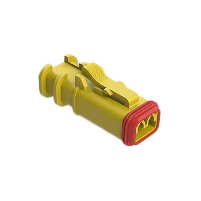

    CONN 2POS PLUG YELLOW
AT06-2S-OMYEL 数据手册
REVISIONS 43.6 REV ECO DESCRIPTION DATE BY APPR 01 - NEW RELEASE 27JAN16 JARRY TOMMY UPDATED MATERIAL DETAIL 16FEB16 JARRY TOMMY 28JAN18 JAH 14JUN19 JAH 02 - A2 - A3 - ADDED REDUCED DIAMETER SEAL P/N'S REVISED TITLE TITLE: STRUCTURE+,OVERMOLD-COMPATIBLE,PLUG, 2 SOCKET,AT REQUIRES CONTACT RETENTION WEDGE AW2S 6 18.1 NOTES: UNLESS OTHERWISE SPECIFIED 1. MATERIAL: HOUSING: PA66 GF15 SEAL: SILICONE RUBBER 2. MODIFICATIONS: FOR OVER MOLDING DWG NO: AT06-2S-OMXXX 3. SPECIFICATIONS: 3.1 CURRENT RATING: 13 AMPS 3.2 OPERATING TEMPERATURE: -55°C TO +125°C 3.3 DIELECTRIC WITHSTANDING VOLTAGE: LESS THAN 2 MILLIAMPS CURRENT LEAKAGE @ 1500 VOLTS AC. 3.4 INSULATION RESISTANCE: 1000 MEGOHMS MIN @ 25°C. 3.5 MOISTURE RESISTANCE: IP67 ( MATED CONDITION ) 3.6 MATING CYCLE DURABILITY: 100 CYCLES 3.7 RoHS COMPLIANT 18.5 REV: A3 4. MATING PART: AT04-2P* RECEPTACLE ( * = MODIFICATIONS AND COLORS ) MAX. INSUL O.D. 16 2.24 mm (.088 in) 3.68 mm (.145 in) TYPICAL WIRE RANGE 14 - 20 AWG REDUCED DIAMETER SEAL GREY AT06-2S-OMGRY AT06-2S-OMRDGRY BLACK AT06-2S-OMBLK AT06-2S-OMRDBLK BLUE AT06-2S-OMBLU AT06-2S-OMRDBLU BROWN AT06-2S-OMBRN AT06-2S-OMRDBRN GREEN AT06-2S-OMGRN AT06-2S-OMRDGRN CONTACT SIZE MIN. INSUL O.D. MAX. INSUL O.D. TYPICAL WIRE RANGE RED AT06-2S-OMRED AT06-2S-OMRDRED 1.35 mm (.053 in) 3.05 mm (.120 in) WHITE AT06-2S-OMWHT AT06-2S-OMRDWHT 16 14 - 20 AWG YELLOW AT06-2S-OMYEL AT06-2S-OMRDYEL SEE PART NUMBER CHART DESCRIPTION PART NUMBER QUANTITY MATERIALS LIST UNLESS OTHERWISE SPECIFIED 1) All dimensions are in metric(mm). 2) Tolerances are as follows: 1 PL DEC ±0.30 Fractions ±1/64 2 PL DEC ±0.15 Angles ±1° 3 PL DEC ±0.08 3) Note reference = X SIGNATURES DRAWN: JARRY Amphenol DATE 27JAN16 CHECKED: Sine Systems - www.amphenol-sine.com 44724 Morley Drive Clinton Township, MI 48036 ENGINEER: APPROVAL: MATERIAL SPECIFICATIONS: CUSTOMER: PROCESS SPECIFICATIONS: STRUCTURE+, OVERMOLD-COMPATIBLE PLUG, 2 SOCKET, AT SERIES THIS DRAWING IS SUPPLIED FOR INFORMATION ONLY. DESIGN FEATURES, SPECIFICATIONS AND PERFORMANCE DATA SIZE SHOWN HEREON ARE THE PROPERTY OF THE AMPHENOL CORPORATION. NO RIGHTS OF REPRODUCTION ARE IMPLIED. ALL DIMENSIONS ARE SUBJECT TO NORMAL SCALE: MANUFACTURING VARIATIONS. TYPE B C- NEXT ASS'Y: ITEM NONE DWG NO: REVISION AT06-2S-OMXXX SHEET 1 A3 OF 1 1 MIN. INSUL O.D. P/N W/ RD SEAL OF: CONTACT SIZE P/N W/ STD SEAL 1 COLOR STANDARD SEAL REFER TO PART NUMBER CHART FOR AVAILABLE CONNECTOR COLORS PART NUMBER CHART 6 CONTACT SIZE AND REAR SEAL WIRE RANGE: SH: 5. ALL DIMENSIONS ARE FOR REFERENCE USE ONLY. A Series™ - Contact Size 16 Options (Works with: AT, ATV, AHD-9, ARC, DuraMate and PanelMate Series) Stamped & Formed Contacts, Sockets & Pins Machined Contacts, Sockets & Pins Size AWG Type AT60-215-1631 Male Contact - Pin, Gold-plated 16 14 Machined AT60-14-0122 Male Contact - Pin, Nickel-plated 16 14-18 Stamped & Formed Part Number Description Size AWG Type Part Number Description AT62-209-1631 Female Contact - Socket, Gold-plated 16 14 Machined AT62-14-0122 Female Contact - Socket, Nickel-plated 16 14-18 Stamped & Formed AT60-215-16141 Male Contact - Pin, Nickel-plated 16 14 Machined AT60-14-0144 Male Contact - Pin, Gold-plated 16 14-18 Stamped & Formed AT62-209-16141 Female Contact - Socket, Nickel-plated 16 14 Machined AT62-14-0144 Female Contact - Socket, Gold-plated 16 14-18 Stamped & Formed AT60-202-1631 Male Contact - Pin, Gold-plated 16 16-20 Machined AT60-16-0122 Male Contact - Pin, Nickel-plated 16 16-18 Stamped & Formed Machined AT62-16-0122 Female Contact - Socket, Nickel-plated 16 16-18 Stamped & Formed Male Contact - Pin, Gold-plated 16 16-18 Stamped & Formed AT62-201-1631 Female Contact - Socket, Gold-plated 16 16-20 AT60-202-16141 Male Contact - Pin, Nickel-plated 16 16-20 Machined AT60-16-0144 AT62-201-16141 Female Contact - Socket, Nickel-plated 16 16-20 Machined AT62-16-0144 Female Contact - Socket, Gold-plated 16 16-18 Stamped & Formed AT60-202-1631-22 Male Contact - Pin, Gold-plated 16 22-24 Machined AT60-16-0622 Male Contact - Pin, Nickel-plated 16 16-20 Stamped & Formed AT62-201-1631-22 Female Contact - Socket, Gold-plated 16 22-24 Machined AT62-16-0622 Female Contact - Socket, Nickel-plated 16 16-20 Stamped & Formed AT60-202-16141-22 Male Contact - Pin, Nickel-plated 16 22-24 Machined AT60-16-0644 Male Contact - Pin, Gold-plated 16 16-20 Stamped & Formed AT62-201-16141-22 Female Contact - Socket, Nickel-plated 16 22-24 Machined AT62-16-0644 Female Contact - Socket, Gold-plated 16 16-20 Stamped & Formed AT60-16-0677 Male Contact - Pin, Tin-plated 16 16-20 Stamped & Formed AT62-16-0677 Female Contact - Socket, Tin-plated 16 16-20 Stamped & Formed Description AT60-16-0822 Male Contact - Pin, Nickel-plated 16 20-22 Stamped & Formed AUTK-16 Hand Crimp Tool, Size 16 AT62-16-0822 Female Contact - Socket, Nickel-plated 16 20-22 Stamped & Formed AUTK-100 Universal Heavy Duty Contact Crimping Tool Kit, Size 12/16/20 AT60-16-0844 Male Contact - Pin, Gold-plated 16 20-22 Stamped & Formed CA-5D12 Universal Hand Crimp Tool, Size 12/16/20 AT62-16-0844 Female Contact - Socket, Gold-plated 16 20-22 Stamped & Formed CA-5E12 Pneumatic Crimp Tool, Size 12/16/20 Tooling - Machined Contacts Part Number Tooling - Stamped & Formed Contacts Contact Removal Tools (For both Machined or Stamped & Formed Contacts) Part Number ATRT-100 AT11-310-1605 Description MFX-3950 Crimp Die - Size 16, 18-20AWG MFX-3953 Crimp Die - Size 16, 16-18AWG MFX-3975 Crimp Die - Size 16, 14-16AWG MFX-3990 Crimp Die - Size 16, 20-22AWG ATT-16-00 Hand Crimp Tool - Size 16, 14-16AWG ATT-16-01 Hand Crimp Tool - Size 16, 18-20AWG ATT-1612-03 Hand Crimp Tool - Size 16, 20-22AWG Contact and Wedgelock Extraction Tool Contact Removal Tool, Plastic, Size 16 Sealing Plugs (For both Machined or Stamped & Formed Contacts) Part Number A114017 A114017-SR AT13-217-1605 AT13-217-1605-SR Description Sealing Plug, Size 16, White Sealing Plug, Size 16, SR01 Series, Black Locking Sealing Plug, Size 16, Grey Locking Sealing Plug, Size 16, SR01 Series, Red Amphenol Sine Systems 44724 Morley Drive, Clinton Township, MI 48036 USA www.amphenol-sine.com 10-2023
