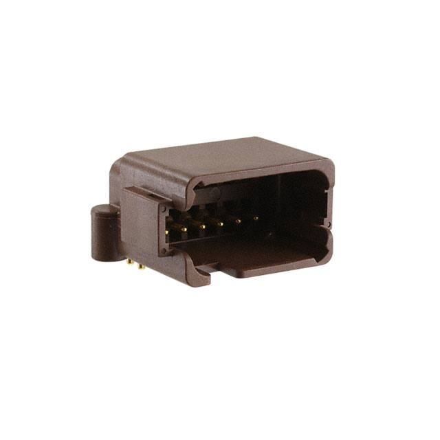

    线对板针座 2x6P 弯插 间距:4.42mm
ATF13-12PD-BM11 数据手册
REVISIONS REV ECO A1 - A2 A3 DESCRIPTION DATE BY RELEASE 02JUL2018 JAH - UPDATE DRAWING 25/MAR/19 BROOK - MODIFIED DESCRIPTION 12JUL19 APPR TOMMY BROOK TOMMY 41.6±0.50 TITLE: RIGHT ANGLE RECEPT, AT 12 PIN, SCREW BOSS,BOARDLOCK 34.9 41.95±0.50 22.2 12x3.05±0.30 2xØ1.96x9.0 DP FOR ANSI SIZE #2 SCREWS TORQUE: 2.1-3.1 IN-LB [0.24-0.35 NM] 1 SEE SHEET 2 FOR KEY ARRANGEMENTS AND COLORS. ATF13-12PX-BM1X NOTES: UNLESS OTHERWISE SPECIFIED DWG NO: 0.74 12xØ1.57 34.29 22.10 13.26 12xØ1.70 2. MATERIAL: HOUSING: THERMOPLASTIC CONTACT: COPPER ALLOY PLATING: NICKEL UNDERPLATE SEE CHART FOR OVERALL FINISH 4.42 A3 34.29±0.3 22.10±0.25 13.26 4.42 SH: RECOMMENDED PCB LAYOUT 1 OF: REF: DTF13-12PA, DTF13-12PB, DTF13-12PC, DTF13-12PD, DTF13-12PA-G003 SEE PART NUMBER CHART PART NUMBER DESCRIPTION QUANTITY MATERIALS LIST UNLESS OTHERWISE SPECIFIED 4.42 30.4 1) All dimensions are in metric(mm). 2) Tolerances are as follows: 1 PL DEC ±0.30 Fractions ±1/64 2 PL DEC ±0.15 Angles ±1° 3 PL DEC ±0.08 3) Note reference = X SIGNATURES DRAWN: CHECKED: MATERIAL SPECIFICATIONS: CUSTOMER: PROCESS SPECIFICATIONS: 6. ALL DIMENSIONS ARE FOR REFERENCE USE ONLY. NEXT ASS'Y: 12/JUL/19 12/JUL/19 TOMMY.XIE 12/JUL/19 Sine Systems - www.amphenol-sine.com 44724 Morley Drive Clinton Township, MI 48036 ENGINEER: APPROVAL: 5. MATING PART: AT06-12S* PLUG ( * = MODIFICATIONS AND COLORS ) Amphenol DATE BROOK.DING ORION.LI ITEM RIGHT ANGLE RECEPTACLE, AT 12 PIN, SCREW BOSS,BOARDLOCK THIS DRAWING IS SUPPLIED FOR INFORMATION ONLY. DESIGN FEATURES, SPECIFICATIONS AND PERFORMANCE DATA SIZE SHOWN HEREON ARE THE PROPERTY OF THE AMPHENOL CORPORATION. NO RIGHTS OF REPRODUCTION ARE IMPLIED. ALL DIMENSIONS ARE SUBJECT TO NORMAL SCALE: MANUFACTURING VARIATIONS. TYPE B CNONE DWG NO: REVISION ATF13-12PX-BM1X SHEET 1 A3 OF 1 2 4. SPECIFICATIONS: 4.1 CURRENT RATING: 13 AMPS 4.2 OPERATING TEMPERATURE: -55°C TO +125°C 4.3 DIELECTRIC WITHSTANDING VOLTAGE: LESS THAN 2 MILLIAMPS CURRENT LEAKAGE @ 1500 VOLTS AC. 4.4 INSULATION RESISTANCE: 1000 MEGOHMS MIN @ 25°C. 4.5 MOISTURE RESISTANCE: IP67 ( MATED CONDITION ) 4.6 MATING CYCLE DURABILITY: 100 CYCLES 4.7 RoHS COMPLIANT 2xØ2.40 REV: 3. MODIFICATIONS: RIGHT ANGLE PCB MOUNT, SCREW BOSS KEYED, HOUSING COLOR 4.42 REVISIONS P/N ATF13-12PA-BM1X KEY-A CONFIGURATION STANDARD COLOR: GREY P/N ATF13-12PB-BM1X KEY-B CONFIGURATION STANDARD COLOR: BLACK REV ECO A1 - A2 A3 DESCRIPTION DATE BY RELEASE 02JUL2018 JAH - UPDATE DRAWING 25/MAR/19 BROOK - MODIFIED DESCRIPTION 12JUL19 P/N ATF13-12PD-BM1X KEY-D CONFIGURATION STANDARD COLOR: BROWN KEYWAY (3)PLACES KEYWAY (3)PLACES TOMMY BROOK TOMMY TITLE: P/N ATF13-12PC-BM1X KEY-C CONFIGURATION STANDARD COLOR: GREEN APPR KEYWAY (3)PLACES RIGHT ANGLE RECEPT, AT 12 PIN, SCREW BOSS,BOARDLOCK KEYWAY (3)PLACES DWG NO: PART NUMBER PART NUMBER PART NUMBER PART NUMBER GOLD ATF13-12PA-BM11 GOLD ATF13-12PB-BM11 GOLD ATF13-12PC-BM11 GOLD ATF13-12PD-BM11 TIN ATF13-12PA-BM13 TIN ATF13-12PB-BM13 TIN ATF13-12PC-BM13 TIN ATF13-12PD-BM13 SH: ATF13-12PD-BM1X VARIANTS CONTACT PLATING A3 ATF13-12PC-BM1X VARIANTS CONTACT PLATING REV: ATF13-12PB-BM1X VARIANTS CONTACT PLATING ATF13-12PX-BM1X ATF13-12PA-BM1X VARIANTS CONTACT PLATING 2 OF: UNLESS OTHERWISE SPECIFIED 1) All dimensions are in metric(mm). 2) Tolerances are as follows: 1 PL DEC ±0.30 Fractions ±1/64 2 PL DEC ±0.15 Angles ±1° 3 PL DEC ±0.08 3) Note reference = X SIGNATURES DRAWN: CHECKED: 12/JUL/19 12/JUL/19 TOMMY.XIE 12/JUL/19 Sine Systems - www.amphenol-sine.com 44724 Morley Drive Clinton Township, MI 48036 ENGINEER: APPROVAL: MATERIAL SPECIFICATIONS: CUSTOMER: PROCESS SPECIFICATIONS: Amphenol DATE BROOK.DING ORION.LI RIGHT ANGLE RECEPTACLE, AT 12 PIN, SCREW BOSS,BOARDLOCK THIS DRAWING IS SUPPLIED FOR INFORMATION ONLY. DESIGN FEATURES, SPECIFICATIONS AND PERFORMANCE DATA SIZE SHOWN HEREON ARE THE PROPERTY OF THE AMPHENOL CORPORATION. NO RIGHTS OF REPRODUCTION ARE IMPLIED. ALL DIMENSIONS ARE SUBJECT TO NORMAL SCALE: MANUFACTURING VARIATIONS. TYPE B C- NEXT ASS'Y: ITEM NONE DWG NO: REVISION ATF13-12PX-BM1X SHEET 2 A3 OF 2 2 SEE PART NUMBER CHART DESCRIPTION PART NUMBER QUANTITY MATERIALS LIST
ATF13-12PD-BM11
1. 物料型号: - ATF13-12PA-BM1X(键位A配置,标准颜色:灰色) - ATF13-12PB-BM1X(键位B配置,标准颜色:黑色) - ATF13-12PC-BM1X(键位C配置,标准颜色:绿色) - ATF13-12PD-BM1X(键位D配置,标准颜色:棕色)
2. 器件简介: - 该系列连接器为直角PCB安装,带螺丝固定键位的12针连接器。
3. 引脚分配: - 文档中未提供具体的引脚分配图,但提到了12个引脚。
4. 参数特性: - 电流额定值:13安培 - 工作温度范围:-55°C至+125°C - 介电耐压:在1500伏交流电下,漏电流小于2毫安 - 绝缘电阻:在25°C下,最小为1000兆欧姆 - 防水等级:IP67(在连接状态下) - 插拔耐久性:100次插拔循环 - 符合RoHS标准
5. 功能详解: - 连接器具有直角安装和螺丝固定功能,提供多种颜色和键位配置选项。
6. 应用信息: - 适用于需要直角安装和螺丝固定连接的应用场合。
7. 封装信息: - 材料:外壳为热塑性材料,接触件为铜合金,镀层为镍下层。 - 推荐PCB布局参考:DTF13-12PA, DTF13-12PB, DTF13-12PC, DTF13-12PD。
