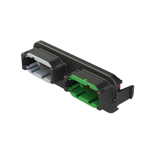

    线对板针座 2x12P 面板安装,卡入式,通孔,直角
ATM13-12PA-12PC-BM01 数据手册
REVISIONS REV ECO A1 - A2 A3 9.5 DESCRIPTION DATE BY APPR RELEASE NEW DRAWING 06NOV18 SULLEN TOMMY - UPDATED DRAWING 18FEB19 SULLEN TOMMY - ADD SPACE LIMIT DIMENSION 15JAN20 SULLEN TOMMY 7.4 3.3 5.0 21.2 TITLE: 18.2 15.7 101.0±0.5 HEADER SEAL 35.0±0.4 3.05±0.4 DWG NO: KEY B BLACK KEY A GREY Ø1.0±0.05 34.05±0.10 21.0±0.10 21.0±0.10 4.2 4.2 17.03±0.1 4.20±0.1 (5x) 2.0 4.20±0.1 (5x) 6.35±0.1 2.9 6.35±0.1 1 12 12 1 7 6 VIEW FROM COMPONENTS SIDE OF PCB 5.3 34.1 SEE SHEET 2 & 3 PART NUMBER 3. SPECIFICATIONS: 3.1 CURRENT RATING: 7.5 AMPS 3.2 OPERATING TEMPERATURE: -55°C TO +125°C 3.3 DIELECTRIC WITHSTANDING VOLTAGE: LESS THAN 2 MILLIAMPS CURRENT LEAKAGE @ 1500 VOLTS AC 3.4 INSULATION RESISTANCE: 1000 MEGOHMS MIN @ 25°C 3.5 MOISTURE RESISTANCE: IP69K ( MATED CONDITION ) 3.6 MATING CYCLE DURABILITY: 100 CYCLES 3.7 RoHS COMPLIANT 5. THIS RECEPTACLE IS USED WITH AIPXE-325X4A-XXXX AND AIPXE-325X4B-XXXX ENCLOSURE (XXXX= ALL MODIFICATIONS) DESCRIPTION QUANTITY DRAWN: CHECKED: X Sine Systems - www.amphenol-sine.com 44724 Morley Drive Clinton Township, MI 48036 ENGINEER: APPROVAL: MATERIAL SPECIFICATIONS: CUSTOMER: 4. MATING PART: ATM06-12SX-* ( X = A,B,C,D KEYS ; * = ALL MODIFICATIONS) Ø3.00+0.2 0 RECOMMENDED PCB LAYOUT OF: 2. MODIFICATIONS: RA PCB MOUNT 6 7 Ø1.20+0.2 0 (24x) SH: 1. MATERIAL: HOUSING: THERMOPLASTIC, BLACK SEAL: SILICONE RUBBER CONTACT: COPPER ALLOY 6.4 REV: 1.98±0.1 NOTES: UNLESS OTHERWISE SPECIFIED 6. SEE SHEET 2 AND 3 FOR OTHER KEY ARRANGEMENTS AND COLORS 7. MAXIMUM COMPONENT HEIGHT DEPENDS ON LOCATION DUE TO PART DRAFT AND RIBS.(SEE SHEET 4) PROCESS SPECIFICATIONS: 8. ALL DIMENSIONS ARE FOR REFERENCE USE ONLY NEXT ASS'Y: ARMOR IPX RECEPTACLE ATM HEADER, 2 x 12 POSITIONS, SIZE 20 CONTACT THIS DRAWING IS SUPPLIED FOR INFORMATION ONLY. DESIGN FEATURES, SPECIFICATIONS AND PERFORMANCE DATA SHOWN HEREON ARE THE PROPERTY OF THE AMPHENOL CORPORATION. NO RIGHTS OF REPRODUCTION ARE IMPLIED. ALL DIMENSIONS ARE SUBJECT TO NORMAL SCALE: MANUFACTURING VARIATIONS. TYPE DWG NO: A3 B NONE SHEET 1 OF 4 REVISIONS 3X KEYWAY SELEEVE RETAINER:GREY A KEY 3X KEYWAY SELEEVE RETAINER:BLACK B KEY 3X KEYWAY SELEEVE RETAINER:GREY A KEY 3X KEYWAY SELEEVE RETAINER:GREEN C KEY REV ECO A1 - A2 A3 DESCRIPTION DATE BY APPR RELEASE NEW DRAWING 06NOV18 SULLEN TOMMY - UPDATED DRAWING 18FEB19 SULLEN TOMMY - ADD SPACE LIMIT DIMENSION 15JAN20 SULLEN TOMMY 3X KEYWAY SELEEVE RETAINER:GREY A KEY 3X KEYWAY SELEEVE RETAINER:BROWN D KEY TITLE: CONTACT PLATING PART NUMBER REFERENCE CONTACT PLATING PART NUMBER REFERENCE CONTACT PLATING PART NUMBER REFERENCE GOLD ATM13-12PA-12PB-BM01 DTM13-12PA-12PB-GR01 GOLD ATM13-12PA-12PC-BM01 DTM13-12PA-12PC-GR01 GOLD ATM13-12PA-12PD-BM01 DTM13-12PA-12PD-GR01 TIN ATM13-12PA-12PB-BM03 DTM13-12PA-12PB-R008 TIN ATM13-12PA-12PC-BM03 DTM13-12PA-12PC-R008 TIN ATM13-12PA-12PD-BM03 DTM13-12PA-12PD-R008 3X KEYWAY SELEEVE RETAINER:GREY A KEY 3X KEYWAY SELEEVE RETAINER:BLACK B KEY 3X KEYWAY SELEEVE RETAINER:GREEN C KEY 3X KEYWAY SELEEVE RETAINER:BLACK B KEY 3X KEYWAY SELEEVE RETAINER:BROWN D KEY REFERENCE CONTACT PLATING PART NUMBER REFERENCE CONTACT PLATING PART NUMBER REFERENCE GOLD ATM13-12PB-12PA-BM01 DTM13-12PB-12PA-GR01 GOLD ATM13-12PB-12PC-BM01 DTM13-12PB-12PC-GR01 GOLD ATM13-12PB-12PD-BM01 DTM13-12PB-12PD-GR01 TIN ATM13-12PB-12PA-BM03 DTM13-12PB-12PA-R008 TIN ATM13-12PB-12PC-BM03 DTM13-12PB-12PC-R008 TIN ATM13-12PB-12PD-BM03 DTM13-12PB-12PD-R008 SH: PART NUMBER REV: CONTACT PLATING DWG NO: 3X KEYWAY SELEEVE RETAINER:BLACK B KEY OF: ATM13-12PX-12PX-BMXX PART NUMBER DESCRIPTION QUANTITY DRAWN: CHECKED: X Sine Systems - www.amphenol-sine.com 44724 Morley Drive Clinton Township, MI 48036 ENGINEER: APPROVAL: MATERIAL SPECIFICATIONS: CUSTOMER: PROCESS SPECIFICATIONS: ARMOR IPX RECEPTACLE ATM HEADER, 2 x 12 POSITIONS,SIZE 20 CONTACT THIS DRAWING IS SUPPLIED FOR INFORMATION ONLY. DESIGN FEATURES, SPECIFICATIONS AND PERFORMANCE DATA SHOWN HEREON ARE THE PROPERTY OF THE AMPHENOL CORPORATION. NO RIGHTS OF REPRODUCTION ARE IMPLIED. ALL DIMENSIONS ARE SUBJECT TO NORMAL SCALE: MANUFACTURING VARIATIONS. TYPE DWG NO: A3 B NEXT ASS'Y: NONE SHEET 2 OF 4 REVISIONS 3X KEYWAY SELEEVE RETAINER:GREEN C KEY 3X KEYWAY SELEEVE RETAINER:GREY A KEY 3X KEYWAY SELEEVE RETAINER:GREEN C KEY REV ECO A1 - A2 A3 DESCRIPTION BY APPR 06NOV18 SULLEN TOMMY - UPDATED DRAWING 18FEB19 SULLEN TOMMY - ADD SPACE LIMIT DIMENSION 15JAN20 SULLEN TOMMY 3X KEYWAY SELEEVE RETAINER:GREEN C KEY 3X KEYWAY SELEEVE RETAINER:BLACK B KEY DATE RELEASE NEW DRAWING 3X KEYWAY SELEEVE RETAINER:BROWN D KEY TITLE: CONTACT PLATING PART NUMBER REFERENCE CONTACT PLATING PART NUMBER REFERENCE CONTACT PLATING PART NUMBER REFERENCE GOLD ATM13-12PC-12PA-BM01 DTM13-12PC-12PA-GR01 GOLD ATM13-12PC-12PB-BM01 DTM13-12PC-12PB-GR01 GOLD ATM13-12PC-12PD-BM01 DTM13-12PC-12PD-GR01 TIN ATM13-12PC-12PA-BM03 DTM13-12PC-12PA-R008 TIN ATM13-12PC-12PB-BM03 DTM13-12PC-12PB-R008 TIN ATM13-12PC-12PD-BM03 DTM13-12PC-12PD-R008 3X KEYWAY SELEEVE RETAINER:GREY A KEY 3X KEYWAY SELEEVE RETAINER:BROWN D KEY 3X KEYWAY SELEEVE RETAINER:BLACK B KEY 3X KEYWAY SELEEVE RETAINER:GREEN C KEY 3X KEYWAY SELEEVE RETAINER:BROWN D KEY REFERENCE CONTACT PLATING PART NUMBER REFERENCE CONTACT PLATING PART NUMBER REFERENCE GOLD ATM13-12PD-12PA-BM01 DTM13-12PD-12PA-GR01 GOLD ATM13-12PD-12PB-BM01 DTM13-12PD-12PB-GR01 GOLD ATM13-12PD-12PC-BM01 DTM13-12PD-12PC-GR01 TIN ATM13-12PD-12PA-BM03 DTM13-12PD-12PA-R008 TIN ATM13-12PD-12PB-BM03 DTM13-12PD-12PB-R008 TIN ATM13-12PD-12PC-BM03 DTM13-12PD-12PC-R008 SH: PART NUMBER REV: CONTACT PLATING DWG NO: 3X KEYWAY SELEEVE RETAINER:BROWN D KEY OF: ATM13-12PX-12PX-BMXX PART NUMBER DESCRIPTION QUANTITY DRAWN: CHECKED: X Sine Systems - www.amphenol-sine.com 44724 Morley Drive Clinton Township, MI 48036 ENGINEER: APPROVAL: MATERIAL SPECIFICATIONS: CUSTOMER: PROCESS SPECIFICATIONS: ARMOR IPX RECEPTACLE ATM HEADER, 2 x 12 POSITIONS,SIZE 20 CONTACT THIS DRAWING IS SUPPLIED FOR INFORMATION ONLY. DESIGN FEATURES, SPECIFICATIONS AND PERFORMANCE DATA SHOWN HEREON ARE THE PROPERTY OF THE AMPHENOL CORPORATION. NO RIGHTS OF REPRODUCTION ARE IMPLIED. ALL DIMENSIONS ARE SUBJECT TO NORMAL SCALE: MANUFACTURING VARIATIONS. TYPE DWG NO: A3 B NEXT ASS'Y: NONE SHEET 3 OF 4 REVISIONS CIRCUIT BOARD HOLE LOCATIONS AND KEEP CLEAR AREAS FOR ATM13-12Px-12Px-BM01 ATM13-12Px-12Px-BM03 ALL DIMENSIONS REFERENCE TOP VIEW BOTTOM SIDE ONLY REV ECO A1 - A2 A3 DESCRIPTION DATE BY APPR RELEASE NEW DRAWING 06NOV18 SULLEN TOMMY - UPDATE DRAWING 18FEB19 SULLEN TOMMY - ADD SPACE LIMIT DIMENSION 15JAN20 SULLEN TOMMY 82.55 A #4 [M3] SCREW LOCATION OPTIONAL 4.00 2.00 10.00 3.00 TITLE: HEADER PCB KEEP CLEAR Ø3.00 FOR #4 [M3] SCREW 101.60 12.00 (133) TOP SURFACE OF PCB REF HOLE FOR Ø1.04 PIN ENCLOSURE 4.20 8.40 12.60 16.80 21.00 9.00 6.35 2.45 DWG NO: 4.41 B B 12.00 17.03 30.00 A SECTION A-A 60.00 22.00 11.00 2x4.00 7 (19.2) 7 (17.6) REV: 44.00 ASSEMBLED PCB ENCLOSURE SHOWN FOR REFERENCE SH: 84.60 SECTION B-B OF: SEE SHEET 2 & 3 PART NUMBER 7.00 DESCRIPTION QUANTITY DRAWN: 17.00 19.00 CHECKED: X 14.00 Sine Systems - www.amphenol-sine.com 44724 Morley Drive Clinton Township, MI 48036 ENGINEER: APPROVAL: MATERIAL SPECIFICATIONS: CUSTOMER: THREE DIMENSIONAL SPACE LIMIT APPROXIMATE INTERNAL SPACE FOR COMPONENT SPACE LAYOUT MAX. COMPONENT HEIGHT UNDER BOARD 2.00 mm. 3D VIEW AIPXE-325X4A-XXXX AND AIPXE-325X4B-XXXX ENCLOSURE AND MOUNTING HARDWARE SHOWN FOR REFERENCE PROCESS SPECIFICATIONS: ARMOR IPX RECEPTACLE ATM HEADER, 2 x 12 POSITIONS,SIZE 20 CONTACT THIS DRAWING IS SUPPLIED FOR INFORMATION ONLY. DESIGN FEATURES, SPECIFICATIONS AND PERFORMANCE DATA SHOWN HEREON ARE THE PROPERTY OF THE AMPHENOL CORPORATION. NO RIGHTS OF REPRODUCTION ARE IMPLIED. ALL DIMENSIONS ARE SUBJECT TO NORMAL SCALE: MANUFACTURING VARIATIONS. TYPE DWG NO: B NEXT ASS'Y: NONE SHEET 4 OF 4
