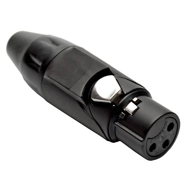

XLR Connectors AX Series Cable Connectors AX SERIES XLR CABLE CONNECTORS The revolutionary AX series of XLR connectors introduce an exciting contemporary look and feel to the professional audio interconnect market. They are designed to complement modern audio architecture and truly “fit” within their environment. An impressive list of features guarantees pure sound performance in the most demanding applications providing unrivalled value. Features • Unique Australian designed shell and housing. • One piece ground / latch spring design incorporating twin wipe contacts for a direct connection path from mating shell to ground providing enhanced connection and EMI performance. • Ergonomic sleeve design for improved grip. • Channel I.D capability with coloured sleeves. • Oversized ergonomic latch for quick and easy mating. • Leading first mate last break pin 1 on socket connectors. • Chuck style cable clamp to suit 3mm - 8mm (0.118” - 0.314”) cable O.D. with integrated split to allow inclusion after soldering. • Concealed latching point for improved aesthetics, sealing and strength. • Overmolded boot with flex bend relief for improved aesthetics, cable protection and boot retention. • Concentric socket contact design provides optimal contact resistance • Precision machined pin contacts as standard. • Compact solder buckets to reduce termination time and material wastage during the soldering process. • Zinc diecast shell housing for robustness and wear with Satin nickel or Black finish. • Available in 3,4 and 5 contact arrangements. 2 Options • Coloured I.D sleeves. • Satin nickel or Black shell finish. • Single or Bulk packaging. • Gold plated contacts. Ordering Codes We have listed the more common ordering codes in each section. For further options please refer to the part number breakdown charts. Please contact us if you need any further assistance. Simple steps to guide you in using this catalogue 1) Identify the product group listed in Contents on page 1 and go directly to that page number. 2) Each product group cover page then details information and options available. 3) Refer to the product detail pages and identify the product you require pictorially. 4) Read the product description column for the products standard features. 5) Use variations column to determine your choice. 6) Identify part number. 7) In the event the particular option you require is not listed please refer to the part number breakdown page at the end of each section. 8) Please contact us directly if you have any further problems. ENTERTAINMENT INTERCONNECT CATALOGUE - Amphenol Australia Pty Ltd +61 3 8796 8888 www.amphenolaudio.com XLR Connectors AX Series Cable Connectors Features: • Unique Australian designed shell and housing. • Ergonomic stylish sleeve design for improved grip. • Oversized latch lever preserves your thumb. • Leading first mate last break pin 1 on socket connectors. • Chuck style cable clamp to suit 3mm - 8mm (0.118” - 0.314”) cable O.D. with integrated split to allow inclusion after soldering. • Overmolded cable support boot. • New socket contact design for improved contact resistance. • Precision machined pin contacts as standard. • Compact solder buckets to reduce soldering time and wastage. • Zinc diecast shell housing with Satin nickel or Matt black finish. • Available in 3,4 and 5 contact arrangements. Options: • Coloured I.D sleeves. • Satin nickel or Matt black shell finish. • Single or Bulk packaging. Part Number Breakdown: Page 5 Specifications: Page 8 Assembly Instructions: Page 6 & 7 PRODUCT - FIGURE DRAWING Dimensions in mm (inches) DESCRIPTION VARIATIONS PART NUMBER XLR 3 pole male Machined contacts Nickel Finish Standard AX3M Bulk Pack AX3M BULK Standard AX3MB Gold Plated Contacts AX3MB-AU Bulk Pack AX3MB BULK Standard AX3F Bulk Pack AX3F BULK Standard AX3FB Gold Plated Contacts AX3FB-AU Bulk Pack AX3FB BULK Standard AX4M Bulk Pack AX4M BULK XLR 3 pole male Machined contacts Black Finish XLR 3 pole female Stamped contacts Nickel Finish XLR 3 pole female Stamped contacts Black Finish XLR 4 pole male Machined contacts Nickel Finish *PI538 is available for download at www.amphenolaudio.com www.amphenolaudio.com ENTERTAINMENT INTERCONNECT CATALOGUE - Amphenol Australia Pty Ltd +61 3 8796 8888 3 XLR Connectors AX Series Cable Connectors PRODUCT - FIGURE DRAWING Dimensions in mm (inches) DESCRIPTION VARIATIONS PART NUMBER XLR 4 pole male Machined contacts Black Finish Standard AX4MB Gold Plated Contacts AX4MB-AU Bulk Pack AX4MB BULK Standard AX4F Bulk Pack AX4F BULK Standard AX4FB Gold Plated Contacts AX4FB-AU Bulk Pack AX4FB BULK Standard AX5M Bulk Pack AX5M BULK Standard AX5MB Gold Plated Contacts AX5MB-AU Bulk Pack AX5MB BULK Standard AX5F Bulk Pack AX5F BULK Standard AX5FB Gold Plated Contacts AX5FB-AU Bulk Pack AX5FB BULK XLR 4 pole female Machined contacts Nickel Finish XLR 4 pole female Machined contacts Black Finish XLR 5 pole male Machined contacts Nickel Finish XLR 5 pole male Machined contacts Black Finish XLR 5 pole female Machined contacts Nickel Finish XLR 5 pole female Machined contacts Black Finish 4 ENTERTAINMENT INTERCONNECT CATALOGUE - Amphenol Australia Pty Ltd +61 3 8796 8888 www.amphenolaudio.com XLR Connectors AX Series Cable Connectors PART NUMBER BREAKDOWN SERIES PREFIX AX = Series Prefix CONTACT LAYOUTS 3 = 3 Contacts 4 = 4 Contacts 5 = 5 Contacts F = Female Socket Contacts M = Male Pin Contacts GENDER SHELL FINISH SLEEVE COLOUR OPTION SLEEVE MARKING CONTACT PLATING Blank = Nickel Plated Finish B Black Finish www.amphenolaudio.com M FI NI SH SL EE VE CO SL LO EE UR VE OP M TI AR ON KI NG CO NT AC T PL AT IN G PA CK AG IN G EL L 3 SH AC T LA GE YO ND UT S ER AX B 2 M - AU BULK Blank = Black 1 = Brown 2 = Red 3 = Orange 4 = Yellow 5 = Green 6 = Blue 7 = Violet 8 = Grey 9 = White Blank = Standard Sleeve 0M = Marking Sleeve (Black) M = Marking Sleeve (Colour) Blank = Standard Plating (Silver or Tin) (Refer to Standard Data) AU PACKAGING = CO NT E. G . AX3MB2M-AU BULK AX (Series Prefix), 3 contacts, Male, Black Finish, 2 (Red Sleeve) M (Sleeve Marking) - AU (Gold Plated Contacts), Bulk Packaged. SE RI ES PR EF IX METAL SHELL TYPE - SOLDER = Gold Plated Blank = Individual Bags BULK = Bulk Packed ENTERTAINMENT INTERCONNECT CATALOGUE - Amphenol Australia Pty Ltd +61 3 8796 8888 5 XLR Connectors AX Series Cable Connectors PI539 ASSEMBLY INSTRUCTIONS 1 AX SERIES FEMALE XLR CABLE CONNECTOR 4 Slide the nut (Backshell) onto the cable 6 2 22 Install the cable clamp, flush to the insert making sure to align the top slot with the spring. Then push the insert & cable clamp together into the shell. 4 5 Strip the cable Close the cable clamp slightly and push the boot over the clamp ensuring the wires fit inside the boot. 7 3 Thread the nut (Backshell) onto the shell (Torque 0.8Nm - 1.2Nm) to activate the cable clamp and close the connector assembly. Final assembly can be achieved either by manually screwing the boot on, or by using an Amphenol Australia T2860 termination tool. Rev 1 - 03/2009 Push back the insert only enough to expose the solder buckets. It is not necessary to remove the insert. Solder the wires to the contacts. 6 ENTERTAINMENT INTERCONNECT CATALOGUE - Amphenol Australia Pty Ltd +61 3 8796 8888 www.amphenolaudio.com XLR Connectors AX Series Cable Connectors PI538 ASSEMBLY INSTRUCTIONS 1 AX SERIES MALE XLR CABLE CONNECTOR 4 Slide the nut (Backshell) onto the cable 2 6 22 Install the cable clamp flush to the insert making sure to align the slot with the ground contact. 4 5 Strip the cable Thread the nut (Backshell) onto the shell (Torque 0.8Nm - 1.2Nm) to activate the cable clamp and close the connector assembly. 3 Align the key of the insert with the keyway on the shell then push the pin insert & cable clamp together in the shell. Rev 1 - 03/2009 Solder the wires to the contacts. www.amphenolaudio.com ENTERTAINMENT INTERCONNECT CATALOGUE - Amphenol Australia Pty Ltd +61 3 8796 8888 7 XLR Connectors AX Series Cable Connectors STANDARD DATA AX SERIES CABLE CONNECTORS VALUE GENERAL CHARACTERISTICS Number of contacts 3 5 AX Series Contact Arrangements (Front view of pin inserts) Termination Max. Wire Gauge - Stranded wire: Solder SOLDER 14AWG Flammability rating of insulator plastics and housings 16AWG 18AWG UL94V-0 Environmental ELECTRICAL CHARACTERISTICS 4 Complies with EU RoHS 2 Directive 2011/65/EU 1) Service Voltage RMS 133V Test Voltage AC RMS 1400V Current carrying capacity: 15A Solder Typicial Contact Resistance ≤3m Ω Insulation Resistance ≥1G Ω CLIMATIC CHARACTERISTICS Protection Class MECHANICAL CHARACTERISTICS Insertion and Withdrawal force Weight 2) Cable O.D. range Mechanical Operations Connector shell - Metal Shell finish Insulators Rev 3 - 03/2013 Boot / Backshell Finish 1) 2) 8 7.5A IP40 Operating Temperature Typical Cable retention force MATERIALS 10A -25˚C to +75˚C (-13°F to -167°F) ≥10N - ≤30N 31g (0.068lb) 33g (0.073lb) 33g (0.073lb) 22Kg to 44Kg (50lb to 100lb) - Dependent on cable material and diameter. 3mm to 8mm (0.118” to 0.314”) 1000 mating cycles Diecast Zinc Alloy Satin nickel or Black UL94V-0 PA66, 30% Glass Filled UL94V-0 Noryl N190 / Santoprene Black, other colours available - see page 80 Cable clamp Noryl N190 Sleeve Noryl N190 Male Contact Machined - Solder / Plating Brass / Silver or Gold (Optional) Female Contact Stamped - Solder / Plating Phosphor Bronze / Tin or Gold (Optional) Not suitable for domestic applications above 50V Approximate weight only, does not include packaging. Please contact us for exact weight for shipping purposes. ENTERTAINMENT INTERCONNECT CATALOGUE - Amphenol Australia Pty Ltd +61 3 8796 8888 www.amphenolaudio.com XLR Connectors AC Series Cable Connectors AC SERIES XLR CABLE CONNECTORS Amphenol Australia have been manufacturing and designing innovative XLR connectors since 1955 The AC series cable connector range complies with IEC268-12 and AES 14-1992 standards. CSA File Number 68598. Jaws Cable Clamp Options Ordering Codes We have listed the more common ordering codes in each section. For further options please refer to the part number breakdown charts. Please contact us if you need any further assistance. Features • AC series XLR connectors feature the unique Australian design and patented “Jaws” cable retention system • A leading first mate last break socket contact is standard on all female connectors (Pin 1). • The “Jaws” cable retention system provides up to 44kg (100lb) of strain. • The AC series connector can be quickly and easily assembled without screws – by hand or portable termination tool. (Part number T2860) • Available in 3, 4, 5, 6A and 7 contact arrangements. • Compatible with all major XLR brands. Standard Jaws cable clamp (Black), Cable O.D 3mm to 6.5mm (0.118” to 0.255”) 1) Identify the product group listed in Contents on page 1 and go directly to that page number. Options • Solder Bucket termination • Thermoplastic shell • Zinc Diecast shell - Satin Nickel Finish • Zinc Diecast shell - Black Polyester Finish • Gold, Silver or Tin Plated contacts • Bulk Style Packaging • Single Bag packs • Precision machined contacts • Cost effective stamped contacts on 3 pole • Standard Jaws cable clamp, Cable O.D 3mm to 6.5mm (0.118” to 0.255”) • Large Jaws cable clamp, Cable O.D 6.5mm to 8mm (0.255” to 0.314”) • Metal Boots / Backshells • Coloured Boots / Backshells • Coloured Identification rings • Termination / Assembly tooling www.amphenolaudio.com Simple steps to guide you in using this catalogue 2) Each product group cover page then details information and options available. 3) Refer to the product detail pages and identify the product you require pictorially. Large Jaws cable clamp (Purple), Cable O.D 6.5mm to 8mm (0.255” to 0.314”) 4) Read the product description column for the products standard features. 5) Use variations column to determine your choice. 6) Identify part number. 7) In the event the particular option you require is not listed please refer to the part number breakdown page at the end of each section. 8) Please contact us directly if you have any further problems. ENTERTAINMENT INTERCONNECT CATALOGUE - Amphenol Australia Pty Ltd +61 3 8796 8888 9 XLR Connectors AC Series Cable Connectors Features: • Zinc Diecast Shell. • Solder Bucket connections. • “Jaws” Cable Retention System. • Contact layouts in 3, 4, 5, 6A and 7. • Precision machined or Stamped contacts. • Leading first mate last break socket contact. • Quick and easy assembly without screws – by hand or portable termination tool. (Part number T2860.) Options: Stamped Contacts (3 contact only), Gold plated contacts, Large or Small Jaws Cable Clamp, Black Finish Shell, Bulk Pack, Coloured Boots / Backshells Part Number Breakdown: Page 13 Specifications: Page 15 PRODUCT - FIGURE DRAWING Dimensions in mm (inches) DESCRIPTION VARIATIONS PART NUMBER XLR 3 pole male, Machined contacts, Nickel Finish, Jaws cable clamp Standard AC3MM Bulk Pack AC3MM BULK Standard AC3MMB Gold Plated Contacts AC3MMB-AU Bulk Pack AC3MMB BULK Standard AC3M Large Cable Clamp AC3MJ Bulk Pack AC3M BULK Standard AC3MB Gold Plated Contacts AC3MB-AU Large Cable Clamp AC3MBJ Bulk Pack AC3MB BULK Standard AC3F Large Cable Clamp AC3FJ Bulk Pack AC3F BULK Standard AC3FB Gold Plated Contacts AC3FB-AU Large Cable Clamp AC3FBJ Bulk Pack AC3FB BULK XLR 3 pole male, Machined contacts, Black Finish, Jaws cable clamp XLR 3 pole male, Stamped contacts, Nickel Finish, Jaws cable clamp XLR 3 pole male, Stamped contacts, Black Finish, Jaws cable clamp XLR 3 pole female, Stamped contacts, Nickel Finish, Jaws cable clamp XLR 3 pole female, Stamped contacts, Black Finish, Jaws cable clamp 10 ENTERTAINMENT INTERCONNECT CATALOGUE - Amphenol Australia Pty Ltd +61 3 8796 8888 www.amphenolaudio.com XLR Connectors AC Series Cable Connectors PRODUCT - FIGURE DRAWING Dimensions in mm (inches) DESCRIPTION VARIATIONS PART NUMBER XLR 4 pole male, Machined contacts, Nickel Finish, Jaws cable clamp Standard AC4M Large Cable Clamp AC4MJ Bulk Pack AC4M BULK Standard AC4MB Gold Plated Contacts AC4MB-AU Large Cable Clamp AC4MBJ Bulk Pack AC4MB BULK Standard AC4F Large Cable Clamp AC4FJ Bulk Pack AC4F BULK Standard AC4FB Gold Plated Contacts AC4FB-AU Large Cable Clamp AC4FBJ Bulk Pack AC4FB BULK Standard AC5M Large Cable Clamp AC5MJ Bulk Pack AC5M BULK Standard AC5MB Gold Plated Contacts AC5MB-AU Large Cable Clamp AC5MBJ Bulk Pack AC5MB BULK Standard AC5F Large Cable Clamp AC5FJ Bulk Pack AC5F BULK Standard AC5FB Gold Plated Contacts AC5FB-AU Large Cable Clamp AC5FBJ Bulk Pack AC5FB BULK XLR 4 pole male, Machined contacts, Black Finish, Jaws cable clamp XLR 4 pole female, Machined contacts, Nickel Finish, Jaws cable clamp XLR 4 pole female, Machined contacts, Black Finish, Jaws cable clamp XLR 5 pole male, Machined contacts, Nickel Finish, Jaws cable clamp XLR 5 pole male, Machined contacts, Black Finish, Jaws cable clamp XLR 5 pole female, Machined contacts, Nickel Finish, Jaws cable clamp XLR 5 pole female, Machined contacts, Black Finish, Jaws cable clamp www.amphenolaudio.com ENTERTAINMENT INTERCONNECT CATALOGUE - Amphenol Australia Pty Ltd +61 3 8796 8888 11 XLR Connectors AC Series Cable Connectors PRODUCT - FIGURE DRAWING Dimensions in mm (inches) DESCRIPTION VARIATIONS PART NUMBER XLR 6A pole male, Machined contacts, Nickel Finish, Jaws cable clamp Standard AC6AM Large Cable Clamp AC6AMJ Bulk Pack AC6AM BULK Standard AC6AMB Gold Plated Contacts AC6AMB-AU Large Cable Clamp AC6AMBJ Bulk Pack AC6AMB BULK Standard AC6AF Large Cable Clamp AC6AFJ Bulk Pack AC6AF BULK Standard AC6AFB Gold Plated Contacts AC6AFB-AU Large Cable Clamp AC6AFBJ Bulk Pack AC6AFB BULK Standard AC7M Large Cable Clamp AC7MJ Bulk Pack AC7M BULK Standard AC7MB Large Cable Clamp AC7MBJ Bulk Pack AC7MB BULK Standard AC7F Large Cable Clamp AC7FJ Bulk Pack AC7F BULK Standard AC7FB Large Cable Clamp AC7FBJ Bulk Pack AC7FB BULK XLR 6A pole male, Machined contacts, Black Finish, Jaws cable clamp XLR 6A pole female, Machined contacts, Nickel Finish, Jaws cable clamp XLR 6A pole female, Machined contacts, Black Finish, Jaws cable clamp XLR 7 pole male, Gold plated Machined contacts, Nickel Finish, Jaws cable clamp XLR 7 pole male, Gold plated Machined contacts, Black Finish, Jaws cable clamp XLR 7 pole female, Gold plated Machined contacts, Nickel Finish, Jaws cable clamp XLR 7 pole female, Gold plated Machined contacts, Black Finish, Jaws cable clamp 12 ENTERTAINMENT INTERCONNECT CATALOGUE - Amphenol Australia Pty Ltd +61 3 8796 8888 www.amphenolaudio.com XLR Connectors SERIES PREFIX AC = Series Prefix CONTACT LAYOUTS 3 = 3 Contacts 4 = 4 Contacts 5 = 5 Contacts 6A = 6 Contacts 7 = 7 Contacts F = Female Socket Contacts M = Male Pin Contacts Blank = Stamped Contacts M = Machined Contacts G = Stamped Contacts, Ground Tag GENDER CONTACT1 M M B J - IN G CK AG IN G PL AT T AC CO NT 3 PA AC CO NT E. G . AC3MMBJ-AU BULK AC (Series Prefix), 3 contacts, Male, Machined Contacts, Black Polyester Finish, J (Large Jaws),- AU (Gold Plated Contacts), Bulk Packaged. SE RI ES METAL SHELL TYPE - SOLDER PR EF IX PART NUMBER BREAKDOWN AC T GE LA ND YO ER UT S CO NT AC T SH EL L FI NI SH CA BL E CL AM P AC Series Cable Connectors AU BULK MG = Machined Contacts, Ground Tag (Applicable 3 male pin contacts, option M & MG only) SHELL FINISH2 CABLE CLAMP CONTACT PLATING3 Blank = Nickel Plated Finish B Black Polyester Finish Blank = Standard Jaws 3mm - 6.5mm cable O.D. (0.118” to 0.255”) J = Large Jaws 6.5mm - 8mm cable O.D. (0.255” to 0.314”) Blank = Standard Plating (Silver or Tin) (Refer to Standard Data) AU PACKAGING = = Gold Plated Blank = Individual Bags BULK = Bulk Packed Note: 1 4 - 7 contact connectors have machined contacts and grounding as standard. Ground contacts are not supplied with the black polyester finish shell option. 3 7 Contact is gold plated as standard. 4 All AC Series Connectors are available with optional colour coded boot / backshell. Refer to page 135 and simply add colour to end of part number. Example: AC3MM - RED 2 www.amphenolaudio.com ENTERTAINMENT INTERCONNECT CATALOGUE - Amphenol Australia Pty Ltd +61 3 8796 8888 13 XLR Connectors AC Series Cable Connectors Features: • Thermoplastic Shell. • Solder Bucket Connections. • “Jaws” Cable Retention System. • Stamped or Machined Contacts. • Leading first mate last break socket contact. • Quick and easy assembly without screws – by hand or portable termination tool. (Part number T2860.) Options: Gold Plated Contacts, Stamped Contacts (3 Contact only), Bulk Pack, Coloured Boots / Backshells 3, 4, 5, 6A and 7 Contacts. Specifications: Page 15 PRODUCT - FIGURE DRAWING Dimensions in mm (inches) DESCRIPTION VARIATIONS PART NUMBER XLR 3 pole male, Machined contacts, Thermoplastic shell, Jaws cable clamp Standard AC3MMCP Bulk Pack AC3MMCP BULK Standard AC3MCP Bulk Pack AC3MCP BULK Standard AC3FCP Bulk Pack AC3FCP BULK XLR 3 pole male, Stamped contacts, Thermoplastic shell, Jaws cable clamp XLR 3 pole female, Stamped contacts, Thermoplastic shell, Jaws cable clamp Note: Thermoplastic shell connectors are also available in 4 - 7 contact arrangements, please contact us for ordering code. 14 ENTERTAINMENT INTERCONNECT CATALOGUE - Amphenol Australia Pty Ltd +61 3 8796 8888 www.amphenolaudio.com XLR Connectors AC Series Cable Connectors STANDARD DATA AC CABLE CONNECTORS VALUE GENERAL CHARACTERISTICS Number of contacts 3 4 5 SOLDER Max. Wire Gauge - Stranded wire: Solder 14AWG 16AWG 18AWG Environmental Complies with EU RoHS 2 Directive 2011/65/EU Service Voltage RMS 133V 1 Test Voltage AC RMS 1400V Current carrying capacity: Solder 15A 10A ≤3mΩ Insulation Resistance ≥1GΩ CLIMATIC CHARACTERISTICS Protection Class MECHANICAL CHARACTERISTICS Insertion and Withdrawal force -25˚C to +75˚C (-13°F to +167°F) ≥10N - ≤30N Weight - Metal 2 36g (0.080lb) 37g (0.081lb) 38g (0.083lb) Weight - Thermoplastic 2 18g (0.039lb) 19g (0.041lb) 20g (0.044lb) 22Kg to 44Kg (50lb to 100lb) - Dependent on cable material and diameter. Standard Large 3mm to 6.5mm (0.118” to 0.255”) 6.5mm to 8mm ( 0.255” to 0.314”) Mechanical Operations 1000 mating cycles Connector shell - Metal Diecast Zinc Alloy Shell finish Satin nickel or Black polyester Connector shell - Thermoplastic Thermoplastic, UL94V-0 Modified PPE Resin Shell finish Black Insulators UL94V-0 PBT Resin or Modified PPE Resin Boot / Backshell UL94V-0 Modified PPE Resin or Machined Brass Finish Black, other colours available - see page 135 Cable clamp (JAWS) Standard Solder UL94V-0 Modified PPO Resin (Black) Large Solder UL94V-0 Modified PPO Resin (Purple) Cable Bushing Rev 6 - 03/2015 5A IP40 Operating Temperature Cable O.D. range - JAWS clamp 2) 7.5A Typical Contact Resistance Typical Cable retention force 1) 20AWG UL94V-0 Flammability rating (insulator plastics & housings) MATERIALS 7 AC Series Contact Arrangements (Front view of pin inserts) Termination ELECTRICAL CHARACTERISTICS 6A Santoprene Male Contact (Solder / Plating) Stamped Phosphor Bronze / Silver or Gold (Optional) Machined Brass / Silver or Gold (Optional) Female Contact (Solder / Plating) Stamped Phosphor Bronze / Tin or Gold (Optional) Machined Brass / Silver or Gold (Optional) Not suitable for domestic applications above 50V Approximate weight only, does not include packaging. Please contact us for exact weight for shipping purposes. www.amphenolaudio.com ENTERTAINMENT INTERCONNECT CATALOGUE - Amphenol Australia Pty Ltd +61 3 8796 8888 15 XLR Connectors Chassis Mount XLR METAL CHASSIS MOUNT CONNECTORS The metal chassis mount connectors are designed for the audio user where durability, reliability and strength across a wide range of applications are important. All products are manufactured to the highest quality standards and will withstand the harshest environments. This range complies with IEC268-12 and AES 14-1992 standards. CSA File Number 68598 Features • The “D” size housing can be either front or rear mounted using the same panel cutout. • The “P” size housing is the original wide flange front mounting XLR connector. “PN” is the original narrow flange front mounting male connector. • A leading first mate last break socket contact is standard on all female connectors (Pin 1). • Solder cup or Vertical PCB versions. • Connectors are fitted with a grounding system for RFI shielding applications. Note: A ground tag is standard on all AC “Z” series connectors. Although the ground tag is intended for RFI shielding applications, Amphenol cannot guarantee its effectiveness in all cases. The non-conductive Black polyester finish insulates the ground tag from the shell and should not be used in applications requiring ground contact to the shell. Ordering Codes We have listed the more common ordering codes in each section. For further options please refer to the part number breakdown charts. Please contact us if you need any further assistance. Simple steps to guide you in using this catalogue 1) Identify the product group listed in Contents on page 1 and go directly to that page number. 2) Each product group cover page then details information and options available. 3) Refer to the product detail pages and identify the product you require pictorially. 4) Read the product description column for the products standard features. 5) Use variations column to determine your choice. 6) Identify part number. 7) In the event the particular option you require is not listed please refer to the part number breakdown page at the end of each section. 8) Please contact us directly if you have any further problems. • Available in 3, 4, 5, 6A and 7 contact arrangements. • Compatible with all other XLR brands. Options • Solder Bucket termination • Vertical PCB contacts • Zinc Diecast Shell - Satin Nickel Finish • Zinc Diecast Shell - Black Polyester Finish • Gold, Silver or Tin Plated Contacts • Bulk Packaging • Single Bag packs • Precision machined contacts • Cost effective stamped contacts on 3 pole • Latchless versions (Non-Latching) (Female only) 16 ENTERTAINMENT INTERCONNECT CATALOGUE - Amphenol Australia Pty Ltd +61 3 8796 8888 www.amphenolaudio.com XLR Connectors AX Series Chassis Mount Features: • Zinc Diecast Shell. • D size housing can be front or rear mounted using the same panel cutout. • Solder Bucket connections. • Vertical PCB mounting. • Precision machined or Stamped contacts (3 pin only). • Leading first mate last break socket contact. • Positive latch lock system. • M3 threaded holes (Optional). Options: Stamped contacts (3 contact only), Gold plated contacts, Vertical PCB contacts, Black finish, Non-Latching (Female only), Bulk Pack. Part Number Breakdown: Page 20 Specifications: Page 26 PRODUCT DRAWING Dimensions in mm (inches) DESCRIPTION VARIATIONS PART NO. XLR 3 pole male, D Flange, Machined contacts, Nickel Finish Standard AX3MD M3 Threaded Holes AX3MD-M3 Vertical PCB AX3MDV M3 Threaded Holes AX3MDV-M3 Standard AX3MDB M3 Threaded Holes AX3MDB-M3 Gold Plated Contacts AX3MDB-AU Vertical PCB AX3MDVB M3 Threaded Holes AX3MDVB-M3 Standard AX3FD M3 Threaded Holes AX3FD-M3 Standard AX3FDB M3 Threaded Holes AX3FDB-M3 Gold Plated Contacts AX3FDB-AU XLR 3 pole male, D Flange, Machined contacts, Black Finish XLR 3 pole female, D Flange, Stamped contacts, Nickel Finish XLR 3 pole female, D Flange, Stamped contacts, Black Finish www.amphenolaudio.com ENTERTAINMENT INTERCONNECT CATALOGUE - Amphenol Australia Pty Ltd +61 3 8796 8888 17 XLR Connectors AX Series Chassis Mount PRODUCT DRAWING Dimensions in mm (inches) DESCRIPTION VARIATIONS PART NO. XLR 4 pole male, D Flange, Machined contacts, Nickel Finish Standard AX4MD M3 Threaded Holes AX4MD-M3 Vertical PCB AX4MDV M3 Threaded Holes AX4MDV-M3 Standard AX4MDB Gold Plated Contacts AX4MDB-AU Vertical PCB AX4MDVB Standard AX4FD M3 Threaded Holes AX4FD-M3 Vertical PCB AX4FDV M3 Threaded Holes AX4FDV-M3 Standard AX4FDB Gold Plated Contacts AX4FDB-AU Vertical PCB AX4FDVB Standard AX5MD M3 Threaded Holes AX5MD-M3 Vertical PCB AX5MDV M3 Threaded Holes AX5MDV-M3 Standard AX5MDB Gold Plated Contacts AX5MDB-AU Vertical PCB AX5MDVB XLR 4 pole male, D Flange, Machined contacts, Black Finish XLR 4 pole female, D Flange, Machined contacts, Nickel Finish XLR 4 pole female, D Flange, Machined contacts, Black Finish XLR 5 pole male, D Flange, Machined contacts, Nickel Finish XLR 5 pole male, D Flange, Machined contacts, Black Finish 18 ENTERTAINMENT INTERCONNECT CATALOGUE - Amphenol Australia Pty Ltd +61 3 8796 8888 www.amphenolaudio.com XLR Connectors AX Series Chassis Mount PRODUCT DRAWING Dimensions in mm (inches) DESCRIPTION VARIATIONS PART NO. XLR 5 pole female, D Flange, Machined contacts, Nickel Finish Standard AX5FD M3 Threaded Holes AX5FD-M3 Vertical PCB AX5FDV M3 Threaded Holes AX5FDV-M3 Standard AX4FDB Gold Plated Contacts AX4FDB-AU Vertical PCB AX4FDVB Standard AX6AMD M3 Threaded Holes AX6AMD-M3 Vertical PCB AX6AMDV M3 Threaded Holes AX6AMDV-M3 Standard AX6AMDB Gold Plated Contacts AX6AMDB-AU Vertical PCB AX6AMDVB Standard AX6AFD M3 Threaded Holes AX6AFD-M3 Vertical PCB AX6AFDV M3 Threaded Holes AX6AFDV-M3 Standard AX6AFDB Gold Plated Contacts AX6FADB-AU Vertical PCB AX6AFDVB XLR 5 pole female, D Flange, Machined contacts, Black Finish XLR 6A pole male, D Flange, Machined contacts, Nickel Finish XLR 6A pole male, D Flange, Machined contacts, Black Finish XLR 6A pole female, D Flange, Machined contacts, Nickel Finish XLR 6A pole female, D Flange, Machined contacts, Black Finish www.amphenolaudio.com ENTERTAINMENT INTERCONNECT CATALOGUE - Amphenol Australia Pty Ltd +61 3 8796 8888 19 XLR Connectors AX Series Chassis Mount PR EF CO IX NT A GE CT ND LA ER YO UT SH S EL L ST SH YL EL E L SH SER EL IE S L FI NI SH CO NT AC T PL AT IN G M OU NT IN G HO LE PA CK AG IN G PART NUMBER BREAKDOWN SE RI ES METAL TYPE FLANGE E. G . AX3MDVB-AU-M3 BULK AX (Series Prefix), 3 contacts, Male, D Small Flange, Vertical PCB Contact, Black Polyester Finish, - AU (Gold Plated Contacts), - M3 Mounted Holes, BULK Packaged. SERIES PREFIX CONTACT LAYOUTS GENDER SHELL STYLE SHELL SERIES SHELL FINISH1 CONTACT PLATING2 MOUNTING HOLES PACKAGING AX = Series Prefix 3 = 3 Contacts 4 = 4 Contacts 5 = 5 Contacts 6A = 6 Contacts F = Female Socket Contacts M = Male Pin Contacts AX 3 M D V B - AU - M3 BULK D = Small Flange (front or rear mounting) Blank = Solder Bucket V = Vertical PCB Contact Blank = Nickel Plated Finish B = Black Polyester Finish Blank = Standard Plating AU = Gold Plated Blank = Through Holes M3 = M3 Threaded Holes Blank = Individual Bags BULK = Bulk Packed Note: 20 1 Ground contacts are not supplied with the black polyester finish shell option. 3 Non-Latching Versions (Female) available - Please contact us for part number options. ENTERTAINMENT INTERCONNECT CATALOGUE - Amphenol Australia Pty Ltd +61 3 8796 8888 www.amphenolaudio.com XLR Connectors AC “Z” Series Chassis Mount Features: • Zinc Diecast Shell. • D size housing can be front or rear mounted using the same panel cutout. • Solder Bucket connections. • Precision machined or Stamped contacts (3 pin only). • Leading first mate last break socket contact. • Positive latch lock system. Options: Stamped contacts (3 contact only), Gold plated contacts, Black finish, Non-Latching (Female only), Bulk Pack. Part Number Breakdown: Page 25 Specifications: Page 26 PCB Footprints: Page 27 Panel Cutouts: Page 27 PRODUCT - FIGURE DRAWING Dimensions in mm (inches) DESCRIPTION VARIATIONS PART NUMBER XLR 3 pole male, D Flange, Machined contacts, Nickel Finish Standard AC3MMDZ Bulk Pack AC3MMDZ BULK Standard AC3MMDZB Gold Plated Contacts AC3MMDZB-AU Standard AC3MDZ Bulk Pack AC3MDZ BULK Standard AC3MDZB Gold Plated Contacts AC3MDZB-AU Standard AC3FDZ Bulk Pack AC3FDZ BULK Standard AC3FDZB Gold Plated Contacts AC3FDZB-AU XLR 3 pole male, D Flange, Machined contacts, Black Finish XLR 3 pole male, D Flange, Stamped contacts, Nickel Finish XLR 3 pole male, D Flange, Stamped contacts, Black Finish XLR 3 pole female, D Flange, Stamped contacts, Nickel Finish XLR 3 pole female, D Flange, Stamped contacts, Black Finish www.amphenolaudio.com ENTERTAINMENT INTERCONNECT CATALOGUE - Amphenol Australia Pty Ltd +61 3 8796 8888 21 XLR Connectors AC “Z” Series Chassis Mount PRODUCT - FIGURE DRAWING Dimensions in mm (inches) DESCRIPTION VARIATIONS PART NUMBER XLR 4 pole male, D Flange, Machined contacts, Nickel Finish Standard AC4MDZ Bulk Pack AC4MDZ BULK Standard AC4MDZB Gold Plated Contacts AC4MDZB-AU Standard AC4FDZ Bulk Pack AC4FDZ BULK Standard AC4FDZB Gold Plated Contacts AC4FDZB-AU Standard AC5MDZ Bulk Pack AC5MDZ BULK Standard AC5MDZB Gold Plated Contacts AC5MDZB-AU Standard AC5FDZ Bulk Pack AC5FDZ BULK Standard AC5FDZB Gold Plated Contacts AC5FDZB-AU XLR 4 pole male, D Flange, Machined contacts, Black Finish XLR 4 pole female, D Flange, Machined contacts, Nickel Finish XLR 4 pole female, D Flange, Machined contacts, Black Finish XLR 5 pole male, D Flange, Machined contacts, Nickel Finish XLR 5 pole male, D Flange, Machined contacts, Black Finish XLR 5 pole female, D Flange, Machined contacts, Nickel Finish XLR 5 pole female, D Flange, Machined contacts, Black Finish 22 ENTERTAINMENT INTERCONNECT CATALOGUE - Amphenol Australia Pty Ltd +61 3 8796 8888 www.amphenolaudio.com XLR Connectors AC “Z” Series Chassis Mount PRODUCT - FIGURE DRAWING Dimensions in mm (inches) DESCRIPTION VARIATIONS PART NUMBER XLR 6A pole male, D Flange, Machined contacts, Nickel Finish Standard AC6AMDZ Bulk Pack AC6AMDZ BULK Standard AC6AMDZB Gold Plated Contacts AC6AMDZB-AU Standard AC6AFDZ Bulk Pack AC6AFDZ BULK Standard AC6AFDZB Gold Plated Contacts AC6AFDZB-AU Standard AC7MDZ Vertical PCB AC7MDZV Bulk Pack AC7MDZ BULK XLR 7 pole male, D Flange, Gold Plated Machined contacts, Black Finish Standard AC7MDZB Vertical PCB AC7MDZVB XLR 7 pole female, D Flange, Gold Plated Machined contacts, Nickel Finish Standard AC7FDZ Vertical PCB AC7FDZV Bulk Pack AC7FDZ BULK Standard AC7FDZB Vertical PCB AC7FDZVB XLR 6A pole male, D Flange, Machined contacts, Black Finish XLR 6A pole female, D Flange, Machined contacts, Nickel Finish XLR 6A pole female, D Flange, Machined contacts, Black Finish XLR 7 pole male, D Flange, Gold Plated Machined contacts, Nickel Finish XLR 7 pole female, D Flange, Gold Plated Machined contacts, Black Finish www.amphenolaudio.com ENTERTAINMENT INTERCONNECT CATALOGUE - Amphenol Australia Pty Ltd +61 3 8796 8888 23 XLR Connectors AC “Z” Series Chassis Mount Features: • Zinc Diecast shell. • The P size housing is the original wide flange front mounting XLR connector. PN is the original narrow, front mounting male connector. • Solder Bucket connections. • Precision Machined or Stamped contacts (3 pin only). • Leading first mate last break socket contact. • Positive latch lock system. Options: Stamped contacts (3 contact only), Gold plated contacts, Black Finish, Non-Latching (Female only), Bulk Pack. Part Number Breakdown: Page 20 PCB Footprints: Page 27 PRODUCT - FIGURE DRAWING Dimensions in mm (inches) DESCRIPTION POLES Specifications: Page 26 Panel Cutouts: Page 27 PART NUMBER XLR male, Narrow flange, Machined contacts 3 AC3MMPNZ XLR male, Narrow flange, Stamped contacts, 3 AC3MPNZ 4 AC4MPNZ 5 AC5MPNZ 6 AC6AMPNZ 7 AC7MPNZ XLR male, Wide flange, Machined contacts 3 AC3MMP XLR male, Wide flange, Stamped contacts 3 AC3MP 4 AC4MP 5 AC5MP 6 AC6AMP 7 AC7MP 3 AC3FPZ 4 AC4FPZ 5 AC5FPZ 6 AC6AFPZ 7 AC7FPZ XLR female, Wide flange, Stamped contacts *Black finish available on special request please contact factory. 24 ENTERTAINMENT INTERCONNECT CATALOGUE - Amphenol Australia Pty Ltd +61 3 8796 8888 www.amphenolaudio.com XLR Connectors AC “Z” Series Chassis Mount SE RI ES METAL TYPE FLANGE E. G . AC3MMPNZVB-AU BULK AC (Series Prefix), 3 contacts, Male, Machined Contacts, PN (Narrow Flange), Z (Metal Chassis Series), Black Polyester Finish, - AU (Gold Plated Contacts), Bulk Packaged. SERIES PREFIX CONTACT LAYOUTS GENDER MACHINED CONTACTS1 AC = Series Prefix 3 = 3 Contacts 4 = 4 Contacts 5 = 5 Contacts 6A = 6 Contacts 7 = 7 Contacts F = Female Socket Contacts M = Male Pin Contacts Blank = Stamped Contacts M = Machined Contacts CO NT PR EF IX AC T GE LA ND YO E UT CO R S NT AC T SH EL TYP L ST E YL SH E EL L SH SER EL IE S L FI NI SH CO NT AC T PL AT IN PA G CK AG IN G PART NUMBER BREAKDOWN AC 3 M M PN Z B - AU BULK (Applicable 3 male pin contacts only) D = Small Flange (front or rear mounting) SHELL STYLE P = Large Shell with Wide Flange PN = Large Shell with Narrow Flange (male only) SHELL SERIES SHELL FINISH2 Blank = Male P Shell Style Only Z = Metal Chassis Series Blank = Nickel Plated Finish B = Black Polyester Finish Blank = Standard Plating (Silver or Tin - refer to Standard Data) CONTACT PLATING3 PACKAGING AU = Gold Plated Blank = Individual Bags BULK = Bulk Packed Note: 1 4 - 7 contact connectors have machined contacts and grounding as standard. They are not available in stamped contacts. 2 Ground contacts are not supplied with the black polyester finish shell option. 3 7 Contact is gold plated as standard. 4 Non-Latching Versions (Female) available - Please contact us for part number options. www.amphenolaudio.com ENTERTAINMENT INTERCONNECT CATALOGUE - Amphenol Australia Pty Ltd +61 3 8796 8888 25 XLR Connectors AC / AX Series Chassis Mount STANDARD DATA AC / AX SERIES CHASSIS - METAL “Z” VALUE GENERAL CHARACTERISTICS Number of contacts 3 4 5 7 Contact Arrangement (Front view of pin inserts) Termination Max. Wire Gauge - Stranded wire: Solder Printed Circuit Board - PCB Solder Bucket / Printed Circuit Board (PCB) 14AWG N/A 16AWG N/A 18AWG N/A Flammability rating of plastics 18AWG N/A 20AWG N/A UL94V-0 Environmental ELECTRICAL CHARACTERISTICS 6A Complies with EU RoHS 2 Directive 2011/65/EU 1) Service Voltage RMS 133V Test Voltage AC RMS 1400V Current carrying capacity: Solder 15A 10A 7.5A 7.5A 5A Printed Circuit Board (PCB) 15A 10A 7.5A 7.5A 5A Typical Contact Resistance ≤3mΩ Insulation Resistance CLIMATIC CHARACTERISTICS Protection Class MECHANICAL CHARACTERISTICS Weight - Metal 2) IP40 Operating Temperature Mechanical Operations MATERIALS ≥1000MΩ Connector Shell -25˚C to +75˚C (-13°F to +167°F) 31g 32g 33g 33g 33g (0.068lb) (0.070lb) (0.072lb) (0.072lb) (0.072lb) 1000 mating cycles Diecast Zinc Alloy Shell Finish Satin Nickel or Black Polyester Insulators PA66 30% Glass Filled Resin Male Contact Stamped Solder and PCB-(Material/Plating) Machined Solder-(Material/Plating) Phosphor Bronze / Silver or Gold (optional) Brass / Silver or Gold (optional) Rev 4 - 02/2020 Female Contact 26 Stamped Solder and PCB-(Material/Plating) Machined Solder-(Material/Plating) Phosphor Bronze / Tin or Gold (optional) Brass / Silver or Gold (Optional) 1) Not suitable for domestic applications above 50V 2) Approximate weight only, does not include packaging. Please contact us for exact weight for shipping purposes. ENTERTAINMENT INTERCONNECT CATALOGUE - Amphenol Australia Pty Ltd +61 3 8796 8888 www.amphenolaudio.com XLR Connectors AC / AX Series Chassis Mount AC / AX SERIES CHASSIS METAL “Z” PCB FOOTPRINTS STRAIGHT (V) AC3MM*ZV CONNECTOR SIDE OF PCB AC4F*ZV ø1.2mm(.05”) + Panel Cutout CL AC4M*ZV AC5F*ZV AC7M*ZV AC5M*ZV AC6AF*ZV AC6AM*ZV AC7F*ZV AX3FD AX3MD AX4FD AX4MD AX5FD AX5MD AX6AFD AX6AMD PANEL CUTOUT DIMENSIONS AC*FDZ / AX*FD www.amphenolaudio.com FRONT VIEW AC*MDZ / AX*MD AC*FPZ AC*MP ENTERTAINMENT INTERCONNECT CATALOGUE - Amphenol Australia Pty Ltd +61 3 8796 8888 AC*MPNZ 27 XLR Connectors AC Series PCB Chassis Mount AC SERIES XLR PCB CHASSIS MOUNT CONNECTORS The AC series, A and B type XLR chassis receptacles have been designed and manufactured with the Original Equipment Manufacturers’ (OEM) needs in mind. The compact shell design allows a significant space saving over the traditional ‘D’ type shell. Gold plated contacts improve the performance, ensuring a reliable contact and the unique grounding link options offer flexibility in design. Options • Vertical PCB contacts • Horizontal PCB contacts • Precision Machined Pin contacts • Cost effective Stamped Socket contacts • Gold Plated contacts (Standard) • Silver Plated contacts (Optional) • Bulk Packaging • Integrated Switch Ordering Codes Features • A leading first mate last break socket contact is standard on all female connectors (Pin 1). • Vertical and Horizontal PCB versions available. • Latching and Non-latching versions available. We have listed the more common ordering codes in each section. For further options please refer to the part number breakdown charts. Please contact us if you need any further assistance. Simple steps to guide you in using this catalogue 1) Identify the product group listed in Contents on page 1 and go directly to that page number. 2) Each product group cover page then details information and options available. 3) Refer to the product detail pages and identify the product you require pictorially. 4) Read the product description column for the products standard features. 5) Use variations column to determine your choice. 6) Identify part number. • A range of different grounding options are available including: - Mating connector shell to Pin 1 - Mating connector shell to Chassis - Mating connector shell to pin 1 to Chassis 7) In the event the particular option you require is not listed please refer to the part number breakdown page at the end of each section. 8) Please contact us directly if you have any further problems. • A type is available in 3, 4 or 5 contacts. • B type is available in 3 contact only. • Compatible with all other XLR brands. • Metal Mounting Flange (B type) 28 ENTERTAINMENT INTERCONNECT CATALOGUE - Amphenol Australia Pty Ltd +61 3 8796 8888 www.amphenolaudio.com XLR Connectors AC Series PCB Chassis Mount (A Type) Features: • Thermoplastic Shell • Contact layouts in 3,4 or 5 • Industry standard PCB footprints. • Vertical or Horizontal PCB mounting. • Precision machined pin contacts. • Gold plated contacts. • Leading first mate last break socket contact. • Bulk packed in trays, 100 to a box as standard. • Positive latch lock system. Options: Vertical or Horizontal PCB, Various grounding methods, Latching or Non-Latching. Part Number Breakdown: Page 36 Specifications: Page 39 PCB Footprints: Page 40 Panel Cutouts: Page 41 Recommended Fastener: Page 133 PRODUCT - FIGURE www.amphenolaudio.com DRAWING Dimensions in mm (inches) GROUND LINK PART NUMBER XLR 3 pole male, Horizontal PCB, Gold Plated Contacts, Bulk Pack No Ground Link AC3MAH-AU-PRE XLR 3 pole male, Horizontal PCB, Gold Plated Contacts, Bulk Pack Pin 1 to Chassis to Mating connector shell AC3MAH1-AU-PRE XLR 3 pole male, Horizontal PCB, Gold Plated Contacts, Bulk Pack Mating connector shell to Chassis Pin 1 sep. Ground AC3MAH2-AU-PRE XLR 3 pole male with integrated switch, Horizontal PCB, Gold Plated Contacts, Bulk Pack Mating connector shell to Chassis to PCB, Pin 1 sep. Ground AC3MAH4-SW-B XLR 3 pole male, Vertical PCB, Gold Plated Contacts, Bulk Pack No Ground Link DESCRIPTION VARIATIONS ENTERTAINMENT INTERCONNECT CATALOGUE - Amphenol Australia Pty Ltd +61 3 8796 8888 AC3MAV-AU-PRE 29 XLR Connectors AC Series PCB Chassis Mount (A Type) PRODUCT - FIGURE 30 DRAWING Dimensions in mm (inches) GROUND LINK PART NUMBER XLR 3 pole male, Vertical PCB, Gold Plated Contacts, Bulk Pack Mating connector shell to Chassis Pin 1 sep. Ground AC3MAV2-AU-PRE XLR 3 pole male, Solder Buckets, Gold Plated Contacts, Bulk Pack No Ground Link AC3MA-AU-B XLR 3 pole female, Horizontal PCB, Latching Type, Gold Plated Contacts, Bulk Pack No Ground Link AC3FAH-AU-PRE XLR 3 pole female, Horizontal PCB, Latching Type, Gold Plated Contacts, Bulk Pack Pin 1 to Chassis to Mating connector shell AC3FAH1-AU-PRE XLR 3 pole female, Horizontal PCB, Latching Type, Gold Plated Contacts, Bulk Pack Mating connector shell to Chassis Pin 1 sep. Ground AC3FAH2-AU-PRE XLR 3 pole female, Horizontal PCB, Non-Latching Type Gold Plated Contacts, Bulk Pack No Ground Link AC3FAHL-AU-PRE XLR 3 pole female, Horizontal PCB, Non-Latching Type Gold Plated Contacts, Bulk Pack Pin 1 to Chassis to mating connector shell AC3FAHL1-AU-PRE XLR 3 pole female, Horizontal PCB, Non-Latching Type Gold Plated Contacts, Bulk Pack Mating connector shell to Chassis Pin 1 sep. Ground. AC3FAHL2-AU-PRE XLR 3 pole female, Vertical PCB, Latching Type, Gold Plated Contacts, Bulk Pack No Ground Link AC3FAV-AU-PRE XLR 3 pole female, Vertical PCB, Latching Type, Gold Plated Contacts, Bulk Pack Pin 1 to Chassis to Mating connector shell AC3FAV1-AU-PRE DESCRIPTION VARIATIONS ENTERTAINMENT INTERCONNECT CATALOGUE - Amphenol Australia Pty Ltd +61 3 8796 8888 www.amphenolaudio.com XLR Connectors AC Series PCB Chassis Mount (A Type) PRODUCT - FIGURE www.amphenolaudio.com DRAWING Dimensions in mm (inches) DESCRIPTION GROUND LINK VARIATIONS PART NUMBER XLR 3 pole female, Vertical PCB, Latching Type, Gold Plated Contacts, Bulk Pack Mating connector shell to Chassis Pin 1 sep. Ground. AC3FAV2-AU-PRE XLR 3 pole female, Vertical PCB, Non-Latching Type, Gold Plated Contacts, Bulk Pack No Ground Link AC3FAVL-AU-PRE XLR 3 pole female, Vertical PCB, Non-Latching Type, Gold Plated Contacts, Bulk Pack Pin 1 to Chassis to Mating connector shell AC3FAVL1-AU-PRE XLR 3 pole female, Vertical PCB, Non-Latching Type, Gold Plated Contacts, Bulk Pack Mating connector shell to Chassis Pin 1 sep. Ground. AC3FAVL2-AU-PRE XLR 4 pole male, Horizontal PCB, Gold Plated Contacts, Bulk Pack Mating connector shell to Chassis - Pin 1 sep. Ground AC4MAH-AU-B XLR 5 pole male, Horizontal PCB, Gold Plated Contacts, Bulk Pack Mating connector shell to Chassis to PCB, Pin 1 sep. Ground AC5MAH-AU-B XLR 5 pole male, Vertical PCB, Gold Plated Contacts, Bulk Pack Mating connector shell to Chassis to PCB, Pin 1 sep. Ground AC5MAV-AU-B XLR 5 pole female, Horizontal PCB, Gold Plated Contacts, Bulk Pack Mating connector shell to Chassis to PCB, Pin 1 sep. Ground AC5FAH-AU-B XLR 5 pole female, Vertical PCB, Gold Plated Contacts, Bulk Pack Mating connector shell to Chassis to PCB, Pin 1 sep. Ground AC5FAV-AU-B ENTERTAINMENT INTERCONNECT CATALOGUE - Amphenol Australia Pty Ltd +61 3 8796 8888 31 XLR Connectors AC Series PCB Chassis Mount (B Type) Features: • Thermoplastic Shell with Metal Mounting Flange • Contact layouts in 3 or 5 • Industry standard PCB footprints • Improved grounding performance • Vertical or Horizontal PCB mounting • Precision machined pin contacts • Gold plated contacts • Leading first mate last break socket contact • Bulk packed in trays, 100 to a box as standard • Positive latch lock system Options: Silver plated contacts, Vertical or Horizontal PCB, Various grounding methods, Latching or Non-Latching. Part Number Breakdown: Page 36 Specifications: Page 39 PCB Footprints: Page 40 Panel Cutouts: Page 41 Recommended Fastener: Page 133 PRODUCT - FIGURE DRAWING Dimensions in mm (inches) DESCRIPTION/ GROUND LINK XLR 3 pole male, Horizontal PCB, Gold Plated Contacts, Bulk Pack MOUNTING FLANGE VARIATIONS PART NUMBER Nickel Finish AC3MBH-AU-PRE Nickel Finish AC3MBH1-AU-PRE Nickel Finish AC3MBH2-AU-PRE Nickel Finish AC3MBH3-AU-PRE Nickel Finish AC3MBHL-AU-PRE Nickel Finish AC3MBV-AU-PRE No Ground Link XLR 3 pole male, Horizontal PCB, Gold Plated Contacts, Bulk Pack Pin 1 to Chassis to Mating connector shell XLR 3 pole male, Horizontal PCB, Gold Plated Contacts, Bulk Pack Mating connector shell to Chassis Pin 1 sep. Ground XLR 3 pole male, Horizontal PCB, Gold Plated Contacts, Bulk Pack Mating connector shell to Pin 1 XLR 3 pole male, Horizontal PCB, Non-Latching Type, Gold Plated Contacts, Bulk Pack No Ground Link XLR 3 pole male, Vertical PCB, Gold Plated Contacts, Bulk Pack No Ground Link 32 ENTERTAINMENT INTERCONNECT CATALOGUE - Amphenol Australia Pty Ltd +61 3 8796 8888 www.amphenolaudio.com XLR Connectors AC Series PCB Chassis Mount (B Type) PRODUCT - FIGURE DRAWING Dimensions in mm (inches) DESCRIPTION/ GROUND LINK XLR 3 pole male, Vertical PCB, Gold Plated Contacts, Bulk Pack MOUNTING FLANGE VARIATIONS PART NUMBER Nickel Finish AC3MBV1-AU-PRE Nickel Finish AC3MBV2-AU-PRE Nickel Finish AC3MBV3-AU-PRE Nickel Finish AC3FBH-AU-PRE Nickel Finish AC3FBH1-AU-PRE Nickel Finish AC3FBH2-AU-PRE Nickel Finish AC3FBH3-AU-PRE Nickel Finish AC3FBHL-AU-PRE Pin 1 to Chassis to Mating connector shell XLR 3 pole male, Vertical PCB, Gold Plated Contacts, Bulk Pack Mating connector shell to Chassis Pin 1 sep. Ground XLR 3 pole male, Vertical PCB, Gold Plated Contacts, Bulk Pack Mating connector shell to Pin 1 XLR 3 pole female, Horizontal PCB, Latching Type, Gold Plated Contacts, Bulk Pack No Ground Link XLR 3 pole female, Horizontal PCB, Latching Type, Gold Plated Contacts, Bulk Pack Pin 1 to Chassis to Mating connector shell XLR 3 pole female, Horizontal PCB, Latching Type, Gold Plated Contacts, Bulk Pack Mating connector shell to Chassis - Pin 1 sep. Ground XLR 3 pole female, Horizontal PCB, Latching Type, Gold Plated Contacts, Bulk Pack Pin 1 to Chassis XLR 3 pole female, Horizontal PCB, Non-Latching Type Gold Plated Contacts, Bulk Pack No Ground Link www.amphenolaudio.com ENTERTAINMENT INTERCONNECT CATALOGUE - Amphenol Australia Pty Ltd +61 3 8796 8888 33 XLR Connectors AC Series PCB Chassis Mount (B Type) PRODUCT DRAWING Dimensions in mm (inches) DESCRIPTION/ GROUND LINK XLR 3 pole female, Horizontal PCB, Non-Latching Type Gold Plated Contacts, Bulk Pack FINISH PART NUMBER Nickel Finish AC3FBHL1-AU-PRE Nickel Finish AC3FBHL2-AU-PRE Nickel Finish AC3FBHL3-AU-PRE Nickel Finish AC3FBV-AU-PRE Nickel Finish AC3FBV1-AU-PRE Nickel Finish AC3FBV2-AU-PRE Nickel Finish AC3FBV3-AU-PRE Nickel Finish AC3FBVL-AU-PRE Pin 1 to Chassis to mating connector shell XLR 3 pole female, Horizontal PCB, NonLatching Type, Gold Plated Contacts, Bulk Pack Mating connector shell to Chassis Pin 1 sep. Ground. XLR 3 pole female, Horizontal PCB, Non-Latching Type Gold Plated Contacts, Bulk Pack Pin 1 to Chassis XLR 3 pole female, Vertical PCB, Latching Type, Gold Plated Contacts, Bulk Pack No Ground Link XLR 3 pole female, Vertical PCB, Latching Type, Gold Plated Contacts, Bulk Pack Pin 1 to Chassis to mating connector shell XLR 3 pole female, Vertical PCB, Latching Type, Gold Plated Contacts, Bulk Pack Mating connector shell to Chassis - Pin 1 sep. Ground. XLR 3 pole female, Vertical PCB, Latching Type, Gold Plated Contacts, Bulk Pack Pin 1 to Chassis XLR 3 pole female, Vertical PCB, Non-Latching Type, Gold Plated Contacts, Bulk Pack No Ground Link 34 ENTERTAINMENT INTERCONNECT CATALOGUE - Amphenol Australia Pty Ltd +61 3 8796 8888 www.amphenolaudio.com XLR Connectors AC Series PCB Chassis Mount (B Type) PRODUCT DRAWING Dimensions in mm (inches) DESCRIPTION/ GROUND LINK FINISH PART NUMBER Nickel Finish AC3FBVL1-AU-PRE Nickel Finish AC3FBVL2-AU-PRE Nickel Finish AC3FBVL3-AU-PRE XLR 5 pole female, Horizontal PCB, Latching Type, Gold Plated Contacts, Bulk Pack Nickel Finish AC5FBH-AU-PRE XLR 5 pole female, Vertical PCB, Latching Type, Gold Plated Contacts, Bulk Pack Nickel Finish AC5FBV-AU-PRE XLR 5 pole male, Horizontal PCB, Gold Plated Contacts, Bulk Pack Nickel Finish AC5MBH-AU-PRE XLR 5 pole male, Vertical PCB, Gold Plated Contacts, Bulk Pack Nickel Finish AC5MBV-AU-PRE XLR 3 pole female, Vertical PCB, Non-Latching Type, Gold Plated Contacts, Bulk Pack Pin 1 to Chassis to Mating connector shell XLR 3 pole female, Vertical PCB, Non-Latching Type, Gold Plated Contacts, Bulk Pack Mating connector shell to Chassis -Pin 1 sep. Ground. XLR 3 pole female, Vertical PCB, Non-Latching Type, Gold Plated Contacts, Bulk Pack Pin 1 to Chassis www.amphenolaudio.com ENTERTAINMENT INTERCONNECT CATALOGUE - Amphenol Australia Pty Ltd +61 3 8796 8888 35 XLR Connectors AC Series PCB Chassis Mount PART NUMBER BREAKDOWN E. G . AC3MAVL3-AU PRE AC (series prefix),3 contacts, Male, A Type, Vertical Printed Circuit Board, Latchless, 3 (Mating Shell to Pin 1 Grounding), - AU (Gold Plated Contacts), PRE Bulk Packaged. SERIES PREFIX AC = Series Prefix CONTACT LAYOUT 3 = 3 Contact only GENDER M = Male Socket Contacts A = A Type B = B Type SHELL SERIES AC CO NT SE RI ES PR EF IX AC T LA GE YO ND UT ER S SH EL L SE RI TE ES RM IN AT IO LO N CK IN G M GR EC HA OU NI ND SM IN G OP TI ON CO S NT AC T PL PA AT CK IN AG G IN G AC SERIES A AND B TYPE MALE - 3 CONTACT 3 M B V L 3 - AU PRE H = Horizontal Printed Circuit Board TERMINATION MOUNTING FLANGE FINISH (B TYPE ONLY) LOCKING MECHANISM V = Vertical Printed Circuit Board Blank Solder Bucket Contacts Blank = Nickel Blank = Latching L = Latchless Blank GROUNDING LINK OPTIONS CONTACT PLATING PACKAGING 36 = = No Ground Link 1 = Pin 1 to Chassis to mating connector shell 2 = Mating Connector shell to Chassis, Pin 1 to separate ground 3 Mating connector to Pin 1 = 4 = Mating connector to Shell to Chassis to PCB, Pin 1 separate ground AU Gold Plated Contacts = AG = Silver Plated Contacts (Non-Standard) PRE = Bulk Packed PRD = Disassembled push latch ENTERTAINMENT INTERCONNECT CATALOGUE - Amphenol Australia Pty Ltd +61 3 8796 8888 www.amphenolaudio.com XLR Connectors AC Series PCB Chassis Mount PART NUMBER BREAKDOWN E. G . AC3MAVL3-AU B AC (series prefix),3 contacts, Female, A Type, Vertical Printed Circuit Board,Latchless, 3 (Pin 1 to Chassis Grounding), - AU (Gold Plated Contacts), PRE Bulk Packaged. SERIES PREFIX AC = Series Prefix CONTACT LAYOUT 3 = 3 Contact only GENDER F = Female Socket Contacts A = A Type B = B Type SHELL SERIES TERMINATION LOCKING MECHANISM GROUNDING LINK OPTIONS CONTACT PLATING PACKAGING www.amphenolaudio.com AC CO NT SE RI ES PR EF IX AC T LA GE YO ND UT ER S SH EL L SE RI TE ES RM IN AT IO LO N CK IN G M GR EC HA OU NI ND SM IN G OP TI ON CO S NT AC T PL PA AT CK IN AG G IN G AC SERIES A AND B TYPE FEMALE - 3 CONTACT 3 F B V L 3 - AU PRE H = Horizontal Printed Circuit Board V = Vertical Printed Circuit Board Blank = Latching L = Latchless Blank = No Ground Link 1 = Pin 1 to Chassis to mating connector shell 2 = Mating Connector shell to Chassis, Pin 1 to separate ground 3 = Pin 1 to Chassis AU = Gold Plated Contacts AG = Silver Plated Contacts (Non-Standard) PRE = Bulk Packed PRD = Disassembled push latch ENTERTAINMENT INTERCONNECT CATALOGUE - Amphenol Australia Pty Ltd +61 3 8796 8888 37 XLR Connectors AC Series PCB Chassis Mount PART NUMBER BREAKDOWN SERIES PREFIX CONTACT LAYOUT GENDER SHELL SERIES TERMINATION CONTACT PLATING PACKAGING 38 AC = Series Prefix 4 = 4 Contact 5 = 5 Contact F = Female Socket Contacts M = Male Pin Contacts A = A Type B = B Type 5 F A V IN G IN G PL AT AG T AC - AU - B CK PA AC CO NT E. G . AC5FAV-AU-B AC (series prefix),5 contacts, Female, A Type, Vertical Printed Circuit Board, AU (Gold Plated Contacts) - Bulk Packaged. CO NT SE RI ES PR EF IX AC T LA GE YO ND UT ER S SH EL L SE RI TE ES RM IN AT IO N AC SERIES A AND B TYPE MALE AND FEMALE - 4 / 5 CONTACT H = Horizontal Printed Circuit Board V = Vertical Printed Circuit Board AU = Gold Plated Contacts B = Bulk Packed PRE = PRE Series Bulk Packed ENTERTAINMENT INTERCONNECT CATALOGUE - Amphenol Australia Pty Ltd +61 3 8796 8888 www.amphenolaudio.com XLR Connectors AC Series PCB Chassis Mount STANDARD DATA AC SERIES A AND B TYPE CHASSIS VALUE GENERAL CHARACTERISTICS Number of contacts 3 4 5 Contact Arrangements (Front view of pin insert) Termination Printed Circuit Board (PCB) Flammability rating of plastics Environmental Complies with EU RoHS 2 Directive 2011/65/EU Service Voltage RMS 133V1 Test Voltage AC RMS 1500V Current carrying capacity 3A Typical Contact Resistance ≤5mΩ Insulation Resistance (initial) ≥2GΩ Insulation Resistance (after damp heat test) ≥1GΩ CLIMATIC CHARACTERISTICS Protection Class MECHANICAL CHARACTERISTICS Weight2 IP40 Operating Temperature -25˚C to +75˚C (-13°F to +167°F) 14g (0.030lb) Retention Spring separating force ≥20N Mounting Screw torque max. 1.5Nm Mechanical Operations MATERIALS 6A 1500 mating cycles Fastening A Type Connectors3 Self-Tapping PT screw with thread 2.9 x 1.06 and of Tri-rondular configuration Fastening B Type Connectors3 Self-Tapping screw M2.5 Connector Flange - B-Type Diecast Zinc Alloy Flange Finish - B-Type Insulators 1 Not Nickel PA6.6+25% glass fibre reinforced, UL94V-0 Male Contact Material Brass Male Contact Plating 0.05µm gold over 2µm nickel Female Contact Material Bronze Female Contact Plating 0.05µm gold over 2µm nickel Latch lock and Spring Spring Steel Ground element Spring Steel Rev 11 - 08/2016 ELECTRICAL CHARACTERISTICS UL94V-0 suitable for domestic applications above 50V 2 Approximate 3 Refer weight only, does not include packaging. Please contact us for exact weight for shipping purposes. to page 133 www.amphenolaudio.com ENTERTAINMENT INTERCONNECT CATALOGUE - Amphenol Australia Pty Ltd +61 3 8796 8888 39 XLR Connectors AC Series PCB Chassis Mount AC SERIES A AND B TYPE CHASSIS PCB FOOTPRINTS - CONNECTOR SIDE OF PCB AC3FAV1 AC3FAV3 AC3FBV1 AC3FBV3 AC3FAV AC3FBV AC5FAH AC3FAV2 AC3FBV2 AC3MAH1 AC3MAH3 AC3MBH1 AC3MBH3 AC3MAH AC3MBH AC3MBHL AC5FAV AC3MAH2 AC3MAH4 AC3MBH2 AC3MAV1 AC3MAV3 AC3MBV1 AC3MBV3 AC3MAV AC3MBV AC5MAH AC3MAV2 AC3MAV4 AC3MBV2 AC3MAH4SWB AC5MAV AC3FAH1 AC3FAH3 AC3FBH1 AC3FBH3 AC3FAH AC3FBH AC4MAH AC3FAH2 AC3FBH2 40 ENTERTAINMENT INTERCONNECT CATALOGUE - Amphenol Australia Pty Ltd +61 3 8796 8888 www.amphenolaudio.com XLR Connectors AC Series PCB Chassis Mount AC SERIES A AND B TYPE CHASSIS PANEL CUTOUT DIMENSIONS - FRONT VIEW A TYPE B TYPE A AND B TYPE MALE MOUNTING PITCH A AND B TYPE FEMALE MOUNTING PITCH AC3FA/BH/V SCHEMATIC CHART www.amphenolaudio.com ENTERTAINMENT INTERCONNECT CATALOGUE - Amphenol Australia Pty Ltd +61 3 8796 8888 41 XLR Connectors AC Series Dual 1/4” (6.35mm) / XLR Chassis Mount AC SERIES DUAL 1/4” (6.35mm) / XLR The AC Series C type chassis receptacles feature two connectors in the one space saving housing. A combined XLR female receptacle together with a 6.35mm (1/4”) phone jack give the designer more flexibility ensuring premium board space is saved. The new low profile high density C type offers a 15% space saving over the traditional C type. Various configurations are available in either stereo or mono layouts with Vertical, Horizontal Printed Circuit Board or Solder contacts. Features • Standard or low profile / high density shell design • Two connectors in the one housing. • Industry standard PCB footprint layout on standard C type. • Vertical or Horizontal PCB mounting. • Bulk packed. • Positive latch lock system (XLR). Ordering Codes We have listed the more common ordering codes in each section. For further options please refer to the part number breakdown charts. Please contact us if you need any further assistance. Simple steps to guide you in using this catalogue 1) Identify the product group listed in Contents on page 1 and go directly to that page number. 2) Each product group cover page then details information and options available. 3) Refer to the product detail pages and identify the product you require pictorially. 4) Read the product description column for the products standard features. 5) Use variations column to determine your choice. 6) Identify part number. Options • Solder contacts • Vertical PCB contacts­ • Horizontal PCB contacts • Bulk Packaging • Overmoldable connector housing 42 7) In the event the particular option you require is not listed please refer to the part number breakdown page at the end of each section. 8) Please contact us directly if you have any further problems. ENTERTAINMENT INTERCONNECT CATALOGUE - Amphenol Australia Pty Ltd +61 3 8796 8888 www.amphenolaudio.com XLR Connectors AC Series Dual 1/4” (6.35mm) / XLR Chassis Mount Features: • Two connectors in the one housing. • Low profile design offers a 15% space saving over the traditional design. • Vertical or Horizontal PCB mounting. • Bulk packed in trays, 100 to a box as standard. • Positive latch lock system (XLR). Part Number Breakdown: Page 48 Specifications: Page 50 PCB Footprints: Page 49 Recommended Fastener: Page 133 PRODUCT - FIGURE www.amphenolaudio.com DRAWING Dimensions in mm (inches) DESCRIPTION VARIATIONS PART NUMBER Low Profile XLR 3 pole female receptacle with 1/4” stereo jack without switching contact, Horizontal PCB mount, Bulk Pack Latching ACJC6AH BULK Low Profile XLR 3 pole female receptacle with 1/4” stereo jack without switching contact, Horizontal PCB mount, Bulk Pack Non-latching, Retention Spring ACJC6AHL BULK Low Profile XLR 3 pole female receptacle with 1/4” stereo jack without switching contact, Vertical PCB mount, Bulk Pack Latching ACJC6AV2 BULK Low Profile XLR 3 pole female receptacle with 1/4” stereo jack without switching contact, Vertical PCB mount, Bulk Pack Non-latching, Retention Spring ACJC6AV2L BULK Low Profile XLR 3 pole female receptacle with 1/4” switching stereo jack, Horizontal PCB mount, Bulk Pack Latching ACJC9AH BULK Low Profile XLR 3 pole female receptacle with 1/4” switching stereo jack, Horizontal PCB mount, Bulk Pack Non-latching, Retention Spring ACJC9AHL BULK ENTERTAINMENT INTERCONNECT CATALOGUE - Amphenol Australia Pty Ltd +61 3 8796 8888 43 XLR Connectors AC Series Dual 1/4” (6.35mm) / XLR Chassis Mount PRODUCT - FIGURE 44 DRAWING Dimensions in mm (inches) DESCRIPTION VARIATIONS PART NUMBER Low Profile XLR 3 pole female receptacle with 1/4” switching stereo jack, Vertical PCB mount, Bulk Pack Latching ACJC9AV2 BULK Low Profile XLR 3 pole female receptacle with 1/4” switching stereo jack, Vertical PCB mount, Bulk Pack Non-latching, Retention Spring ACJC9AV2L BULK Low Profile XLR 3 pole female receptacle with 1/4” switching stereo jack and switching ground contact, Horizontal PCB mount, Bulk Pack Latching ACJC10AH BULK Low Profile XLR 3 pole female receptacle with 1/4” switching stereo jack and switching ground contact, Horizontal PCB mount, Bulk Pack Non-latching, Retention Spring ACJC10AHL BULK Low Profile XLR 3 pole female receptacle with 1/4” switching stereo jack and switching ground contact, Vertical PCB mount, Bulk Pack Latching ACJC10AV2 BULK Low Profile XLR 3 pole female receptacle with 1/4” switching stereo jack and switching ground contact, Vertical PCB mount, Bulk Pack Non-latching, Retention Spring ACJC10AV2L BULK ENTERTAINMENT INTERCONNECT CATALOGUE - Amphenol Australia Pty Ltd +61 3 8796 8888 www.amphenolaudio.com XLR Connectors AC Series Dual 1/4” (6.35mm) / XLR Chassis Mount Features: • Two connectors in the one housing. • Space saving design. • Industry standard PCB footprint layout. • Vertical or Horizontal PCB mounting. • Bulk packed in trays, 100 to a box as standard. • Positive latch lock system (XLR). Part Number Breakdown: Page 48 Specifications: Page 50 PCB Footprints: Page 49 Recommended Fastener: Page 133 PRODUCT - FIGURE www.amphenolaudio.com DRAWING Dimensions in mm (inches) DESCRIPTION VARIATIONS PART NUMBER XLR 3 pole female receptacle with 1/4” mono jack without switching contact, Horizontal PCB mount, Bulk Pack Latching ACJC5H BULK XLR 3 pole female receptacle with 1/4” mono jack without switching contact, Horizontal PCB mount, Bulk Pack Non-latching, Retention Spring ACJC5HL BULK XLR 3 pole female receptacle with 1/4” mono jack without switching contact, Vertical PCB mount, Bulk Pack Latching ACJC5V BULK XLR 3 pole female receptacle with 1/4” mono jack without switching contact, Vertical PCB mount, Bulk Pack Non-latching, Retention Spring ACJC5VL BULK XLR 3 pole female receptacle with 1/4” mono jack without switching contact, Solder Contacts, Bulk Pack Latching ACJC5S BULK XLR 3 pole female receptacle with 1/4” mono jack without switching contact, Solder Contacts, Bulk Pack Non-latching, Retention Spring ACJC5SL BULK ENTERTAINMENT INTERCONNECT CATALOGUE - Amphenol Australia Pty Ltd +61 3 8796 8888 45 XLR Connectors AC Series Dual 1/4” (6.35mm) / XLR Chassis Mount PRODUCT - FIGURE 46 DRAWING Dimensions in mm (inches) VARIATIONS DESCRIPTION PART NUMBER XLR 3 pole female receptacle with 1/4” stereo jack without switching contact, Horizontal PCB mount, Bulk Pack Latching ACJC6H BULK XLR 3 pole female receptacle with 1/4” stereo jack without switching contact, Horizontal PCB mount, Bulk Pack Non-latching, Retention Spring ACJC6HL BULK XLR 3 pole female receptacle with 1/4” stereo jack without switching contact, Vertical PCB mount, Bulk Pack Latching ACJC6V BULK XLR 3 pole female receptacle with 1/4” stereo jack without switching contact, Vertical PCB mount, Bulk Pack Non-latching, Retention Spring ACJC6VL BULK XLR 3 pole female receptacle with 1/4” stereo jack without switching contact, Solder Contacts, Bulk Pack Latching ACJC6S BULK XLR 3 pole female receptacle with 1/4” stereo jack without switching contact, Solder Contacts, Bulk Pack Non-latching, Retention Spring ACJC6SL BULK XLR 3 pole female receptacle with 1/4” switching stereo jack, Horizontal PCB mount, Bulk Pack Latching ACJC9H BULK XLR 3 pole female receptacle with 1/4” switching stereo jack, Horizontal PCB mount, Bulk Pack Non-latching, Retention Spring ACJC9HL­ BULK ENTERTAINMENT INTERCONNECT CATALOGUE - Amphenol Australia Pty Ltd +61 3 8796 8888 www.amphenolaudio.com XLR Connectors AC Series Dual 1/4” (6.35mm) / XLR Chassis Mount PRODUCT - FIGURE www.amphenolaudio.com DRAWING Dimensions in mm (inches) DESCRIPTION VARIATIONS PART NUMBER XLR 3 pole female receptacle with 1/4” switching stereo jack, Vertical PCB mount, Bulk Pack Latching ACJC9V BULK XLR 3 pole female receptacle with 1/4” switching stereo jack, Vertical PCB mount, Bulk Pack Non-latching, Retention Spring ACJC9VL BULK XLR 3 pole female receptacle with 1/4” switching stereo jack, Solder Contacts, Bulk Pack Latching ACJC9S BULK XLR 3 pole female receptacle with 1/4” switching stereo jack, Solder Contacts, Bulk Pack Non-latching, Retention Spring ACJC9SL­­ BULK XLR 3 pole female receptacle with 1/4” switching stereo jack and switching ground contact, Horizontal PCB mount, Bulk Pack Latching ACJC10H BULK XLR 3 pole female receptacle with 1/4” switching stereo jack and switching ground contact, Horizontal PCB mount, Bulk Pack Non-latching, Retention Spring ACJC10HL BULK XLR 3 pole female receptacle with 1/4” switching stereo jack and switching ground contact, Vertical PCB mount, Bulk Pack Latching ACJC10V BULK XLR 3 pole female receptacle with 1/4” switching stereo jack and switching ground contact, Vertical PCB mount, Bulk Pack Non-latching, Retention Spring ACJC10VL BULK ENTERTAINMENT INTERCONNECT CATALOGUE - Amphenol Australia Pty Ltd +61 3 8796 8888 47 XLR Connectors AC Series Dual 1/4” (6.35mm) / XLR Chassis Mount DESCRIPTION VARIATIONS XLR 3 pole female receptacle with 1/4” switching stereo jack and switching ground contact, Solder Contacts, Bulk Pack Non-latching, Retention Spring ACJC10SL BULK CONNECTOR TYPE JC = Jack / Connector XLR = IN AG CK L PA G CK IN AC H G EN T OR I T TY G US IN LO 5 NT JC CO CO NT CO AC PE PE OP T TY TO R EC PR EF I X AC NN ES RI SERIES PREFIX SE E. G . ACJC5HL BULK AC (Series Prefix),JC Jack/Connector XLR, 5 Mono, Horizontal Printed Circuit Board, Latchless, Bulk Packaged. AT IO M N EC HA NI SM ACJC10S BULK IO NS Latching PART NUMBER BREAKDOWN AC SERIES THERMOPLASTIC C TYPE PART NUMBER XLR 3 pole female receptacle with 1/4” switching stereo jack and switching ground contact, Solder Contacts, Bulk Pack HO Dimensions in mm (inches) T DRAWING AC PRODUCT - FIGURE BULK Series Prefix 5 = Mono, Non Switching, XLR Grounded CONTACT OPTIONS 6 = Stereo, Non Switching, XLR Grounded 9 = Stereo, Switching, XLR Grounded 10 = HOUSING TYPE CONTACT TYPE LOCKING MECHANISM PACKAGING 48 Stereo, Switching, XLR with Ground Switch Blank = Standard A = Low Profile / High Density V = Vertical Pritned Circuit Board V2 = Vertical Printed Circuit Board (24mm) H = Horizontal Printed Circuit Board S = Solder Contacts Blank = Latching L = Latchless Blank = Individual Bags BULK = Bulk Packed PRD = Disassembled push lever ENTERTAINMENT INTERCONNECT CATALOGUE - Amphenol Australia Pty Ltd +61 3 8796 8888 www.amphenolaudio.com XLR Connectors AC Series Dual 1/4” (6.35mm) / XLR Chassis Mount AC SERIES C TYPE SERIES ACJC5H & ACJC5HL ACJC5V & ACJC5VL ACJC6H & ACJC6HL ACJC6V & ACJC6VL ACJC9H & ACJC9HL ACJC9V & ACJC9VL ACJC10H & ACJC10HL ACJC10V & ACJC10VL ACJC6AH & ACJC6AHL ACJC6AV2 & ACJC6AV2L ACJC9AH & ACJC9AHL ACJC9AV2 & ACJC9AV2L ACJC10AH & ACJC10AHL ACJC10AV2 & ACJC10AV2L C TYPE PANEL CUTOUT C TYPE MOUNTING PITCH C TYPE LOW PROFILE PANEL CUTOUT C TYPE LOW PROFILE MOUNTING PITCH www.amphenolaudio.com ENTERTAINMENT INTERCONNECT CATALOGUE - Amphenol Australia Pty Ltd +61 3 8796 8888 49 XLR Connectors AC Series Dual 1/4” (6.35mm) / XLR Chassis Mount STANDARD DATA C TYPE CHASSIS RECEPTACLES VALUE LOW PROFILE TYPE GENERAL CHARACTERISTICS ELECTRICAL CHARACTERISTICS Number of contacts Termination STANDARD C TYPE 5, 6, 9 or 10 Printed Circuit Board (PCB) or Solder Bucket­­­­­­­ Printed Circuit Board (PCB) Flammability UL 94HB Environmental Complies with EU RoHS 2 Directive 2011/65/EU Service Voltage RMS 50V Test Voltage AC RMS 1500V Current carrying capacity 7.5A Typical Contact Resistance ≤50mΩ Insulation Resistance (initial) > 0.5GΩ Insulation Resistance (after damp heat test) > 0.2GΩ CLIMATIC CHARACTERISTICS Protection Class MECHANICAL CHARACTERISTICS Weight** IP40 Operating Temperature -25˚C to +70˚C 9.2g (0.02lb) Retention Spring separating force ≥20N Mounting Screw torque max. 1.5Nm Mechanical Operations Fastening*** MATERIALS 14g (0.030lb) Connector Shell 1500 mating cycles Self-Tapping PT screw with thread 2.9 x 1.06 and of Tri-rondular configuration PA6.6 + 30% glass fibre reinforced, UL94HB PA6.6 + 20% glass fibre reinforced, UL94HB Shell Finish Insulators Black PA6.6 glass fibre reinforced, UL94HB PA6.6 + 20% glass fibre reinforced, UL94HB XLR Contact Material Bronze Plating Gold over Nickel plated Jack Contact Plating Bronze Gold over Nickel plated Latch lock and Spring Ground element Brass Silver over Copper plated Nickel Plated Nickel Plated Silver over Copper plated **Approximate weight in grams not including packaging. Please contact us for exact weight for shipping purposes. ***Refer to Page 133 50 ENTERTAINMENT INTERCONNECT CATALOGUE - Amphenol Australia Pty Ltd +61 3 8796 8888 www.amphenolaudio.com Rev 6 - 03/2013 Material XLR Connectors G-Type Miniature XLR Connectors Features: - Miniature version of the standard XLR series - Diecast or Precision machined metal housings - Metal cable clamp - Precision machined pin contacts - Stamped socket contacts - Solder cup or Printed Circuit board contacts - Available in 3, 4, 5 or 6 contacts - Postive latchlock - Flexible cable grommet Part Number Breakdown: Page 52 PCB Footprints: Page 54 PRODUCT - FIGURE DRAWING Dimensions in mm (inches) DESCRIPTION VARIATIONS PART NUMBER Male cable connector, Machined contacts, Nickel Finish 3 pole AG3M 4 pole AG4M 5 pole AG5M 6 pole AG6M 3 pole AG3F 4 pole AG4F 5 pole AG5F 6 pole AG6F 3 pole AG3FL 4 pole AG4FL 5 pole AG5FL 6 pole AG6FL 3 pole AG3MCC 4 pole AG4MCC 5 pole AG5MCC 6 pole AG6MCC 3 pole AG3FCE 4 pole AG4FCE 5 pole AG5FCE 6 pole AG6FCE 3 pole AG3MCCH 4 pole AG4MCCH 5 pole AG5MCCH 6 pole AG6MCCH 3 pole AG3FCCH 4 pole AG4FCCH 5 pole AG5FCCH 6 pole AG6FCCH Female cable connector, Stamped contacts, Nickel Finish Female cable connector with locking ring, Stamped contacts, Nickel Finish. Male chassis connector, Machined contacts, Nickel Finish Female chassis connector, Stamped contacts, Nickel Finish Male chassis connector, Horizontal PCB, Machined contacts, Nickel Finish Female chassis connector, Horizontal PCB, Stamped contacts, Nickel Finish www.amphenolaudio.com Specifications: Page 53 Panel Cutouts: Page 54 ENTERTAINMENT INTERCONNECT CATALOGUE - Amphenol Australia Pty Ltd +61 3 8796 8888 51 XLR Connectors G-Type Miniature XLR Connectors 4 pole AG4MPCH Female chassis connector, Stamped contacts, Nickel Finish 3 pole AG3FCRV 4 pole AG4FCRV 5 pole AG5FCRV 6 pole AG6FCRV SERIES PREFIX AG CONTACT LAYOUTS 3 4 5 6 GENDER Blank = = = J = L = F M SHELL STYLE LL CC CE CM CR PC Blank CONTACT TYPE H V Blank SHELL FINISH 52 = = = = = B = = = = = = = = = = = AG AC CO NT E. G . AG3MCCHB AG (Series Prefix), 3 contacts, Male, Chassis Connector,Horizontal PCB Contacts, Black finish. SE RI ES PR EF I G TYPE CONNECTORS X PART NUMBER BREAKDOWN T LA GE YO ND UT ER S SH EL L ST YL E CO NT AC T TY PE SH EL L FI NI SH Male chassis connector, Horizontal PCB, Machined contacts, Thermoplastic shell 3 M CC H B Series Prefix 3 Contacts 4 Contacts 5 Contacts 6 Contacts Female Socket Contacts Male Pin Contacts Cable Connector Standard (Male or Female) Cable Connector Large Cable clamp / boot O.D (Male or Female) Cable Connector with locking ring (Female) Latchless (Chassis Connector) Chassis Connector Circular Metal (Male) Rear Mount (Chassis Connector) Mid Mount (Chassis Connector) Chassis Connector Rectangular Metal (Female) Chassis Connector Plastic (Male) Solder Buckets (All styles except PC, CR) Horizontal PCB (Style CC, PC only) Vertical PCB (Style CR only) Nickel Plated Finish Black Finish ENTERTAINMENT INTERCONNECT CATALOGUE - Amphenol Australia Pty Ltd +61 3 8796 8888 www.amphenolaudio.com XLR Connectors G-Type Miniature XLR Connectors STANDARD DATA G TYPE VALUE ELECTRICAL CHARACTERISTICS Number of Contacts 4 5 Printed Circuit Board (PCB) or Solder Bucket Max. Wire Gauge - Stranded Wire AWG 24 - 0.5mm² UL94V-HB Environmental Complies with EU RoHS 2 Directive 2011/65/EU Current Carrying Capacity 5A 5A 4A Typical Contact Resistance ≤10mΩ Insulation resistance (initial) After Damp Heat Test ≥510MΩ ≥10MΩ Dielectric Strength Protection Class MECHANICAL CHARACTERISTICS Insertion Spring Separating Force 1000 V dc Standard Large clamp / boot (Option “J”) Mechanical Operations Weight 250 V dc -30˚C to +80˚C (-20F - +176F) ≥20N 2mm to 3.5mm (0.078” to 0.137”) 3mm to 5mm (0.118” to 0.196”) 5000 mating cycles Bronze & Zinc Connector Shell Finish Nickel Plated Insulators PPS - Black Male Contact Material - Brass C3604 Plating - Gold over Silver Plated Female Contact Material - Brass C5210P Plating - Gold over Silver Plated Latch Lock and Spring SUS (AISI - 301) - Nickel Plated Cable Clamp 2000 mating cycles 13.5g (0.029lb) Connector Shell Adaptor 1.2A IP00 Operating Temperature Cable O.D. 6 AWG 28 - 0.38mm² Flammability CLIMATIC CHARACTERISTICS MATERIALS 3 Termination PPS - Black Bronze - Nickel Plated Boot/Backshell ABS - Black Grommet PU - Black Rev 6 - 08/2019 GENERAL CHARACTERISTICS 1) Approximate weight only, does not include packaging. Please contact us for exact weight for shipping purposes. Not suitable for voltages over 50V. www.amphenolaudio.com ENTERTAINMENT INTERCONNECT CATALOGUE - Amphenol Australia Pty Ltd +61 3 8796 8888 53 XLR Connectors G-Type Miniature XLR Connectors PANEL CUTOUTS - CONNECTOR SIDE OF PCB AG3MCC AG4MCC AG5MCC AG6MCC AG3FCCH AG3MCCH AG4FCCH AG4MCCH AG5FCCH AG5MCCH AG6FCCH AG6MCCH AG3FCRV AG4FCRV AG5FCRV AG6FCRV AG4MPCH AG3FCE PANEL CUTOUTS - FRONT VIEW AG3MCC AG4MCC AG5MCC AG6MCC 54 AG3MCCH AG4MCCH AG5MCCH AG6MCCH AG4MPCH ENTERTAINMENT INTERCONNECT CATALOGUE - Amphenol Australia Pty Ltd +61 3 8796 8888 AG3FCRV AG4FCRV AG5FCRV AG6FCRV www.amphenolaudio.com
