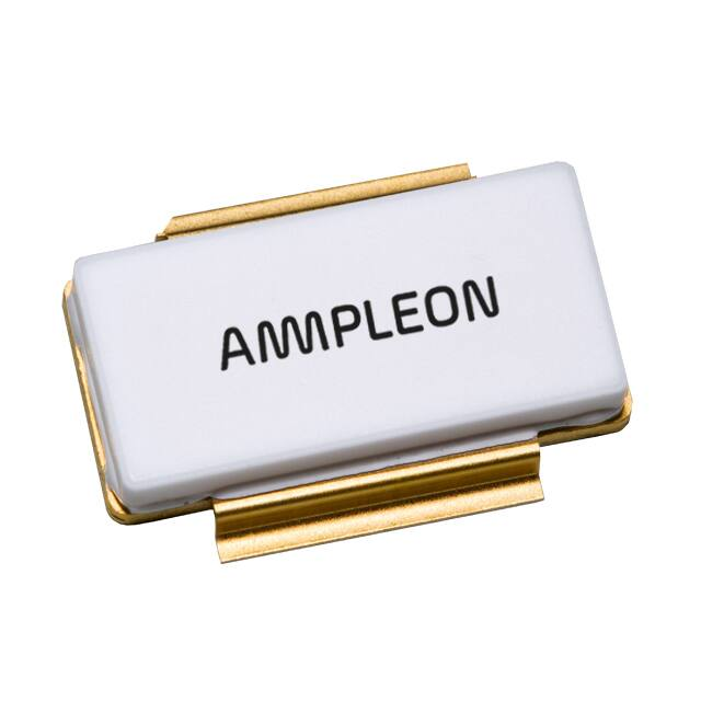

BLA6G1011-200R; BLA6G1011L(S)-200RG Power LDMOS transistor Rev. 6 — 1 September 2015 Product data sheet 1. Product profile 1.1 General description 200 W LDMOS power transistor for avionics applications at frequencies from 1030 MHz to 1090 MHz. Table 1. Test information Typical RF performance at Tcase = 25 C. Test signal f VDS PL Gp D tr tf (MHz) (V) (W) (dB) (%) (ns) (ns) 10 6 Typical RF performance in a class-AB production test circuit for SOT502A pulsed RF 1030 to 1090 28 200 20 65 Typical RF performance in a Gullwing application for SOT502C and SOT502D pulsed RF 1030 to 1090 28 200 20 65 15 6 1.2 Features and benefits  Typical pulsed RF performance at frequencies from 1030 MHz to 1090 MHz, a supply voltage of 28 V and an IDq of 100 mA:  Output power = 200 W  Power gain = 20 dB  Efficiency = 65 %  Easy power control  Integrated ESD protection  Enhanced ruggedness  High efficiency  Excellent thermal stability  Designed for broadband operation (1030 MHz to 1090 MHz)  Internally matched for ease of use  Compliant to Directive 2002/95/EC, regarding Restriction of Hazardous Substances (RoHS) 1.3 Applications  Avionics transmitter applications in the 1030 MHz to 1090 MHz frequency range. BLA6G1011(L)(S)-200R(G) Power LDMOS transistor 2. Pinning information Table 2. Pinning Pin Description Simplified outline Graphic symbol BLA6G1011-200R (SOT502A) 1 drain 2 gate 3 source 1 1 3 [1] 2 2 3 sym112 BLA6G1011L-200RG (SOT502D) 1 drain 2 gate 3 source 1 1 3 [1] 2 3 2 sym112 BLA6G1011LS-200RG (SOT502C) 1 drain 2 gate 3 source 1 [1] 1 3 2 3 2 sym112 [1] Connected to flange. 3. Ordering information Table 3. Ordering information Type number Package Name Description Version BLA6G1011-200R - flanged ceramic package; 2 mounting holes; 2 leads SOT502A BLA6G1011L-200RG - eared flanged ceramic package; 2 mounting holes; 2 leads SOT502D earless flanged ceramic package; 2 leads SOT502C BLA6G1011LS-200RG - 4. Limiting values Table 4. Limiting values In accordance with the Absolute Maximum Rating System (IEC 60134). BLA6G1011-200R_L-200RG_LS-200RG#6 Product data sheet Symbol Parameter VDS Conditions Min Max Unit drain-source voltage - 65 V VGS gate-source voltage 0.5 +13 V ID drain current - 49 A Tstg storage temperature 65 +150 C Tj junction temperature - 225 C All information provided in this document is subject to legal disclaimers. Rev. 6 — 1 September 2015 © Ampleon The Netherlands B.V. 2015. All rights reserved. 2 of 13 BLA6G1011(L)(S)-200R(G) Power LDMOS transistor 5. Thermal characteristics Table 5. Thermal characteristics Symbol Parameter Zth(j-c) Conditions transient thermal impedance Tcase = 25 C; from junction to case tp = 50 s; =2% Type Typ Unit BLA6G1011-200R 0.085 K/W BLA6G1011L-200RG 0.065 K/W BLA6G1011LS-200RG 0.065 K/W 6. Characteristics Table 6. DC characteristics Tj = 25 C unless otherwise specified. Symbol Parameter Conditions Min Typ Max Unit V(BR)DSS drain-source breakdown voltage VGS = 0 V; ID = 0.9 mA 65 - - V VGS(th) gate-source threshold voltage VDS = 10 V; ID = 270 mA 1.4 2.0 2.4 V VGSq gate-source quiescent voltage VDS = 28 V; ID = 1620 mA 1.7 2.2 2.7 V IDSS drain leakage current VGS = 0 V; VDS = 28 V - - 4.2 A IDSX drain cut-off current VGS = VGS(th) + 3.75 V; VDS = 10 V 40 48 - A IGSS gate leakage current VGS = 11 V; VDS = 0 V - - 420 nA gfs forward transconductance VDS = 10 V; ID = 9.45 A 11 18 26 S RDS(on) drain-source on-state resistance VGS = VGS(th) + 3.75 V; ID = 9.45 A 0.012 0.07 0.093  Crs feedback capacitance VGS = 0 V; VDS = 28 V; f = 1 MHz - - 3 pF Table 7. RF characteristics Test signal: Pulsed RF; tp = 50 s;  = 2 %; VDS = 28 V; IDq = 100 mA; Tcase = 25 C; unless otherwise specified; in a class-AB production test circuit for straight leads. Symbol Parameter Conditions Min Typ Max Unit PL output power 200 - - W Gp power gain PL = 200 W 18 20 - dB RLin D input return loss PL = 200 W - 10 8 dB drain efficiency PL = 200 W 58 65 - % tr rise time PL = 200 W - 10 20 ns tf fall time PL = 200 W - 6 20 ns 6.1 Ruggedness in class-AB operation The BLA6G1011-200R, BLA6G1011L-200RG and BLA6G1011LS-200RG are enhanced rugged devices and are capable of withstanding a load mismatch corresponding to VSWR = 10 : 1 through all phases under the following conditions: tp = 50 s;  = 2 %; VDS = 28 V; IDq = 100 mA; PL = 200 W; f = 1030 MHz to 1090 MHz. BLA6G1011-200R_L-200RG_LS-200RG#6 Product data sheet All information provided in this document is subject to legal disclaimers. Rev. 6 — 1 September 2015 © Ampleon The Netherlands B.V. 2015. All rights reserved. 3 of 13 BLA6G1011(L)(S)-200R(G) Power LDMOS transistor 7. Application information 7.1 Impedance information Table 8. Typical impedance Typical values unless otherwise specified. f ZS ZL (MHz) () () 1030 0.57  j0.94 0.80  j0.68 1060 0.70  j1.13 0.84  j0.52 1090 0.80  j1.53 0.86  j0.35 BLA6G1011-200R BLA6G1011L-200RG and BLA6G1011LS-200RG 1030 0.69  j2.18 0.84  j0.59 1060 0.86  j2.36 0.85  j0.73 1090 1.12  j2.54 0.86  j0.87 drain ZL gate ZS 001aaf059 Fig 1. BLA6G1011-200R_L-200RG_LS-200RG#6 Product data sheet Definition of transistor impedance All information provided in this document is subject to legal disclaimers. Rev. 6 — 1 September 2015 © Ampleon The Netherlands B.V. 2015. All rights reserved. 4 of 13 BLA6G1011(L)(S)-200R(G) Power LDMOS transistor 7.2 RF performance 001aak266 250 PL (W) 001aak267 22 Gp (dB) 200 (1) (2) (3) 20 150 18 (1) (2) (3) 100 16 50 14 0 12 0 1 2 3 4 0 50 100 150 Pi (W) VDS = 28 V; tp = 50 s;  = 2 %; IDq = 100 mA. VDS = 28 V; tp = 50 s;  = 2 %; IDq = 100 mA. (1) f = 1030 MHz (1) f = 1030 MHz (2) f = 1060 MHz (2) f = 1060 MHz (3) f = 1090 MHz (3) f = 1090 MHz Fig 2. ηD (%) Output power as a function of input power; typical values Fig 3. 001aak268 70 Power gain as a function of output power; typical values 001aak269 25 Gp RLin (dB) 60 Gp 70 ηD 15 40 75 ηD (%) 20 (1) (2) (3) 50 200 250 PL (W) 65 RLin 30 10 60 5 55 20 10 0 0 50 100 150 0 1020 200 250 PL (W) 1040 1060 50 1100 1080 f (MHz) VDS = 28 V; tp = 50 s;  = 2 %; IDq = 100 mA. PL = 200 W; VDS = 28 V; tp = 50 s;  = 2 %; IDq = 100 mA. (1) f = 1030 MHz (2) f = 1060 MHz (3) f = 1090 MHz Fig 4. Drain efficiency as a function of output power; typical values BLA6G1011-200R_L-200RG_LS-200RG#6 Product data sheet Fig 5. Power gain, input return loss and drain efficiency as function of frequency; typical values All information provided in this document is subject to legal disclaimers. Rev. 6 — 1 September 2015 © Ampleon The Netherlands B.V. 2015. All rights reserved. 5 of 13 BLA6G1011(L)(S)-200R(G) Power LDMOS transistor 7.3 Application circuit Remark: For BLA6G1011-200R with straight leads C5 C2 C1 + C6 C7 R1 C8 C3 C4 001aak270 See Table 9 for list of components. Fig 6. Component layout for class-AB application circuit Table 9. List of components See Figure 6. Striplines are on a Rogers Duroid 6006 Printed-Circuit Board (PCB); r = 6.15 F/m; thickness = 0.64 mm BLA6G1011-200R_L-200RG_LS-200RG#6 Product data sheet Component Description Value C1, C6 multilayer ceramic chip capacitor 10 F Remarks TDK C2 multilayer ceramic chip capacitor 68 pF [1] C3 multilayer ceramic chip capacitor 1.5 pF [1] C4 multilayer ceramic chip capacitor 3.9 pF [1] C5, C8 multilayer ceramic chip capacitor 30 pF [2] C7 electrolytic capacitor 470 F; 63 V R1 SMD resistor 12  [1] American Technical Ceramics type 100A or capacitor of same quality. [2] American Technical Ceramics type 100B or capacitor of same quality. All information provided in this document is subject to legal disclaimers. Rev. 6 — 1 September 2015 SMD 1206 © Ampleon The Netherlands B.V. 2015. All rights reserved. 6 of 13 BLA6G1011(L)(S)-200R(G) Power LDMOS transistor 8. Package outline Flanged ceramic package; 2 mounting holes; 2 leads SOT502A D A F 3 D1 U1 B q c C 1 H L E1 p U2 E w1 M A M B M A 2 w2 M C M b 0 5 Q 10 mm scale DIMENSIONS (millimetre dimensions are derived from the original inch dimensions) UNIT A b c mm 4.72 3.43 12.83 12.57 0.15 0.08 inches 0.186 0.135 0.505 0.006 0.495 0.003 OUTLINE VERSION E E1 F H L p Q q U1 U2 w1 w2 20.02 19.96 19.61 19.66 9.50 9.30 9.53 9.25 1.14 0.89 19.94 18.92 5.33 4.32 3.38 3.12 1.70 1.45 27.94 34.16 33.91 9.91 9.65 0.25 0.51 0.788 0.786 0.772 0.774 0.374 0.375 0.366 0.364 0.067 1.100 0.057 1.345 1.335 0.390 0.380 0.01 0.02 D D1 0.045 0.785 0.210 0.133 0.035 0.745 0.170 0.123 REFERENCES IEC JEDEC JEITA ISSUE DATE 03-01-10 12-05-02 SOT502A Fig 7. EUROPEAN PROJECTION Package outline SOT502A BLA6G1011-200R_L-200RG_LS-200RG#6 Product data sheet All information provided in this document is subject to legal disclaimers. Rev. 6 — 1 September 2015 © Ampleon The Netherlands B.V. 2015. All rights reserved. 7 of 13 BLA6G1011(L)(S)-200R(G) Power LDMOS transistor Earless flanged ceramic package; 2 leads SOT502C 0.4 mm gauge plane D Lp A F D1 detail X U1 v B w2 b A c B X 1 H 3 U2 E1 E 2 A Q θ 0 5 Dimensions Unit(1) mm 10 mm scale A b c D D1 E E1 F H max 4.72 12.83 0.16 20.02 19.96 9.53 9.53 1.14 13.6 nom min 3.43 12.57 0.10 19.61 19.66 9.27 9.27 0.89 13.2 Lp Q U1 U2 v w2 θ 7° 1.2 0.195 20.70 9.91 0.25 0.25 0.8 0.055 20.45 9.65 max 0.185 0.505 0.006 0.788 0.786 0.375 0.375 0.045 0.536 0.048 0.008 0.815 0.39 inches nom 0.01 0.01 min 0.135 0.495 0.004 0.772 0.774 0.365 0.365 0.035 0.519 0.031 0.002 0.805 0.38 0° 7° 0° Note 1. Millimeter dimensions are derived from the original inch dimensions. Outline version References IEC JEDEC JEITA European projection Issue date 11-05-02 12-05-02 SOT502C Fig 8. sot502c_po Package outline SOT502C BLA6G1011-200R_L-200RG_LS-200RG#6 Product data sheet All information provided in this document is subject to legal disclaimers. Rev. 6 — 1 September 2015 © Ampleon The Netherlands B.V. 2015. All rights reserved. 8 of 13 BLA6G1011(L)(S)-200R(G) Power LDMOS transistor Eared flanged ceramic package; 2 leads; 2 mounting holes SOT502D 0.4 mm gauge plane D A Lp F D1 detail X U1 B q v w2 b A c B X 1 3 U2 H E1 p w1 2 A A E B Q θ 0 5 Dimensions Unit(1) mm 10 mm scale A b c D D1 E1 F H Lp 9.53 1.14 13.6 1.2 E max 4.72 12.83 0.16 20.02 19.96 9.53 nom min 3.43 12.57 0.10 19.61 19.66 9.27 p Q q U1 U2 0.89 3.12 0.055 33.91 9.65 max 0.185 0.505 0.006 0.788 0.786 0.375 0.375 0.045 0.536 0.048 0.133 0.008 inches nom min 0.135 0.495 0.004 0.772 0.774 0.365 0.365 0.035 0.519 0.031 0.123 0.002 1.345 0.39 13.2 0.8 w1 w2 0.25 0.25 0.25 1.1 0° 7° 0.01 1.335 0.38 Note 1. Millimeter dimensions are derived from the original inch dimensions. Outline version References IEC JEDEC JEITA 0.01 0.01 0° sot502d_po European projection Issue date 11-05-02 12-05-02 SOT502D Fig 9. θ 7° 34.16 9.91 3.38 0.195 27.94 9.27 v Package outline SOT502D BLA6G1011-200R_L-200RG_LS-200RG#6 Product data sheet All information provided in this document is subject to legal disclaimers. Rev. 6 — 1 September 2015 © Ampleon The Netherlands B.V. 2015. All rights reserved. 9 of 13 BLA6G1011(L)(S)-200R(G) Power LDMOS transistor 9. Handling information CAUTION This device is sensitive to ElectroStatic Discharge (ESD). Observe precautions for handling electrostatic sensitive devices. Such precautions are described in the ANSI/ESD S20.20, IEC/ST 61340-5, JESD625-A or equivalent standards. 10. Abbreviations Table 10. Abbreviations Acronym Description ESD ElectroStatic Discharge LDMOS Laterally Diffused Metal-Oxide Semiconductor SMD Surface Mounted Device VSWR Voltage Standing-Wave Ratio 11. Revision history Table 11. Revision history Document ID Release date Data sheet status Change notice Supersedes BLA6G1011-200R_L-200RG_LS-200RG#6 20150901 Product data sheet Modifications: BLA6G1011-200R v.5 • The format of this document has been redesigned to comply with the new identity guidelines of Ampleon. • Legal texts have been adapted to the new company name where appropriate. BLA6G1011-200R_L-200RG_LS-200RG v.5 20150317 Product data sheet BLA6G1011-200R v.4 BLA6G1011-200R_L-200RG_LS-200RG v.4 20111109 Product data sheet BLA6G1011-200R v.3 BLA6G1011-200R v.3 Product data sheet - - BLA6G1011-200R_L-200RG_LS-200RG#6 Product data sheet 20100714 All information provided in this document is subject to legal disclaimers. Rev. 6 — 1 September 2015 © Ampleon The Netherlands B.V. 2015. All rights reserved. 10 of 13 BLA6G1011(L)(S)-200R(G) Power LDMOS transistor 12. Legal information 12.1 Data sheet status Document status[1][2] Product status[3] Objective [short] data sheet Development This document contains data from the objective specification for product development. Preliminary [short] data sheet Qualification This document contains data from the preliminary specification. Product [short] data sheet Production This document contains the product specification. Definition [1] Please consult the most recently issued document before initiating or completing a design. [2] The term ‘short data sheet’ is explained in section “Definitions”. [3] The product status of device(s) described in this document may have changed since this document was published and may differ in case of multiple devices. The latest product status information is available on the Internet at URL http://www.ampleon.com. 12.2 Definitions Draft — The document is a draft version only. The content is still under internal review and subject to formal approval, which may result in modifications or additions. Ampleon does not give any representations or warranties as to the accuracy or completeness of information included herein and shall have no liability for the consequences of use of such information. Short data sheet — A short data sheet is an extract from a full data sheet with the same product type number(s) and title. A short data sheet is intended for quick reference only and should not be relied upon to contain detailed and full information. For detailed and full information see the relevant full data sheet, which is available on request via the local Ampleon sales office. In case of any inconsistency or conflict with the short data sheet, the full data sheet shall prevail. Product specification — The information and data provided in a Product data sheet shall define the specification of the product as agreed between Ampleon and its customer, unless Ampleon and customer have explicitly agreed otherwise in writing. In no event however, shall an agreement be valid in which the Ampleon product is deemed to offer functions and qualities beyond those described in the Product data sheet. 12.3 Disclaimers Limited warranty and liability — Information in this document is believed to be accurate and reliable. However, Ampleon does not give any representations or warranties, expressed or implied, as to the accuracy or completeness of such information and shall have no liability for the consequences of use of such information. Ampleon takes no responsibility for the content in this document if provided by an information source outside of Ampleon. In no event shall Ampleon be liable for any indirect, incidental, punitive, special or consequential damages (including - without limitation - lost profits, lost savings, business interruption, costs related to the removal or replacement of any products or rework charges) whether or not such damages are based on tort (including negligence), warranty, breach of contract or any other legal theory. Notwithstanding any damages that customer might incur for any reason whatsoever, Ampleon’ aggregate and cumulative liability towards customer for the products described herein shall be limited in accordance with the Terms and conditions of commercial sale of Ampleon. Right to make changes — Ampleon reserves the right to make changes to information published in this document, including without limitation specifications and product descriptions, at any time and without notice. This document supersedes and replaces all information supplied prior to the publication hereof. Suitability for use — Ampleon products are not designed, authorized or warranted to be suitable for use in life support, life-critical or safety-critical systems or equipment, nor in applications where failure or malfunction of an BLA6G1011-200R_L-200RG_LS-200RG#6 Product data sheet Ampleon product can reasonably be expected to result in personal injury, death or severe property or environmental damage. Ampleon and its suppliers accept no liability for inclusion and/or use of Ampleon products in such equipment or applications and therefore such inclusion and/or use is at the customer’s own risk. Applications — Applications that are described herein for any of these products are for illustrative purposes only. Ampleon makes no representation or warranty that such applications will be suitable for the specified use without further testing or modification. Customers are responsible for the design and operation of their applications and products using Ampleon products, and Ampleon accepts no liability for any assistance with applications or customer product design. It is customer’s sole responsibility to determine whether the Ampleon product is suitable and fit for the customer’s applications and products planned, as well as for the planned application and use of customer’s third party customer(s). Customers should provide appropriate design and operating safeguards to minimize the risks associated with their applications and products. Ampleon does not accept any liability related to any default, damage, costs or problem which is based on any weakness or default in the customer’s applications or products, or the application or use by customer’s third party customer(s). Customer is responsible for doing all necessary testing for the customer’s applications and products using Ampleon products in order to avoid a default of the applications and the products or of the application or use by customer’s third party customer(s). Ampleon does not accept any liability in this respect. Limiting values — Stress above one or more limiting values (as defined in the Absolute Maximum Ratings System of IEC 60134) will cause permanent damage to the device. Limiting values are stress ratings only and (proper) operation of the device at these or any other conditions above those given in the Recommended operating conditions section (if present) or the Characteristics sections of this document is not warranted. Constant or repeated exposure to limiting values will permanently and irreversibly affect the quality and reliability of the device. Terms and conditions of commercial sale — Ampleon products are sold subject to the general terms and conditions of commercial sale, as published at http://www.ampleon.com/terms, unless otherwise agreed in a valid written individual agreement. In case an individual agreement is concluded only the terms and conditions of the respective agreement shall apply. Ampleon hereby expressly objects to applying the customer’s general terms and conditions with regard to the purchase of Ampleon products by customer. No offer to sell or license — Nothing in this document may be interpreted or construed as an offer to sell products that is open for acceptance or the grant, conveyance or implication of any license under any copyrights, patents or other industrial or intellectual property rights. Export control — This document as well as the item(s) described herein may be subject to export control regulations. Export might require a prior authorization from competent authorities. All information provided in this document is subject to legal disclaimers. Rev. 6 — 1 September 2015 © Ampleon The Netherlands B.V. 2015. All rights reserved. 11 of 13 BLA6G1011(L)(S)-200R(G) Power LDMOS transistor Non-automotive qualified products — Unless this data sheet expressly states that this specific Ampleon product is automotive qualified, the product is not suitable for automotive use. It is neither qualified nor tested in accordance with automotive testing or application requirements. Ampleon accepts no liability for inclusion and/or use of non-automotive qualified products in automotive equipment or applications. In the event that customer uses the product for design-in and use in automotive applications to automotive specifications and standards, customer (a) shall use the product without Ampleon’ warranty of the product for such automotive applications, use and specifications, and (b) whenever customer uses the product for automotive applications beyond Ampleon’ specifications such use shall be solely at customer’s own risk, and (c) customer fully indemnifies Ampleon for any liability, damages or failed product claims resulting from customer design and use of the product for automotive applications beyond Ampleon’ standard warranty and Ampleon’ product specifications. 12.4 Trademarks Notice: All referenced brands, product names, service names and trademarks are the property of their respective owners. Any reference or use of any ‘NXP’ trademark in this document or in or on the surface of Ampleon products does not result in any claim, liability or entitlement vis-à-vis the owner of this trademark. Ampleon is no longer part of the NXP group of companies and any reference to or use of the ‘NXP’ trademarks will be replaced by reference to or use of Ampleon’s own Any reference or use of any ‘NXP’ trademark in this document or in or on the surface of Ampleon products does not result in any claim, liability or entitlement vis-à-vis the owner of this trademark. Ampleon is no longer part of the NXP group of companies and any reference to or use of the ‘NXP’ trademarks will be replaced by reference to or use of Ampleon’s own trademarks. Translations — A non-English (translated) version of a document is for reference only. The English version shall prevail in case of any discrepancy between the translated and English versions. 13. Contact information For more information, please visit: http://www.ampleon.com BLA6G1011-200R_L-200RG_LS-200RG#6 Product data sheet For sales office addresses, please visit: http://www.ampleon.com/sales All information provided in this document is subject to legal disclaimers. Rev. 6 — 1 September 2015 © Ampleon The Netherlands B.V. 2015. All rights reserved. 12 of 13 BLA6G1011(L)(S)-200R(G) Power LDMOS transistor 14. Contents 1 1.1 1.2 1.3 2 3 4 5 6 6.1 7 7.1 7.2 7.3 8 9 10 11 12 12.1 12.2 12.3 12.4 13 14 Product profile . . . . . . . . . . . . . . . . . . . . . . . . . . 1 General description . . . . . . . . . . . . . . . . . . . . . 1 Features and benefits . . . . . . . . . . . . . . . . . . . . 1 Applications . . . . . . . . . . . . . . . . . . . . . . . . . . . 1 Pinning information . . . . . . . . . . . . . . . . . . . . . . 2 Ordering information . . . . . . . . . . . . . . . . . . . . . 2 Limiting values. . . . . . . . . . . . . . . . . . . . . . . . . . 2 Thermal characteristics . . . . . . . . . . . . . . . . . . 3 Characteristics . . . . . . . . . . . . . . . . . . . . . . . . . . 3 Ruggedness in class-AB operation . . . . . . . . . 3 Application information. . . . . . . . . . . . . . . . . . . 4 Impedance information . . . . . . . . . . . . . . . . . . . 4 RF performance . . . . . . . . . . . . . . . . . . . . . . . . 5 Application circuit . . . . . . . . . . . . . . . . . . . . . . . 6 Package outline . . . . . . . . . . . . . . . . . . . . . . . . . 7 Handling information. . . . . . . . . . . . . . . . . . . . 10 Abbreviations . . . . . . . . . . . . . . . . . . . . . . . . . . 10 Revision history . . . . . . . . . . . . . . . . . . . . . . . . 10 Legal information. . . . . . . . . . . . . . . . . . . . . . . 11 Data sheet status . . . . . . . . . . . . . . . . . . . . . . 11 Definitions . . . . . . . . . . . . . . . . . . . . . . . . . . . . 11 Disclaimers . . . . . . . . . . . . . . . . . . . . . . . . . . . 11 Trademarks. . . . . . . . . . . . . . . . . . . . . . . . . . . 12 Contact information. . . . . . . . . . . . . . . . . . . . . 12 Contents . . . . . . . . . . . . . . . . . . . . . . . . . . . . . . 13 Please be aware that important notices concerning this document and the product(s) described herein, have been included in section ‘Legal information’. © Ampleon The Netherlands B.V. 2015. All rights reserved. For more information, please visit: http://www.ampleon.com For sales office addresses, please visit: http://www.ampleon.com/sales Date of release: 1 September 2015 Document identifier: BLA6G1011-200R_L-200RG_LS-200RG#6
