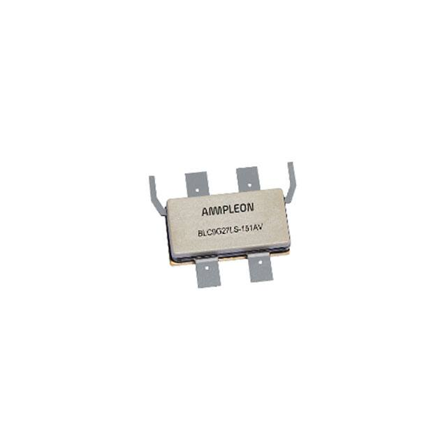

BLC9G27LS-151AV Power LDMOS transistor Rev. 3 — 24 May 2017 Product data sheet 1. Product profile 1.1 General description 150 W LDMOS packaged asymmetrical Doherty power transistor for base station applications at frequencies from 2496 MHz to 2690 MHz. Table 1. Typical performance Typical RF performance at Tcase = 25 C in the Doherty demo board. Test signal f (MHz) (V) (W) 1-carrier W-CDMA 2496 to 2690 28 28.2 [1] VDS PL(AV) D ACPR (dB) (%) (dBc) 15.5 48 30 [1] Gp Test signal: 3GPP test model 1; 1 to 64 DPCH; PAR = 7.2 dB at 0.01 % probability on CCDF. 1.2 Features and benefits          Excellent ruggedness High efficiency Low thermal resistance providing excellent thermal stability Decoupling leads to enable improved video bandwidth Lower output capacitance for improved performance in Doherty applications Designed for low memory effects providing excellent pre-distortability Internally matched for ease of use Integrated ESD protection Compliant to Directive 2002/95/EC, regarding Restriction of Hazardous Substances (RoHS) 1.3 Applications  RF power amplifier for LTE base stations and multi carrier applications in the 2496 MHz to 2690 MHz frequency range BLC9G27LS-151AV Power LDMOS transistor 2. Pinning information Table 2. Pinning Pin Description 1 drain1 (main) 2 drain2 (peak) 3 gate1 (main) 4 gate2 (peak) Simplified outline 5 6 1, 5 3 video decoupling (main) 6 video decoupling (peak) [1] 2 7 5 7 1 Graphic symbol 7 4 3 4 2, 6 [1] source aaa-007731 Connected to flange. 3. Ordering information Table 3. Ordering information Type number Package BLC9G27LS-151AV Name Description Version - air cavity plastic earless flanged package; 6 leads SOT1275-1 4. Limiting values Table 4. Limiting values In accordance with the Absolute Maximum Rating System (IEC 60134). Symbol Parameter Conditions Min Max Unit VDS drain-source voltage - 65 V VGS gate-source voltage 5 +13 V Tstg storage temperature 65 +150 C - 225 C junction temperature Tj [1] [1] Continuous use at maximum temperature will affect the reliability, for details refer to the online MTF calculator. 5. Thermal characteristics Table 5. Symbol Thermal characteristics Parameter Conditions Rth(j-case) thermal resistance from junction to case BLC9G27LS-151AV Product data sheet Unit Tcase = 80 C; IDq = 280 mA; VGS(amp) peak = 0.85 V PL = 28.2 W 0.314 K/W PL = 44.7 W 0.270 K/W All information provided in this document is subject to legal disclaimers. Rev. 3 — 24 May 2017 Typ © Ampleon Netherlands B.V. 2017. All rights reserved. 2 of 15 BLC9G27LS-151AV Power LDMOS transistor 6. Characteristics Table 6. DC characteristics Tj = 25 C unless otherwise specified. Symbol Parameter Conditions Min Typ Max Unit Main device 65 - - V VGS(th) V(BR)DSS drain-source breakdown voltage VGS = 0 V; ID = 0.5 mA gate-source threshold voltage VDS = 10 V; ID = 50 mA 1.5 2 2.5 V VGSq gate-source quiescent voltage VDS = 28 V; ID = 300mA 1.75 2.3 2.85 V IDSS drain leakage current VGS = 0 V; VDS = 32 V - - 1.4 IDSX drain cut-off current VGS = VGS(th) + 3.75 V; VDS = 10 V - 10.9 - A IGSS gate leakage current VGS = 11 V; VDS = 0 V - - nA gfs forward transconductance VDS = 10 V; ID = 50 mA - 0.53 - S RDS(on) drain-source on-state resistance VGS = VGS(th) + 3.75 V; ID = 1.75 A - 285 460 m 65 - - V V 140 A Peak device V(BR)DSS drain-source breakdown voltage VGS = 0 V; ID = 1.1 mA VGS(th) gate-source threshold voltage VDS = 10 V; ID = 110 mA 1.5 2 2.5 VGSq gate-source quiescent voltage VDS = 28 V; ID = 660 mA 1.65 2.2 2.75 V IDSS drain leakage current VGS = 0 V; VDS = 32 V - - 1.4 IDSX drain cut-off current VGS = VGS(th) + 3.75 V; VDS = 10 V - 23.8 - A IGSS gate leakage current VGS = 11 V; VDS = 0 V - - nA gfs forward transconductance VDS = 10 V; ID = 110 mA - 1.16 - S RDS(on) drain-source on-state resistance VGS = VGS(th) + 3.75 V; ID = 3.85 A - 130 m 140 215 A Table 7. RF characteristics Test signal: 1-carrier W-CDMA; PAR = 7.2 dB at 0.01 % probability on the CCDF; 3GPP test model 1; 1 to 64 DPCH; f1 = 2496 MHz; f2 = 2690 MHz; RF performance at VDS = 28 V; IDq = 280 mA (main); VGS(amp)peak = 0.8 V; Tcase = 25 C; unless otherwise specified; in an asymmetrical Doherty production test circuit at frequencies from 2496 MHz to 2690 MHz. Symbol Parameter Conditions Min Typ Max Unit Gp power gain PL(AV) = 28 W 14.4 15.6 - dB RLin input return loss PL(AV) = 28 W - 11 7 dB D drain efficiency PL(AV) = 28 W 41 46 - % ACPR adjacent channel power ratio PL(AV) = 28 W - 30 25 dBc Table 8. RF characteristics Test signal: pulsed CW; tp = 100 s;  = 10 %; f = 2690 MHz; RF performance at VDS = 28 V; IDq = 280 mA (main); VGS(amp)peak = 0.8 V; Tcase = 25 C; unless otherwise specified; tested in an asymmetrical Doherty production test circuit at frequencies from 2496 MHz to 2690 MHz. BLC9G27LS-151AV Product data sheet Symbol Parameter Conditions PL(3dB) output power at 3 dB gain compression All information provided in this document is subject to legal disclaimers. Rev. 3 — 24 May 2017 Min Typ Max Unit 135 155 - W © Ampleon Netherlands B.V. 2017. All rights reserved. 3 of 15 BLC9G27LS-151AV Power LDMOS transistor 7. Test information 7.1 Ruggedness in Doherty operation The BLC9G27LS-151AV is capable of withstanding a load mismatch corresponding to a VSWR = 10 : 1 through all phases under the following conditions: VDS = 28 V; IDq = 200 mA (main); VGS(amp)peak = 0.85 V; PL = 50 W (1-carrier W-CDMA); f = 2496 MHz. 7.2 Impedance information Table 9. Typical impedance of main device Measured load-pull data of main device; IDq = 300 mA (main); VDS = 28 V. f ZS [1] ZL [1] PL [2] D [2] Gp [2] (MHz) () () (W) (%) (dB) Maximum power load 2496 6.2  j7.7 3.3  j7.7 71.5 55.8 18.1 2600 6.1  j5.9 3.3  j7.7 71.3 55.7 18.5 2690 3.6  j5.4 3.3  j7.7 66.9 54.9 19.1 Maximum drain efficiency load 2496 6.2  j7.7 6.4  j5.7 52.8 63.5 20.3 2600 6.1  j5.9 6.0  j5.9 52.1 64.3 21.1 2690 3.6  j5.4 5.0  j5.0 48.5 61.8 21.5 [1] ZS and ZL defined in Figure 1. [2] at 3 dB gain compression. Table 10. Typical impedance of peak device Measured load-pull data of peak device; IDq = 600 mA (peak); VDS = 28 V. f ZS [1] ZL [1] PL [2] D [2] Gp [2] (MHz) () () (W) (%) (dB) Maximum power load 2496 7.2  j8.6 4.1  j9.1 146.9 58.2 17.6 2600 8.0  j6.3 4.1  j9.1 141.1 56.0 17.9 2690 6.0  j2.8 5.0  j10.0 137.3 55.7 18.3 Maximum drain efficiency load BLC9G27LS-151AV Product data sheet 2496 7.2  j8.6 5.8  j6.2 115.5 65.3 19.5 2600 8.0  j6.3 5.4  j5.5 103.2 64.2 20.2 2690 6.0  j2.8 4.8  j5.9 98.5 62.8 20.6 [1] ZS and ZL defined in Figure 1. [2] at 3 dB gain compression. All information provided in this document is subject to legal disclaimers. Rev. 3 — 24 May 2017 © Ampleon Netherlands B.V. 2017. All rights reserved. 4 of 15 BLC9G27LS-151AV Power LDMOS transistor drain ZL gate ZS 001aaf059 Fig 1. Definition of transistor impedance 7.3 Recommended impedances for Doherty design Table 11. Typical impedance of main device at 1 : 1 load Measured load-pull data of main device; IDq = 300 mA (main); VDS = 28 V. f ZS [1] ZL [1] PL [2] D [3] Gp [3] (MHz) () () (dBm) (%) (dB) 2496 6.2  j7.7 3.7  j7.0 48.1 41.5 18.5 2600 6.1  j5.9 3.7  j7.1 48.0 42.0 18.7 2690 3.6  j5.4 3.7  j7.2 48.0 42.0 19.3 [1] ZS and ZL defined in Figure 1. [2] at 3 dB gain compression. [3] at PL(AV) = 44.5 dBm. Table 12. Typical impedance of main device at 1 : 2.5 load Measured load-pull data of main device; IDq = 300 mA (main); VDS = 28 V. f ZS [1] ZL [1] PL [2] D [3] Gp [3] (MHz) () () (dBm) (%) (dB) 2496 6.2  j7.7 6.8  j12.9 46.2 55 20.7 2600 6.1  j5.9 6.0  j14.1 46.7 54 21.3 2690 3.6  j5.4 5.5  j13.7 45.9 53 21.8 [1] ZS and ZL defined in Figure 1. [2] at 3 dB gain compression. [3] at PL(AV) = 44.5 dBm. 7.4 VBW in Doherty operation The BLC9G27LS-151AV shows 100 MHz (typical) video bandwidth in Doherty demo board in 2600 MHz at VDS = 28 V; IDq = 250 mA and VGS(amp)peak = 0.8 V. BLC9G27LS-151AV Product data sheet All information provided in this document is subject to legal disclaimers. Rev. 3 — 24 May 2017 © Ampleon Netherlands B.V. 2017. All rights reserved. 5 of 15 BLC9G27LS-151AV Power LDMOS transistor 7.5 Test circuit 40 mm 40 mm C17 C9 C10 C3 R2 C13 C7 C14 R1 C1 C5 C2 C6 80 mm C8 R3 C4 C15 C16 C11 C12 C18 aaa-020753 Printed-Circuit Board (PCB): Rogers RO4350B; r = 3.5; thickness = 0.508 mm; thickness copper plating = 35 m. See Table 13 for a list of components. Fig 2. Component layout Table 13. List of components See Figure 2 for component layout. Component BLC9G27LS-151AV Product data sheet Description Value Remarks C1, C2, C3, C4, C6, C7, C8 multilayer ceramic chip capacitor 9.1 pF [1] C5 multilayer ceramic chip capacitor 4.3 pF [1] C9, C11 multilayer ceramic chip capacitor 1 F, 50 V [2] C10, C12, C13, C14, C15, C16 multilayer ceramic chip capacitor 10 F, 50 V [2] C17, C18 electrolytic capacitor 1000 F, 100 V R1 resistor 51  SMD 0805 R2. R3 resistor 9.1  SMD 0805 [1] American Technical Ceramics type 600F or capacitor of same quality [2] Murata or capacitor of same quality All information provided in this document is subject to legal disclaimers. Rev. 3 — 24 May 2017 © Ampleon Netherlands B.V. 2017. All rights reserved. 6 of 15 BLC9G27LS-151AV Power LDMOS transistor 7.6 Graphical data 7.6.1 Pulsed CW aaa-020471 22 Gp (dB) 70 ηD 20 RLin (dB) 60 (1) (2) (3) 18 aaa-020472 20 ηD (%) 16 50 12 16 (1) (2) (3) 40 (1) (2) (3) 14 8 30 Gp 12 4 20 10 10 39 41 43 45 47 49 51 PL (dBm) 0 53 39 VDS = 28 V; IDq = 210 mA (main device); VGS(amp)peak = 0.85 V. 41 43 (1) f = 2496 MHz (2) f = 2590 MHz (2) f = 2590 MHz (3) f = 2690 MHz (3) f = 2690 MHz Power gain and drain efficiency as function of output power; typical values BLC9G27LS-151AV Product data sheet 47 49 51 PL (dBm) 53 VDS = 28 V; IDq = 210 mA (main device); VGS(amp)peak = 0.85 V. (1) f = 2496 MHz Fig 3. 45 Fig 4. Input return loss as a function of output power; typical values All information provided in this document is subject to legal disclaimers. Rev. 3 — 24 May 2017 © Ampleon Netherlands B.V. 2017. All rights reserved. 7 of 15 BLC9G27LS-151AV Power LDMOS transistor 7.6.2 1-Carrier W-CDMA aaa-020473 18 60 Gp (dB) aaa-020474 15 RLin (dB) ηD (%) Gp 13 16 55 11 (1) (1) (2) (2) (3) (3) 14 (3) (2) (1) 50 9 12 45 ηD 7 10 40 41 42 43 44 45 46 47 PL (dBm) 5 48 41 VDS = 28 V; IDq = 210 mA (main device); VGS(amp)peak = 0.85 V. 42 43 45 46 47 PL (W) 48 VDS = 28 V; IDq = 210 mA (main device); VGS(amp)peak = 0.85 V. (1) f = 2496 MHz (1) f = 2496 MHz (2) f = 2590 MHz (2) f = 2590 MHz (3) f = 2690 MHz (3) f = 2690 MHz Fig 5. 44 Power gain and drain efficiency as function of output power; typical values Fig 6. Input return loss as a function of output power; typical values aaa-020475 0 ACPR5M (dBc) -10 -20 -30 (1) (2) (3) -40 -50 -60 41 42 43 44 45 46 47 PL (dBm) 48 VDS = 28 V; IDq = 210 mA (main device); VGS(amp)peak = 0.85 V. (1) f = 2496 MHz (2) f = 2590 MHz (3) f = 2690 MHz Fig 7. Adjacent channel power ratio (5 MHz) as a function of output power; typical values BLC9G27LS-151AV Product data sheet All information provided in this document is subject to legal disclaimers. Rev. 3 — 24 May 2017 © Ampleon Netherlands B.V. 2017. All rights reserved. 8 of 15 BLC9G27LS-151AV Power LDMOS transistor 7.6.3 2-Tone VBW aaa-020476 0 IMD (dBc) (1) (2) -20 IMD3 (1) (2) IMD5 -40 (1) (2) IMD7 -60 -80 1 10 102 carrier spacing (MHz) 103 VDS = 28 V; IDq = 250 mA (main device); VGS(amp)peak = 0.8 V; fc = 2600 MHz. (1) IMD low (2) IMD high Fig 8. BLC9G27LS-151AV Product data sheet VBW capability in Doherty demo board All information provided in this document is subject to legal disclaimers. Rev. 3 — 24 May 2017 © Ampleon Netherlands B.V. 2017. All rights reserved. 9 of 15 BLC9G27LS-151AV Power LDMOS transistor 8. Package outline Air cavity plastic earless flanged package; 6 leads SOT1275-1 D F A 7 w1 D1 B L U1 b1 v B A c H1 5 1 2 6 y Į Z1 Z U2 H E1 E A 3 4 b e Q w2 0 B 5 10 mm y v w1 w2 0.1 0.5 0.5 0.5 U2 Z Z1 Į scale Dimensions Unit mm A max 4.01 nom min 3.40 b b1 3.94 1.14 c D D1 E 0.178 20.42 20.37 9.80 E1 e 9.75 F H H1 L Q(1) U1 1.14 19.53 12.80 25.40 1.68 20.70 9.91 3.17 5.79 65° 0.94 19.33 12.60 25.20 1.45 20.50 9.70 2.67 5.29 61° 8.89 3.68 0.89 0.127 20.12 20.17 9.50 9.55 Note 1. Dimension Q is measured 0.1 mm away from the flange. 2. Ringframe and/or ringframe glue shall not overhang at the side of the flange. Outline version References IEC JEDEC JEITA Issue date 16-11-15 17-04-13 SOT1275-1 Fig 9. sot1275-1_po European projection Package outline SOT1275-1 BLC9G27LS-151AV Product data sheet All information provided in this document is subject to legal disclaimers. Rev. 3 — 24 May 2017 © Ampleon Netherlands B.V. 2017. All rights reserved. 10 of 15 BLC9G27LS-151AV Power LDMOS transistor 9. Handling information CAUTION This device is sensitive to ElectroStatic Discharge (ESD). Observe precautions for handling electrostatic sensitive devices. Such precautions are described in the ANSI/ESD S20.20, IEC/ST 61340-5, JESD625-A or equivalent standards. Table 14. ESD sensitivity ESD model Class Charged Device Model (CDM); According to ANSI/ESDA/JEDEC standard JS-002 C2A [1] Human Body Model (HBM); According to ANSI/ESDA/JEDEC standard JS-001 2 [2] [1] CDM classification C2A is granted to any part that passes after exposure to an ESD pulse of 500 V, but fails after exposure to an ESD pulse of 750 V. [2] HBM classification 2 is granted to any part that passes after exposure to an ESD pulse of 2000 V, but fails after exposure to an ESD pulse of 4000 V. 10. Abbreviations Table 15. BLC9G27LS-151AV Product data sheet Abbreviations Acronym Description 3GPP 3rd Generation Partnership Project CCDF Complementary Cumulative Distribution Function CW Continuous Wave DPCH Dedicated Physical CHannel ESD ElectroStatic Discharge LDMOS Laterally Diffused Metal-Oxide Semiconductor LTE Long Term Evolution MTF Median Time to Failure PAR Peak-to-Average Ratio SMD Surface Mounted Device VBW Video BandWidth VSWR Voltage Standing Wave Ratio W-CDMA Wideband Code Division Multiple Access All information provided in this document is subject to legal disclaimers. Rev. 3 — 24 May 2017 © Ampleon Netherlands B.V. 2017. All rights reserved. 11 of 15 BLC9G27LS-151AV Power LDMOS transistor 11. Revision history Table 16. Revision history Document ID Release date Data sheet status Change notice Supersedes BLC9G27LS-151AV v.3 20170524 Product data sheet - BLC9G27LS-151AV v.2 Modifications: • • • Table 2 on page 2: change simplified outline Table 3 on page 2: change version to SOT1275-1 Figure 9 on page 10: change package outline drawing to SOT1275-1 BLC9G27LS-151AV v.2 20161202 Product data sheet - BLC9G27LS-151AV v.1 BLC9G27LS-151AV v.1 20160226 Product data sheet - - BLC9G27LS-151AV Product data sheet All information provided in this document is subject to legal disclaimers. Rev. 3 — 24 May 2017 © Ampleon Netherlands B.V. 2017. All rights reserved. 12 of 15 BLC9G27LS-151AV Power LDMOS transistor 12. Legal information 12.1 Data sheet status Document status[1][2] Product status[3] Definition Objective [short] data sheet Development This document contains data from the objective specification for product development. Preliminary [short] data sheet Qualification This document contains data from the preliminary specification. Product [short] data sheet Production This document contains the product specification. [1] Please consult the most recently issued document before initiating or completing a design. [2] The term ‘short data sheet’ is explained in section “Definitions”. [3] The product status of device(s) described in this document may have changed since this document was published and may differ in case of multiple devices. The latest product status information is available on the Internet at URL http://www.ampleon.com. 12.2 Definitions Draft — The document is a draft version only. The content is still under internal review and subject to formal approval, which may result in modifications or additions. Ampleon does not give any representations or warranties as to the accuracy or completeness of information included herein and shall have no liability for the consequences of use of such information. Short data sheet — A short data sheet is an extract from a full data sheet with the same product type number(s) and title. A short data sheet is intended for quick reference only and should not be relied upon to contain detailed and full information. For detailed and full information see the relevant full data sheet, which is available on request via the local Ampleon sales office. In case of any inconsistency or conflict with the short data sheet, the full data sheet shall prevail. Product specification — The information and data provided in a Product data sheet shall define the specification of the product as agreed between Ampleon and its customer, unless Ampleon and customer have explicitly agreed otherwise in writing. In no event however, shall an agreement be valid in which the Ampleon product is deemed to offer functions and qualities beyond those described in the Product data sheet. 12.3 Disclaimers Limited warranty and liability — Information in this document is believed to be accurate and reliable. However, Ampleon does not give any representations or warranties, expressed or implied, as to the accuracy or completeness of such information and shall have no liability for the consequences of use of such information. Ampleon takes no responsibility for the content in this document if provided by an information source outside of Ampleon. In no event shall Ampleon be liable for any indirect, incidental, punitive, special or consequential damages (including - without limitation - lost profits, lost savings, business interruption, costs related to the removal or replacement of any products or rework charges) whether or not such damages are based on tort (including negligence), warranty, breach of contract or any other legal theory. Notwithstanding any damages that customer might incur for any reason whatsoever, Ampleon’s aggregate and cumulative liability towards customer for the products described herein shall be limited in accordance with the Terms and conditions of commercial sale of Ampleon. Right to make changes — Ampleon reserves the right to make changes to information published in this document, including without limitation specifications and product descriptions, at any time and without notice. This document supersedes and replaces all information supplied prior to the publication hereof. Suitability for use — Ampleon products are not designed, authorized or warranted to be suitable for use in life support, life-critical or safety-critical systems or equipment, nor in applications where failure or malfunction of an BLC9G27LS-151AV Product data sheet Ampleon product can reasonably be expected to result in personal injury, death or severe property or environmental damage. Ampleon and its suppliers accept no liability for inclusion and/or use of Ampleon products in such equipment or applications and therefore such inclusion and/or use is at the customer’s own risk. Applications — Applications that are described herein for any of these products are for illustrative purposes only. Ampleon makes no representation or warranty that such applications will be suitable for the specified use without further testing or modification. Customers are responsible for the design and operation of their applications and products using Ampleon products, and Ampleon accepts no liability for any assistance with applications or customer product design. It is customer’s sole responsibility to determine whether the Ampleon product is suitable and fit for the customer’s applications and products planned, as well as for the planned application and use of customer’s third party customer(s). Customers should provide appropriate design and operating safeguards to minimize the risks associated with their applications and products. Ampleon does not accept any liability related to any default, damage, costs or problem which is based on any weakness or default in the customer’s applications or products, or the application or use by customer’s third party customer(s). Customer is responsible for doing all necessary testing for the customer’s applications and products using Ampleon products in order to avoid a default of the applications and the products or of the application or use by customer’s third party customer(s). Ampleon does not accept any liability in this respect. Limiting values — Stress above one or more limiting values (as defined in the Absolute Maximum Ratings System of IEC 60134) will cause permanent damage to the device. Limiting values are stress ratings only and (proper) operation of the device at these or any other conditions above those given in the Recommended operating conditions section (if present) or the Characteristics sections of this document is not warranted. Constant or repeated exposure to limiting values will permanently and irreversibly affect the quality and reliability of the device. Terms and conditions of commercial sale — Ampleon products are sold subject to the general terms and conditions of commercial sale, as published at http://www.ampleon.com/terms, unless otherwise agreed in a valid written individual agreement. In case an individual agreement is concluded only the terms and conditions of the respective agreement shall apply. Ampleon hereby expressly objects to applying the customer’s general terms and conditions with regard to the purchase of Ampleon products by customer. No offer to sell or license — Nothing in this document may be interpreted or construed as an offer to sell products that is open for acceptance or the grant, conveyance or implication of any license under any copyrights, patents or other industrial or intellectual property rights. Export control — This document as well as the item(s) described herein may be subject to export control regulations. Export might require a prior authorization from competent authorities. All information provided in this document is subject to legal disclaimers. Rev. 3 — 24 May 2017 © Ampleon Netherlands B.V. 2017. All rights reserved. 13 of 15 BLC9G27LS-151AV Power LDMOS transistor Non-automotive qualified products — Unless this data sheet expressly states that this specific Ampleon product is automotive qualified, the product is not suitable for automotive use. It is neither qualified nor tested in accordance with automotive testing or application requirements. Ampleon accepts no liability for inclusion and/or use of non-automotive qualified products in automotive equipment or applications. In the event that customer uses the product for design-in and use in automotive applications to automotive specifications and standards, customer (a) shall use the product without Ampleon’ warranty of the product for such automotive applications, use and specifications, and (b) whenever customer uses the product for automotive applications beyond Ampleon’ specifications such use shall be solely at customer’s own risk, and (c) customer fully indemnifies Ampleon for any liability, damages or failed product claims resulting from customer design and use of the product for automotive applications beyond Ampleon’ standard warranty and Ampleon’ product specifications. Translations — A non-English (translated) version of a document is for reference only. The English version shall prevail in case of any discrepancy between the translated and English versions. 12.4 Trademarks Notice: All referenced brands, product names, service names and trademarks are the property of their respective owners. Any reference or use of any ‘NXP’ trademark in this document or in or on the surface of Ampleon products does not result in any claim, liability or entitlement vis-à-vis the owner of this trademark. Ampleon is no longer part of the NXP group of companies and any reference to or use of the ‘NXP’ trademarks will be replaced by reference to or use of Ampleon’s own trademarks. 13. Contact information For more information, please visit: http://www.ampleon.com For sales office addresses, please visit: http://www.ampleon.com/sales BLC9G27LS-151AV Product data sheet All information provided in this document is subject to legal disclaimers. Rev. 3 — 24 May 2017 © Ampleon Netherlands B.V. 2017. All rights reserved. 14 of 15 BLC9G27LS-151AV Power LDMOS transistor 14. Contents 1 1.1 1.2 1.3 2 3 4 5 6 7 7.1 7.2 7.3 7.4 7.5 7.6 7.6.1 7.6.2 7.6.3 8 9 10 11 12 12.1 12.2 12.3 12.4 13 14 Product profile . . . . . . . . . . . . . . . . . . . . . . . . . . 1 General description . . . . . . . . . . . . . . . . . . . . . 1 Features and benefits . . . . . . . . . . . . . . . . . . . . 1 Applications . . . . . . . . . . . . . . . . . . . . . . . . . . . 1 Pinning information . . . . . . . . . . . . . . . . . . . . . . 2 Ordering information . . . . . . . . . . . . . . . . . . . . . 2 Limiting values. . . . . . . . . . . . . . . . . . . . . . . . . . 2 Thermal characteristics . . . . . . . . . . . . . . . . . . 2 Characteristics . . . . . . . . . . . . . . . . . . . . . . . . . . 3 Test information . . . . . . . . . . . . . . . . . . . . . . . . . 4 Ruggedness in Doherty operation . . . . . . . . . . 4 Impedance information . . . . . . . . . . . . . . . . . . . 4 Recommended impedances for Doherty design 5 VBW in Doherty operation . . . . . . . . . . . . . . . . 5 Test circuit. . . . . . . . . . . . . . . . . . . . . . . . . . . . . 6 Graphical data . . . . . . . . . . . . . . . . . . . . . . . . . 7 Pulsed CW . . . . . . . . . . . . . . . . . . . . . . . . . . . . 7 1-Carrier W-CDMA . . . . . . . . . . . . . . . . . . . . . . 8 2-Tone VBW . . . . . . . . . . . . . . . . . . . . . . . . . . . 9 Package outline . . . . . . . . . . . . . . . . . . . . . . . . 10 Handling information. . . . . . . . . . . . . . . . . . . . 11 Abbreviations . . . . . . . . . . . . . . . . . . . . . . . . . . 11 Revision history . . . . . . . . . . . . . . . . . . . . . . . . 12 Legal information. . . . . . . . . . . . . . . . . . . . . . . 13 Data sheet status . . . . . . . . . . . . . . . . . . . . . . 13 Definitions . . . . . . . . . . . . . . . . . . . . . . . . . . . . 13 Disclaimers . . . . . . . . . . . . . . . . . . . . . . . . . . . 13 Trademarks. . . . . . . . . . . . . . . . . . . . . . . . . . . 14 Contact information. . . . . . . . . . . . . . . . . . . . . 14 Contents . . . . . . . . . . . . . . . . . . . . . . . . . . . . . . 15 Please be aware that important notices concerning this document and the product(s) described herein, have been included in section ‘Legal information’. © Ampleon Netherlands B.V. 2017. All rights reserved. For more information, please visit: http://www.ampleon.com For sales office addresses, please visit: http://www.ampleon.com/sales Date of release: 24 May 2017 Document identifier: BLC9G27LS-151AV
