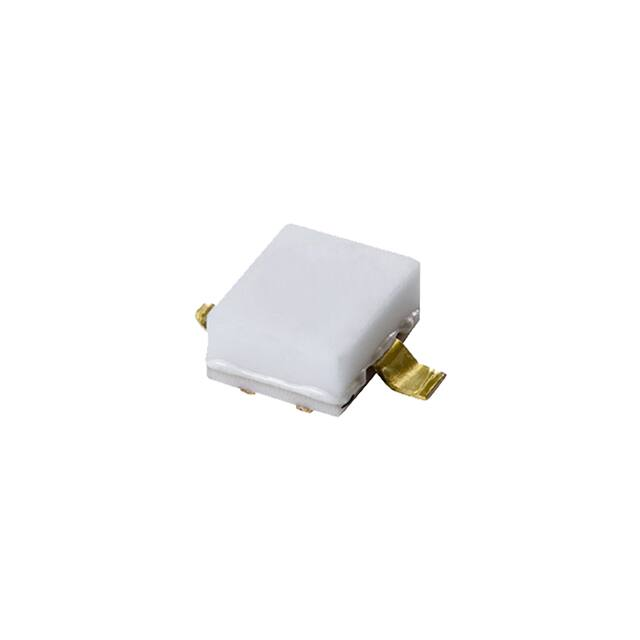

BLF1043 UHF power LDMOS transistor Rev. 9 — 1 September 2015 Product data sheet 1. Product profile 1.1 General description 10 W LDMOS power transistor for base station applications at frequencies from HF to 1000 MHz. Table 1. Typical performance RF performance at Th = 25 C in a common source test circuit. Mode of operation Gp D dim (dB) (%) (dBc) 10 (PEP) 18.5 40 -31 10 52 - f VDS IDQ (MHz) (V) (mA) (W) PL CW, 2-tone, class-AB f1 = 960; f2 = 960.1 26 85 CW, 1-tone, class-AB f = 960 26 85 18.5 CAUTION This device is sensitive to ElectroStatic Discharge (ESD). Therefore care should be taken during transport and handling. 1.2 Features and benefits  Typical 2-tone performance at a supply voltage of 26 V and IDQ of 85 mA  Output power = 10 W (PEP)  Gain = 18.5 dB  Efficiency = 40%  dim = -31 dBc  Easy power control  Excellent ruggedness  High power gain  Excellent thermal stability  Designed for broadband operation (HF to 1000 MHz)  No internal matching for broadband operation  SMD package. 1.3 Applications  RF power amplifiers for GSM, EDGE and CDMA base stations and multicarrier applications in the 800 to 1000 MHz frequency range  Broadcast drivers. BLF1043 UHF power LDMOS transistor 2. Pinning information Table 2. Pinning Pin Description Simplified outline 1 drain 2 gate 3 source, connected to flange Graphic symbol 1 1 2 3 3 sym112 2 3. Ordering information Table 3. Ordering information Type number BLF1043 Package Name Description Version - ceramic surface mounted package; 2 leads SOT538A 4. Limiting values Table 4. Limiting values In accordance with the Absolute Maximum Rating System (IEC 60134). Symbol Parameter VDS VGS Conditions Min Max Unit drain-source voltage - 65 V gate-source voltage - 15 V ID drain current (DC) - 2.2 A Tstg storage temperature -65 +150 C Tj junction temperature - 200 C 5. Thermal characteristics Table 5. Symbol Rth j-h [1] BLF1043#9 Product data sheet Thermal characteristics Parameter Conditions thermal resistance from junction to heatsink Tmb = 25 C [1] Typ Unit 9 K/W Thermal resistance is determined under RF operating conditions. Typical value with device soldered on PC board with 32 via holes (diameter 0.3 mm) and thermal compound between PCB and heatsink. All information provided in this document is subject to legal disclaimers. Rev. 9 — 1 September 2015 © Ampleon The Netherlands B.V. 2013. All rights reserved. 2 of 12 BLF1043 UHF power LDMOS transistor 6. Characteristics Table 6. Characteristics Tj = 25 C unless otherwise specified. Symbol Parameter Conditions Min Typ Max Unit V(BR)DSS drain-source breakdown voltage VGS = 0; ID = 0.2 mA 65 - - V VGSth gate-source threshold voltage VDS = 10 V; ID = 20 mA 4 - 5 V IDSS drain-source leakage current VGS = 0; VDS = 26 V - - 1.5 A IDSX drain cut-off current VGS = VGSth + 9 V; VDS = 10 V 2.8 - - A IGSS gate leakage current VGS = 15 V; VDS = 0 - - 40 nA gfs forward transconductance VDS = 10 V; ID = 0.75 A - 0.5 - S RDSon drain-source on-state resistance VDS = 10 V; ID = 0.75 A - 1.05 -  Ciss input capacitance VGS = 0; VDS = 26 V; f = 1 MHz - 11 - pF Coss output capacitance VGS = 0; VDS = 26 V; f = 1 MHz - 9 - pF Crss feedback capacitance VGS = 0; VDS = 26 V; f = 1 MHz - 0.5 - pF 7. Application information Table 7. RF performance in a common source class-AB circuit Th = 25 C; Rth j-h = 9 K/W, unless otherwise specified. Mode of operation CW, 2-tone, class-AB f VDS IDQ PL Gp D dim (MHz) (V) (mA) (W) (dB) (%) (dBc) f1 = 960; f2 = 960.1 26 85 10 >16.5 (PEP) >38 -25 7.1 Ruggedness in class-AB operation The BLF1043 is capable of withstanding a load mismatch corresponding to VSWR = 10 : 1 through all phases under the following conditions: VDS = 26 V; f = 960 MHz at rated load power. BLF1043#9 Product data sheet All information provided in this document is subject to legal disclaimers. Rev. 9 — 1 September 2015 © Ampleon The Netherlands B.V. 2013. All rights reserved. 3 of 12 BLF1043 UHF power LDMOS transistor mdb150 20 60 Gp Gp hD (dB) (%) mdb151 0 dim (dBC) -20 d3 40 16 hD d5 -40 d7 20 12 -60 0 8 0 Fig 1. 4 8 -80 12 16 PL (PEP)(W) 0 4 8 12 16 PL (PEP)(W) Two-tone performance. Two-tone performance. VDS = 26 V; IDQ = 85 mA; Th  25 C; f1 = 960 MHz; f2 = 960.1 MHz. VDS = 26 V; IDQ = 85 mA; Th  25 C; f1 = 960 MHz; f = 960.1 MHz. Power gain and efficiency as functions of peak envelope load power; typical values. mdb152 22 Gp (%) Gp Intermodulation distortion as a function of peak envelope load power; typical values. 70 hD (dB) Fig 2. mdb148 6 Zi (W) 2 18 ri 50 -2 hD 14 30 -6 Xi 10 0 Fig 3. 4 8 12 16 PL (W) 10 20 -10 800 840 880 920 960 1000 f (MHz) Single-tone performance. VDS = 26 V; IDQ = 85 mA; PL = 10 W; Th  25 C. VDS = 26 V; IDQ = 85 mA; Th  25 C; f = 960 MHz. Impedance measured at reference planes; see Figure 6. Power gain and efficiency as functions of load power; typical values. BLF1043#9 Product data sheet Fig 4. Input impedance as a function of frequency (series components); typical values. All information provided in this document is subject to legal disclaimers. Rev. 9 — 1 September 2015 © Ampleon The Netherlands B.V. 2013. All rights reserved. 4 of 12 BLF1043 UHF power LDMOS transistor mdb149 12 ZL RL (W) 8 XL 4 0 800 840 880 920 960 1000 f (MHz) reference planes mgt002 VDS = 26 V; IDQ = 85 mA; Th  25 C. Impedance measured at reference planes; see Figure 6. Fig 5. Input impedance as a function of frequency (series components); typical values. Fig 6. Measuring reference planes: SOT538A. drain ZL gate ZIN Fig 7. mgs998 Definition of transistor impedance. VDS L2 C11 C12 C7 C8 R2 VGS C4 C3 L1 C9 C10 R1 L7 50 Ω input L3 C2 L4 L5 L8 C6 L9 L10 50 Ω output L6 C5 C1 mdb153 Fig 8. BLF1043#9 Product data sheet Class-AB test circuit for 960 MHz. All information provided in this document is subject to legal disclaimers. Rev. 9 — 1 September 2015 © Ampleon The Netherlands B.V. 2013. All rights reserved. 5 of 12 BLF1043 UHF power LDMOS transistor 8. Test information Table 8. List of components (see Figure 8 and Figure 9) Component Description Value C1, C5 Tekelec variable capacitor C2, C3, C6, C7 multilayer ceramic chip capacitor C4, C10 tantalum SMD capacitor C8 Dimension 0.8 to 8 pF [1] 56 pF 10 F; 35 V multilayer ceramic chip capacitor [1] 1 nF C9 multilayer ceramic chip capacitor C11 multilayer ceramic chip capacitor C12 electrolytic capacitor L1 3 turns enamelled 0.5 mm copper wire L2 ferrite bead; ferroxcube CBD4.6/3/3-4S2 L3 stripline [3] 50  3.5 x 1.5 mm stripline [3] 50  2 x 1.5 mm L5 stripline [3] 42  5 x 2 mm L6 stripline [3] 31  13 x 3 mm L7 stripline [3] 50  10 x 1.5 mm stripline [3] 65  5.9 x 1 mm L9 stripline [3] 50  2 x 1.5 mm L10 stripline [3] 50  3.5 x 1.5 mm R1 metal film resistor 39 , 0.6 W R2 metal film resistor 10 , 0.6 W L4 L8 [1] BLF1043#9 Product data sheet Catalogue no. 100 nF [2] 2222 581 16641 1 nF 100 F; 63 V 2222 037 58101 3 loops; d = 3.5 mm 2322 256 11009 American Technical Ceramics type 100A or capacitor of same quality. [2] American Technical Ceramics type 100B or capacitor of same quality. [3] The striplines are on a double copper-clad printed-circuit board with Rogers 5880 dielectric (r = 2.2); thickness 0.51 mm. All information provided in this document is subject to legal disclaimers. Rev. 9 — 1 September 2015 © Ampleon The Netherlands B.V. 2013. All rights reserved. 6 of 12 BLF1043 UHF power LDMOS transistor 52.3 53.7 C11 VGS C12 VDS L2 C4 R2 C10 C9 C8 C7 R1 C3 L1 C6 C2 C1 BLF1043 C5 mdb154 Dimensions in mm. The components are situated on one side of the copper-clad printed-circuit board with Teflon dielectric (r = 2.2), thickness 0.51 mm. The other side is unetched and serves as a ground plane. Fig 9. BLF1043#9 Product data sheet Component layout for 960 MHz class-AB test circuit. All information provided in this document is subject to legal disclaimers. Rev. 9 — 1 September 2015 © Ampleon The Netherlands B.V. 2013. All rights reserved. 7 of 12 BLF1043 UHF power LDMOS transistor 9. Package outline Ceramic surface-mounted package; 2 leads SOT538A D A 3 z2 (4×) z4 (4×) D1 D2 B c 1 Lp A L z1 (4×) E2 H E1 E z3 (4×) 2 w1 b B α Q 0 5 mm 2.5 scale Dimensions (mm are the original dimensions) Unit mm A b c D D1 D2 E E1 E2 H L max 2.34 1.35 0.23 5.16 4.65 5.16 4.14 3.63 4.14 7.49 2.03 nom min 2.13 1.19 0.18 5.00 4.50 5.00 3.99 3.48 3.99 7.24 1.27 Lp Q w1 1.02 0.1 z1 z2 z3 z4 0.58 0.25 0.97 0.51 7° 0.43 0.18 0.81 0.00 0° 0.25 0.51 0.0 θ sot538a_po Outline version References IEC JEDEC JEITA European projection Issue date 13-02-07 15-04-05 SOT538A Fig 10. Package outline SOT538A BLF1043#9 Product data sheet All information provided in this document is subject to legal disclaimers. Rev. 9 — 1 September 2015 © Ampleon The Netherlands B.V. 2013. All rights reserved. 8 of 12 BLF1043 UHF power LDMOS transistor 10. Revision history Table 9. Revision history Document ID Release date Data sheet status Change notice Supersedes BLF1043#9 20150901 Product data sheet - BLF1043 v.8 Modifications: • The format of this document has been redesigned to comply with the new identity guidelines of Ampleon. • Legal texts have been adapted to the new company name where appropriate. BLF1043 v.8 20130506 Product data sheet - BLF1043 v.7 BLF1043 v.7 20030313 Product specification - BLF1043 v.6 BLF1043#9 Product data sheet All information provided in this document is subject to legal disclaimers. Rev. 9 — 1 September 2015 © Ampleon The Netherlands B.V. 2013. All rights reserved. 9 of 12 BLF1043 UHF power LDMOS transistor 11. Legal information 11.1 Data sheet status Document status[1][2] Product status[3] Objective [short] data sheet Development This document contains data from the objective specification for product development. Preliminary [short] data sheet Qualification This document contains data from the preliminary specification. Product [short] data sheet Production This document contains the product specification. Definition [1] Please consult the most recently issued document before initiating or completing a design. [2] The term ‘short data sheet’ is explained in section “Definitions”. [3] The product status of device(s) described in this document may have changed since this document was published and may differ in case of multiple devices. The latest product status information is available on the Internet at URL http://www.ampleon.com. 11.2 Definitions Draft — The document is a draft version only. The content is still under internal review and subject to formal approval, which may result in modifications or additions. Ampleon does not give any representations or warranties as to the accuracy or completeness of information included herein and shall have no liability for the consequences of use of such information. Short data sheet — A short data sheet is an extract from a full data sheet with the same product type number(s) and title. A short data sheet is intended for quick reference only and should not be relied upon to contain detailed and full information. For detailed and full information see the relevant full data sheet, which is available on request via the local Ampleon sales office. In case of any inconsistency or conflict with the short data sheet, the full data sheet shall prevail. Product specification — The information and data provided in a Product data sheet shall define the specification of the product as agreed between Ampleon and its customer, unless Ampleon and customer have explicitly agreed otherwise in writing. In no event however, shall an agreement be valid in which the Ampleon product is deemed to offer functions and qualities beyond those described in the Product data sheet. 11.3 Disclaimers Limited warranty and liability — Information in this document is believed to be accurate and reliable. However, Ampleon does not give any representations or warranties, expressed or implied, as to the accuracy or completeness of such information and shall have no liability for the consequences of use of such information. Ampleon takes no responsibility for the content in this document if provided by an information source outside of Ampleon. In no event shall Ampleon be liable for any indirect, incidental, punitive, special or consequential damages (including - without limitation - lost profits, lost savings, business interruption, costs related to the removal or replacement of any products or rework charges) whether or not such damages are based on tort (including negligence), warranty, breach of contract or any other legal theory. Notwithstanding any damages that customer might incur for any reason whatsoever, Ampleon’ aggregate and cumulative liability towards customer for the products described herein shall be limited in accordance with the Terms and conditions of commercial sale of Ampleon. Right to make changes — Ampleon reserves the right to make changes to information published in this document, including without limitation specifications and product descriptions, at any time and without notice. This document supersedes and replaces all information supplied prior to the publication hereof. Suitability for use — Ampleon products are not designed, authorized or warranted to be suitable for use in life support, life-critical or safety-critical systems or equipment, nor in applications where failure or malfunction of an BLF1043#9 Product data sheet Ampleon product can reasonably be expected to result in personal injury, death or severe property or environmental damage. Ampleon and its suppliers accept no liability for inclusion and/or use of Ampleon products in such equipment or applications and therefore such inclusion and/or use is at the customer’s own risk. Applications — Applications that are described herein for any of these products are for illustrative purposes only. Ampleon makes no representation or warranty that such applications will be suitable for the specified use without further testing or modification. Customers are responsible for the design and operation of their applications and products using Ampleon products, and Ampleon accepts no liability for any assistance with applications or customer product design. It is customer’s sole responsibility to determine whether the Ampleon product is suitable and fit for the customer’s applications and products planned, as well as for the planned application and use of customer’s third party customer(s). Customers should provide appropriate design and operating safeguards to minimize the risks associated with their applications and products. Ampleon does not accept any liability related to any default, damage, costs or problem which is based on any weakness or default in the customer’s applications or products, or the application or use by customer’s third party customer(s). Customer is responsible for doing all necessary testing for the customer’s applications and products using Ampleon products in order to avoid a default of the applications and the products or of the application or use by customer’s third party customer(s). Ampleon does not accept any liability in this respect. Limiting values — Stress above one or more limiting values (as defined in the Absolute Maximum Ratings System of IEC 60134) will cause permanent damage to the device. Limiting values are stress ratings only and (proper) operation of the device at these or any other conditions above those given in the Recommended operating conditions section (if present) or the Characteristics sections of this document is not warranted. Constant or repeated exposure to limiting values will permanently and irreversibly affect the quality and reliability of the device. Terms and conditions of commercial sale — Ampleon products are sold subject to the general terms and conditions of commercial sale, as published at http://www.ampleon.com/terms, unless otherwise agreed in a valid written individual agreement. In case an individual agreement is concluded only the terms and conditions of the respective agreement shall apply. Ampleon hereby expressly objects to applying the customer’s general terms and conditions with regard to the purchase of Ampleon products by customer. No offer to sell or license — Nothing in this document may be interpreted or construed as an offer to sell products that is open for acceptance or the grant, conveyance or implication of any license under any copyrights, patents or other industrial or intellectual property rights. Export control — This document as well as the item(s) described herein may be subject to export control regulations. Export might require a prior authorization from competent authorities. All information provided in this document is subject to legal disclaimers. Rev. 9 — 1 September 2015 © Ampleon The Netherlands B.V. 2013. All rights reserved. 10 of 12 BLF1043 UHF power LDMOS transistor Non-automotive qualified products — Unless this data sheet expressly states that this specific Ampleon product is automotive qualified, the product is not suitable for automotive use. It is neither qualified nor tested in accordance with automotive testing or application requirements. Ampleon accepts no liability for inclusion and/or use of non-automotive qualified products in automotive equipment or applications. In the event that customer uses the product for design-in and use in automotive applications to automotive specifications and standards, customer (a) shall use the product without Ampleon’ warranty of the product for such automotive applications, use and specifications, and (b) whenever customer uses the product for automotive applications beyond Ampleon’ specifications such use shall be solely at customer’s own risk, and (c) customer fully indemnifies Ampleon for any liability, damages or failed product claims resulting from customer design and use of the product for automotive applications beyond Ampleon’ standard warranty and Ampleon’ product specifications. 11.4 Trademarks Notice: All referenced brands, product names, service names and trademarks are the property of their respective owners. Any reference or use of any ‘NXP’ trademark in this document or in or on the surface of Ampleon products does not result in any claim, liability or entitlement vis-à-vis the owner of this trademark. Ampleon is no longer part of the NXP group of companies and any reference to or use of the ‘NXP’ trademarks will be replaced by reference to or use of Ampleon’s own Any reference or use of any ‘NXP’ trademark in this document or in or on the surface of Ampleon products does not result in any claim, liability or entitlement vis-à-vis the owner of this trademark. Ampleon is no longer part of the NXP group of companies and any reference to or use of the ‘NXP’ trademarks will be replaced by reference to or use of Ampleon’s own trademarks. Translations — A non-English (translated) version of a document is for reference only. The English version shall prevail in case of any discrepancy between the translated and English versions. 12. Contact information For more information, please visit: http://www.ampleon.com BLF1043#9 Product data sheet For sales office addresses, please visit: http://www.ampleon.com/sales All information provided in this document is subject to legal disclaimers. Rev. 9 — 1 September 2015 © Ampleon The Netherlands B.V. 2013. All rights reserved. 11 of 12 BLF1043 UHF power LDMOS transistor 13. Contents 1 1.1 1.2 1.3 2 3 4 5 6 7 7.1 8 9 10 11 11.1 11.2 11.3 11.4 12 13 Product profile . . . . . . . . . . . . . . . . . . . . . . . . . . 1 General description . . . . . . . . . . . . . . . . . . . . . 1 Features and benefits . . . . . . . . . . . . . . . . . . . . 1 Applications . . . . . . . . . . . . . . . . . . . . . . . . . . . 1 Pinning information . . . . . . . . . . . . . . . . . . . . . . 2 Ordering information . . . . . . . . . . . . . . . . . . . . . 2 Limiting values. . . . . . . . . . . . . . . . . . . . . . . . . . 2 Thermal characteristics . . . . . . . . . . . . . . . . . . 2 Characteristics . . . . . . . . . . . . . . . . . . . . . . . . . . 3 Application information. . . . . . . . . . . . . . . . . . . 3 Ruggedness in class-AB operation . . . . . . . . . 3 Test information . . . . . . . . . . . . . . . . . . . . . . . . . 6 Package outline . . . . . . . . . . . . . . . . . . . . . . . . . 8 Revision history . . . . . . . . . . . . . . . . . . . . . . . . . 9 Legal information. . . . . . . . . . . . . . . . . . . . . . . 10 Data sheet status . . . . . . . . . . . . . . . . . . . . . . 10 Definitions . . . . . . . . . . . . . . . . . . . . . . . . . . . . 10 Disclaimers . . . . . . . . . . . . . . . . . . . . . . . . . . . 10 Trademarks. . . . . . . . . . . . . . . . . . . . . . . . . . . 11 Contact information. . . . . . . . . . . . . . . . . . . . . 11 Contents . . . . . . . . . . . . . . . . . . . . . . . . . . . . . . 12 Please be aware that important notices concerning this document and the product(s) described herein, have been included in section ‘Legal information’. © Ampleon The Netherlands B.V. 2013. All rights reserved. For more information, please visit: http://www.ampleon.com For sales office addresses, please visit: http://www.ampleon.com/sales Date of release: 1 September 2015 Document identifier: BLF1043#9
