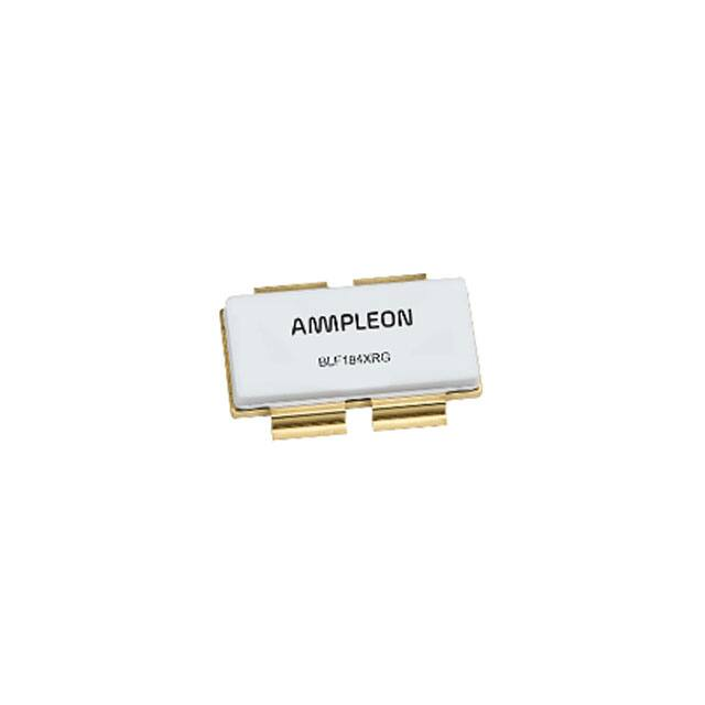

BLF184XRG Power LDMOS transistor Rev. 2 — 1 September 2015 Product data sheet 1. Product profile 1.1 General description A 700 W extremely rugged LDMOS power transistor for broadcast and industrial applications in the HF to 600 MHz band. Table 1. Application information VDS PL Gp D Test signal f (MHz) (V) (W) (dB) (%) pulsed RF 108 50 700 23.9 73.5 CW 108 50 750 23.5 81.9 1.2 Features and benefits        Easy power control Integrated ESD protection Excellent ruggedness High efficiency Excellent thermal stability Designed for broadband operation (HF to 600 MHz) Compliant to Directive 2002/95/EC, regarding Restriction of Hazardous Substances (RoHS) 1.3 Applications  Industrial, scientific and medical applications  Broadcast transmitter applications BLF184XRG Power LDMOS transistor 2. Pinning information Table 2. Pinning Pin Description 1 drain1 2 drain2 3 gate1 4 gate2 5 Simplified outline 1 2 3 4 Graphic symbol 1 3 [1] source 5 5 4 2 sym117 [1] Connected to flange. 3. Ordering information Table 3. Ordering information Type number BLF184XRG Package Name Description Version - earless flanged LDMOST ceramic package; 4 leads SOT1214C 4. Limiting values Table 4. Limiting values In accordance with the Absolute Maximum Rating System (IEC 60134). Symbol Parameter VDS Min Max Unit drain-source voltage - 135 V VGS gate-source voltage 6 +11 V Tstg storage temperature 65 +150 C Tj junction temperature - 225 C [1] Conditions [1] Continuous use at maximum temperature will affect the reliability, for details refer to the on-line MTF calculator. 5. Thermal characteristics Table 5. Thermal characteristics Symbol Parameter Product data sheet Tj = 150 C [1][2] Rth(j-c) thermal resistance from junction to case Zth(j-c) transient thermal impedance from junction Tj = 150 C; tp = 100 s; to case  = 20 % [1] BLF184XRG#2 Conditions [3] Typ Unit 0.18 K/W 0.065 K/W Tj is the junction temperature. [2] Rth(j-c) is measured under RF conditions. [3] See Figure 3. All information provided in this document is subject to legal disclaimers. Rev. 2 — 1 September 2015 © Ampleon The Netherlands B.V. 2015. All rights reserved. 2 of 13 BLF184XRG Power LDMOS transistor aaa-011222 0.2 Zth(j-c) (K/W) 0.16 (7) (6) (5) (4) (3) (2) (1) 0.12 0.08 0.04 0 10-7 10-6 10-5 10-4 10-3 10-2 10-1 tp (s) 1 (1)  = 1 % (2)  = 2 % (3)  = 5 % (4)  = 10 % (5)  = 20 % (6)  = 50 % (7)  = 100 % (DC) Fig 1. Transient thermal impedance from junction to case as a function of pulse duration 6. Characteristics Table 6. DC characteristics Tj = 25 C; per section unless otherwise specified. BLF184XRG#2 Product data sheet Symbol Parameter Conditions Min Typ Max Unit V(BR)DSS drain-source breakdown voltage VGS = 0 V; ID = 2.75 mA 135 - - V VGS(th) gate-source threshold voltage VDS = 10 V; ID = 275 mA 1.25 1.9 2.25 V VGSq gate-source quiescent voltage VDS = 50 V; ID = 50 mA - 1.6 - V IDSS drain leakage current VGS = 0 V; VDS = 50 V - - 1.4 A IDSX drain cut-off current VGS = VGS(th) + 3.75 V; VDS = 10 V - 38.5 - A IGSS gate leakage current VGS = 11 V; VDS = 0 V - - 140 nA RDS(on) drain-source on-state resistance VGS = VGS(th) + 3.75 V; ID = 9.625 A - 0.16 -  All information provided in this document is subject to legal disclaimers. Rev. 2 — 1 September 2015 © Ampleon The Netherlands B.V. 2015. All rights reserved. 3 of 13 BLF184XRG Power LDMOS transistor Table 7. AC characteristics Tj = 25 C; per section unless otherwise specified. Symbol Parameter Conditions Min Typ Max Unit Crs feedback capacitance VGS = 0 V; VDS = 50 V; f = 1 MHz - 3.1 - pF Ciss input capacitance VGS = 0 V; VDS = 50 V; f = 1 MHz - 292 - pF Coss output capacitance VGS = 0 V; VDS = 50 V; f = 1 MHz - 107 - pF Table 8. RF characteristics Test signal: pulsed RF; tp = 100 s;  = 20 %; f = 108 MHz; RF performance at VDS = 50 V; IDq = 100 mA; Tcase = 25 C; unless otherwise specified; in a class-AB production test circuit. Symbol Parameter Conditions Min Typ Max Unit Gp power gain PL = 700 W 22.8 23.9 - dB RLin input return loss PL = 700 W - 20 13 dB D drain efficiency PL = 700 W 71 73.5 - % aaa-011223 600 Coss (pF) 450 300 150 0 0 10 20 30 40 VDS (V) 50 VGS = 0 V; f = 1 MHz. Fig 2. Output capacitance as a function of drain-source voltage; typical values per section 7. Test information 7.1 Ruggedness in class-AB operation The BLF184XRG is capable of withstanding a load mismatch corresponding to VSWR > 65 : 1 through all phases under the following conditions: VDS = 50 V; IDq = 100 mA; PL = 700 W pulsed; f = 108 MHz. BLF184XRG#2 Product data sheet All information provided in this document is subject to legal disclaimers. Rev. 2 — 1 September 2015 © Ampleon The Netherlands B.V. 2015. All rights reserved. 4 of 13 BLF184XRG Power LDMOS transistor 7.2 Impedance information drain 1 gate 1 Zi ZL gate 2 drain 2 001aan207 Fig 3. Definition of transistor impedance Table 9. Typical push-pull impedance Simulated Zi and ZL device impedance; impedance info at VDS = 50 V and PL = 700 W. f Zi ZL (MHz) () () 108 5.8  j19.1 5.5 + j1.0 7.3 UIS avalanche energy Table 10. Typical avalanche data per section Tamb = 25 C; typical test data; test jig without water cooling. IAS EAS (A) (J) 15 4.3 20 2.1 25 1.3 For information see application note AN10273. aaa-009890 5 EAS (J) 4 3 2 1 0 10 Fig 4. BLF184XRG#2 Product data sheet 12.5 15 17.5 20 22.5 25 27.5 IAS (A) 30 Non-repetitive avalanche energy as a function of single pulse avalanche current, typical values All information provided in this document is subject to legal disclaimers. Rev. 2 — 1 September 2015 © Ampleon The Netherlands B.V. 2015. All rights reserved. 5 of 13 BLF184XRG Power LDMOS transistor 7.4 Test circuit 95 mm 95 mm C9 C13 - T2 C7 + L5 R1 C11 C15 C24 C1 L1 L3 80 mm C18 C19 C21 C20 C6 C2 L2 C3 L4 C5 C4 L7 C17 C22 C26 C23 L8 C27 C25 R2 C16 L6 C10 + C12 C8 C14 T1 - aaa-012339 38 mm 41 mm Printed-Circuit Board (PCB): Taconic RF-35; r = 3.5 F/m; thickness = 0.765 mm; thickness copper plating = 35 m, gold plated. See Table 11 for a list of components. Fig 5. Component layout for class-AB production test circuit Table 11. List of components For test circuit see Figure 5. Component Description Value Remarks C1, C2 multilayer ceramic chip capacitor 910 pF [1] C3 multilayer ceramic chip capacitor 47 pF [1] C4 multilayer ceramic chip capacitor 51 pF [1] C5 multilayer ceramic chip capacitor 100 pF [1] C6, C23 multilayer ceramic chip capacitor 20 pF C7, C8, C15, C16 multilayer ceramic chip capacitor 820 pF [1] C9, C10, C13, C14 multilayer ceramic chip capacitor 4.7 F, 100 V BLF184XRG#2 Product data sheet TDK: C5750X7R2A475KT 1000 F, 63 V C11, C12 electrolytic capacitor C17, C19 multilayer ceramic chip capacitor 39 pF [1] C18, C20 multilayer ceramic chip capacitor 27 pF [1] C21 multilayer ceramic chip capacitor 7.5 pF [1] C22 multilayer ceramic chip capacitor 22 pF [1] C24, C25 multilayer ceramic chip capacitor 27 pF [1] C26, C27 multilayer ceramic chip capacitor 1 nF [2] L1, L2, L3, L4 1.5 turn 0.8 mm copper wire D = 2.8 mm L5, L6 5.5 turn 0.8 mm copper wire D = 3.6 mm L7, L8 1 turn 1.5 mm copper wire D = 4 mm All information provided in this document is subject to legal disclaimers. Rev. 2 — 1 September 2015 © Ampleon The Netherlands B.V. 2015. All rights reserved. 6 of 13 BLF184XRG Power LDMOS transistor Table 11. List of components …continued For test circuit see Figure 5. Component Description Value Remarks R1, R2 resistor 10  SMD 1206 T1 semi rigid coax 25 , length = 160 mm Micro-Coax: UT-090C-25 T2 semi rigid coax 25 , length = 160 mm Micro-Coax: UT-141C-25 [1] American Technical Ceramics type 800B or capacitor of same quality. [2] American Technical Ceramics type 100B or capacitor of same quality. 7.5 Graphical data The following figures are measured in a class-AB production test circuit. 7.5.1 1-Tone CW pulsed aaa-011224 28 Gp (dB) ηD (%) ηD 26 aaa-011225 63 80 PL (dBm) Ideal PL 60 (2) (1) 59 PL 24 40 22 20 55 Gp 20 0 200 400 600 800 PL (W) 51 0 1000 25 VDS = 50 V; IDq = 100 mA; f = 108 MHz; tp = 100 s;  = 20 %. 27 29 31 33 35 37 39 Pi (dBm) VDS = 50 V; IDq = 100 mA; f = 108 MHz; tp = 100 s;  = 20 %. (1) PL(1dB) = 58.6 dBm (720 W) (2) PL(3dB) = 59 dBm (800 W) Fig 6. Power gain and drain efficiency as function of output power; typical values BLF184XRG#2 Product data sheet Fig 7. Output power as a function of input power; typical values All information provided in this document is subject to legal disclaimers. Rev. 2 — 1 September 2015 © Ampleon The Netherlands B.V. 2015. All rights reserved. 7 of 13 BLF184XRG Power LDMOS transistor aaa-011226 28 aaa-011227 80 ηD (%) Gp (dB) 26 60 24 (4) (3) (2) (1) (4) (3) (2) (1) 40 22 20 20 0 18 0 200 400 600 800 PL (W) 0 1000 VDS = 50 V; f = 108 MHz; tp = 100 s;  = 20 %. 200 400 (1) IDq = 50 mA (2) IDq = 100 mA (2) IDq = 100 mA (3) IDq = 200 mA (3) IDq = 200 mA (4) IDq = 400 mA (4) IDq = 100 mA Power gain as a function of output power; typical values Fig 9. aaa-011228 28 Gp (dB) 800 PL (W) 1000 VDS = 50 V; f = 108 MHz; tp = 100 s;  = 20 %. (1) IDq = 50 mA Fig 8. 600 Drain efficiency as a function of output power; typical values aaa-011229 80 (1) ηD (%) (2) (3) (4) (5) (6) 26 60 24 40 22 (6) (4) (5) 20 (3) 20 (2) (1) 18 0 0 200 400 600 800 PL (W) 1000 IDq = 100 mA; f = 108 MHz; tp = 100 s;  = 20 %. 0 200 (1) VDS = 25 V (2) VDS = 30 V (2) VDS = 30 V (3) VDS = 35 V (3) VDS = 35 V (4) VDS = 40 V (4) VDS = 40 V (5) VDS = 45 V (5) VDS = 45 V (6) VDS = 50 V (6) VDS = 50 V BLF184XRG#2 Product data sheet 600 800 PL (W) 1000 IDq = 100 mA; f = 108 MHz; tp = 100 s;  = 20 %. (1) VDS = 25 V Fig 10. Power gain as a function of output power; typical values 400 Fig 11. Drain efficiency as a function of output power; typical values All information provided in this document is subject to legal disclaimers. Rev. 2 — 1 September 2015 © Ampleon The Netherlands B.V. 2015. All rights reserved. 8 of 13 BLF184XRG Power LDMOS transistor 8. Package outline Earless flanged LDMOST ceramic package; 4 leads SOT1214C 0.3 mm gauge plane Lp D F A 5 y D1 Q detail X U1 v A B H1 w2 1 c C 2 E1 U2 H X 3 E 4 A b α w3 e 0 5 Dimensions (mm are the original dimensions) Unit A b c D D1 10 mm scale e E E1 F H H1 Lp Q U1 U2 v w2 w3 y α 1.38 0.195 20.70 9.91 0.15 max 4.72 6.17 0.15 20.02 19.96 9.53 9.50 1.14 14.3 nom 8.21 14.24 0.25 0.51 0.25 9.27 9.29 0.89 14.1 0.98 0.055 20.45 9.65 min 3.43 5.92 0.08 19.61 19.66 mm 7° 0° sot1214c_po Outline version References IEC JEDEC JEITA European projection Issue date 13-11-21 13-12-02 SOT1214C Fig 12. Package outline SOT1214C BLF184XRG#2 Product data sheet All information provided in this document is subject to legal disclaimers. Rev. 2 — 1 September 2015 © Ampleon The Netherlands B.V. 2015. All rights reserved. 9 of 13 BLF184XRG Power LDMOS transistor 9. Handling information CAUTION This device is sensitive to ElectroStatic Discharge (ESD). Observe precautions for handling electrostatic sensitive devices. Such precautions are described in the ANSI/ESD S20.20, IEC/ST 61340-5, JESD625-A or equivalent standards. 10. Abbreviations Table 12. Abbreviations Acronym Description CW Continuous Wave ESD ElectroStatic Discharge HF High Frequency LDMOS Laterally Diffused Metal-Oxide Semiconductor LDMOST Laterally Diffused Metal-Oxide Semiconductor Transistor MTF Median Time to Failure SMD Surface Mounted Device UIS Unclamped Inductive Switching VSWR Voltage Standing-Wave Ratio 11. Revision history Table 13. Revision history Document ID Release date Data sheet status Change notice Supersedes BLF184XRG v.2 20150901 Product data sheet - BLF184XRG v.1 Modifications: • The format of this document has been redesigned to comply with the new identity guidelines of Ampleon. Legal texts have been adapted to the new company name where appropriate. BLF184XRG v.1 BLF184XRG#2 Product data sheet 20141218 Product data sheet - All information provided in this document is subject to legal disclaimers. Rev. 2 — 1 September 2015 - © Ampleon The Netherlands B.V. 2015. All rights reserved. 10 of 13 BLF184XRG Power LDMOS transistor 12. Legal information 12.1 Data sheet status Document status[1][2] Product status[3] Objective [short] data sheet Development This document contains data from the objective specification for product development. Preliminary [short] data sheet Qualification This document contains data from the preliminary specification. Product [short] data sheet Production This document contains the product specification. Definition [1] Please consult the most recently issued document before initiating or completing a design. [2] The term ‘short data sheet’ is explained in section “Definitions”. [3] The product status of device(s) described in this document may have changed since this document was published and may differ in case of multiple devices. The latest product status information is available on the Internet at URL http://www.ampleon.com. 12.2 Definitions Draft — The document is a draft version only. The content is still under internal review and subject to formal approval, which may result in modifications or additions. Ampleon does not give any representations or warranties as to the accuracy or completeness of information included herein and shall have no liability for the consequences of use of such information. Short data sheet — A short data sheet is an extract from a full data sheet with the same product type number(s) and title. A short data sheet is intended for quick reference only and should not be relied upon to contain detailed and full information. For detailed and full information see the relevant full data sheet, which is available on request via the local Ampleon sales office. In case of any inconsistency or conflict with the short data sheet, the full data sheet shall prevail. Product specification — The information and data provided in a Product data sheet shall define the specification of the product as agreed between Ampleon and its customer, unless Ampleon and customer have explicitly agreed otherwise in writing. In no event however, shall an agreement be valid in which the Ampleon product is deemed to offer functions and qualities beyond those described in the Product data sheet. 12.3 Disclaimers Limited warranty and liability — Information in this document is believed to be accurate and reliable. However, Ampleon does not give any representations or warranties, expressed or implied, as to the accuracy or completeness of such information and shall have no liability for the consequences of use of such information. Ampleon takes no responsibility for the content in this document if provided by an information source outside of Ampleon. In no event shall Ampleon be liable for any indirect, incidental, punitive, special or consequential damages (including - without limitation - lost profits, lost savings, business interruption, costs related to the removal or replacement of any products or rework charges) whether or not such damages are based on tort (including negligence), warranty, breach of contract or any other legal theory. Notwithstanding any damages that customer might incur for any reason whatsoever, Ampleon’ aggregate and cumulative liability towards customer for the products described herein shall be limited in accordance with the Terms and conditions of commercial sale of Ampleon. Right to make changes — Ampleon reserves the right to make changes to information published in this document, including without limitation specifications and product descriptions, at any time and without notice. This document supersedes and replaces all information supplied prior to the publication hereof. Suitability for use — Ampleon products are not designed, authorized or warranted to be suitable for use in life support, life-critical or safety-critical systems or equipment, nor in applications where failure or malfunction of an BLF184XRG#2 Product data sheet Ampleon product can reasonably be expected to result in personal injury, death or severe property or environmental damage. Ampleon and its suppliers accept no liability for inclusion and/or use of Ampleon products in such equipment or applications and therefore such inclusion and/or use is at the customer’s own risk. Applications — Applications that are described herein for any of these products are for illustrative purposes only. Ampleon makes no representation or warranty that such applications will be suitable for the specified use without further testing or modification. Customers are responsible for the design and operation of their applications and products using Ampleon products, and Ampleon accepts no liability for any assistance with applications or customer product design. It is customer’s sole responsibility to determine whether the Ampleon product is suitable and fit for the customer’s applications and products planned, as well as for the planned application and use of customer’s third party customer(s). Customers should provide appropriate design and operating safeguards to minimize the risks associated with their applications and products. Ampleon does not accept any liability related to any default, damage, costs or problem which is based on any weakness or default in the customer’s applications or products, or the application or use by customer’s third party customer(s). Customer is responsible for doing all necessary testing for the customer’s applications and products using Ampleon products in order to avoid a default of the applications and the products or of the application or use by customer’s third party customer(s). Ampleon does not accept any liability in this respect. Limiting values — Stress above one or more limiting values (as defined in the Absolute Maximum Ratings System of IEC 60134) will cause permanent damage to the device. Limiting values are stress ratings only and (proper) operation of the device at these or any other conditions above those given in the Recommended operating conditions section (if present) or the Characteristics sections of this document is not warranted. Constant or repeated exposure to limiting values will permanently and irreversibly affect the quality and reliability of the device. Terms and conditions of commercial sale — Ampleon products are sold subject to the general terms and conditions of commercial sale, as published at http://www.ampleon.com/terms, unless otherwise agreed in a valid written individual agreement. In case an individual agreement is concluded only the terms and conditions of the respective agreement shall apply. Ampleon hereby expressly objects to applying the customer’s general terms and conditions with regard to the purchase of Ampleon products by customer. No offer to sell or license — Nothing in this document may be interpreted or construed as an offer to sell products that is open for acceptance or the grant, conveyance or implication of any license under any copyrights, patents or other industrial or intellectual property rights. Export control — This document as well as the item(s) described herein may be subject to export control regulations. Export might require a prior authorization from competent authorities. All information provided in this document is subject to legal disclaimers. Rev. 2 — 1 September 2015 © Ampleon The Netherlands B.V. 2015. All rights reserved. 11 of 13 BLF184XRG Power LDMOS transistor Non-automotive qualified products — Unless this data sheet expressly states that this specific Ampleon product is automotive qualified, the product is not suitable for automotive use. It is neither qualified nor tested in accordance with automotive testing or application requirements. Ampleon accepts no liability for inclusion and/or use of non-automotive qualified products in automotive equipment or applications. In the event that customer uses the product for design-in and use in automotive applications to automotive specifications and standards, customer (a) shall use the product without Ampleon’ warranty of the product for such automotive applications, use and specifications, and (b) whenever customer uses the product for automotive applications beyond Ampleon’ specifications such use shall be solely at customer’s own risk, and (c) customer fully indemnifies Ampleon for any liability, damages or failed product claims resulting from customer design and use of the product for automotive applications beyond Ampleon’ standard warranty and Ampleon’ product specifications. 12.4 Trademarks Notice: All referenced brands, product names, service names and trademarks are the property of their respective owners. Any reference or use of any ‘NXP’ trademark in this document or in or on the surface of Ampleon products does not result in any claim, liability or entitlement vis-à-vis the owner of this trademark. Ampleon is no longer part of the NXP group of companies and any reference to or use of the ‘NXP’ trademarks will be replaced by reference to or use of Ampleon’s own Any reference or use of any ‘NXP’ trademark in this document or in or on the surface of Ampleon products does not result in any claim, liability or entitlement vis-à-vis the owner of this trademark. Ampleon is no longer part of the NXP group of companies and any reference to or use of the ‘NXP’ trademarks will be replaced by reference to or use of Ampleon’s own trademarks. Translations — A non-English (translated) version of a document is for reference only. The English version shall prevail in case of any discrepancy between the translated and English versions. 13. Contact information For more information, please visit: http://www.ampleon.com BLF184XRG#2 Product data sheet For sales office addresses, please visit: http://www.ampleon.com/sales All information provided in this document is subject to legal disclaimers. Rev. 2 — 1 September 2015 © Ampleon The Netherlands B.V. 2015. All rights reserved. 12 of 13 BLF184XRG Power LDMOS transistor 14. Contents 1 1.1 1.2 1.3 2 3 4 5 6 7 7.1 7.2 7.3 7.4 7.5 7.5.1 8 9 10 11 12 12.1 12.2 12.3 12.4 13 14 Product profile . . . . . . . . . . . . . . . . . . . . . . . . . . 1 General description . . . . . . . . . . . . . . . . . . . . . 1 Features and benefits . . . . . . . . . . . . . . . . . . . . 1 Applications . . . . . . . . . . . . . . . . . . . . . . . . . . . 1 Pinning information . . . . . . . . . . . . . . . . . . . . . . 2 Ordering information . . . . . . . . . . . . . . . . . . . . . 2 Limiting values. . . . . . . . . . . . . . . . . . . . . . . . . . 2 Thermal characteristics . . . . . . . . . . . . . . . . . . 2 Characteristics . . . . . . . . . . . . . . . . . . . . . . . . . . 3 Test information . . . . . . . . . . . . . . . . . . . . . . . . . 4 Ruggedness in class-AB operation . . . . . . . . . 4 Impedance information . . . . . . . . . . . . . . . . . . . 5 UIS avalanche energy . . . . . . . . . . . . . . . . . . . 5 Test circuit. . . . . . . . . . . . . . . . . . . . . . . . . . . . . 6 Graphical data . . . . . . . . . . . . . . . . . . . . . . . . . 7 1-Tone CW pulsed . . . . . . . . . . . . . . . . . . . . . . 7 Package outline . . . . . . . . . . . . . . . . . . . . . . . . . 9 Handling information. . . . . . . . . . . . . . . . . . . . 10 Abbreviations . . . . . . . . . . . . . . . . . . . . . . . . . . 10 Revision history . . . . . . . . . . . . . . . . . . . . . . . . 10 Legal information. . . . . . . . . . . . . . . . . . . . . . . 11 Data sheet status . . . . . . . . . . . . . . . . . . . . . . 11 Definitions . . . . . . . . . . . . . . . . . . . . . . . . . . . . 11 Disclaimers . . . . . . . . . . . . . . . . . . . . . . . . . . . 11 Trademarks. . . . . . . . . . . . . . . . . . . . . . . . . . . 12 Contact information. . . . . . . . . . . . . . . . . . . . . 12 Contents . . . . . . . . . . . . . . . . . . . . . . . . . . . . . . 13 Please be aware that important notices concerning this document and the product(s) described herein, have been included in section ‘Legal information’. © Ampleon The Netherlands B.V. 2015. All rights reserved. For more information, please visit: http://www.ampleon.com For sales office addresses, please visit: http://www.ampleon.com/sales Date of release: 1 September 2015 Document identifier: BLF184XRG#2
