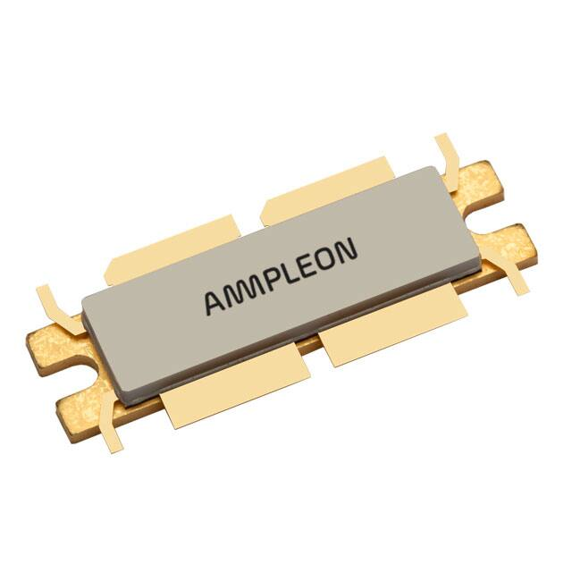

BLF6G15L-250PBRN Power LDMOS transistor Rev. 3 — 1 September 2015 Product data sheet 1. Product profile 1.1 General description 250 W LDMOS power transistor for base station applications at frequencies from 1450 MHz to 1550 MHz. Table 1. Typical performance Typical RF performance at Tcase = 25 C in a class-AB production test circuit. Mode of operation 2C-WCDMA [1] f VDS PL(AV) Gp D ACPR (MHz) (V) (W) (dB) (%) (dBc) 1476 to 1511 28 60 18.5 33.0 32[1] Test signal: 3GPP; test model 1; 64 DPCH; PAR = 7.5 dB at 0.01 % probability on CCDF per carrier. Carrier spacing 5 MHz. CAUTION This device is sensitive to ElectroStatic Discharge (ESD). Therefore care should be taken during transport and handling. 1.2 Features and benefits  Typical 2C-WCDMA performance at frequencies of 1476 MHz and 1511 MHz, a supply voltage of 28 V and an IDq of 1410 mA:  Average output power = 60 W  Power gain = 18.5 dB  Efficiency = 33.0 %  ACPR = 32 dBc  Easy power control  Integrated ESD protection  Enhanced ruggedness  High efficiency  Excellent thermal stability  Designed for broadband operation (1450 MHz to 1550 MHz)  Internally matched for ease of use  Compliant to Restriction of Hazardous Substances (RoHS) Directive 2002/95/EC  Integrated current sense BLF6G15L-250PBRN Power LDMOS transistor 1.3 Applications  RF power amplifiers for GSM, GSM EDGE, CDMA and W-CDMA and multi carrier applications in the 1450 MHz to 1550 MHz frequency range 2. Pinning information Table 2. Pinning Pin Description 1 drain1 2 drain2 3 gate1 4 gate2 5 source 6, 7 sense drain 8, 9 sense gate [1] Simplified outline 6 1 2 7 8 3 4 9 Graphic symbol 6, 7 1 3 5 8, 9 4 [1] 5 2 sym127 Connected to flange. 3. Ordering information Table 3. Ordering information Type number Package BLF6G15L-250PBRN Name Description Version - SOT1110A flanged LDMOST ceramic package; 2 mounting holes; 8 leads 4. Limiting values Table 4. Limiting values In accordance with the Absolute Maximum Rating System (IEC 60134). Symbol Parameter VDS Conditions Min Max Unit drain-source voltage - 65 V VGS gate-source voltage 0.5 +11 V ID drain current - 64 A Tstg storage temperature 65 +150 C Tj junction temperature - 200 C 5. Thermal characteristics Table 5. Symbol Thermal characteristics Parameter Rth(j-case) thermal resistance from junction to case BLF6G15L-250PBRN#3 Product data sheet Conditions Typ Tcase = 80 C; PL = 60 W (CW) 0.29 K/W All information provided in this document is subject to legal disclaimers. Rev. 3 — 1 September 2015 Unit © Ampleon The Netherlands B.V. 2015. All rights reserved. 2 of 13 BLF6G15L-250PBRN Power LDMOS transistor 6. Characteristics Table 6. Characteristics Tj = 25 C per section; unless otherwise specified Symbol Parameter Conditions Min Typ Max Unit V(BR)DSS drain-source breakdown voltage VGS = 0 V; ID = 1.8 mA 65 75 - V VGS(th) gate-source threshold voltage VDS = 10 V; ID = 180 mA 1.4 1.9 2.4 V IDq quiescent drain current sense transistor: 1.31 1.41 1.51 A IDS= 20.1 mA; VDS = 12 V main transistor: VDS = 28 V 2.8 A 25.3 29 - A VGS = 11 V; VDS = 0 V - - 280 nA forward transconductance VDS = 10 V; ID = 9 A 8.1 11.3 - drain-source on-state resistance VGS = VGS(th) + 3.75 V; ID = 6.3 A 0.03 0.1 IDSS drain leakage current VGS = 0 V; VDS = 28 V - IDSX drain cut-off current VGS = VGS(th) + 3.75 V; VDS = 10 V IGSS gate leakage current gfs RDS(on) - S 0.16  7. Application information Table 7. RF performance Mode of operation: 2-carrier W-CDMA; PAR 7.5 dB at 0.01 % probability on CCDF; 3GPP test model 1; 64 DPCH; f1 = 1473.4 MHz; f2 = 1478.4 MHz; f3 = 1508.4 MHz; f4 = 1513.4 MHz; RF performance at VDS = 28 V; IDq = 1410 mA; Tcase = 25 C; unless otherwise specified in a class-AB production test circuit. Symbol Parameter Conditions PL(AV) average output power Gp power gain RLin input return loss PL(AV) = 60 W D drain efficiency PL(AV) = 60 W ACPR adjacent channel power ratio PL(AV) = 60 W - PL(AV) = 60 W Min Typ Max Unit - 60 - W 16.5 18.5 - dB 8 12 - dB 30 33 - % 32 27 dBc Table 8. PAR performance Mode of operation; 1-carrier W-CDMA; PAR 7.5 dB at 0.01 % probability on CCDF; 3GPP test model 1; 64 DPCH; f1 = 1510.9 MHz; RF performance at VDS = 28 V; IDq = 1410 mA; Tcase = 25 C; unless otherwise specified in a class-AB production test circuit. Symbol Parameter PARO BLF6G15L-250PBRN#3 Product data sheet output peak-to-average ratio Conditions Min Typ Max Unit PL(AV) = 120 W at 0.01 % probability on CCDF 3.4 4.2 - dB All information provided in this document is subject to legal disclaimers. Rev. 3 — 1 September 2015 © Ampleon The Netherlands B.V. 2015. All rights reserved. 3 of 13 BLF6G15L-250PBRN Power LDMOS transistor Table 9. Phase binning Off state S11 measurement; VDS = 28 V; VGS = 0 V Marking code Input Resonance Frequency (GHz) Min Max 1 1.85 1.89 2 1.89 1.93 3 1.93 1.97 Table 10. Gain binning Mode of operation: 2-carrier W-CDMA; PAR 7.5 dB at 0.01 % probability on CCDF; 3GPP test model 1; 64 DPCH; f1 = 1473.4 MHz, f2 = 1478.4 MHz; PL(AV) = 60 W; VDS = 28 V; IDq = 1410 mA Marking code Gain at a center frequency of 1475.9 MHz in dB Min Max BT 17.0 17.5 BU 17.5 18.0 BW 18.0 18.5 BX 18.5 19.0 7.1 Ruggedness in class-AB operation The BLF6G15L-250PBRN is capable of withstanding a load mismatch corresponding to VSWR = 10 : 1 through all phases under the following conditions: VDS = 28 V; IDq = 1410 mA; PL = 200 W; f = 1475 MHz. 7.2 Impedance information Table 11. Typical impedance per section IDq = 950 mA; main transistor VDS = 28 V f ZS[1] ZL[1] (MHz) () () 1480 1.1  j2.8 2.3  j3.2 1510 1.3  j2.8 2.1  j2.8 [1] ZS and ZL defined in Figure 1. drain ZL gate ZS 001aaf059 Fig 1. BLF6G15L-250PBRN#3 Product data sheet Definition of transistor impedance All information provided in this document is subject to legal disclaimers. Rev. 3 — 1 September 2015 © Ampleon The Netherlands B.V. 2015. All rights reserved. 4 of 13 BLF6G15L-250PBRN Power LDMOS transistor 7.3 Graphs 7.3.1 CW 014aab101 21 (2) Gp (dB) ηD (3) 20 ηD (%) 50 014aab102 18 60 (1) RLin (dB) (1) 14 (2) 40 19 Gp (1) (3) (2) 30 18 (3) 10 20 17 16 0 50 100 150 10 200 250 PL (W) 6 0 50 (1) f = 1475 MHz (1) f = 1475 MHz (2) f = 1493 MHz (2) f = 1493 MHz (3) f = 1511 MHz (3) f = 1511 MHz Fig 2. Power gain and drain efficiency as function of output power; typical values BLF6G15L-250PBRN#3 Product data sheet Fig 3. 100 150 200 250 PL (W) Input return loss as a function of output power; typical values All information provided in this document is subject to legal disclaimers. Rev. 3 — 1 September 2015 © Ampleon The Netherlands B.V. 2015. All rights reserved. 5 of 13 BLF6G15L-250PBRN Power LDMOS transistor 7.3.2 IS-95 014aab099 20 Gp (dB) ηD (%) (1) Gp 19 (3) 014aab100 −25 50 (2) (3) ACPR (dBc) −35 9 ACPR1980k (3) 30 ηD (3) PAR (2) −45 (1) 18 ACPR885k (1) 40 (2) 11 −55 (1) (2) (2) (1) 7 5 (3) 17 20 16 0 40 80 10 160 120 −65 −75 PAR 0 40 PL (W) IS-95: PAR = 9.8 dB at 0.01 % probability of the CCDF. (1) f = 1475 MHz (1) f = 1475 MHz (2) f = 1493 MHz (2) f = 1493 MHz (3) f = 1511 MHz (3) f = 1511 MHz Power gain and drain efficiency as function of output power; typical values BLF6G15L-250PBRN#3 Product data sheet 1 160 120 PL (W) IS-95: PAR = 9.8 dB at 0.01 % probability of the CCDF. Fig 4. 80 3 Fig 5. Adjacent channel power ratio and peak-to-average power ratio as function of output power; typical values All information provided in this document is subject to legal disclaimers. Rev. 3 — 1 September 2015 © Ampleon The Netherlands B.V. 2015. All rights reserved. 6 of 13 BLF6G15L-250PBRN Power LDMOS transistor 7.3.3 2C-WCDMA (5 MHz spacing) 014aab097 21 Gp (dB) ηD (%) Gp (3) (2) 20 014aab098 −20 50 40 −25 ACPR (dBc) −30 ACPR10M −35 (2) (1) (2) −40 ηD 7.5 (2) (1) 30 (3) 7 (3) (3) (1) (2) 18 −45 20 PAR −50 −55 10 120 17 40 80 6.5 6 0 40 5.5 120 80 PL (W) PL (W) 3GPP: Test Model 1; 64 DPCH; PAR = 7.5 dB at 0.01 % probability per carrier; 5 MHz carrier spacing. 3GPP: Test Model 1; 64 DPCH; PAR = 7.5 dB at 0.01 % probability per carrier; 5 MHz carrier spacing. (1) f = 1475 MHz (1) f = 1475 MHz (2) f = 1493 MHz (2) f = 1493 MHz (3) f = 1511 MHz Fig 6. 8.0 (3) 19 0 PAR 8.5 (1) (1) 9 ACPR5M (3) f = 1511 MHz Power gain and drain efficiency as function of output power; typical values Fig 7. Adjacent channel power ratio and peak-to-average power ratio as function of output power; typical values 8. Test information Table 12. List of components See Figure 8 for component layout. Component Description Value Remarks C1, C2, C3, C4 multi layer ceramic chip capacitor 100 pF [1] C5, C6 multi layer ceramic chip capacitor 10 F [2] C7 multi layer ceramic chip capacitor 10 nF [2] on input gate line as shown C8 multi layer ceramic chip capacitor 100 nF [2] C10 multi layer ceramic chip capacitor 2.4 pF [1] C11 multi layer ceramic chip capacitor 3.6 pF [3] C12 electrolytic capacitor 470 F; 63 V C13, C14, C15, C16 multi layer ceramic chip capacitor 33 pF R1 chip resistor 3.9 k Philips 0603 R2 chip resistor 2.2 k Philips 0603 R3 chip resistor 10  Philips 0603 R4 chip resistor 0 Philips 0603 [1] American Technical Ceramics type 800B or capacitor of same quality. [2] TDK or capacitor of same quality. [3] American Technical Ceramics type 100B or capacitor of same quality. BLF6G15L-250PBRN#3 Product data sheet All information provided in this document is subject to legal disclaimers. Rev. 3 — 1 September 2015 [3] © Ampleon The Netherlands B.V. 2015. All rights reserved. 7 of 13 BLF6G15L-250PBRN Power LDMOS transistor R2 − C7 + C12 R4 R1 C8 R3 C1 C5 C3 C15 C13 C11 C10 BLF6G15L-250BPRN Output Rev 03 C14 C6 C16 BLF6G15L-250BPRN input Rev 03 C4 C2 014aab104 Printed-Circuit Board (PCB): Taconic RF-35A2; r = 3.5 F/m; thickness = 0.762 mm; thickness copper plating = 35 m. The vias can be as a reference to place components. The above layout shows the test circuit used to measure the devices in production. A more appropriate application demonstration for specific customer needs can be provided. See Table 12 for list of components. Fig 8. Component layout BLF6G15L-250PBRN#3 Product data sheet All information provided in this document is subject to legal disclaimers. Rev. 3 — 1 September 2015 © Ampleon The Netherlands B.V. 2015. All rights reserved. 8 of 13 BLF6G15L-250PBRN Power LDMOS transistor 9. Package outline Flanged LDMOST ceramic package; 2 mounting holes; 8 leads SOT1110A D A F L D1 6 U1 B q C H1 w2 1 c D 7 2 a U2 p Z E1 E H 5 A 8 3 9 4 b1 b w3 e w1 Q A B w3 Z a 5.97 64° 5.72 62° 0.25 0 5 0.235 64° 10 mm 0.01 scale 0.225 62° Dimensions Unit(1) mm A max 5.36 nom min 3.99 b 1.14 b1 c D e D1 E 11.81 0.18 31.55 31.52 E1 F H H1 L 9.50 9.53 1.75 17.12 25.53 2.67 p Q(2) 3.30 2.26 13.72 0.89 11.56 0.10 30.94 30.96 q 9.30 9.27 1.50 16.10 25.27 2.41 References JEDEC JEITA 3.05 w2 0.25 0.51 41.02 10.03 2.01 1.625 0.405 0.01 0.02 1.4 1.615 0.395 sot1110a_po European projection Issue date 10-02-02 12-02-20 SOT1110A Fig 9. w1 41.28 10.29 Note 1. millimeter dimensions are derived from the original inch dimensions. 2. dimension is measured 0.030 inch (0.76 mm) from the body. 3. recommended screw pitch dimension of 1.52 inch (38.6 mm) based on M3 screw. IEC U2 35.56 max 0.211 0.045 0.465 0.007 1.242 1.241 0.374 0.375 0.069 0.674 1.005 0.105 0.13 0.089 0.540 inches nom min 0.157 0.035 0.455 0.004 1.218 1.219 0.366 0.365 0.059 0.634 0.995 0.095 0.12 0.079 Outline version U1 Package outline SOT1110A BLF6G15L-250PBRN#3 Product data sheet All information provided in this document is subject to legal disclaimers. Rev. 3 — 1 September 2015 © Ampleon The Netherlands B.V. 2015. All rights reserved. 9 of 13 BLF6G15L-250PBRN Power LDMOS transistor 10. Abbreviations Table 13. Abbreviations Acronym Description CCDF Complementary Cumulative Distribution Function CDMA Code Division Multiple Access CW Continuous Wave EDGE Enhanced Data rates for GSM Evolution DPCH Dedicated Physical CHannel GSM Global System for Mobile communications IS-95 Interim Standard 95 LDMOS Laterally Diffused Metal-Oxide Semiconductor LDMOST Laterally Diffused Metal-Oxide Semiconductor Transistor PAR Peak-to-Average power Ratio RF Radio Frequency VSWR Voltage Standing-Wave Ratio W-CDMA Wideband Code Division Multiple Access 11. Revision history Table 14. Revision history Document ID Release date Data sheet status Change notice Supersedes BLF6G15L-250PBRN#3 20150901 Product data sheet - BLF6G15L-250PBRN v.2 Modifications: • The format of this document has been redesigned to comply with the new identity guidelines of Ampleon. • Legal texts have been adapted to the new company name where appropriate. BLF6G15L-250PBRN v.2 20101103 Product data sheet - BLF6G15L-250PBRN v.1 BLF6G15L-250PBRN v.1 20100914 Preliminary data sheet - - BLF6G15L-250PBRN#3 Product data sheet All information provided in this document is subject to legal disclaimers. Rev. 3 — 1 September 2015 © Ampleon The Netherlands B.V. 2015. All rights reserved. 10 of 13 BLF6G15L-250PBRN Power LDMOS transistor 12. Legal information 12.1 Data sheet status Document status[1][2] Product status[3] Objective [short] data sheet Development This document contains data from the objective specification for product development. Preliminary [short] data sheet Qualification This document contains data from the preliminary specification. Product [short] data sheet Production This document contains the product specification. Definition [1] Please consult the most recently issued document before initiating or completing a design. [2] The term ‘short data sheet’ is explained in section “Definitions”. [3] The product status of device(s) described in this document may have changed since this document was published and may differ in case of multiple devices. The latest product status information is available on the Internet at URL http://www.ampleon.com. 12.2 Definitions Draft — The document is a draft version only. The content is still under internal review and subject to formal approval, which may result in modifications or additions. Ampleon does not give any representations or warranties as to the accuracy or completeness of information included herein and shall have no liability for the consequences of use of such information. Short data sheet — A short data sheet is an extract from a full data sheet with the same product type number(s) and title. A short data sheet is intended for quick reference only and should not be relied upon to contain detailed and full information. For detailed and full information see the relevant full data sheet, which is available on request via the local Ampleon sales office. In case of any inconsistency or conflict with the short data sheet, the full data sheet shall prevail. Product specification — The information and data provided in a Product data sheet shall define the specification of the product as agreed between Ampleon and its customer, unless Ampleon and customer have explicitly agreed otherwise in writing. In no event however, shall an agreement be valid in which the Ampleon product is deemed to offer functions and qualities beyond those described in the Product data sheet. 12.3 Disclaimers Limited warranty and liability — Information in this document is believed to be accurate and reliable. However, Ampleon does not give any representations or warranties, expressed or implied, as to the accuracy or completeness of such information and shall have no liability for the consequences of use of such information. Ampleon takes no responsibility for the content in this document if provided by an information source outside of Ampleon. In no event shall Ampleon be liable for any indirect, incidental, punitive, special or consequential damages (including - without limitation - lost profits, lost savings, business interruption, costs related to the removal or replacement of any products or rework charges) whether or not such damages are based on tort (including negligence), warranty, breach of contract or any other legal theory. Notwithstanding any damages that customer might incur for any reason whatsoever, Ampleon’ aggregate and cumulative liability towards customer for the products described herein shall be limited in accordance with the Terms and conditions of commercial sale of Ampleon. Right to make changes — Ampleon reserves the right to make changes to information published in this document, including without limitation specifications and product descriptions, at any time and without notice. This document supersedes and replaces all information supplied prior to the publication hereof. Suitability for use — Ampleon products are not designed, authorized or warranted to be suitable for use in life support, life-critical or safety-critical systems or equipment, nor in applications where failure or malfunction of an BLF6G15L-250PBRN#3 Product data sheet Ampleon product can reasonably be expected to result in personal injury, death or severe property or environmental damage. Ampleon and its suppliers accept no liability for inclusion and/or use of Ampleon products in such equipment or applications and therefore such inclusion and/or use is at the customer’s own risk. Applications — Applications that are described herein for any of these products are for illustrative purposes only. Ampleon makes no representation or warranty that such applications will be suitable for the specified use without further testing or modification. Customers are responsible for the design and operation of their applications and products using Ampleon products, and Ampleon accepts no liability for any assistance with applications or customer product design. It is customer’s sole responsibility to determine whether the Ampleon product is suitable and fit for the customer’s applications and products planned, as well as for the planned application and use of customer’s third party customer(s). Customers should provide appropriate design and operating safeguards to minimize the risks associated with their applications and products. Ampleon does not accept any liability related to any default, damage, costs or problem which is based on any weakness or default in the customer’s applications or products, or the application or use by customer’s third party customer(s). Customer is responsible for doing all necessary testing for the customer’s applications and products using Ampleon products in order to avoid a default of the applications and the products or of the application or use by customer’s third party customer(s). Ampleon does not accept any liability in this respect. Limiting values — Stress above one or more limiting values (as defined in the Absolute Maximum Ratings System of IEC 60134) will cause permanent damage to the device. Limiting values are stress ratings only and (proper) operation of the device at these or any other conditions above those given in the Recommended operating conditions section (if present) or the Characteristics sections of this document is not warranted. Constant or repeated exposure to limiting values will permanently and irreversibly affect the quality and reliability of the device. Terms and conditions of commercial sale — Ampleon products are sold subject to the general terms and conditions of commercial sale, as published at http://www.ampleon.com/terms, unless otherwise agreed in a valid written individual agreement. In case an individual agreement is concluded only the terms and conditions of the respective agreement shall apply. Ampleon hereby expressly objects to applying the customer’s general terms and conditions with regard to the purchase of Ampleon products by customer. No offer to sell or license — Nothing in this document may be interpreted or construed as an offer to sell products that is open for acceptance or the grant, conveyance or implication of any license under any copyrights, patents or other industrial or intellectual property rights. Export control — This document as well as the item(s) described herein may be subject to export control regulations. Export might require a prior authorization from competent authorities. All information provided in this document is subject to legal disclaimers. Rev. 3 — 1 September 2015 © Ampleon The Netherlands B.V. 2015. All rights reserved. 11 of 13 BLF6G15L-250PBRN Power LDMOS transistor Non-automotive qualified products — Unless this data sheet expressly states that this specific Ampleon product is automotive qualified, the product is not suitable for automotive use. It is neither qualified nor tested in accordance with automotive testing or application requirements. Ampleon accepts no liability for inclusion and/or use of non-automotive qualified products in automotive equipment or applications. In the event that customer uses the product for design-in and use in automotive applications to automotive specifications and standards, customer (a) shall use the product without Ampleon’ warranty of the product for such automotive applications, use and specifications, and (b) whenever customer uses the product for automotive applications beyond Ampleon’ specifications such use shall be solely at customer’s own risk, and (c) customer fully indemnifies Ampleon for any liability, damages or failed product claims resulting from customer design and use of the product for automotive applications beyond Ampleon’ standard warranty and Ampleon’ product specifications. 12.4 Trademarks Notice: All referenced brands, product names, service names and trademarks are the property of their respective owners. Any reference or use of any ‘NXP’ trademark in this document or in or on the surface of Ampleon products does not result in any claim, liability or entitlement vis-à-vis the owner of this trademark. Ampleon is no longer part of the NXP group of companies and any reference to or use of the ‘NXP’ trademarks will be replaced by reference to or use of Ampleon’s own Any reference or use of any ‘NXP’ trademark in this document or in or on the surface of Ampleon products does not result in any claim, liability or entitlement vis-à-vis the owner of this trademark. Ampleon is no longer part of the NXP group of companies and any reference to or use of the ‘NXP’ trademarks will be replaced by reference to or use of Ampleon’s own trademarks. Translations — A non-English (translated) version of a document is for reference only. The English version shall prevail in case of any discrepancy between the translated and English versions. 13. Contact information For more information, please visit: http://www.ampleon.com BLF6G15L-250PBRN#3 Product data sheet For sales office addresses, please visit: http://www.ampleon.com/sales All information provided in this document is subject to legal disclaimers. Rev. 3 — 1 September 2015 © Ampleon The Netherlands B.V. 2015. All rights reserved. 12 of 13 BLF6G15L-250PBRN Power LDMOS transistor 14. Contents 1 1.1 1.2 1.3 2 3 4 5 6 7 7.1 7.2 7.3 7.3.1 7.3.2 7.3.3 8 9 10 11 12 12.1 12.2 12.3 12.4 13 14 Product profile . . . . . . . . . . . . . . . . . . . . . . . . . . 1 General description . . . . . . . . . . . . . . . . . . . . . 1 Features and benefits . . . . . . . . . . . . . . . . . . . . 1 Applications . . . . . . . . . . . . . . . . . . . . . . . . . . . 2 Pinning information . . . . . . . . . . . . . . . . . . . . . . 2 Ordering information . . . . . . . . . . . . . . . . . . . . . 2 Limiting values. . . . . . . . . . . . . . . . . . . . . . . . . . 2 Thermal characteristics . . . . . . . . . . . . . . . . . . 2 Characteristics . . . . . . . . . . . . . . . . . . . . . . . . . . 3 Application information. . . . . . . . . . . . . . . . . . . 3 Ruggedness in class-AB operation . . . . . . . . . 4 Impedance information . . . . . . . . . . . . . . . . . . . 4 Graphs . . . . . . . . . . . . . . . . . . . . . . . . . . . . . . . 5 CW . . . . . . . . . . . . . . . . . . . . . . . . . . . . . . . . . . 5 IS-95 . . . . . . . . . . . . . . . . . . . . . . . . . . . . . . . . . 6 2C-WCDMA (5 MHz spacing) . . . . . . . . . . . . . . 7 Test information . . . . . . . . . . . . . . . . . . . . . . . . . 7 Package outline . . . . . . . . . . . . . . . . . . . . . . . . . 9 Abbreviations . . . . . . . . . . . . . . . . . . . . . . . . . . 10 Revision history . . . . . . . . . . . . . . . . . . . . . . . . 10 Legal information. . . . . . . . . . . . . . . . . . . . . . . 11 Data sheet status . . . . . . . . . . . . . . . . . . . . . . 11 Definitions . . . . . . . . . . . . . . . . . . . . . . . . . . . . 11 Disclaimers . . . . . . . . . . . . . . . . . . . . . . . . . . . 11 Trademarks. . . . . . . . . . . . . . . . . . . . . . . . . . . 12 Contact information. . . . . . . . . . . . . . . . . . . . . 12 Contents . . . . . . . . . . . . . . . . . . . . . . . . . . . . . . 13 Please be aware that important notices concerning this document and the product(s) described herein, have been included in section ‘Legal information’. © Ampleon The Netherlands B.V. 2015. All rights reserved. For more information, please visit: http://www.ampleon.com For sales office addresses, please visit: http://www.ampleon.com/sales Date of release: 1 September 2015 Document identifier: BLF6G15L-250PBRN#3
