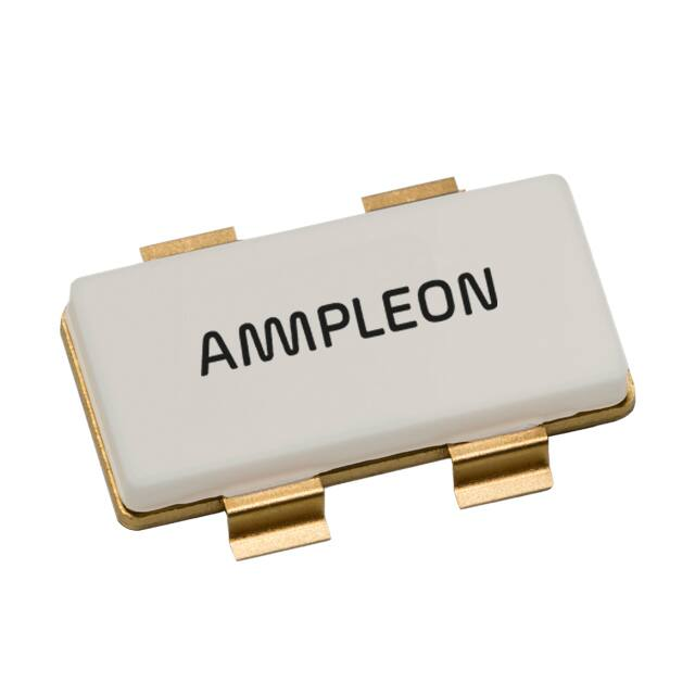

BLF6G27L-40P; BLF6G27LS-40P(G) Power LDMOS transistor Rev. 4 — 1 September 2015 Product data sheet 1. Product profile 1.1 General description 40 W LDMOS power transistor for base station applications at frequencies from 2500 MHz to 2700 MHz, also suitable for operation at 2300 MHz to 2400 MHz. Table 1. Typical performance Typical RF performance at Tcase = 25 C in a common source class-AB production test circuit. f IDq VDS PL(AV) Gp D (MHz) (mA) (V) (W) (dB) (%) (dBc) 2500 to 2700 450 28 12 17.5 30 46 [1] - Single carrier W-CDMA 2500 to 2700 450 28 20 17.5 37 - 35 [2] Test signal IS-95 [1] ACPR885k ACPR5M (dBc) Single carrier IS-95 with pilot, paging, sync and 6 traffic channels (Walsh codes 8 - 13). PAR = 9.7 dB at 0.01 % probability on the CCDF. Channel bandwidth is 1.2288 MHz. [2] 3GPP; test model 1; 64 DPCH; PAR = 7.2 dB at 0.01 % probability on CCDF. Channel bandwidth is 3.84 MHz. 1.2 Features and benefits           Excellent ruggedness High efficiency Low thermal resistance providing excellent thermal stability Designed for broadband operation (2500 MHz to 2700 MHz) Lower output capacitance for improved performance in Doherty applications Designed for low memory effects providing excellent pre-distortability Design optimized for gull-wing and straight lead versions Internally matched for ease of use Integrated ESD protection Compliant to Directive 2002/95/EC, regarding Restriction of Hazardous Substances (RoHS) 1.3 Applications  RF power amplifiers for W-CDMA base stations and multi carrier applications in the 2500 MHz to 2700 MHz frequency range BLF6G27L-40P;BLF6G27LS-40P(G) Power LDMOS transistor 2. Pinning information Table 2. Pinning Pin Description Simplified outline Graphic symbol BLF6G27L-40P (SOT1121A) 1 drain1 2 drain2 3 gate1 4 gate2 5 1 1 2 3 [1] source 5 3 5 4 4 2 sym117 BLF6G27LS-40P (SOT1121B) 1 drain1 2 drain2 3 gate1 4 gate2 5 1 1 2 3 4 5 5 4 [1] source 3 2 sym117 BLF6G27LS-40PG (SOT1121E) 1 drain1 2 drain2 3 gate1 4 gate2 5 source 1 2 3 4 1 5 3 5 4 [1] 2 sym117 [1] Connected to flange. 3. Ordering information Table 3. Ordering information Type number Package Name Description BLF6G27L-40P_LS-40P_LS-40PG#4 Product data sheet Version BLF6G27L-40P - flanged LDMOST ceramic package; 2 mounting holes; SOT1121A 4 leads BLF6G27LS-40P - earless flanged ceramic package; 4 leads SOT1121B BLF6G27LS-40PG - earless flanged LDMOST ceramic package; 4 leads SOT1121E All information provided in this document is subject to legal disclaimers. Rev. 4 — 1 September 2015 © Ampleon The Netherlands B.V. 2015. All rights reserved. 2 of 15 BLF6G27L-40P;BLF6G27LS-40P(G) Power LDMOS transistor 4. Limiting values Table 4. Limiting values In accordance with the Absolute Maximum Rating System (IEC 60134). Symbol Parameter Conditions Min Max Unit VDS drain-source voltage - 65 V VGS gate-source voltage 0.5 +13 V Tstg storage temperature 65 +150 C - 225 C junction temperature Tj [1] [1] Continuous use at maximum temperature will affect the reliability, for details refer to the on-line MTF calculator. 5. Thermal characteristics Table 5. Thermal characteristics Symbol Parameter Conditions Typ Unit Rth(j-c) thermal resistance from junction to case Tcase = 80 C; PL = 40 W 0.7 K/W 6. Characteristics Table 6. Characteristics Tj = 25 C; per section unless otherwise specified. Symbol Parameter Conditions V(BR)DSS drain-source breakdown voltage VGS = 0 V; ID = 0.4 mA BLF6G27L-40P_LS-40P_LS-40PG#4 Product data sheet Min Typ Max Unit 65 - - V VGS(th) gate-source threshold voltage VDS = 10 V; ID = 40 mA 1.4 1.8 2.4 V IDSS drain leakage current VGS = 0 V; VDS = 28 V - - 1.4 A IDSX drain cut-off current VGS = VGS(th) + 3.75 V; VDS = 10 V 5.96 7.2 - A IGSS gate leakage current VGS = 11 V; VDS = 0 V - - 150 nA gfs forward transconductance VDS = 10 V; ID = 2000 mA 1.8 2.9 - S RDS(on) drain-source on-state resistance VGS = VGS(th) + 3.75 V; ID = 1400 mA 0.14 0.36 -  All information provided in this document is subject to legal disclaimers. Rev. 4 — 1 September 2015 © Ampleon The Netherlands B.V. 2015. All rights reserved. 3 of 15 BLF6G27L-40P;BLF6G27LS-40P(G) Power LDMOS transistor 7. Test information Table 7. Functional test information Test signal: 1-carrier N-CDMA, single carrier IS-95 with pilot, paging, sync and 6 traffic channels (Walsh codes 8 - 13). PAR = 9.7 dB at 0.01 % probability on the CCDF, channel bandwidth is 1.2288 MHz; f1 = 2500 MHz; f2 = 2700 MHz; RF performance at VDS = 28 V; IDq = 450 mA; Tcase = 25 C; 2 sections combined unless otherwise specified; in a class-AB production test circuit. Symbol Parameter Conditions Min Typ Max Unit Gp power gain PL(AV) = 12 W 15.5 17.5 - dB RLin input return loss PL(AV) = 12 W - 10 - dB D drain efficiency PL(AV) = 12 W 26 30 % ACPR885k adjacent channel power ratio (885 kHz) PL(AV) = 12 W - 46 41 - dBc 7.1 Ruggedness in class-AB operation The BLF6G27L-40P, BLF6G27LS-40P and BLF6G27LS-40PG are capable of withstanding a load mismatch corresponding to VSWR = 10 : 1 through all phases under the following conditions: VDS = 28 V; IDq = 450 mA; PL = 40 W (CW); f = 2500 MHz. 7.2 Single carrier IS-95 Single carrier IS-95 with pilot, paging, sync and 6 traffic channels (Walsh codes 8 - 13). PAR = 9.7 dB at 0.01 % probability on the CCDF. Channel bandwidth is 1.2288 MHz. 001aan553 19 001aan554 50 ηD (%) Gp (dB) 40 (1) (2) (3) (4) (5) 17 (1) (2) (3) (4) (5) 30 20 15 10 13 0 0 10 20 30 40 50 0 10 20 30 PL (W) VDS = 28 V; IDq = 450 mA. VDS = 28 V; IDq = 450 mA. (1) f = 2500 MHz (2) f = 2550 MHz (2) f = 2550 MHz (3) f = 2600 MHz (3) f = 2600 MHz (4) f = 2650 MHz (4) f = 2650 MHz (5) f = 2700 MHz (5) f = 2700 MHz Single carrier IS-95 power gain as a function of output power; typical values BLF6G27L-40P_LS-40P_LS-40PG#4 Product data sheet 50 PL (W) (1) f = 2500 MHz Fig 1. 40 Fig 2. Single carrier IS-95 drain efficiency as a function of output power; typical values All information provided in this document is subject to legal disclaimers. Rev. 4 — 1 September 2015 © Ampleon The Netherlands B.V. 2015. All rights reserved. 4 of 15 BLF6G27L-40P;BLF6G27LS-40P(G) Power LDMOS transistor 001aan555 - 30 APCR855 (dBc) - 35 APCR1980 (dBc) (1) (2) (3) (4) (5) - 40 - 45 001aan556 - 45 (1) (2) (3) (4) (5) - 55 - 50 - 65 - 55 - 60 - 65 - 75 0 10 20 30 40 50 0 10 20 30 40 PL (W) VDS = 28 V; IDq = 450 mA. VDS = 28 V; IDq = 450 mA. (1) f = 2500 MHz (1) f = 2500 MHz (2) f = 2550 MHz (2) f = 2550 MHz (3) f = 2600 MHz (3) f = 2600 MHz (4) f = 2650 MHz (4) f = 2650 MHz (5) f = 2700 MHz (5) f = 2700 MHz Fig 3. Single carrier IS-95 ACPR at 885 kHz as a function of output power; typical values 001aan557 12 PAR (dB) Fig 4. Single carrier IS-95 ACPR at 1980 kHz as a function of output power; typical values 001aan558 100 PL(M) (W) 10 80 8 (1) (2) (3) (4) (5) 60 (1) (2) (3) (4) (5) 6 4 40 20 0 2 0 10 20 30 40 50 0 10 20 30 PL (W) VDS = 28 V; IDq = 450 mA. (2) f = 2550 MHz (2) f = 2550 MHz (3) f = 2600 MHz (3) f = 2600 MHz (4) f = 2650 MHz (4) f = 2650 MHz (5) f = 2700 MHz (5) f = 2700 MHz Single carrier IS-95 peak-to-average power ratio as a function of output power; typical values Product data sheet 50 VDS = 28 V; IDq = 450 mA. (1) f = 2500 MHz BLF6G27L-40P_LS-40P_LS-40PG#4 40 PL (W) (1) f = 2500 MHz Fig 5. 50 PL (W) Fig 6. Single carrier IS-95 peak output power as a function of output power; typical values All information provided in this document is subject to legal disclaimers. Rev. 4 — 1 September 2015 © Ampleon The Netherlands B.V. 2015. All rights reserved. 5 of 15 BLF6G27L-40P;BLF6G27LS-40P(G) Power LDMOS transistor 7.3 Pulsed CW 001aan559 19 Gp (dB) 001aan560 60 ηD (%) (1) (2) (3) (4) (5) 17 40 (1) (2) (3) (4) (5) 15 20 13 11 0 0 20 40 60 80 0 20 40 PL (W) VDS = 28 V; IDq = 450 mA. VDS = 28 V; IDq = 450 mA. (1) f = 2500 MHz (2) f = 2550 MHz (2) f = 2550 MHz (3) f = 2600 MHz (3) f = 2600 MHz (4) f = 2650 MHz (4) f = 2650 MHz (5) f = 2700 MHz (5) f = 2700 MHz Pulsed CW power gain as a function of output power; typical values BLF6G27L-40P_LS-40P_LS-40PG#4 Product data sheet 80 PL (W) (1) f = 2500 MHz Fig 7. 60 Fig 8. Pulsed CW drain efficiency as a function of output power; typical values All information provided in this document is subject to legal disclaimers. Rev. 4 — 1 September 2015 © Ampleon The Netherlands B.V. 2015. All rights reserved. 6 of 15 BLF6G27L-40P;BLF6G27LS-40P(G) Power LDMOS transistor 7.4 Single carrier W-CDMA 3GPP; test model 1; 64 DPCH; PAR = 7.2 dB at 0.01 % probability on CCDF. Channel bandwidth is 3.84 MHz. 001aan561 19 001aan562 50 ηD (%) Gp (dB) (1) (2) (3) (4) (5) 40 17 (1) (2) (3) (4) (5) 15 30 20 13 10 11 0 0 20 40 60 0 10 20 30 PL (W) VDS = 28 V; IDq = 450 mA. VDS = 28 V; IDq = 450 mA. (1) f = 2500 MHz (2) f = 2550 MHz (2) f = 2550 MHz (3) f = 2600 MHz (3) f = 2600 MHz (4) f = 2650 MHz (4) f = 2650 MHz (5) f = 2700 MHz (5) f = 2700 MHz Single carrier W-CDMA power gain as a function of output power; typical values BLF6G27L-40P_LS-40P_LS-40PG#4 Product data sheet 50 PL (W) (1) f = 2500 MHz Fig 9. 40 Fig 10. Single carrier W-CDMA drain efficiency as a function of output power; typical values All information provided in this document is subject to legal disclaimers. Rev. 4 — 1 September 2015 © Ampleon The Netherlands B.V. 2015. All rights reserved. 7 of 15 BLF6G27L-40P;BLF6G27LS-40P(G) Power LDMOS transistor 001aan563 - 20 APCR5M (dBc) - 25 001aan564 - 40 APCR10M (dBc) - 45 - 30 (1) (2) (3) (4) (5) - 35 (1) (2) (3) (4) (5) - 50 - 40 - 55 - 45 - 60 - 50 - 65 - 55 0 10 20 30 40 0 50 10 20 30 40 50 PL (W) PL (W) VDS = 28 V; IDq = 450 mA. VDS = 28 V; IDq = 450 mA. (1) f = 2500 MHz (1) f = 2500 MHz (2) f = 2550 MHz (2) f = 2550 MHz (3) f = 2600 MHz (3) f = 2600 MHz (4) f = 2650 MHz (4) f = 2650 MHz (5) f = 2700 MHz (5) f = 2700 MHz Fig 11. Single carrier W-CDMA ACPR at 5 MHz as a function of output power; typical values 001aan565 8 PAR (dB) Fig 12. Single carrier W-CDMA ACPR at 10 MHz as a function of output power; typical values 001aan566 100 PL(M) (W) 7 80 6 60 5 40 (1) (2) (3) (4) (5) 4 (1) (2) (3) (4) (5) 20 0 3 0 10 20 30 40 50 0 10 20 30 PL (W) VDS = 28 V; IDq = 450 mA. VDS = 28 V; IDq = 450 mA. (1) f = 2500 MHz (2) f = 2550 MHz (2) f = 2550 MHz (3) f = 2600 MHz (3) f = 2600 MHz (4) f = 2650 MHz (4) f = 2650 MHz (5) f = 2700 MHz (5) f = 2700 MHz Fig 13. Single carrier W-CDMA peak-to-average power ratio as a function of output power; typical values Product data sheet 50 PL (W) (1) f = 2500 MHz BLF6G27L-40P_LS-40P_LS-40PG#4 40 Fig 14. Single carrier W-CDMA peak output power as a function of output power; typical values All information provided in this document is subject to legal disclaimers. Rev. 4 — 1 September 2015 © Ampleon The Netherlands B.V. 2015. All rights reserved. 8 of 15 BLF6G27L-40P;BLF6G27LS-40P(G) Power LDMOS transistor 8. Package outline Flanged LDMOST ceramic package; 2 mounting holes; 4 leads SOT1121A D A F D1 U1 B q C H1 c 1 2 p U2 H E1 E 5 A w1 3 A B 4 b w2 C Q e 0 5 Dimensions Unit(1) mm 10 mm scale A max 4.75 nom min 3.45 b c D D1 3.94 0.18 20.02 19.96 3.68 0.10 19.61 19.66 E e E1 F H H1 p Q(2) 9.53 9.53 1.14 19.94 12.83 3.38 1.70 9.27 9.27 0.89 18.92 12.57 3.12 1.45 q U1 U2 max 0.187 0.155 0.007 0.788 0.786 0.375 0.375 0.045 0.785 0.505 0.133 0.067 inches nom 0.35 min 0.136 0.145 0.004 0.772 0.774 0.365 0.365 0.035 0.745 0.495 0.123 0.057 33.91 9.65 1.345 0.39 0.01 0.02 1.1 1.335 0.38 Note 1. millimeter dimensions are derived from the original inch dimensions. 2. dimension is measured 0.030 inch (0.76 mm) from the body. Outline version References IEC JEDEC JEITA w2 0.25 0.51 27.94 8.89 w1 34.16 9.91 sot1121a_po European projection Issue date 09-10-12 10-02-02 SOT1121A Fig 15. Package outline SOT1121A BLF6G27L-40P_LS-40P_LS-40PG#4 Product data sheet All information provided in this document is subject to legal disclaimers. Rev. 4 — 1 September 2015 © Ampleon The Netherlands B.V. 2015. All rights reserved. 9 of 15 BLF6G27L-40P;BLF6G27LS-40P(G) Power LDMOS transistor Earless flanged ceramic package; 4 leads SOT1121B D A F 5 D1 D U1 w2 H1 1 H c D 2 U2 E1 3 E 4 b y w3 e Q 0 5 10 mm scale Dimensions Unit(1) mm A max 4.75 nom min 3.45 b 3.94 c D D1 E e E1 F H H1 Q U1 U2 w2 w3 9.53 9.53 1.14 19.94 12.83 1.70 20.70 9.91 0.51 0.25 0.18 20.02 19.96 y 0.25 8.89 3.68 0.08 19.61 19.66 9.27 9.27 0.89 18.92 12.57 1.45 20.45 9.65 max 0.187 0.155 0.007 0.788 0.786 0.375 0.375 0.045 0.785 0.505 0.067 0.815 0.39 0.02 0.01 0.35 inches nom min 0.136 0.145 0.003 0.772 0.774 0.365 0.365 0.035 0.745 0.495 0.057 0.805 0.38 Note 1. millimeter dimensions are derived from the original inch dimensions. 2. dimension is measured 0.030 inch (0.76 mm) from the body. Outline version References IEC JEDEC JEITA 0.01 sot1121b_po European projection Issue date 09-12-14 12-06-07 SOT1121B Fig 16. Package outline SOT1121B BLF6G27L-40P_LS-40P_LS-40PG#4 Product data sheet All information provided in this document is subject to legal disclaimers. Rev. 4 — 1 September 2015 © Ampleon The Netherlands B.V. 2015. All rights reserved. 10 of 15 BLF6G27L-40P;BLF6G27LS-40P(G) Power LDMOS transistor Earless flanged LDMOST ceramic package; 4 leads SOT1121E 0.3 mm gauge plane D Lp A F 5 D1 y Q detail X U1 v B c H1 A X 1 H 2 E1 U2 3 E 4 A w2 b B α e 0 5 Dimensions Unit(1) mm 10 mm scale A b c D D1 e E E1 F H H1 Lp Q U1 U2 v w2 y max 4.75 3.94 0.18 20.02 19.96 9.53 9.53 1.14 14.3 12.83 1.38 0.050 20.70 9.91 0.25 0.25 0.10 8.89 nom min 3.45 3.68 0.08 19.61 19.66 9.27 9.27 0.89 14.1 12.57 0.98 -0.050 20.45 9.65 α 7° 0° max 0.187 0.155 0.007 0.788 0.786 0.375 0.375 0.045 0.563 0.505 0.055 -0.002 0.815 0.39 0.01 0.01 0.004 7° 0.35 inches nom 0° min 0.136 0.145 0.003 0.772 0.774 0.365 0.365 0.035 0.555 0.495 0.039 -0.002 0.805 0.38 Note 1. Millimeter dimensions are derived from the original inch dimensions. Outline version References IEC JEDEC JEITA sot1121e_po European projection Issue date 14-06-12 14-06-23 SOT1121E Fig 17. Package outline SOT1121E BLF6G27L-40P_LS-40P_LS-40PG#4 Product data sheet All information provided in this document is subject to legal disclaimers. Rev. 4 — 1 September 2015 © Ampleon The Netherlands B.V. 2015. All rights reserved. 11 of 15 BLF6G27L-40P;BLF6G27LS-40P(G) Power LDMOS transistor 9. Handling information CAUTION This device is sensitive to ElectroStatic Discharge (ESD). Observe precautions for handling electrostatic sensitive devices. Such precautions are described in the ANSI/ESD S20.20, IEC/ST 61340-5, JESD625-A or equivalent standards. 10. Abbreviations Table 8. Abbreviations Acronym Description 3GPP 3rd Generation Partnership Project CCDF Complementary Cumulative Distribution Function CW Continuous Wave DPCH Dedicated Physical CHannel ESD ElectroStatic Discharge IS-95 Interim Standard 95 LDMOS Laterally Diffused Metal Oxide Semiconductor LDMOST Laterally Diffused Metal Oxide Semiconductor Transistor MTF Median Time to Failure N-CDMA Narrowband Code Division Multiple Access PAR Peak-to-Average Ratio VSWR Voltage Standing Wave Ratio W-CDMA Wideband Code Division Multiple Access 11. Revision history Table 9. Revision history Document ID Release date Data sheet status Change notice Supersedes BLF6G27L-40P_27LS-40P_27LS-40PG#4 20150901 Product data sheet - Modifications: BLF6G27L-40P_27LS -40P_27LS-40PG v.3 • The format of this document has been redesigned to comply with the new identity guidelines of Ampleon. • Legal texts have been adapted to the new company name where appropriate. BLF6G27L-40P_27LS-40P_27LS-40PG v.3 20150114 Product data sheet - BLF6G27L-40P_27LS -40P_27LS-40PG v.2 BLF6G27L-40P_27LS-40P_27LS-40PG v.2 20141114 Product data sheet - BLF6G27L-40P_6G27 LS-40P v.1 BLF6G27L-40P_6G27LS-40P v.1 Product data sheet - - BLF6G27L-40P_LS-40P_LS-40PG#4 Product data sheet 20110704 All information provided in this document is subject to legal disclaimers. Rev. 4 — 1 September 2015 © Ampleon The Netherlands B.V. 2015. All rights reserved. 12 of 15 BLF6G27L-40P;BLF6G27LS-40P(G) Power LDMOS transistor 12. Legal information 12.1 Data sheet status Document status[1][2] Product status[3] Objective [short] data sheet Development This document contains data from the objective specification for product development. Preliminary [short] data sheet Qualification This document contains data from the preliminary specification. Product [short] data sheet Production This document contains the product specification. Definition [1] Please consult the most recently issued document before initiating or completing a design. [2] The term ‘short data sheet’ is explained in section “Definitions”. [3] The product status of device(s) described in this document may have changed since this document was published and may differ in case of multiple devices. The latest product status information is available on the Internet at URL http://www.ampleon.com. 12.2 Definitions Draft — The document is a draft version only. The content is still under internal review and subject to formal approval, which may result in modifications or additions. Ampleon does not give any representations or warranties as to the accuracy or completeness of information included herein and shall have no liability for the consequences of use of such information. Short data sheet — A short data sheet is an extract from a full data sheet with the same product type number(s) and title. A short data sheet is intended for quick reference only and should not be relied upon to contain detailed and full information. For detailed and full information see the relevant full data sheet, which is available on request via the local Ampleon sales office. In case of any inconsistency or conflict with the short data sheet, the full data sheet shall prevail. Product specification — The information and data provided in a Product data sheet shall define the specification of the product as agreed between Ampleon and its customer, unless Ampleon and customer have explicitly agreed otherwise in writing. In no event however, shall an agreement be valid in which the Ampleon product is deemed to offer functions and qualities beyond those described in the Product data sheet. 12.3 Disclaimers Limited warranty and liability — Information in this document is believed to be accurate and reliable. However, Ampleon does not give any representations or warranties, expressed or implied, as to the accuracy or completeness of such information and shall have no liability for the consequences of use of such information. Ampleon takes no responsibility for the content in this document if provided by an information source outside of Ampleon. In no event shall Ampleon be liable for any indirect, incidental, punitive, special or consequential damages (including - without limitation - lost profits, lost savings, business interruption, costs related to the removal or replacement of any products or rework charges) whether or not such damages are based on tort (including negligence), warranty, breach of contract or any other legal theory. Notwithstanding any damages that customer might incur for any reason whatsoever, Ampleon’ aggregate and cumulative liability towards customer for the products described herein shall be limited in accordance with the Terms and conditions of commercial sale of Ampleon. Right to make changes — Ampleon reserves the right to make changes to information published in this document, including without limitation specifications and product descriptions, at any time and without notice. This document supersedes and replaces all information supplied prior to the publication hereof. Suitability for use — Ampleon products are not designed, authorized or warranted to be suitable for use in life support, life-critical or safety-critical systems or equipment, nor in applications where failure or malfunction of an BLF6G27L-40P_LS-40P_LS-40PG#4 Product data sheet Ampleon product can reasonably be expected to result in personal injury, death or severe property or environmental damage. Ampleon and its suppliers accept no liability for inclusion and/or use of Ampleon products in such equipment or applications and therefore such inclusion and/or use is at the customer’s own risk. Applications — Applications that are described herein for any of these products are for illustrative purposes only. Ampleon makes no representation or warranty that such applications will be suitable for the specified use without further testing or modification. Customers are responsible for the design and operation of their applications and products using Ampleon products, and Ampleon accepts no liability for any assistance with applications or customer product design. It is customer’s sole responsibility to determine whether the Ampleon product is suitable and fit for the customer’s applications and products planned, as well as for the planned application and use of customer’s third party customer(s). Customers should provide appropriate design and operating safeguards to minimize the risks associated with their applications and products. Ampleon does not accept any liability related to any default, damage, costs or problem which is based on any weakness or default in the customer’s applications or products, or the application or use by customer’s third party customer(s). Customer is responsible for doing all necessary testing for the customer’s applications and products using Ampleon products in order to avoid a default of the applications and the products or of the application or use by customer’s third party customer(s). Ampleon does not accept any liability in this respect. Limiting values — Stress above one or more limiting values (as defined in the Absolute Maximum Ratings System of IEC 60134) will cause permanent damage to the device. Limiting values are stress ratings only and (proper) operation of the device at these or any other conditions above those given in the Recommended operating conditions section (if present) or the Characteristics sections of this document is not warranted. Constant or repeated exposure to limiting values will permanently and irreversibly affect the quality and reliability of the device. Terms and conditions of commercial sale — Ampleon products are sold subject to the general terms and conditions of commercial sale, as published at http://www.ampleon.com/terms, unless otherwise agreed in a valid written individual agreement. In case an individual agreement is concluded only the terms and conditions of the respective agreement shall apply. Ampleon hereby expressly objects to applying the customer’s general terms and conditions with regard to the purchase of Ampleon products by customer. No offer to sell or license — Nothing in this document may be interpreted or construed as an offer to sell products that is open for acceptance or the grant, conveyance or implication of any license under any copyrights, patents or other industrial or intellectual property rights. Export control — This document as well as the item(s) described herein may be subject to export control regulations. Export might require a prior authorization from competent authorities. All information provided in this document is subject to legal disclaimers. Rev. 4 — 1 September 2015 © Ampleon The Netherlands B.V. 2015. All rights reserved. 13 of 15 BLF6G27L-40P;BLF6G27LS-40P(G) Power LDMOS transistor Non-automotive qualified products — Unless this data sheet expressly states that this specific Ampleon product is automotive qualified, the product is not suitable for automotive use. It is neither qualified nor tested in accordance with automotive testing or application requirements. Ampleon accepts no liability for inclusion and/or use of non-automotive qualified products in automotive equipment or applications. In the event that customer uses the product for design-in and use in automotive applications to automotive specifications and standards, customer (a) shall use the product without Ampleon’ warranty of the product for such automotive applications, use and specifications, and (b) whenever customer uses the product for automotive applications beyond Ampleon’ specifications such use shall be solely at customer’s own risk, and (c) customer fully indemnifies Ampleon for any liability, damages or failed product claims resulting from customer design and use of the product for automotive applications beyond Ampleon’ standard warranty and Ampleon’ product specifications. 12.4 Trademarks Notice: All referenced brands, product names, service names and trademarks are the property of their respective owners. Any reference or use of any ‘NXP’ trademark in this document or in or on the surface of Ampleon products does not result in any claim, liability or entitlement vis-à-vis the owner of this trademark. Ampleon is no longer part of the NXP group of companies and any reference to or use of the ‘NXP’ trademarks will be replaced by reference to or use of Ampleon’s own Any reference or use of any ‘NXP’ trademark in this document or in or on the surface of Ampleon products does not result in any claim, liability or entitlement vis-à-vis the owner of this trademark. Ampleon is no longer part of the NXP group of companies and any reference to or use of the ‘NXP’ trademarks will be replaced by reference to or use of Ampleon’s own trademarks. Translations — A non-English (translated) version of a document is for reference only. The English version shall prevail in case of any discrepancy between the translated and English versions. 13. Contact information For more information, please visit: http://www.ampleon.com BLF6G27L-40P_LS-40P_LS-40PG#4 Product data sheet For sales office addresses, please visit: http://www.ampleon.com/sales All information provided in this document is subject to legal disclaimers. Rev. 4 — 1 September 2015 © Ampleon The Netherlands B.V. 2015. All rights reserved. 14 of 15 BLF6G27L-40P;BLF6G27LS-40P(G) Power LDMOS transistor 14. Contents 1 1.1 1.2 1.3 2 3 4 5 6 7 7.1 7.2 7.3 7.4 8 9 10 11 12 12.1 12.2 12.3 12.4 13 14 Product profile . . . . . . . . . . . . . . . . . . . . . . . . . . 1 General description . . . . . . . . . . . . . . . . . . . . . 1 Features and benefits . . . . . . . . . . . . . . . . . . . . 1 Applications . . . . . . . . . . . . . . . . . . . . . . . . . . . 1 Pinning information . . . . . . . . . . . . . . . . . . . . . . 2 Ordering information . . . . . . . . . . . . . . . . . . . . . 2 Limiting values. . . . . . . . . . . . . . . . . . . . . . . . . . 3 Thermal characteristics . . . . . . . . . . . . . . . . . . 3 Characteristics . . . . . . . . . . . . . . . . . . . . . . . . . . 3 Test information . . . . . . . . . . . . . . . . . . . . . . . . . 4 Ruggedness in class-AB operation . . . . . . . . . 4 Single carrier IS-95 . . . . . . . . . . . . . . . . . . . . . . 4 Pulsed CW . . . . . . . . . . . . . . . . . . . . . . . . . . . . 6 Single carrier W-CDMA. . . . . . . . . . . . . . . . . . . 7 Package outline . . . . . . . . . . . . . . . . . . . . . . . . . 9 Handling information. . . . . . . . . . . . . . . . . . . . 12 Abbreviations . . . . . . . . . . . . . . . . . . . . . . . . . . 12 Revision history . . . . . . . . . . . . . . . . . . . . . . . . 12 Legal information. . . . . . . . . . . . . . . . . . . . . . . 13 Data sheet status . . . . . . . . . . . . . . . . . . . . . . 13 Definitions . . . . . . . . . . . . . . . . . . . . . . . . . . . . 13 Disclaimers . . . . . . . . . . . . . . . . . . . . . . . . . . . 13 Trademarks. . . . . . . . . . . . . . . . . . . . . . . . . . . 14 Contact information. . . . . . . . . . . . . . . . . . . . . 14 Contents . . . . . . . . . . . . . . . . . . . . . . . . . . . . . . 15 Please be aware that important notices concerning this document and the product(s) described herein, have been included in section ‘Legal information’. © Ampleon The Netherlands B.V. 2015. All rights reserved. For more information, please visit: http://www.ampleon.com For sales office addresses, please visit: http://www.ampleon.com/sales Date of release: 1 September 2015 Document identifier: BLF6G27L-40P_LS-40P_LS-40PG#4
