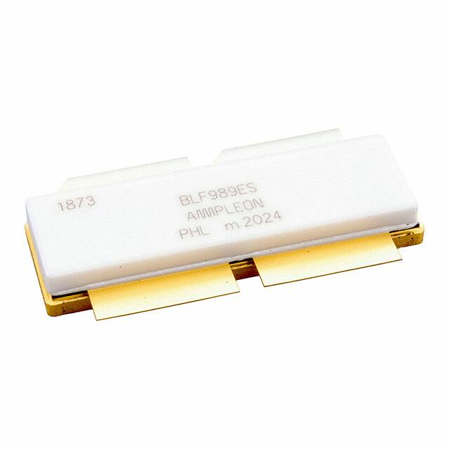

BLF989E; BLF989ES UHF power LDMOS transistor Rev. 2 — 15 April 2021 Product data sheet 1. Product profile 1.1 General description A 1000 W LDMOS RF power transistor for asymmetrical broadcast Doherty transmitter applications which operates at 180 W DVB-T average power. The excellent ruggedness of this device makes it ideal for digital and analog transmitter applications in the frequency range from 400 MHz to 860 MHz. Table 1. Application information RF performance at VDS = 50 V in an asymmetrical Doherty application. Test signal DVB-T (8k OFDM) [1] [1] f PL(AV) Gp D IMDshldr (MHz) (W) (dB) (%) (dBc) (dB) 470 to 620 180 17 50 38 8 470 to 700 180 15 48 37.5 7.5 PAR (of output signal) at 0.01 % probability on CCDF; PAR of input signal = 9.5 dB at 0.01 % probability on CCDF. 1.2 Features and benefits         PAR Designed for asymmetric Doherty operation Very high efficiency enabling air cooled high power transmitters Integrated ESD protection Excellent ruggedness High power gain Excellent reliability Easy power control For RoHS compliance see the product details on the Ampleon website 1.3 Applications  Broadcast transmitter applications in the UHF band  Digital broadcasting  Applicable at frequencies from 400 MHz to 860 MHz BLF989E; BLF989ES UHF power LDMOS transistor 2. Pinning information Table 2. Pinning Pin Description Simplified outline Graphic symbol BLF989E (SOT539AN) 1 drain1 (peak) 2 drain2 (main) 3 gate1 (peak) 4 gate2 (main) 5 1 1 2 5 3 3 4 5 4 [1] source 2 sym117 BLF989ES (SOT539BN) 1 drain1 (peak) 2 drain2 (main) 3 gate1 (peak) 4 gate2 (main) 5 1 1 2 5 3 3 4 5 4 [1] source 2 sym117 [1] Connected to flange. 3. Ordering information Table 3. Ordering information Package name Orderable part number 12NC Packing description Min. orderable quantity (pieces) SOT539AN BLF989EU 9349 602 21112 Tray, 20-fold; non-dry pack 60 SOT539BN BLF989ESU 9349 602 22112 Tray, 20-fold; non-dry pack 60 4. Limiting values Table 4. Limiting values In accordance with the Absolute Maximum Rating System (IEC 60134). Symbol Parameter VDS(amp)main Min Max Unit main amplifier drain-source voltage - 108 V VDS(amp)peak peak amplifier drain-source voltage - 108 V VGS(amp)main main amplifier gate-source voltage 6 +11 V VGS(amp)peak peak amplifier gate-source voltage 6 +11 V Tstg storage temperature 65 +150 C - 225 C Tj [1] BLF989E_BLF989ES Product data sheet junction temperature Conditions [1] Continuous use at maximum temperature will affect the reliability, for details refer to the online MTF calculator. All information provided in this document is subject to legal disclaimers. Rev. 2 — 15 April 2021 © Ampleon Netherlands B.V. 2021. All rights reserved. 2 of 12 BLF989E; BLF989ES UHF power LDMOS transistor 5. Thermal characteristics Table 5. Thermal characteristics Symbol Parameter Rth(j-c) Conditions thermal resistance from junction Tcase = 90 C; VDS = 50 V; to case IDS = 3.5 A (main); IDS = 0 A (peak) Tcase = 90 C; VDS = 50 V; PL = 180 W; PAR = 8 dB Typ Unit [1] 0.28 K/W [2] 0.19 K/W [1] Measured under DC test conditions, with peak section off. [2] Measured in an ultra-wide Doherty application, using DVB-T (8k OFDM) signal, PAR (of output signal) at 0.01 % probability on CCDF; PAR of input signal = 9.5 dB at 0.01 % probability on CCDF. 6. Characteristics Table 6. DC characteristics Tj = 25 C; per section unless otherwise specified. Symbol Parameter Conditions Min Typ Max Unit 108 - - V Main device V(BR)DSS drain-source breakdown voltage VGS = 0 V; ID = 2.4 mA VGS(th) gate-source threshold voltage VDS = 10 V; ID = 240 mA 1.5 2.1 2.5 V IDSS drain leakage current VGS = 0 V; VDS = 50 V - - 2.8 A IDSX drain cut-off current VGS = VGS(th) + 3.75 V; VDS = 10 V - 43 - A IGSS gate leakage current VGS = 10 V; VDS = 0 V - - 280 nA RDS(on) drain-source on-state resistance VGS = VGS(th) + 3.75 V; ID = 8.5 A - 90 - m Peak device 108 - - V VGS(th) V(BR)DSS drain-source breakdown voltage VGS = 0 V; ID = 3.6 mA gate-source threshold voltage VDS = 10 V; ID = 360 mA 1.5 2.0 2.5 V IDSS drain leakage current VGS = 0 V; VDS = 50 V - - 2.8 A IDSX drain cut-off current VGS = VGS(th) + 3.75 V; VDS = 10 V - 67 - A IGSS gate leakage current VGS = 10 V; VDS = 0 V - - 280 nA RDS(on) drain-source on-state resistance VGS = VGS(th) + 3.75 V; ID = 12.6 A - 60 - m Table 7. AC characteristics Tj = 25 C; per section unless otherwise specified. Symbol Parameter Conditions Min Typ Max Unit Main device BLF989E_BLF989ES Product data sheet Ciss input capacitance VGS = 0 V; VDS = 50 V; f = 1 MHz - 368 - pF Coss output capacitance VGS = 0 V; VDS = 50 V; f = 1 MHz - 69 - pF Crss reverse transfer capacitance VGS = 0 V; VDS = 50 V; f = 1 MHz - 0.86 - pF All information provided in this document is subject to legal disclaimers. Rev. 2 — 15 April 2021 © Ampleon Netherlands B.V. 2021. All rights reserved. 3 of 12 BLF989E; BLF989ES UHF power LDMOS transistor Table 7. AC characteristics …continued Tj = 25 C; per section unless otherwise specified. Symbol Parameter Conditions Min Typ Max Unit Peak device Ciss input capacitance VGS = 0 V; VDS = 50 V; f = 1 MHz - 484 - pF Coss output capacitance VGS = 0 V; VDS = 50 V; f = 1 MHz - 107 - pF Crss reverse transfer capacitance VGS = 0 V; VDS = 50 V; f = 1 MHz - 1.16 - pF Table 8. RF characteristics RF characteristics in Ampleon production test circuit, Tcase = 25 C; unless otherwise specified. Symbol Parameter Conditions Min Typ Max Unit - 50 - V DVB-T (8k OFDM), Doherty operation VDS drain-source voltage IDq quiescent drain current peak section: VGS = 1.3 V below VGS(th) (peak) - 600 - mA PL(AV) average output power f = 550 MHz - 180 - W Gp power gain f = 550 MHz 18.6 20 - dB D drain efficiency f = 550 MHz 50 52 - % PAR peak-to-average ratio f = 550 MHz 6.9 7.4 - dB 7. Test information 7.1 Ruggedness in Doherty operation The BLF989E and BLF989ES are capable of withstanding a load mismatch corresponding to VSWR 10 : 1 through all phases under the following conditions: VDS = 50 V; f = 550 MHz at rated load power. BLF989E_BLF989ES Product data sheet All information provided in this document is subject to legal disclaimers. Rev. 2 — 15 April 2021 © Ampleon Netherlands B.V. 2021. All rights reserved. 4 of 12 BLF989E; BLF989ES UHF power LDMOS transistor 7.2 Test circuit + 95 mm - 95 mm C12 C37 C36 R2 C9 C2 L22 C10 L2 R21 C31 C29 C27 R28 R27 80 mm C33 C26 C32 C25 R26 R25 C5 C24 R24 C13 C30 C28 R20 C35 C34 C3 C1 L21 L1 C8 C7 R1 - amp01280 + C11 Printed-Circuit Board (PCB): Rogers RO3006; r = 6.5 F/M; height = 0.635 mm; Cu (top/bottom metallization); thickness copper plating = 29.6 m; Rogers RO3010; r = 10 F/M; height = 0.254 mm. See Table 9 for a list of components. Fig 1. Component layout for production RF test circuit Table 9. List of components See Figure 1 for component layout. Component Description C1, C2, C7, C9, C13 Product data sheet Remarks 100 pF [1] ATC 800B ATC 800B ATC 800B C3 multilayer ceramic chip capacitor 10 pF [1] C5 multilayer ceramic chip capacitor 8.2 pF [1] C8, C10 multilayer ceramic chip capacitor 4.7 F, 100 V C11, C12 electrolytic capacitor 470 F, 63 V L1, L2 one turn inductor D = 5 mm, d = 1mm R1 chip resistor 1 R2 chip resistor 5.6  C24, C25, C26, C27 BLF989E_BLF989ES multilayer ceramic chip capacitor Value multilayer ceramic chip capacitor TDK SMD 1206 SMD 1206 20 pF [1] ATC 800B ATC 800B C28, C29 multilayer ceramic chip capacitor 10 pF [1] C30, C31 multilayer ceramic chip capacitor 5.1 pF [1] ATC 800B [1] ATC 800B C32, C33, C34, C36 multilayer ceramic chip capacitor 100 pF C35, C37 multilayer ceramic chip capacitor 4.7 F, 63 V L21, L22 one turn inductor D = 5 mm, d = 1mm R20, R21 chip resistor 5.6  SMD 0805 R25, R26 chip resistor 300  SMD 1206 All information provided in this document is subject to legal disclaimers. Rev. 2 — 15 April 2021 TDK © Ampleon Netherlands B.V. 2021. All rights reserved. 5 of 12 BLF989E; BLF989ES UHF power LDMOS transistor Table 9. List of components …continued See Figure 1 for component layout. Component Description Value Remarks R24 chip resistor 18  SMD 1206 R27 chip resistor 2x510  SMD 1206 R28 chip resistor 2x180  SMD 1206 [1] American Technical Ceramics type 800B or capacitor of same quality. 7.3 Graphs 7.3.1 DVB-T in production test circuit amp01393 21 Gp (dB) 60 20 amp01394 12 ηD (%) ηD PAR (dB) 50 Gp 10 19 40 18 30 17 20 16 10 8 6 15 0 40 80 120 160 200 PL(AV) (W) 0 240 4 0 VDS = 50 V; IDq = 600 mA; measured in a Doherty production test circuit at 550 MHz. Fig 2. Power gain and drain efficiency as function of average output power; typical values BLF989E_BLF989ES Product data sheet 40 80 120 160 200 PL(AV) (W) 240 VDS = 50 V; IDq = 600 mA; measured in a Doherty production test circuit at 550 MHz. Fig 3. Peak-to-average power ratio as a function of average output power; typical values All information provided in this document is subject to legal disclaimers. Rev. 2 — 15 April 2021 © Ampleon Netherlands B.V. 2021. All rights reserved. 6 of 12 BLF989E; BLF989ES UHF power LDMOS transistor 8. Package outline Flanged balanced ceramic package; 2 mounting holes; 4 leads SOT539AN (note 3) D X A detail X F D1 U1 B q C w2 M C M H1 1 c 2 E1 p H U2 5 L 3 A E w1 M A M B M 4 w3 M b Q e w3 0.25 0 5 10 mm 0.01 scale Dimensions Unit(1) q(2) w1 w2 0.25 0.51 1.625 0.405 max 0.185 0.465 0.007 1.242 1.241 0.374 0.375 0.069 0.674 1.005 0.137 0.130 0.089 1.400 0.54 inches nom 0.01 1.615 0.395 min 0.165 0.455 0.004 1.218 1.219 0.366 0.365 0.059 0.634 0.995 0.117 0.120 0.079 0.02 mm max nom min A b 4.7 11.81 c D D1 0.18 31.55 31.52 E E1 e 9.5 9.53 F H H1 L 1.75 17.12 25.53 3.48 p Q 3.30 2.26 11.56 0.10 30.94 30.96 9.3 9.27 41.28 10.29 1.50 16.10 25.27 2.97 3.05 2.01 41.02 10.03 Note 1. millimeter dimensions are derived from the original inch dimensions. 2. recommended screw pitch dimension of 1.52 inch (38.6 mm) based on M3 screw. 3. ceramic window frame has a minimum thickness of 0.400 mm. Outline version References IEC JEDEC JEITA sot539an_po European projection Issue date 20-04-20 SOT539AN Fig 4. U2 35.56 13.72 4.2 U1 Package outline SOT539AN BLF989E_BLF989ES Product data sheet All information provided in this document is subject to legal disclaimers. Rev. 2 — 15 April 2021 © Ampleon Netherlands B.V. 2021. All rights reserved. 7 of 12 BLF989E; BLF989ES UHF power LDMOS transistor Earless flanged balanced ceramic package; 4 leads SOT539BN (note 2) D X A F 5 D1 detail X D U1 H1 w2 1 c D 2 E1 U2 H E L 3 4 w3 b Q e 0 5 10 mm scale Dimensions Unit(1) A b 4.7 11.81 w2 w3 0.25 0.25 max 0.185 0.465 0.007 1.242 1.241 0.374 0.375 0.069 0.674 1.005 0.137 0.089 1.275 0.405 0.54 inches nom 0.01 min 0.165 0.455 0.004 1.218 1.219 0.366 0.365 0.059 0.634 0.995 0.117 0.079 1.265 0.395 0.01 mm max nom min c D D1 0.18 31.55 31.52 E E1 e 9.5 9.53 F H H1 L Q U1 U2 1.75 17.12 25.53 3.48 2.26 32.39 10.29 1.50 16.10 25.27 2.97 2.01 32.13 10.03 13.72 4.2 11.56 0.10 30.94 30.96 9.3 9.27 Note 1. millimeter dimensions are derived from the original inch dimensions. 2. ceramic window frame has a minimum thickness of 0.400 mm. Outline version References IEC JEDEC JEITA European projection Issue date 20-04-20 SOT539BN Fig 5. sot539bn_po Package outline SOT539BN BLF989E_BLF989ES Product data sheet All information provided in this document is subject to legal disclaimers. Rev. 2 — 15 April 2021 © Ampleon Netherlands B.V. 2021. All rights reserved. 8 of 12 BLF989E; BLF989ES UHF power LDMOS transistor 9. Handling information CAUTION This device is sensitive to ElectroStatic Discharge (ESD). Observe precautions for handling electrostatic sensitive devices. Such precautions are described in the ANSI/ESD S20.20, IEC/ST 61340-5, JESD625-A or equivalent standards. Table 10. ESD sensitivity ESD model Class Charged Device Model (CDM); According to ANSI/ESDA/JEDEC standard JS-002 C2A [1] Human Body Model (HBM); According to ANSI/ESDA/JEDEC standard JS-001 2 [2] [1] CDM classification C2A is granted to any part that passes after exposure to an ESD pulse of 500 V. [2] HBM classification 2 is granted to any part that passes after exposure to an ESD pulse of 2000 V. 10. Abbreviations Table 11. Abbreviations Acronym Description CCDF Complementary Cumulative Distribution Function DVB-T Digital Video Broadcast - Terrestrial ESD ElectroStatic Discharge LDMOS Laterally Diffused Metal-Oxide Semiconductor MTF Median Time to Failure OFDM Orthogonal Frequency Division Multiplexing PAR Peak-to-Average Ratio RoHS Restriction of Hazardous Substances SMD Surface Mounted Device UHF Ultra High Frequency VSWR Voltage Standing Wave Ratio 11. Revision history Table 12. Revision history Document ID Release date Data sheet status Change notice Supersedes BLF989E_BLF989ES v.2 20210415 Product data sheet - BLF989E_BLF989ES v.1 Modifications: BLF989E_BLF989ES v.1 BLF989E_BLF989ES Product data sheet • • • • • • Section 1.1 on page 1: added text in first paragraph Section 1.3 on page 1: added extra bullet Table 2 on page 2: changed package names Section 3 on page 2: updated section Figure 4 on page 7: changed SOT539A to SOT539AN due to tighter dimension Figure 5 on page 8: changed SOT539B to SOT539BN due to tighter dimension 20200403 Product data sheet - All information provided in this document is subject to legal disclaimers. Rev. 2 — 15 April 2021 - © Ampleon Netherlands B.V. 2021. All rights reserved. 9 of 12 BLF989E; BLF989ES UHF power LDMOS transistor 12. Legal information 12.1 Data sheet status Document status[1][2] Product status[3] Definition Objective [short] data sheet Development This document contains data from the objective specification for product development. Preliminary [short] data sheet Qualification This document contains data from the preliminary specification. Product [short] data sheet Production This document contains the product specification. [1] Please consult the most recently issued document before initiating or completing a design. [2] The term ‘short data sheet’ is explained in section “Definitions”. [3] The product status of device(s) described in this document may have changed since this document was published and may differ in case of multiple devices. The latest product status information is available on the Internet at URL http://www.ampleon.com. 12.2 Definitions Draft — The document is a draft version only. The content is still under internal review and subject to formal approval, which may result in modifications or additions. Ampleon does not give any representations or warranties as to the accuracy or completeness of information included herein and shall have no liability for the consequences of use of such information. Short data sheet — A short data sheet is an extract from a full data sheet with the same product type number(s) and title. A short data sheet is intended for quick reference only and should not be relied upon to contain detailed and full information. For detailed and full information see the relevant full data sheet, which is available on request via the local Ampleon sales office. In case of any inconsistency or conflict with the short data sheet, the full data sheet shall prevail. Product specification — The information and data provided in a Product data sheet shall define the specification of the product as agreed between Ampleon and its customer, unless Ampleon and customer have explicitly agreed otherwise in writing. In no event however, shall an agreement be valid in which the Ampleon product is deemed to offer functions and qualities beyond those described in the Product data sheet. 12.3 Disclaimers Maturity — The information in this document can only be regarded as final once the relevant product(s) has passed the Release Gate in Ampleon's release process. Prior to such release this document should be regarded as a draft version. Limited warranty and liability — Information in this document is believed to be accurate and reliable. However, Ampleon does not give any representations or warranties, expressed or implied, as to the accuracy or completeness of such information and shall have no liability for the consequences of use of such information. Ampleon takes no responsibility for the content in this document if provided by an information source outside of Ampleon. In no event shall Ampleon be liable for any indirect, incidental, punitive, special or consequential damages (including - without limitation - lost profits, lost savings, business interruption, costs related to the removal or replacement of any products or rework charges) whether or not such damages are based on tort (including negligence), warranty, breach of contract or any other legal theory. Notwithstanding any damages that customer might incur for any reason whatsoever, Ampleon’s aggregate and cumulative liability towards customer for the products described herein shall be limited in accordance with the Terms and conditions of commercial sale of Ampleon. BLF989E_BLF989ES Product data sheet Right to make changes — Ampleon reserves the right to make changes to information published in this document, including without limitation specifications and product descriptions, at any time and without notice. This document supersedes and replaces all information supplied prior to the publication hereof. Suitability for use — Ampleon products are not designed, authorized or warranted to be suitable for use in life support, life-critical or safety-critical systems or equipment, nor in applications where failure or malfunction of an Ampleon product can reasonably be expected to result in personal injury, death or severe property or environmental damage. Ampleon and its suppliers accept no liability for inclusion and/or use of Ampleon products in such equipment or applications and therefore such inclusion and/or use is at the customer’s own risk. Applications — Applications that are described herein for any of these products are for illustrative purposes only. Ampleon makes no representation or warranty that such applications will be suitable for the specified use without further testing or modification. Customers are responsible for the design and operation of their applications and products using Ampleon products, and Ampleon accepts no liability for any assistance with applications or customer product design. It is customer’s sole responsibility to determine whether the Ampleon product is suitable and fit for the customer’s applications and products planned, as well as for the planned application and use of customer’s third party customer(s). Customers should provide appropriate design and operating safeguards to minimize the risks associated with their applications and products. Ampleon does not accept any liability related to any default, damage, costs or problem which is based on any weakness or default in the customer’s applications or products, or the application or use by customer’s third party customer(s). Customer is responsible for doing all necessary testing for the customer’s applications and products using Ampleon products in order to avoid a default of the applications and the products or of the application or use by customer’s third party customer(s). Ampleon does not accept any liability in this respect. Limiting values — Stress above one or more limiting values (as defined in the Absolute Maximum Ratings System of IEC 60134) will cause permanent damage to the device. Limiting values are stress ratings only and (proper) operation of the device at these or any other conditions above those given in the Recommended operating conditions section (if present) or the Characteristics sections of this document is not warranted. Constant or repeated exposure to limiting values will permanently and irreversibly affect the quality and reliability of the device. Terms and conditions of commercial sale — Ampleon products are sold subject to the general terms and conditions of commercial sale, as published at http://www.ampleon.com/terms, unless otherwise agreed in a valid written individual agreement. In case an individual agreement is concluded only the terms and conditions of the respective agreement shall apply. Ampleon hereby expressly objects to applying the customer’s general terms and conditions with regard to the purchase of Ampleon products by customer. All information provided in this document is subject to legal disclaimers. Rev. 2 — 15 April 2021 © Ampleon Netherlands B.V. 2021. All rights reserved. 10 of 12 BLF989E; BLF989ES UHF power LDMOS transistor No offer to sell or license — Nothing in this document may be interpreted or construed as an offer to sell products that is open for acceptance or the grant, conveyance or implication of any license under any copyrights, patents or other industrial or intellectual property rights. Export control — This document as well as the item(s) described herein may be subject to export control regulations. Export might require a prior authorization from competent authorities. Non-automotive qualified products — Unless this data sheet expressly states that this specific Ampleon product is automotive qualified, the product is not suitable for automotive use. It is neither qualified nor tested in accordance with automotive testing or application requirements. Ampleon accepts no liability for inclusion and/or use of non-automotive qualified products in automotive equipment or applications. In the event that customer uses the product for design-in and use in automotive applications to automotive specifications and standards, customer (a) shall use the product without Ampleon’s warranty of the product for such automotive applications, use and specifications, and (b) whenever customer uses the product for automotive applications beyond Ampleon’s specifications such use shall be solely at customer’s own risk, and (c) customer fully indemnifies Ampleon for any liability, damages or failed product claims resulting from customer design and use of the product for automotive applications beyond Ampleon’s standard warranty and Ampleon’s product specifications. Translations — A non-English (translated) version of a document is for reference only. The English version shall prevail in case of any discrepancy between the translated and English versions. 12.4 Licenses ICs with DVB-T or DVB-T2 functionality Use of this product in any manner that complies with the DVB-T or the DVB-T2 standard may require licenses under applicable patents of the DVB-T respectively the DVB-T2 patent portfolio, which license is available from Sisvel S.p.A., Via Sestriere 100, 10060 None (TO), Italy, and under applicable patents of other parties. 12.5 Trademarks Notice: All referenced brands, product names, service names and trademarks are the property of their respective owners. 13. Contact information For more information, please visit: http://www.ampleon.com For sales office addresses, please visit: http://www.ampleon.com/sales BLF989E_BLF989ES Product data sheet All information provided in this document is subject to legal disclaimers. Rev. 2 — 15 April 2021 © Ampleon Netherlands B.V. 2021. All rights reserved. 11 of 12 BLF989E; BLF989ES UHF power LDMOS transistor 14. Contents 1 1.1 1.2 1.3 2 3 4 5 6 7 7.1 7.2 7.3 7.3.1 8 9 10 11 12 12.1 12.2 12.3 12.4 12.5 13 14 Product profile . . . . . . . . . . . . . . . . . . . . . . . . . . 1 General description . . . . . . . . . . . . . . . . . . . . . 1 Features and benefits . . . . . . . . . . . . . . . . . . . . 1 Applications . . . . . . . . . . . . . . . . . . . . . . . . . . . 1 Pinning information . . . . . . . . . . . . . . . . . . . . . . 2 Ordering information . . . . . . . . . . . . . . . . . . . . . 2 Limiting values. . . . . . . . . . . . . . . . . . . . . . . . . . 2 Thermal characteristics . . . . . . . . . . . . . . . . . . 3 Characteristics . . . . . . . . . . . . . . . . . . . . . . . . . . 3 Test information . . . . . . . . . . . . . . . . . . . . . . . . . 4 Ruggedness in Doherty operation . . . . . . . . . . 4 Test circuit. . . . . . . . . . . . . . . . . . . . . . . . . . . . . 5 Graphs . . . . . . . . . . . . . . . . . . . . . . . . . . . . . . . 6 DVB-T in production test circuit . . . . . . . . . . . . 6 Package outline . . . . . . . . . . . . . . . . . . . . . . . . . 7 Handling information. . . . . . . . . . . . . . . . . . . . . 9 Abbreviations . . . . . . . . . . . . . . . . . . . . . . . . . . . 9 Revision history . . . . . . . . . . . . . . . . . . . . . . . . . 9 Legal information. . . . . . . . . . . . . . . . . . . . . . . 10 Data sheet status . . . . . . . . . . . . . . . . . . . . . . 10 Definitions . . . . . . . . . . . . . . . . . . . . . . . . . . . . 10 Disclaimers . . . . . . . . . . . . . . . . . . . . . . . . . . . 10 Licenses . . . . . . . . . . . . . . . . . . . . . . . . . . . . . 11 Trademarks. . . . . . . . . . . . . . . . . . . . . . . . . . . 11 Contact information. . . . . . . . . . . . . . . . . . . . . 11 Contents . . . . . . . . . . . . . . . . . . . . . . . . . . . . . . 12 Please be aware that important notices concerning this document and the product(s) described herein, have been included in section ‘Legal information’. © Ampleon Netherlands B.V. 2021. All rights reserved. For more information, please visit: http://www.ampleon.com For sales office addresses, please visit: http://www.ampleon.com/sales Date of release: 15 April 2021 Document identifier: BLF989E_BLF989ES
