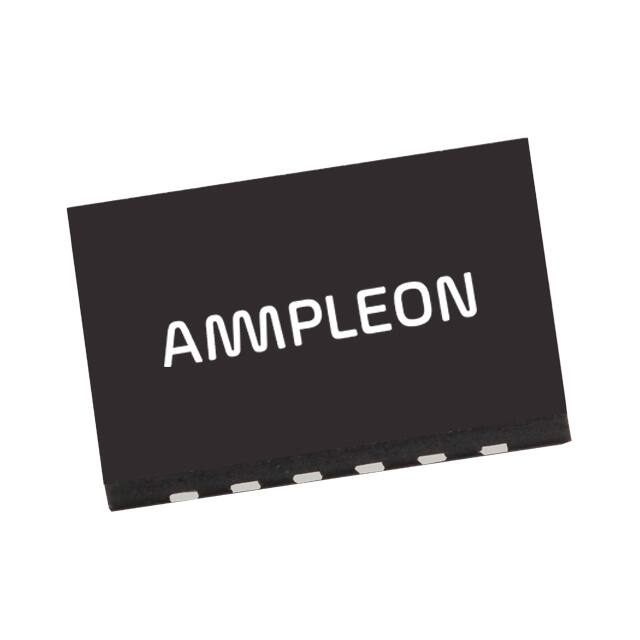

BLP10H605AZ
BLP10H605AZ
    AMPHENOL(安费诺)
    VDFN12
    RF FET LDMOS 104V 22DB 12VDFN
BLP10H605AZ 数据手册
BLP10H605 Broadband LDMOS driver transistor Rev. 4 — 1 September 2015 Product data sheet 1. Product profile 1.1 General description A 5 W plastic LDMOS power transistor for broadcast transmitter and ISM applications at frequencies from HF to 1400 MHz. Table 1. Application performance Test signal CW D f VDS PL Gp (MHz) (V) (W) (dB) (%) 860 50 5 22.4 59.6 1.2 Features and benefits        Easy power control Integrated dual side ESD protection Excellent ruggedness High efficiency Excellent thermal stability Designed for broadband operation (HF to 1400 MHz) Compliant to Directive 2002/95/EC, regarding Restriction of Hazardous Substances (RoHS) 1.3 Applications  Industrial, scientific and medical applications  Broadcast transmitter applications BLP10H605 Broadband LDMOS driver transistor 2. Pinning information Table 2. Pinning Pin Description 1, 3, 4, 6, 7, 9, 10, 12 n.c. 2 gate1 5 gate2 8 drain2 11 drain1 13 source Simplified outline [1] Graphic symbol 1 2 3 12 11 10 4 5 6 9 8 7 11 2 13 5 8 Transparent top view [1] aaa-010780 Connected to flange. 3. Ordering information Table 3. Ordering information Type number Package Name BLP10H605 Description Version HVSON12 plastic thermal enhanced very thin small outline package; no leads; 12 terminals; body 5  6  0.85 mm SOT1352-1 4. Limiting values Table 4. Limiting values In accordance with the Absolute Maximum Rating System (IEC 60134). BLP10H605#4 Product data sheet Symbol Parameter VDS Conditions Min Max Unit drain-source voltage - 104 V VGS gate-source voltage 6 +11 V Tstg storage temperature 65 +150 C Tj junction temperature - 150 C All information provided in this document is subject to legal disclaimers. Rev. 4 — 1 September 2015 © Ampleon The Netherlands B.V. 2015. All rights reserved. 2 of 11 BLP10H605 Broadband LDMOS driver transistor 5. Recommended operating conditions See application note AN11520 for more details. aaa-012031 150 Tcase (°C) 130 110 90 70 50 1 Fig 1. 1.5 2 2.5 3 3.5 4 4.5 P (W) 5 Recommended operating area; case temperature as a function of power dissipation 6. Thermal characteristics Table 5. Thermal characteristics Symbol Parameter Conditions thermal resistance from junction to case Tcase = 80 C; PL = 5 W Rth(j-c) [1] [1] Typ Unit 5.5 K/W Rth(j-c) is measured under RF conditions 7. Characteristics Table 6. DC characteristics Tj = 25 C; unless otherwise specified. BLP10H605#4 Product data sheet Symbol Parameter Conditions Min Typ Max Unit V(BR)DSS drain-source breakdown voltage VGS = 0 V; ID = 0.06 mA 104 - - V VGS(th) gate-source threshold voltage VDS = 10 V; ID = 6 mA 1.25 1.7 2.25 V VGSq gate-source quiescent voltage VDS = 50 V; ID = 30 mA 1.35 1.78 2.25 V IDSS drain leakage current VGS = 0 V; VDS = 50 V - - 1.4 A IDSX drain cut-off current VGS = VGS(th) + 3.75 V; VDS = 10 V - 0.95 - A IGSS gate leakage current VGS = 11 V; VDS = 0 V - - 140 nA RDS(on) drain-source on-state resistance VGS = VGS(th) + 3.75 V; ID = 210 mA - 4580 - m All information provided in this document is subject to legal disclaimers. Rev. 4 — 1 September 2015 © Ampleon The Netherlands B.V. 2015. All rights reserved. 3 of 11 BLP10H605 Broadband LDMOS driver transistor Table 7. AC characteristics Tj = 25 C; unless otherwise specified. Conditions Min Typ Max Unit Crs Symbol Parameter feedback capacitance VGS = 0 V; VDS = 50 V; f = 1 MHz - 0.07 - pF Ciss input capacitance VGS = 0 V; VDS = 0 V; f = 1 MHz - 6.8 - pF Coss output capacitance VGS = 0 V; VDS = 50 V; f = 1 MHz - 2.24 - pF Table 8. RF characteristics Test signal: CW pulsed; tp = 50 s;  = 10 %; f = 860 MHz; RF performance at VDS = 50 V; IDq = 30 mA; Tcase = 25 C; unless otherwise specified, in a class-AB production test circuit [1]. Symbol Parameter Conditions Gp power gain PL = 5 W 20.2 22.4 27.4 dB D drain efficiency PL = 5 W 57 59.6 - % [1] Min Typ Max Unit The industrial test method is performed on special hardware to accommodate the requirements of production. The test results in this table are correlated to correspond with a performance in the application. 8. Test information 8.1 Ruggedness in class-AB operation The BLP10H605 is capable of withstanding a load mismatch corresponding to VSWR = 35 : 1 through all phases under the following conditions: VDS = 50 V; IDq = 30 mA; PL = 5 W; f = 860 MHz. 8.2 Test circuit 66.5 mm C8 R2 R1 - C5 C7 C1 C9 Q1 C2 33 mm + L1 C4 C3 C6 aaa-012032 Printed-Circuit Board (PCB): Rogers RO4350; r = 3.48; height = 0.762 mm; thickness copper plating = 35 m. See Table 9 for a list of components. Fig 2. BLP10H605#4 Product data sheet Component layout All information provided in this document is subject to legal disclaimers. Rev. 4 — 1 September 2015 © Ampleon The Netherlands B.V. 2015. All rights reserved. 4 of 11 BLP10H605 Broadband LDMOS driver transistor Table 9. List of components See Figure 2 for component layout. Component Description Value C1, C4, C7 multilayer ceramic chip capacitor 100 pF [1] C2 multilayer ceramic chip capacitor 8.2 pF [1] C3 multilayer ceramic chip capacitor 5.1 pF [1] C5 multilayer ceramic chip capacitor 1 F, 25 V C6 multilayer ceramic chip capacitor 2.2 pF C8 multilayer ceramic chip capacitor 1 F, 50 V C9 electrolytic capacitor 220 F, 63 V L1 wire inductor, 0.8 mm copper wire 2 turn, D = 3 mm R1 resistor 0 R2 resistor 10  SMD 0805 Q1 transistor - BLP10H605 [1] Remarks Murata GRM31MR71E105KA01L [1] Murata GRM32RR71H105KA01L SMD 0805 American Technical Ceramics type 100A or capacitor of same quality. 8.3 Graphical data aaa-012033 25 Gp (dB) ηD (%) PL (dBm) 43 Gp 23 aaa-012034 47 80 Ideal PL 60 (2) 39 21 PL 40 (1) 35 19 20 31 ηD 17 27 0 0 1 2 3 4 5 6 7 PL (W) 0 8 VDS = 50 V; IDq = 30 mA; f = 860 MHz. 5 10 15 20 25 Pi (dBm) VDS = 50 V; IDq = 30 mA; f = 860 MHz. (1) PL(1dB) = 37.55 dBm (5.7 W) (2) PL(3dB) = 38.24 dBm (6.7 W) Fig 3. Power gain and drain efficiency as function of output power; typical values BLP10H605#4 Product data sheet Fig 4. Output power as a function of input power; typical values All information provided in this document is subject to legal disclaimers. Rev. 4 — 1 September 2015 © Ampleon The Netherlands B.V. 2015. All rights reserved. 5 of 11 BLP10H605 Broadband LDMOS driver transistor aaa-012035 25 Gp (dB) aaa-012036 80 ηD (%) 23 60 21 (4) (3) (2) (1) (4) (3) (2) (1) 40 19 20 17 15 0 0 1 2 3 4 5 6 7 PL (W) 8 0 1 2 4 5 6 7 PL (W) 8 VDS = 50 V; f = 860 MHz. VDS = 50 V; f = 860 MHz. (1) IDq = 10 mA (1) IDq = 10 mA (2) IDq = 20 mA (2) IDq = 20 mA (3) IDq = 30 mA (3) IDq = 30 mA (4) IDq = 40 mA (4) IDq = 40 mA Fig 5. 3 Power gain as a function of output power; typical values Fig 6. aaa-012037 25 Gp (dB) Drain efficiency as a function of output power; typical values aaa-012038 80 ηD (%) 23 (3) (4) 4 5 (5) (2) 60 (1) 21 40 19 (4) (3) (2) (5) (1) 20 17 15 0 0 1 2 3 4 5 6 7 PL (W) 8 0 1 (1) VDS = 30 V (2) VDS = 35 V (2) VDS = 35 V (3) VDS = 40 V (3) VDS = 40 V (4) VDS = 45 V (4) VDS = 45 V (5) VDS = 50 V (5) VDS = 50 V Power gain as a function of output power; typical values BLP10H605#4 Product data sheet 3 6 7 PL (W) 8 IDq = 30 mA; f = 860 MHz. IDq = 30 mA; f = 860 MHz. (1) VDS = 30 V Fig 7. 2 Fig 8. Drain efficiency as a function of output power; typical values All information provided in this document is subject to legal disclaimers. Rev. 4 — 1 September 2015 © Ampleon The Netherlands B.V. 2015. All rights reserved. 6 of 11 BLP10H605 Broadband LDMOS driver transistor 9. Package outline HVSON12: plastic thermal enhanced very thin small outline package; no leads; 12 terminals; body 5 x 6 x 0.85 mm SOT1352-1 X B D A E A A1 c detail X terminal 1 index area e1 e2 terminal 1 index area e v w b 1 6 C C A B C y1 C y L K Eh 12 7 Dh 0 2.5 Dimensions (mm are the original dimensions) Unit A A1 b max 1.00 0.05 0.35 nom 0.85 0.03 0.30 min 0.80 0.00 0.25 mm 5 mm scale c D(1) Dh E(1) Eh e e1 e2 0.2 6.1 6.0 5.9 5.2 5.1 5.0 5.1 5.0 4.9 2.3 2.2 2.1 0.8 4.5 1.3 K L v 0.1 1.0 0.5 0.4 0.3 w y 0.05 0.05 y1 0.1 Note 1. Plastic or metal protrusions of 0.075 mm maximum per side are not included. References Outline version IEC JEDEC JEITA SOT1352-1 --- MO-229 --- Fig 9. sot1352-1_po European projection Issue date 13-03-26 13-07-16 Package outline SOT1352-1 (HVSON12) BLP10H605#4 Product data sheet All information provided in this document is subject to legal disclaimers. Rev. 4 — 1 September 2015 © Ampleon The Netherlands B.V. 2015. All rights reserved. 7 of 11 BLP10H605 Broadband LDMOS driver transistor 10. Handling information CAUTION This device is sensitive to ElectroStatic Discharge (ESD). Observe precautions for handling electrostatic sensitive devices. Such precautions are described in the ANSI/ESD S20.20, IEC/ST 61340-5, JESD625-A or equivalent standards. 11. Abbreviations Table 10. Abbreviations Acronym Description CW Continuous Wave ESD ElectroStatic Discharge LDMOS Laterally Diffused Metal-Oxide Semiconductor HF High Frequency ISM Industrial, Scientific and Medical SMD Surface Mounted Device VSWR Voltage Standing-Wave Ratio 12. Revision history Table 11. Revision history Document ID Release date Data sheet status BLP10H605 v.4 20150901 Product data sheet Modifications: Change notice Supersedes BLP10H605 v.3 • The format of this document has been redesigned to comply with the new identity guidelines of Ampleon. • Legal texts have been adapted to the new company name where appropriate. BLP10H605 v.3 20141002 Product data sheet - BLP10H605 v.2 BLP10H605 v.2 20140418 Objective data sheet - BLP10H605 v.1 BLP10H605 v.1 20140221 Objective data sheet - - BLP10H605#4 Product data sheet All information provided in this document is subject to legal disclaimers. Rev. 4 — 1 September 2015 © Ampleon The Netherlands B.V. 2015. All rights reserved. 8 of 11 BLP10H605 Broadband LDMOS driver transistor 13. Legal information 13.1 Data sheet status Document status[1][2] Product status[3] Objective [short] data sheet Development This document contains data from the objective specification for product development. Preliminary [short] data sheet Qualification This document contains data from the preliminary specification. Product [short] data sheet Production This document contains the product specification. Definition [1] Please consult the most recently issued document before initiating or completing a design. [2] The term ‘short data sheet’ is explained in section “Definitions”. [3] The product status of device(s) described in this document may have changed since this document was published and may differ in case of multiple devices. The latest product status information is available on the Internet at URL http://www.ampleon.com. 13.2 Definitions Draft — The document is a draft version only. The content is still under internal review and subject to formal approval, which may result in modifications or additions. Ampleon does not give any representations or warranties as to the accuracy or completeness of information included herein and shall have no liability for the consequences of use of such information. Short data sheet — A short data sheet is an extract from a full data sheet with the same product type number(s) and title. A short data sheet is intended for quick reference only and should not be relied upon to contain detailed and full information. For detailed and full information see the relevant full data sheet, which is available on request via the local Ampleon sales office. In case of any inconsistency or conflict with the short data sheet, the full data sheet shall prevail. Product specification — The information and data provided in a Product data sheet shall define the specification of the product as agreed between Ampleon and its customer, unless Ampleon and customer have explicitly agreed otherwise in writing. In no event however, shall an agreement be valid in which the Ampleon product is deemed to offer functions and qualities beyond those described in the Product data sheet. 13.3 Disclaimers Limited warranty and liability — Information in this document is believed to be accurate and reliable. However, Ampleon does not give any representations or warranties, expressed or implied, as to the accuracy or completeness of such information and shall have no liability for the consequences of use of such information. Ampleon takes no responsibility for the content in this document if provided by an information source outside of Ampleon. In no event shall Ampleon be liable for any indirect, incidental, punitive, special or consequential damages (including - without limitation - lost profits, lost savings, business interruption, costs related to the removal or replacement of any products or rework charges) whether or not such damages are based on tort (including negligence), warranty, breach of contract or any other legal theory. Notwithstanding any damages that customer might incur for any reason whatsoever, Ampleon’ aggregate and cumulative liability towards customer for the products described herein shall be limited in accordance with the Terms and conditions of commercial sale of Ampleon. Right to make changes — Ampleon reserves the right to make changes to information published in this document, including without limitation specifications and product descriptions, at any time and without notice. This document supersedes and replaces all information supplied prior to the publication hereof. Suitability for use — Ampleon products are not designed, authorized or warranted to be suitable for use in life support, life-critical or safety-critical systems or equipment, nor in applications where failure or malfunction of an BLP10H605#4 Product data sheet Ampleon product can reasonably be expected to result in personal injury, death or severe property or environmental damage. Ampleon and its suppliers accept no liability for inclusion and/or use of Ampleon products in such equipment or applications and therefore such inclusion and/or use is at the customer’s own risk. Applications — Applications that are described herein for any of these products are for illustrative purposes only. Ampleon makes no representation or warranty that such applications will be suitable for the specified use without further testing or modification. Customers are responsible for the design and operation of their applications and products using Ampleon products, and Ampleon accepts no liability for any assistance with applications or customer product design. It is customer’s sole responsibility to determine whether the Ampleon product is suitable and fit for the customer’s applications and products planned, as well as for the planned application and use of customer’s third party customer(s). Customers should provide appropriate design and operating safeguards to minimize the risks associated with their applications and products. Ampleon does not accept any liability related to any default, damage, costs or problem which is based on any weakness or default in the customer’s applications or products, or the application or use by customer’s third party customer(s). Customer is responsible for doing all necessary testing for the customer’s applications and products using Ampleon products in order to avoid a default of the applications and the products or of the application or use by customer’s third party customer(s). Ampleon does not accept any liability in this respect. Limiting values — Stress above one or more limiting values (as defined in the Absolute Maximum Ratings System of IEC 60134) will cause permanent damage to the device. Limiting values are stress ratings only and (proper) operation of the device at these or any other conditions above those given in the Recommended operating conditions section (if present) or the Characteristics sections of this document is not warranted. Constant or repeated exposure to limiting values will permanently and irreversibly affect the quality and reliability of the device. Terms and conditions of commercial sale — Ampleon products are sold subject to the general terms and conditions of commercial sale, as published at http://www.ampleon.com/terms, unless otherwise agreed in a valid written individual agreement. In case an individual agreement is concluded only the terms and conditions of the respective agreement shall apply. Ampleon hereby expressly objects to applying the customer’s general terms and conditions with regard to the purchase of Ampleon products by customer. No offer to sell or license — Nothing in this document may be interpreted or construed as an offer to sell products that is open for acceptance or the grant, conveyance or implication of any license under any copyrights, patents or other industrial or intellectual property rights. Export control — This document as well as the item(s) described herein may be subject to export control regulations. Export might require a prior authorization from competent authorities. All information provided in this document is subject to legal disclaimers. Rev. 4 — 1 September 2015 © Ampleon The Netherlands B.V. 2015. All rights reserved. 9 of 11 BLP10H605 Broadband LDMOS driver transistor Non-automotive qualified products — Unless this data sheet expressly states that this specific Ampleon product is automotive qualified, the product is not suitable for automotive use. It is neither qualified nor tested in accordance with automotive testing or application requirements. Ampleon accepts no liability for inclusion and/or use of non-automotive qualified products in automotive equipment or applications. In the event that customer uses the product for design-in and use in automotive applications to automotive specifications and standards, customer (a) shall use the product without Ampleon’ warranty of the product for such automotive applications, use and specifications, and (b) whenever customer uses the product for automotive applications beyond Ampleon’ specifications such use shall be solely at customer’s own risk, and (c) customer fully indemnifies Ampleon for any liability, damages or failed product claims resulting from customer design and use of the product for automotive applications beyond Ampleon’ standard warranty and Ampleon’ product specifications. 13.4 Trademarks Notice: All referenced brands, product names, service names and trademarks are the property of their respective owners. Any reference or use of any ‘NXP’ trademark in this document or in or on the surface of Ampleon products does not result in any claim, liability or entitlement vis-à-vis the owner of this trademark. Ampleon is no longer part of the NXP group of companies and any reference to or use of the ‘NXP’ trademarks will be replaced by reference to or use of Ampleon’s own Any reference or use of any ‘NXP’ trademark in this document or in or on the surface of Ampleon products does not result in any claim, liability or entitlement vis-à-vis the owner of this trademark. Ampleon is no longer part of the NXP group of companies and any reference to or use of the ‘NXP’ trademarks will be replaced by reference to or use of Ampleon’s own trademarks. Translations — A non-English (translated) version of a document is for reference only. The English version shall prevail in case of any discrepancy between the translated and English versions. 14. Contact information For more information, please visit: http://www.ampleon.com BLP10H605#4 Product data sheet For sales office addresses, please visit: http://www.ampleon.com/sales All information provided in this document is subject to legal disclaimers. Rev. 4 — 1 September 2015 © Ampleon The Netherlands B.V. 2015. All rights reserved. 10 of 11 BLP10H605 Broadband LDMOS driver transistor 15. Contents 1 1.1 1.2 1.3 2 3 4 5 6 7 8 8.1 8.2 8.3 9 10 11 12 13 13.1 13.2 13.3 13.4 14 15 Product profile . . . . . . . . . . . . . . . . . . . . . . . . . . 1 General description . . . . . . . . . . . . . . . . . . . . . 1 Features and benefits . . . . . . . . . . . . . . . . . . . . 1 Applications . . . . . . . . . . . . . . . . . . . . . . . . . . . 1 Pinning information . . . . . . . . . . . . . . . . . . . . . . 2 Ordering information . . . . . . . . . . . . . . . . . . . . . 2 Limiting values. . . . . . . . . . . . . . . . . . . . . . . . . . 2 Recommended operating conditions. . . . . . . . 3 Thermal characteristics . . . . . . . . . . . . . . . . . . 3 Characteristics . . . . . . . . . . . . . . . . . . . . . . . . . . 3 Test information . . . . . . . . . . . . . . . . . . . . . . . . . 4 Ruggedness in class-AB operation . . . . . . . . . 4 Test circuit. . . . . . . . . . . . . . . . . . . . . . . . . . . . . 4 Graphical data . . . . . . . . . . . . . . . . . . . . . . . . . 5 Package outline . . . . . . . . . . . . . . . . . . . . . . . . . 7 Handling information. . . . . . . . . . . . . . . . . . . . . 8 Abbreviations . . . . . . . . . . . . . . . . . . . . . . . . . . . 8 Revision history . . . . . . . . . . . . . . . . . . . . . . . . . 8 Legal information. . . . . . . . . . . . . . . . . . . . . . . . 9 Data sheet status . . . . . . . . . . . . . . . . . . . . . . . 9 Definitions . . . . . . . . . . . . . . . . . . . . . . . . . . . . . 9 Disclaimers . . . . . . . . . . . . . . . . . . . . . . . . . . . . 9 Trademarks. . . . . . . . . . . . . . . . . . . . . . . . . . . 10 Contact information. . . . . . . . . . . . . . . . . . . . . 10 Contents . . . . . . . . . . . . . . . . . . . . . . . . . . . . . . 11 Please be aware that important notices concerning this document and the product(s) described herein, have been included in section ‘Legal information’. © Ampleon The Netherlands B.V. 2015. All rights reserved. For more information, please visit: http://www.ampleon.com For sales office addresses, please visit: http://www.ampleon.com/sales Date of release: 1 September 2015 Document identifier: BLP10H605#4
