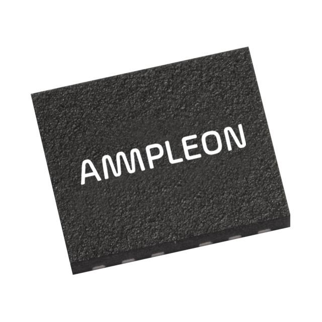

BLP10H610AZ
BLP10H610AZ
    AMPHENOL(安费诺)
    VDFN12
    RF FET LDMOS 104V 22DB 12VDFN
