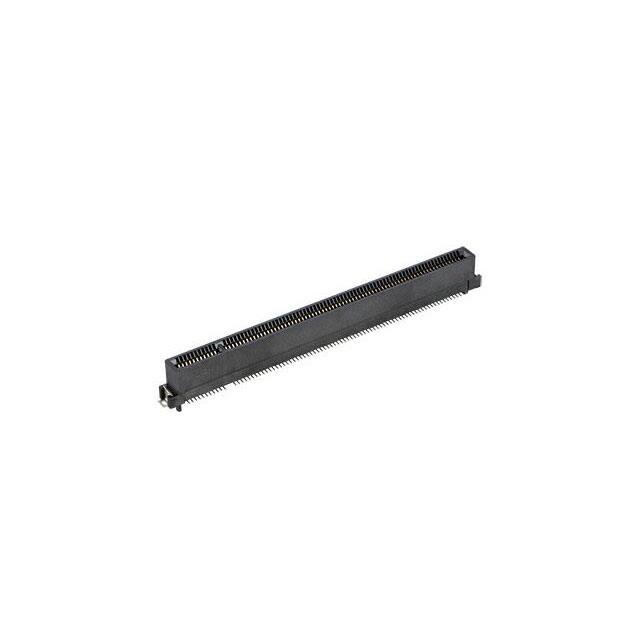

CEE016400140101 数据手册
1 2 3 4 revision history ecn no 4 CD2021 6 CD2675 5 CD2387 description dr date DETAILED THE PN SYSTEM JF JF 2020/05/30 JQ 2021/06/04 UPDATE PLATING SPEC UPDATE GOLD FINGER 2020/12/22 A (12.0 ) (7.0 ) A NOTE: 1.MATERIAL: HOUSING:HIGH TEMPERATURE THERMOPLASTIC;BLACK UL94V-0;HALOGEN FREE CONTACT:COPPER ALLOY BOARD LOCK:SPCC 2.PLATING: CONTACT:MATING AREA:SEE PN SYSTEM OVER 1.27-2.54UM NICKEL UNDERPLATED SOLDER AREA:2.54UM MIN TIN OVER 1.27-2.54UM NICKEL UNDERPLATED BOARD LOCK:2.54UM MIN TIN OVER 1.27-2.54UM NICKEL UNDERPLATED 3.ELECTRICAL PERFORMANCE: RATED CURRENT FOR SIGNAL PIN:0.7A/PIN RATED CURRENT FOR POWER PIN:1.1A/PIN(A2/A3/A9/A10/B1/B2/B3/B8/,TOTAL 8PIN) 4.MATERIAL IS COMPLIANT TO RoHS 5.TRANSMISSION SPEED: PCIe Gen4/16Gbps:OPEN PIN FIELD DESIGN PCIe Gen5/32Gbps:CONFORM TO PCIe CEM SPECIFICATION 6.ORDERING PART NUMBER:REFER TO THE PART NUMBER SYSTEM rev B TOP VIEW WITH PICK CAP (T=0.25mm) PART NUMBER SYSTEM PIN COUNT 164: 164PIN PICK CAP & MYLAR 0: WITH CAP 1: WITH MYLAR PLATING SPEC 1: Au 0.76UM(30u") 2: Au 0.38UM(15u") 3: Gold Flash 4: GXT (7.0 ) CEE0164X014XXXX (70.0 ) TRANSMISSION SPEED 0: PCIe Gen5/32Gbps 1: PCIe Gen4/16Gbps C SOLDER TAIL OPTION 2: STANDARD TAIL 3: SHORTER TAIL tolerance std TOLERANCES UNLESS OTHERWISE SPECIFIED 0.X surface linear 0.XX 0.XXX angular Creo File:APH-A3C,REV B,2021-05-07 1 2 0 $ dr JERRY.QU Jun.04,2021 eng JERRY.QU Jun.04,2021 mm rvwr ecn no amphenol-icc.com appr projection PCIe COOL EDGE CONNECTOR 1.0mm PITCH,X16,Gen4 & Gen5 product family 3 rel level dwg no spec ref D title C 2021 Amphenol Corporation PACKING TRAY 0: BLISTER TRAY (330x230mm T=2mm) 1: BLISTER TRAY (330x120mm T=2mm) 2: BLISTER TRAY (260x165mm T=2mm) 3: INJECTION TRAY (320x136mm) C TOP VIEW WITH MYLAR (T=0.15mm) scale 1:1 size A3 CD2675 RELEASED C CEE0164X014XXXX rev cat. no. PCIe COOL EDGE 4 sheet 1 of 5 6 D 1 2 3 4 95.00 93.00 PITCH=1.00 (5.80 ) (0.60 ) (7.05 ) 87.00 1.20 (0.30 )TYP 2.00 TOLERANCES UNLESS OTHERWISE SPECIFIED 0.X surface linear 0.XX 0.XXX angular Creo File:APH-A3C,REV B,2021-05-07 1 2 5.46 ECB (OPTIONAL) SHORTER TAIL SECTION A-A GND PIN DIFINITON (REFER TO PCIe CEM SPEC) SIDE A GND PIN 0 $ dr JERRY.QU Jun.04,2021 eng JERRY.QU Jun.04,2021 A12,A15,A18,A20,A23,A24,A27,A28,A31,A34,A37, A38,A41,A42,A45,A46,A49,A51,A54,A55,A58,A59, A62,A63,A66,A67,A70,A71,A74,A75,A78,A79,A82 B13,B16,B18,B21,B22,B25,B26,B29,B32,B35,B36, B39,B40,B43,B44,B47,B49,B52,B53,B56,B57,B60, B61,B64,B65,B68,B69,B72,B73,B76,B77,B80 mm rvwr ecn no amphenol-icc.com appr projection title spec ref tolerance std (0.65 ) C SIDE B GND PIN D ECB (OPTIONAL) B -A- 1.50 PITCH=1.00 7.00 STANDARD TAIL SECTION A-A 1.50 75.00 (0.70 ) (1.42 ) 3.40 0.15 3.40 2.45 10.45 YYMMDDL 1.50 1.80 DETAIL A SCALE 2:1 (0.70 ) DATE CODE C 2021 Amphenol Corporation DETAIL A SCALE 2:1 (71.65 ) (11.65 ) C SHORTER TAIL 4.40 0.20 B82 (0.34 ) STANDARD TAIL (7.05 ) 1.50 A82 3.40 0.15 1.50 B12 Y PCIe COOL EDGE CONNECTOR 1.0mm PITCH,X16,Gen4 & Gen5 product family 3 rel level dwg no B11 A12 A 4.40 0.20 B1 X A11 DETAIL A 1.78 0.05 5.80 A1 72.54 1.76 (3.00 ) 12.54 (7.00 ) 89.00 A scale 1:1 size A3 CD2675 RELEASED C CEE0164X014XXXX rev cat. no. PCIe COOL EDGE 4 sheet 2 of 5 6 D 1 2 3 4 A A R1.0 B12 B82 1.50 A # 0.05 (SEE TABLE 1) 12.15 0.10 (SEE TABLE 1) 72.15 0.10 1.50 1.50 ITEM/DIM PCIe Gen5 A11 20 $ 5 $ B TABLE 1 PCIe Gen4 A1 A12 A (Gold Finger Length) B (Gold Finger Width) 3.91 # 0.05 3.20 # 0.05(A1 and B81) 0.70 # 0.05 3.00 # 0.05 0.60 # 0.05 C A82 RECOMMENDED LAY OUT FOR MATING CARD,THICKNESS=1.57 # 0.15mm GENERAL TOLERANCE # 0.05 tolerance std TOLERANCES UNLESS OTHERWISE SPECIFIED 0.X surface linear 0.XX 0.XXX angular Creo File:APH-A3C,REV B,2021-05-07 1 2 0 $ dr JERRY.QU Jun.04,2021 eng JERRY.QU Jun.04,2021 mm rvwr ecn no amphenol-icc.com appr projection PCIe COOL EDGE CONNECTOR 1.0mm PITCH,X16,Gen4 & Gen5 product family 3 rel level dwg no spec ref D title C 2021 Amphenol Corporation PITCH=1.00 5.60 C # 0.05 A # 0.05 (SEE TABLE 1) B 1.50 0.50x45 $ TYP 1.30 0.25 B11 5.60 8.40 Min B1 1.90 0.05 1.57 0.15 GOLD FINGER TO GOLD FINGER B scale 1:1 size A3 CD2675 RELEASED C CEE0164X014XXXX rev cat. no. PCIe COOL EDGE 4 sheet 3 of 5 6 D 1 2 3 4 A A A11 A12 A82 B1 B11 B12 B82 PLACEMENT KEEP-OUT ZONE 87.00 B 1.65 0.03 -P- 1.55 0.05 95.90 0.05 E # 0.05 (SEE TABLE 2) A1 1.50 2.00 0.55 0.03 ROUTING KEEP OUT FOR HIGH-SPEED SIGNAL (OPTIONAL) 2x3.80 0.05 2x2.90 0.05 (71.0) (3.12) 1.50 1.95 0.05 C # 0.05 (SEE TABLE 2) 3.60 # 0.05 D F (SEE TABLE 2) 75.00 (96.40 ) RECOMMENDED SOLDER PCB LAYOUT C C ITEM/DIM SHORTER TAIL STANDARD TAIL tolerance std TOLERANCES UNLESS OTHERWISE SPECIFIED 0.X surface linear 0.XX 0.XXX angular Creo File:APH-A3C,REV B,2021-05-07 1 2 0 $ dr JERRY.QU Jun.04,2021 eng JERRY.QU Jun.04,2021 C (Pad Length) 1.20 1.90 D 6.00 7.40 E F 3.00 6.55 3.70 rvwr ecn no amphenol-icc.com appr projection 7.95 mm PCIe COOL EDGE CONNECTOR 1.0mm PITCH,X16,Gen4 & Gen5 product family 3 rel level dwg no spec ref D title C 2021 Amphenol Corporation TABLE 2 scale 1:1 size A3 CD2675 RELEASED C CEE0164X014XXXX rev cat. no. PCIe COOL EDGE 4 sheet 4 of 5 6 D 160.0 QTY (PCS/CARTON) 330x120x21 10 160 2 260x165x22 20 14 320x136x23 25 tolerance std surface 0.XX 0.XXX angular 2 23.0 280 ANTI-STATIC PS,BLACK,T=2.00;BLISTER TRAY TOLERANCES UNLESS OTHERWISE SPECIFIED linear 0 $ C ANTI-STATIC PS,BLACK,T=2.00;BLISTER TRAY ANTI-STATIC PS,BLACK,T=2.00;BLISTER TRAY 400 0.X PART NUMBER SYSTEM PACKING TRAY CODE: 3 220 spec ref B NOTE HIPS,BLACK;INJECTION TRAY dr JERRY.QU Jun.04,2021 eng JERRY.QU Jun.04,2021 mm rvwr ecn no amphenol-icc.com appr projection title C 2021 Amphenol Corporation 315.0 PART NUMBER SYSTEM PACKING TRAY CODE: 2 QTY (PCS/TRAY) 330x230x21 3 1 115.0 A TRAY SIZE (LxWxH) 0 1 Creo File:APH-A3C,REV B,2021-05-07 320.0 22.0 21.0 15.0 120.0 18.0 21.0 PART NUMBER SYSTEM PACKING CODE D 260.0 12.0 PART NUMBER SYSTEM PACKING TRAY CODE: 1 PART NUMBER SYSTEM PACKING TRAY CODE: 0 C 4 PCIe COOL EDGE CONNECTOR 1.0mm PITCH,X16,Gen4 & Gen5 product family 3 rel level dwg no 140.0 3 136.0 330.0 165.0 330.0 A 230.0 2 16.0 1 scale 1:1 size A3 CD2675 RELEASED C CEE0164X014XXXX rev cat. no. PCIe COOL EDGE 4 sheet 5 of 5 6 D
