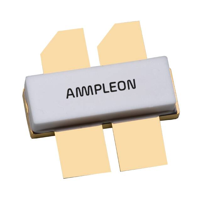

    RF FET HEMT 150V 14DB SOT1228B
CLF1G0035S-100PU 数据手册
CLF1G0035-100P; CLF1G0035S-100P Broadband RF power GaN HEMT Rev. 4 — 24 February 2016 Product data sheet 1. Product profile 1.1 General description The CLF1G0035-100P and CLF1G0035S-100P are 100 W general purpose broadband GaN HEMTs usable from DC to 3.5 GHz. Table 1. CW and pulsed RF application information Typical RF performance at Tcase = 25 C; IDq = 330 mA; VDS = 50 V in a class-AB broadband demo board. Test signal 1-Tone CW 1-Tone pulsed [1] [1] f PL Gp D (MHz) (W) (dB) (%) 2500 100 12.8 51 2600 100 12.7 52.4 2700 100 12.3 50 2800 100 11.7 49 2900 100 11.5 49 3000 100 10.5 47 2500 100 14.2 52 2600 100 14.4 54.4 2700 100 14.1 52.5 2800 100 13.7 51.5 2900 100 13.6 51.8 3000 100 12.7 50.1 Pulsed RF; tp = 100 s;  = 10 %. Table 2. 2-Tone CW application information Typical 2-Tone performance at Tcase = 25 C; IDq = 330 mA; VDS = 50 V in a class-AB broadband demo board. Test signal 2-Tone CW [1] [1] 2-Tone CW; f = 100 kHz. f PL(PEP) IMD3 (MHz) (W) (dBc) 2500 20 41.6 2600 20 43 2700 20 41.5 2800 20 41.3 2900 20 41.3 3000 20 40 CLF1G0035(S)-100P Broadband RF power GaN HEMT 1.2 Features and benefits      Frequency of operation is from DC to 3.5 GHz 100 W general purpose broadband RF Power GaN HEMT Excellent ruggedness (VSWR = 10 : 1) High voltage operation (50 V) Thermally enhanced package 1.3 Applications  Commercial wireless infrastructure (cellular, WiMAX)  Radar  Broadband general purpose amplifier  Public mobile radios  Industrial, scientific, medical  Jammers  EMC testing  Defense application 2. Pinning information Table 3. Pinning Pin Description Simplified outline Graphic symbol CLF1G0035-100P (SOT1228A) 1 drain1 2 drain2 3 gate1 4 gate2 5 source 1 2 3 4 1 3 5 5 4 2 aaa-005775 [1] CLF1G0035S-100P (SOT1228B) 1 drain1 2 drain2 3 gate1 4 2 3 5 4 gate2 5 [1] 1 1 2 aaa-005775 [1] source 3 4 Connected to flange. 3. Ordering information Table 4. CLF1G0035-100P_1G0035S-100P Product data sheet Ordering information Type number Package Name Description CLF1G0035-100P - flanged ceramic package; 2 mounting holes; 4 leads SOT1228A CLF1G0035S-100P - earless flanged ceramic package; 4 leads All information provided in this document is subject to legal disclaimers. Rev. 4 — 24 February 2016 Version SOT1228B © Ampleon Netherlands B.V. 2016. All rights reserved. 2 of 16 CLF1G0035(S)-100P Broadband RF power GaN HEMT 4. Limiting values Table 5. Limiting values In accordance with the Absolute Maximum Rating System (IEC 60134). Symbol Parameter VDS VGS IGF forward gate current Tstg storage temperature Tj junction temperature Conditions Min Max Unit drain-source voltage - 150 V gate-source voltage 8 +3 V - 36 mA 65 +150 C - 250 C external RG = 5  measured via IR scan 5. Thermal characteristics Table 6. Thermal characteristics Symbol Parameter Conditions Rth(j-c) thermal resistance from junction to case Tj = 200 C [1] [1] Typ Unit 1.02 K/W Tj is measured via IR scan with case temperature of 85 C and power dissipation of 108.6 W. 6. Characteristics Table 7. DC characteristics Tcase = 25 C; per section; unless otherwise specified. Symbol Parameter Conditions Min Typ Max Unit V(BR)DSS drain-source breakdown voltage VGS = 7 V; IDS = 12 mA 150 - - V VGS(th) gate-source threshold voltage VDS = 0.1 V; IDS = 12 mA 2.4 2 1.6 V IDSX drain cut-off current VDS = 10 V; VGS = 3 V - 8.8 - A gfs forward transconductance VDS = 10 V; VGS = 0 V - 1.8 - S Table 8. RF characteristics Test signal: pulsed RF; f = 3000 MHz; tp = 100 s;  = 10 %; RF performance at VDS = 50 V; IDq = 330 mA; Tcase = 25 C; unless otherwise specified in a class-AB production circuit. Symbol Parameter Conditions Min D drain efficiency PL = 100 W 43 49 - % Gp power gain PL = 100 W 10.3 12.5 - dB RLin input return loss PL = 100 W - 6 - dB PL = 100 W - 0.2 - dB Pdroop(pulse) pulse droop power CLF1G0035-100P_1G0035S-100P Product data sheet Typ Max Unit tr rise time PL = 100 W - 5 - ns tf fall time PL = 100 W - 5 - ns All information provided in this document is subject to legal disclaimers. Rev. 4 — 24 February 2016 © Ampleon Netherlands B.V. 2016. All rights reserved. 3 of 16 CLF1G0035(S)-100P Broadband RF power GaN HEMT 7. Application information 7.1 Demo circuit 50 mm 50 mm R2 R1 C5 C2 C11 C4 C6 Q1 60 mm C1 C10 C8 C7 C3 C9 C12 aaa-007980 Printed-Circuit Board (PCB) material: TMM6, r = 6.0, thickness = 0.635 mm, 28.35 grams copper on each side. See Table 9 for list of components. Fig 1. The broadband amplifier (2500 MHz to 3000 MHz) demo circuit outline Table 9. List of components See Figure 1. Component Description Value C1, C10 multilayer ceramic chip capacitor 20 pF C2, C3,C4, C7 multilayer ceramic chip capacitor 1 nF CLF1G0035-100P_1G0035S-100P Product data sheet C5, C8 multilayer ceramic chip capacitor 4.7 F, 50 V C6, C9 multilayer ceramic chip capacitor 10 F, 50 V C11, C12 electrolytic capacitor 220 F, 50 V Q1 transistor - R1 resistor 4.7  R2 resistor 0.01  All information provided in this document is subject to legal disclaimers. Rev. 4 — 24 February 2016 Remarks ATC800A ATC700A CLF1G0035-100P LVK25R01, 2W, 1 % tolerance © Ampleon Netherlands B.V. 2016. All rights reserved. 4 of 16 CLF1G0035(S)-100P Broadband RF power GaN HEMT 7.2 Application test results Table 10. CW and pulsed RF application information Typical RF performance at Tcase = 25 C; IDq = 330 mA; VDS = 50 V in a class-AB broadband demo board. Test signal 1-Tone CW 1-Tone pulsed [1] [1] f PL Gp D (MHz) (W) (dB) (%) 2500 100 12.8 51 2600 100 12.7 52.4 2700 100 12.3 50 2800 100 11.7 49 2900 100 11.5 49 3000 100 10.5 47 2500 100 14.2 52 2600 100 14.4 54.4 2700 100 14.1 52.5 2800 100 13.7 51.5 2900 100 13.6 51.8 3000 100 12.7 50.1 Pulsed RF; tp = 100 s;  = 10 %. Table 11. 2-Tone CW application information Typical 2-Tone performance at Tcase = 25 C; IDq = 330 mA; VDS = 50 V in a class-AB broadband demo board. Test signal 2-Tone CW [1] CLF1G0035-100P_1G0035S-100P Product data sheet [1] f PL(PEP) IMD3 (MHz) (W) (dBc) 2500 20 41.6 2600 20 43 2700 20 41.5 2800 20 41.3 2900 20 41.3 3000 20 40 2-Tone CW; f = 100 kHz. All information provided in this document is subject to legal disclaimers. Rev. 4 — 24 February 2016 © Ampleon Netherlands B.V. 2016. All rights reserved. 5 of 16 CLF1G0035(S)-100P Broadband RF power GaN HEMT 7.3 Graphical data The following figures are measured in a broadband amplifier demo board from 2500 MHz to 3000 MHz. 7.3.1 1-Tone CW RF performance aaa-005226 16 80 Gp (dB) aaa-005227 18 ηD (%) Gp (dB) Gp ηD (%) Gp 16 12 60 50 60 ηD 14 8 40 4 20 40 (1) (2) (3) 12 10 30 20 ηD 8 0 2400 2500 2600 2700 2800 2900 3000 f (MHz) 0 3100 10 6 0 36 VDS = 50 V; IDq = 330 mA; PL = 100 W. 38 40 42 44 46 48 50 PL (dBm) 52 VDS = 50 V; IDq = 330 mA. (1) f = 2500 MHz (2) f = 2700 MHz (3) f = 3000 MHz Fig 2. Power gain and drain efficiency as function of frequency; typical values CLF1G0035-100P_1G0035S-100P Product data sheet Fig 3. Power gain and drain efficiency as a function of output power; typical values All information provided in this document is subject to legal disclaimers. Rev. 4 — 24 February 2016 © Ampleon Netherlands B.V. 2016. All rights reserved. 6 of 16 CLF1G0035(S)-100P Broadband RF power GaN HEMT 7.3.2 1-Tone pulsed RF performance aaa-005228 18 80 Gp (dB) aaa-005229 18 Gp ηD (%) 16 14 60 Gp (dB) ηD (%) 50 Gp 60 14 40 ηD 10 40 6 20 (1) (2) (3) 12 30 10 20 ηD 8 2 2400 2500 2600 2700 2800 0 3100 2900 3000 f (MHz) 10 6 0 36 VDS = 50 V; IDq = 330 mA; PL = 100 W. 38 40 42 44 46 48 50 PL (dBm) 52 VDS = 50 V; IDq = 330 mA. (1) f = 2500 MHz (2) f = 2700 MHz (3) f = 3000 MHz Fig 4. Power gain and drain efficiency as function of frequency; typical values Fig 5. Power gain and drain efficiency as function of output power; typical values 7.3.3 2-Tone CW performance aaa-005230 0 IMD3 (dBc) -10 -20 -30 (3) -40 (2) -50 (1) -60 0 25 50 75 100 125 PL(PEP) (W) 150 f = 100 kHz; VDS = 50 V; IDq = 330 mA. (1) f = 2500 MHz (2) f = 2700 MHz (3) f = 3000 MHz Fig 6. CLF1G0035-100P_1G0035S-100P Product data sheet Third-order intermodulation distortion as a function of peak envelope power load power; typical values All information provided in this document is subject to legal disclaimers. Rev. 4 — 24 February 2016 © Ampleon Netherlands B.V. 2016. All rights reserved. 7 of 16 CLF1G0035(S)-100P Broadband RF power GaN HEMT 8. Test information 8.1 Ruggedness in class-AB operation The CLF1G0035-100P and CLF1G0035S-100P are capable of withstanding a load mismatch corresponding to VSWR = 10 : 1 through all phases under the following conditions: VDS = 50 V; PL = 100 W (CW), f = 2500 MHz. 8.2 Load pull impedance information Table 12. Typical impedance Measured load-pull data half device. Typical values unless otherwise specified. IDq = 150 mA; VDS = 50 V. ZS and ZL defined in Figure 7. f ZS [1] ZL (maximum PL(M)) [2] ZL (maximum D) [2] (MHz) () () () 500 6.4 + 4j 9.7 + 7j 10 + 5j 1000 1.9 + 2.2j 9.1 + 12.4j 10 + 6j 2000 1.9  2.9j 5 + 4.1j 6.6 + 1.4j 2500 2.1  6.3j 3.6 + 0.75j 4.5  0.4j 3000 2.5  9j 3.9  1.2j 5.8  1.8j 3500 2.9  14j 6.6  2j 5.8  3j [1] measured at gate1 and gate2 [2] measured at drain1 and drain2 drain 1 gate 1 ZL ZS gate 2 drain 2 aaa-007981 Fig 7. Definition of transistor impedance ZS is the measured source pull impedance presented to the device. ZL is the measured load pull impedance presented to the device. CLF1G0035-100P_1G0035S-100P Product data sheet All information provided in this document is subject to legal disclaimers. Rev. 4 — 24 February 2016 © Ampleon Netherlands B.V. 2016. All rights reserved. 8 of 16 CLF1G0035(S)-100P Broadband RF power GaN HEMT 8.3 Packaged S-parameter data Table 13. S-parameter data half device Small signal; typical values unless otherwise specified; VDS = 50 V; IDq = 150 mA; ZS = ZL = 50 . f (MHz) S11 S21 S12 S22 Magnitude (ratio) Angle (degree) Magnitude (ratio) Angle (degree) Magnitude (ratio) Angle (degree) Magnitude (ratio) Angle (degree) 500 0.82686 168.9 9.6028 67.238 0.01482 9.5809 0.48482 133.17 600 0.82717 171.62 7.7589 61.123 0.013844 12.463 0.52053 136.01 700 0.82892 173.81 6.4386 55.547 0.01282 14.415 0.55589 138.65 800 0.83183 175.69 5.4524 50.412 0.011783 15.413 0.58964 141.17 900 0.83572 177.39 4.6934 45.655 0.010764 15.358 0.62126 143.61 1000 0.84047 178.98 4.096 41.233 0.0097946 14.091 0.65063 145.96 1100 0.84604 179.5 3.618 37.11 0.008907 11.409 0.67787 148.22 1200 0.85244 178 3.2306 33.257 0.0081421 7.0907 0.70319 150.39 1300 0.8597 176.51 2.9136 29.648 0.0075495 0.99281 0.72687 152.47 1400 0.86785 175.01 2.6525 26.259 0.0071873 6.7932 0.74919 154.47 1500 0.87697 173.47 2.4362 23.07 0.0071125 15.766 0.77044 156.39 1600 0.88715 171.88 2.2569 20.062 0.0073641 25.034 0.79086 158.24 1700 0.89848 170.23 2.1083 17.22 0.007952 33.645 0.81069 160.04 1800 0.90446 168.57 1.972 14.461 0.0088014 40.908 0.8252 161.7 1900 0.90172 166.97 1.839 11.713 0.0098257 46.58 0.83233 163.2 2000 0.89927 165.33 1.7253 9.0465 0.011062 50.849 0.83898 164.63 2100 0.89713 163.64 1.6281 6.4503 0.012486 53.942 0.84528 166 2200 0.89532 161.88 1.5454 3.9129 0.014088 56.092 0.85135 167.32 2300 0.89386 160.04 1.4755 1.4231 0.015869 57.498 0.85727 168.6 2400 0.89277 158.1 1.4171 1.0309 0.01784 58.314 0.86313 169.84 2500 0.89205 156.03 1.3692 3.4611 0.020023 58.659 0.86899 171.05 2600 0.89096 153.83 1.3297 5.8933 0.022423 58.605 0.87436 172.23 2700 0.88445 151.58 1.2888 8.4222 0.024891 58.132 0.87579 173.35 2800 0.87762 149.17 1.2551 10.982 0.027588 57.364 0.87715 174.44 2900 0.87039 146.59 1.2281 13.588 0.030547 56.329 0.87847 175.5 3000 0.86268 143.8 1.2076 16.259 0.033808 55.045 0.8798 176.54 3100 0.85434 140.75 1.1934 19.013 0.037423 53.519 0.88118 177.56 3200 0.84525 137.4 1.1855 21.877 0.041451 51.748 0.88265 178.56 3300 0.83522 133.68 1.1839 24.877 0.045967 49.721 0.88425 179.53 3400 0.82403 129.52 1.1889 28.05 0.051058 47.418 0.88607 179.52 3500 0.80856 125.24 1.1872 31.326 0.056194 44.92 0.88556 178.56 3600 0.79077 120.6 1.1867 34.765 0.061705 42.174 0.88468 177.6 3700 0.77106 115.45 1.1896 38.412 0.067742 39.146 0.88406 176.66 3800 0.74926 109.7 1.1956 42.297 0.074348 35.812 0.88382 175.74 3900 0.72527 103.23 1.2044 46.449 0.081559 32.146 0.88412 174.82 4000 0.69912 95.917 1.2152 50.902 0.089394 28.121 0.88516 173.9 4100 0.67108 87.595 1.2274 55.686 0.097849 23.71 0.88717 172.98 CLF1G0035-100P_1G0035S-100P Product data sheet All information provided in this document is subject to legal disclaimers. Rev. 4 — 24 February 2016 © Ampleon Netherlands B.V. 2016. All rights reserved. 9 of 16 CLF1G0035(S)-100P Broadband RF power GaN HEMT Table 13. S-parameter data half device …continued Small signal; typical values unless otherwise specified; VDS = 50 V; IDq = 150 mA; ZS = ZL = 50 . f (MHz) S11 Magnitude (ratio) Angle (degree) Magnitude (ratio) Angle (degree) Magnitude (ratio) Angle (degree) Magnitude (ratio) Angle (degree) 4200 0.64183 78.092 1.24 60.826 0.10688 18.891 0.89042 172.03 4300 0.6126 67.228 1.2515 66.34 0.11639 13.65 0.89516 171.03 4400 0.58534 54.856 1.2604 72.231 0.12622 7.9864 0.90159 169.95 4500 0.5628 40.93 1.2649 78.48 0.13615 1.9193 0.90984 168.75 4600 0.54816 25.608 1.2633 85.047 0.14588 4.5074 0.91983 167.38 4700 0.54433 9.3292 1.2542 91.862 0.15511 11.224 0.9313 165.79 4800 0.55279 7.214 1.2369 98.835 0.16356 18.138 0.94381 163.95 4900 0.57293 23.266 1.2115 105.86 0.17103 25.144 0.95677 161.82 5000 0.60219 38.234 1.1791 112.84 0.17745 32.138 0.96962 159.39 5100 0.63534 51.341 1.1406 119.47 0.18272 38.825 0.9807 156.67 5200 0.66527 61.779 1.0972 125.31 0.18683 44.756 0.98704 153.74 5300 0.69493 71.079 1.0544 130.96 0.1906 50.53 0.99214 150.52 5400 0.72195 78.947 1.0134 136.23 0.19423 55.963 0.99508 147.04 5500 0.74577 85.567 0.97537 141.15 0.19795 61.088 0.99579 143.28 5600 0.76759 91.49 0.94075 146 0.20193 66.161 0.99532 139.15 5700 0.78744 96.798 0.90986 150.8 0.20632 71.236 0.99371 134.58 5800 0.80548 101.57 0.88283 155.64 0.21125 76.374 0.99093 129.47 5900 0.82197 105.86 0.85961 160.58 0.21682 81.647 0.98694 123.72 6000 0.83722 109.72 0.84 165.71 0.22309 87.14 0.98164 117.18 CLF1G0035-100P_1G0035S-100P Product data sheet S21 S12 All information provided in this document is subject to legal disclaimers. Rev. 4 — 24 February 2016 S22 © Ampleon Netherlands B.V. 2016. All rights reserved. 10 of 16 CLF1G0035(S)-100P Broadband RF power GaN HEMT 9. Package outline Flanged LDMOST ceramic package; 2 mounting holes; 4 leads SOT1228A D A F D1 w1 U1 B q C w2 H1 1 B c C 2 w3 H A A B E1 p U2 E 5 A w1 3 A B 4 w1 b w4 e 0 w4 Q 5 A B 0.380 10 mm 0.015 scale Dimensions Unit(1) mm max nom min A b c 5.2 5.59 0.15 D D1 E e 16.66 16.69 E1 F 5.92 5.97 1.65 H H1 18.29 12.19 p Q(2) 3.43 2.21 max 0.205 inches nom min 0.177 5.33 0.08 16.36 16.33 0.220 0.006 0.656 0.657 5.77 5.72 1.40 17.27 11.94 3.18 0.003 1.145 0.235 0.01 0.02 0.005 1.135 0.225 Note 1. Millimeter dimensions are derived from the original inch dimensions. 2. Dimension is measured 0.030 inch (0.76 mm) from body. Outline version References IEC JEDEC JEITA sot1228a_po European projection Issue date 12-06-11 13-05-16 SOT1228A Fig 8. w3 0.25 0.51 0.125 0.900 0.227 0.225 0.055 0.680 0.470 0.125 0.077 w2 28.83 5.72 0.233 0.235 0.065 0.720 0.480 0.135 0.087 0.644 0.643 w1 29.08 5.97 1.96 0.26 0.210 U2 22.86 6.60 4.5 U1 q Package outline SOT1228A CLF1G0035-100P_1G0035S-100P Product data sheet All information provided in this document is subject to legal disclaimers. Rev. 4 — 24 February 2016 © Ampleon Netherlands B.V. 2016. All rights reserved. 11 of 16 CLF1G0035(S)-100P Broadband RF power GaN HEMT Earless flanged LDMOST ceramic package; 4 leads SOT1228B D A F 5 D1 w1 U1 A B B H1 w2 1 c B 2 w3 A B E1 H U2 E A 3 4 w1 b Q e w4 0 5 A B 10 mm scale Dimensions Unit(1) mm max nom min A b c 5.2 5.59 0.15 D D1 E e 16.66 16.69 E1 F H H1 Q(2) U1 w1 U2 5.92 5.97 1.65 18.29 12.19 2.21 17.40 5.97 5.77 5.72 1.40 17.27 11.94 1.96 17.15 5.72 max 0.205 inches nom min 0.177 5.33 0.08 16.36 16.33 0.220 0.006 0.656 0.657 0.233 0.235 0.065 0.720 0.480 0.087 0.685 0.235 0.227 0.225 0.055 0.680 0.470 0.077 0.675 0.225 0.003 0.644 0.643 Note 1. Millimeter dimensions are derived from the original inch dimensions. 2. Dimension is measured 0.030 inch (0.76 mm) from body. Outline version References IEC JEDEC JEITA sot1228b_po European projection Issue date 13-05-15 13-05-23 SOT1228B Fig 9. w4 0.01 0.02 0.005 0.01 0.26 0.210 w3 0.25 0.51 0.125 0.38 6.60 4.5 w2 Package outline SOT1228B CLF1G0035-100P_1G0035S-100P Product data sheet All information provided in this document is subject to legal disclaimers. Rev. 4 — 24 February 2016 © Ampleon Netherlands B.V. 2016. All rights reserved. 12 of 16 CLF1G0035(S)-100P Broadband RF power GaN HEMT 10. Handling information 10.1 ESD Sensitivity Table 14. ESD sensitivity ESD model Class Human Body Model (HBM); According JEDEC standard JESD22-A114F 1B [1] [1] Classification 1B is granted to any part that passes after exposure to an ESD pulse of 500 V, but fails after exposure to an ESD pulse of 1000 V. 11. Abbreviations Table 15. Abbreviations Acronym Description CW Continuous Wave EMC ElectroMagnetic Compatibility ESD ElectroStatic Discharge GaN Gallium Nitride HEMT High Electron Mobility Transistor VSWR Voltage Standing-Wave Ratio WiMAX Worldwide Interoperability for Microwave Access 12. Revision history Table 16. Revision history Document ID Release date Data sheet status Change notice Supersedes CLF1G0035-100P_1G0035S-100P v.4 20160224 Product data sheet - CLF1G0035-100P_ 1G0035S-100P#3 Modifications: • Table 8 on page 3: table updated CLF1G0035-100P_1G0035S-100P#3 20150901 Objective data sheet - CLF1G0035-100P_ 1G0035S-100P v.1 CLF1G0035-100P_1G0035S-100P v.2 20130620 Objective data sheet - CLF1G0035-100P_ 1G0035S-100P v.1 CLF1G0035-100P_1G0035S-100P v.1 20121210 Objective data sheet - - CLF1G0035-100P_1G0035S-100P Product data sheet All information provided in this document is subject to legal disclaimers. Rev. 4 — 24 February 2016 © Ampleon Netherlands B.V. 2016. All rights reserved. 13 of 16 CLF1G0035(S)-100P Broadband RF power GaN HEMT 13. Legal information 13.1 Data sheet status Document status[1][2] Product status[3] Definition Objective [short] data sheet Development This document contains data from the objective specification for product development. Preliminary [short] data sheet Qualification This document contains data from the preliminary specification. Product [short] data sheet Production This document contains the product specification. [1] Please consult the most recently issued document before initiating or completing a design. [2] The term ‘short data sheet’ is explained in section “Definitions”. [3] The product status of device(s) described in this document may have changed since this document was published and may differ in case of multiple devices. The latest product status information is available on the Internet at URL http://www.ampleon.com. 13.2 Definitions Draft — The document is a draft version only. The content is still under internal review and subject to formal approval, which may result in modifications or additions. Ampleon does not give any representations or warranties as to the accuracy or completeness of information included herein and shall have no liability for the consequences of use of such information. Short data sheet — A short data sheet is an extract from a full data sheet with the same product type number(s) and title. A short data sheet is intended for quick reference only and should not be relied upon to contain detailed and full information. For detailed and full information see the relevant full data sheet, which is available on request via the local Ampleon sales office. In case of any inconsistency or conflict with the short data sheet, the full data sheet shall prevail. Product specification — The information and data provided in a Product data sheet shall define the specification of the product as agreed between Ampleon and its customer, unless Ampleon and customer have explicitly agreed otherwise in writing. In no event however, shall an agreement be valid in which the Ampleon product is deemed to offer functions and qualities beyond those described in the Product data sheet. 13.3 Disclaimers Limited warranty and liability — Information in this document is believed to be accurate and reliable. However, Ampleon does not give any representations or warranties, expressed or implied, as to the accuracy or completeness of such information and shall have no liability for the consequences of use of such information. Ampleon takes no responsibility for the content in this document if provided by an information source outside of Ampleon. In no event shall Ampleon be liable for any indirect, incidental, punitive, special or consequential damages (including - without limitation - lost profits, lost savings, business interruption, costs related to the removal or replacement of any products or rework charges) whether or not such damages are based on tort (including negligence), warranty, breach of contract or any other legal theory. Notwithstanding any damages that customer might incur for any reason whatsoever, Ampleon’s aggregate and cumulative liability towards customer for the products described herein shall be limited in accordance with the Terms and conditions of commercial sale of Ampleon. Right to make changes — Ampleon reserves the right to make changes to information published in this document, including without limitation specifications and product descriptions, at any time and without notice. This document supersedes and replaces all information supplied prior to the publication hereof. Suitability for use — Ampleon products are not designed, authorized or warranted to be suitable for use in life support, life-critical or safety-critical systems or equipment, nor in applications where failure or malfunction of an CLF1G0035-100P_1G0035S-100P Product data sheet Ampleon product can reasonably be expected to result in personal injury, death or severe property or environmental damage. Ampleon and its suppliers accept no liability for inclusion and/or use of Ampleon products in such equipment or applications and therefore such inclusion and/or use is at the customer’s own risk. Applications — Applications that are described herein for any of these products are for illustrative purposes only. Ampleon makes no representation or warranty that such applications will be suitable for the specified use without further testing or modification. Customers are responsible for the design and operation of their applications and products using Ampleon products, and Ampleon accepts no liability for any assistance with applications or customer product design. It is customer’s sole responsibility to determine whether the Ampleon product is suitable and fit for the customer’s applications and products planned, as well as for the planned application and use of customer’s third party customer(s). Customers should provide appropriate design and operating safeguards to minimize the risks associated with their applications and products. Ampleon does not accept any liability related to any default, damage, costs or problem which is based on any weakness or default in the customer’s applications or products, or the application or use by customer’s third party customer(s). Customer is responsible for doing all necessary testing for the customer’s applications and products using Ampleon products in order to avoid a default of the applications and the products or of the application or use by customer’s third party customer(s). Ampleon does not accept any liability in this respect. Limiting values — Stress above one or more limiting values (as defined in the Absolute Maximum Ratings System of IEC 60134) will cause permanent damage to the device. Limiting values are stress ratings only and (proper) operation of the device at these or any other conditions above those given in the Recommended operating conditions section (if present) or the Characteristics sections of this document is not warranted. Constant or repeated exposure to limiting values will permanently and irreversibly affect the quality and reliability of the device. Terms and conditions of commercial sale — Ampleon products are sold subject to the general terms and conditions of commercial sale, as published at http://www.ampleon.com/terms, unless otherwise agreed in a valid written individual agreement. In case an individual agreement is concluded only the terms and conditions of the respective agreement shall apply. Ampleon hereby expressly objects to applying the customer’s general terms and conditions with regard to the purchase of Ampleon products by customer. No offer to sell or license — Nothing in this document may be interpreted or construed as an offer to sell products that is open for acceptance or the grant, conveyance or implication of any license under any copyrights, patents or other industrial or intellectual property rights. Export control — This document as well as the item(s) described herein may be subject to export control regulations. Export might require a prior authorization from competent authorities. All information provided in this document is subject to legal disclaimers. Rev. 4 — 24 February 2016 © Ampleon Netherlands B.V. 2016. All rights reserved. 14 of 16 CLF1G0035(S)-100P Broadband RF power GaN HEMT Non-automotive qualified products — Unless this data sheet expressly states that this specific Ampleon product is automotive qualified, the product is not suitable for automotive use. It is neither qualified nor tested in accordance with automotive testing or application requirements. Ampleon accepts no liability for inclusion and/or use of non-automotive qualified products in automotive equipment or applications. In the event that customer uses the product for design-in and use in automotive applications to automotive specifications and standards, customer (a) shall use the product without Ampleon’ warranty of the product for such automotive applications, use and specifications, and (b) whenever customer uses the product for automotive applications beyond Ampleon’ specifications such use shall be solely at customer’s own risk, and (c) customer fully indemnifies Ampleon for any liability, damages or failed product claims resulting from customer design and use of the product for automotive applications beyond Ampleon’ standard warranty and Ampleon’ product specifications. Translations — A non-English (translated) version of a document is for reference only. The English version shall prevail in case of any discrepancy between the translated and English versions. 13.4 Trademarks Notice: All referenced brands, product names, service names and trademarks are the property of their respective owners. Any reference or use of any ‘NXP’ trademark in this document or in or on the surface of Ampleon products does not result in any claim, liability or entitlement vis-à-vis the owner of this trademark. Ampleon is no longer part of the NXP group of companies and any reference to or use of the ‘NXP’ trademarks will be replaced by reference to or use of Ampleon’s own trademarks. 14. Contact information For more information, please visit: http://www.ampleon.com For sales office addresses, please visit: http://www.ampleon.com/sales CLF1G0035-100P_1G0035S-100P Product data sheet All information provided in this document is subject to legal disclaimers. Rev. 4 — 24 February 2016 © Ampleon Netherlands B.V. 2016. All rights reserved. 15 of 16 CLF1G0035(S)-100P Broadband RF power GaN HEMT 15. Contents 1 1.1 1.2 1.3 2 3 4 5 6 7 7.1 7.2 7.3 7.3.1 7.3.2 7.3.3 8 8.1 8.2 8.3 9 10 10.1 11 12 13 13.1 13.2 13.3 13.4 14 15 Product profile . . . . . . . . . . . . . . . . . . . . . . . . . . 1 General description . . . . . . . . . . . . . . . . . . . . . 1 Features and benefits . . . . . . . . . . . . . . . . . . . . 2 Applications . . . . . . . . . . . . . . . . . . . . . . . . . . . 2 Pinning information . . . . . . . . . . . . . . . . . . . . . . 2 Ordering information . . . . . . . . . . . . . . . . . . . . . 2 Limiting values. . . . . . . . . . . . . . . . . . . . . . . . . . 3 Thermal characteristics . . . . . . . . . . . . . . . . . . 3 Characteristics . . . . . . . . . . . . . . . . . . . . . . . . . . 3 Application information. . . . . . . . . . . . . . . . . . . 4 Demo circuit . . . . . . . . . . . . . . . . . . . . . . . . . . . 4 Application test results . . . . . . . . . . . . . . . . . . . 5 Graphical data . . . . . . . . . . . . . . . . . . . . . . . . . 6 1-Tone CW RF performance. . . . . . . . . . . . . . . 6 1-Tone pulsed RF performance . . . . . . . . . . . . 7 2-Tone CW performance . . . . . . . . . . . . . . . . . 7 Test information . . . . . . . . . . . . . . . . . . . . . . . . . 8 Ruggedness in class-AB operation . . . . . . . . . 8 Load pull impedance information . . . . . . . . . . . 8 Packaged S-parameter data. . . . . . . . . . . . . . . 9 Package outline . . . . . . . . . . . . . . . . . . . . . . . . 11 Handling information. . . . . . . . . . . . . . . . . . . . 13 ESD Sensitivity . . . . . . . . . . . . . . . . . . . . . . . . 13 Abbreviations . . . . . . . . . . . . . . . . . . . . . . . . . . 13 Revision history . . . . . . . . . . . . . . . . . . . . . . . . 13 Legal information. . . . . . . . . . . . . . . . . . . . . . . 14 Data sheet status . . . . . . . . . . . . . . . . . . . . . . 14 Definitions . . . . . . . . . . . . . . . . . . . . . . . . . . . . 14 Disclaimers . . . . . . . . . . . . . . . . . . . . . . . . . . . 14 Trademarks. . . . . . . . . . . . . . . . . . . . . . . . . . . 15 Contact information. . . . . . . . . . . . . . . . . . . . . 15 Contents . . . . . . . . . . . . . . . . . . . . . . . . . . . . . . 16 Please be aware that important notices concerning this document and the product(s) described herein, have been included in section ‘Legal information’. © Ampleon Netherlands B.V. 2016. All rights reserved. For more information, please visit: http://www.ampleon.com For sales office addresses, please visit: http://www.ampleon.com/sales Date of release: 24 February 2016 Document identifier: CLF1G0035-100P_1G0035S-100P
