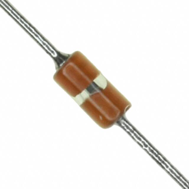

NTC Diode Thermometrics Thermistors A range of NTC chip thermistors in DO-35 style glass package (diode outline) with axial soldercoated copper-clad steel wires. • Available on axial bandolier to IEC-286-1/ EIA-468A and packet taped to EIA RS-481 for MELF. • Designed for accurate temperature measurement, control and compensation • Also available loose-packed with axial, radial and SMD wire forms • Tight tolerances on resistance and B value • Suitable for automotive, telecom (battery packs), HVAC and white goods applications • Operation up to 482°F (250°C) with excellent stability • Glass body provides hermetic seal and voltage insulation and excellent stability • Designed for cost effective solid state sensor • Lead-wires metallurgically bonded to thermistor element for improved reliability (Type GE only) • Resistant to corrosive atmospheres and harsh environments Amphenol Advanced Sensors • Temperature sensing for household appliances such as rice cookers, electronic ranges, ovens, etc. • Temperature sensing for industrial products such as pharmaceuticals, chemicals, food, etc.components. Type DK Specifications Chip thermistor in DO-35 glass package Options • Other resistance values within the ranges shown; e.g. code DKA302*2 for 3000 Ω ±2% at 77°F (25°C) • Reference temperatures in the range 0°F to 302°F (-18°C to 150°C) 1.06 in (27 mm) minimum 0.08 in (2 mm) Inside radius nominal 0.05 in (1.2 mm) nominal 0.16 in (4 mm) maximum Ø 0.02 in (0.5 mm) 0.1 in (2.8 mm) nominal 0.8 in (19.5 mm) ±1 NTC Type DK wires should not be bent within 0.08 in (2 mm) of glass body Data • Operating temperature: -40°F to 482°F (-40°C to 250°C) Coding Replace * in the codes shown below as follows: • Axial, loose-packed: N • Thermal time constant: 7 seconds (cooling in air) • Dissipation factor: 3.0 mW/K • Mass: 0.2 g • Axial, bandoliered: B • Packing/MOQ: 1000/box (loose), 5000/reel (bandoliered) • Radial, loose-packed: H • Surface mount, loose-packed: M R25 W Material system B 25/85 K Code R25 ±2% Code R25 ±3% Code R25 ±5% Code R25 ±10% 2000 2 3540 ±1% DKA202*2 DKA202*3 DKA202*5 DKA202*10 5000 2 3540 ±1% DKA502*2 DKA502*3 DKA502*5 DKA502*10 10,000 2 3540 ±1% DKA103*2 DKA103*3 DKA103*5 DKA103*10 10,000 5A 3730 ±2% DKC103*3 DKC103*5 DKC103*10 12,000 5A 3730 ±2% DKC123*2 DKC123*3 DKC123*5 DKC123*10 10,000 3 3960 ±1% DKF103*2 DKF103*3 DKF103*5 DKF103*10 20,000 3 3960 ±1% DKF203*2 DKF203*3 DKF203*5 DKF203*10 30,000 3 3960 ±1% DKF303*2 DKF303*3 DKF303*5 DKF303*10 50,000 3 3960 ±1% DKF503*2 DKF503*3 DKF503*5 DKF503*10 100,000 3 3960 ±1% DKF104*2 DKF104*3 DKF104*5 DKF104*10 200,000 G 4263 ±2% DKG204*5 DKG204*10 500,000 D 4573 ±2% DKD504*5 DKD504*10 1,000,000 D 4573 ±2% DKD105*5 DKD105*10 See separate tables for resistance-temperature data.. Consult factory for additional tolerance requirements. 2 0.2 in (4.2 mm) maximum DK-H • Operation to 572°F (300°C) (no solder coating on wires) • Wire lengths 0.16 in to 1.26 in (4 mm to 32 mm) ±0.04 in (±1 mm) for DK-N; up to 1.02 in (26 mm) for DK-H 0.02 in (0.5 mm) nominal 0.08 in (2 mm) maximum DK-N Type DKM Specifications 0.09 in (2.2 mm) maximum 0.04 in (1 mm) minimum Glass encapsulated SMD thermistor 0.04 in (1 mm) minimum 0.2 in (4.2 mm) maximum 0.4 in (9.0 mm)/ 0.4 in (9.5 mm ) Description A range of thermistors in DO-35 style glass package (diode outline formed for surface lead-wires and applications) with soldercoated copper-clad steel lead-wires. NTC Type DKM wires should not be bent within 0.08 in (2 mm) of glass body Options • Other resistance values within the ranges shown; e.g. code DKA302M2 for 3000 Ω ±2% at 77°F (25°C) Data • Reference temperatures in the range 32°F to 302°F (0°C to 150°C) • Thermal time constant: 7 seconds (cooling in air) • For tape and reel, add suffix “AB” • Mass: 0.2 g • Operation to 572°F (300°C); no solder coating on lead-wires • Packing/MOQ: 1000/box (loose) • Operating temperature: -40°F to 482°F (-40°C to 250°C) • Dissipation factor: 3.0 mW/K R25 W Material System B 25/85 K Code R25 ±2% Code R25 ±3% Code R25 ±5% Code R25 ±10% 2000 2 3540 ±1% DKA202M2 DKA202M3 DKA202M5 DKA202M10 5000 2 3540 ±1% DKA502M2 DKA502M3 DKA502M5 DKA502M10 10,000 2 3540 ±1% DKA103M2 DKA103M3 DKA103M5 DKA103M10 10,000 5A 3730 ±2% DKC103M3 DKC103M5 DKC103M10 10,000 3 3960 ±1% DKF103M2 DKF103M3 DKF103M5 DKF103M10 20,000 3 3960 ±1% DKF203M2 DKF203M3 DKF203M5 DKF203M10 30,000 3 3960 ±1% DKF303M2 DKF303M3 DKF303M5 DKF303M10 50,000 3 3960 ±1% DKF503M2 DKF503M3 DKF503M5 DKF503M10 100,000 3 3960 ±1% DKF104M2 DKF104M3 DKF104M5 DKF104M10 200,000 G 4263 ±2% DKG204M5 DKG204M10 500,000 D 4573 ±2% DKD504M5 DKD504M10 1,000,000 D 4573 ±2% DKD105M5 DKD105M10 See separate tables for resistance-temperature data. Consult factory for additional tolerance requirements. 3 Type GE Specifications Tinned AWG 24 Glass encapsulated DO-35 package Options 1.15 in (29.2 mm) ± 0.1 • For reel taping • Nickel leads for welding 1.15 in (29.2 mm) ± 0.1 • Other resistances in the range 250 Ω to 5 MΩ Data • Other tolerances, tolerances at other temperatures • Dissipation constant: 3.0 mW/K • Can be expanded to 572°F (300°C) with nickel leads • Standard resistance tolerance: ±10% @ 77°F (25°C) • Time constant: 7 seconds • Operating range: -58°F to 400°F (-50°C to 204°C • Lead Wires metallurgically bonded to thermistor element for improved reliability Material System Beta 25/85 Type Number 250 GE5.5* 2983 AL03006-165.9-55-G1 500 GE5.5* 2983 AL03006-331.8-55-G1 1K GE7.3 3499 AL03006-624-73-G1 2K GE7.3 3499 AL03006-1248-73-G1 2786 GE10.1 4102 AL03006-1576-101-G1 3K GE7.6 3553 AL03006-1847-76-G1 4K GE7.6 3553 AL03006-2463-76-G1 5K GE7.6 3553 AL03006-3079-76-G1 10K GE9.7A 3992 AL03006-5818-97-G1 20K GE9.8 3974 AL03006-11.7K-98-G1 30K GE9.8 3974 AL03006-17.53K-98-G1 50K GE9.7B 3952 AL03006-29.1K-97-G1 100K GE9.7B 3952 AL03006-58.2K-97-G1 200K GE12.3 4365 AL03006-111.3K-123-G1 500K GE13.8 4567 AL03006-269.8K-138-G1 1M GE14.5 4661 AL03006-535K-145-G1 5M GE16.4 4848 AL03006-2.6M-164-G1 Ro@25°C (W ) Ø 0.075 in (1.9 mm) maximum NTC Type GE dimensions • Alternative leads lengths, lead materials *maximum operating temperature 302°F (150°C) 4 0.155 in (3.93 mm) maximum Type MELF Specifications Tinned dumet contacts (2 places) Glass Ø 0.063 to 0.067 in (1.6 to 1.7 mm) Glass encapsulated SMD thermistor Description Hermetically sealed, glass encapsulated thermistor in SOD-80 SMD package. 0.016 to 0.022 in (0.41 to 0.56 mm) 0.016 to 0.022 in (0.41 to 0.56 mm) 0.13 to 0.146 in (3.3 to 3.71 mm) Options NTC Type MELF dimensions • Pocket Taping • Other resistances in the range 250 Ω to 5 MΩ available • Other tolerances, tolerances at other temperatures Data • Standard resistance tolerance: ±10% @ 77°F (25°C) • Dissipation constant: 3.0 mW/°C • Time constant: 7 seconds • Operating range: -58°F to 400°F (-50°C to 204°C) Ro@25° C (W ) Material System Beta 25/85 Type Number 250 GE5.5* 2983 03006-165.9-55-G100 500 GE5.5* 2983 03006-331.8-55-G100 1K GE7.3 3499 03006-624-73-G100 2K GE7.3 3499 03006-1248-73-G100 2786 GE10.1 4102 03006-1576-101-G100 3K GE7.6 3553 03006-1847-76-G100 4K GE7.6 3553 03006-2463-76-G100 5K GE7.6 3553 03006-3079-76-G100 10K GE9.7A 3992 03006-5818-97-G100 20K GE9.8 3974 03006-11.7K-98-G100 30K GE9.8 3974 03006-17.53K-98-G100 50K GE9.7B 3952 03006-29.1K-97-G100 100K GE9.7B 3952 03006-58.2-97-G100 200K GE12.3 4365 03006-111.3K-123-G100 500K GE13.8 4567 03006-269.8K-138-G100 1M GE14.5 4661 03006-535K-145-G100 5M GE16.4 4848 03006-2.6M-164-G100 *maximum operating temperature 302°F (150°C) 5 Type TH Specifications Glass encapsulated radial lead thermistor Part Number Resistance (25 W ) ß Constant (25/50) Recommended Maximum Operating Current at 77°F (25ºC) Maximum Permissible Current at 77°F (25ºC) TH220J33G 2.0 K 3375 K 0.22 mA 30.0 mA TH225J13G 2.545 K 3745 K 0.22 mA 30.0 mA TH238J34G 3.896 K 3434 K 0.20 mA 26.5 mA TH253J34G 5.369 K 3434 K 0.16 mA 24.0 mA TH310J34G 10.74 K 3434 K 0.13 mA 20.0 mA TH310J36G 10.0 K 3684 K 0.14 mA 20.0 mA TH310J39G 10.0 K 3933 K 0.14 mA 20.0 mA TH315J39G 15.0 K 3933 K 0.12 mA 17.0 mA TH320J39G 20.0 K 3952 K 0.10 mA 15.0 mA TH349J39G 49.12 K 3952 K 0.06 mA 10.0 mA TH350J39G 50.0 K 3952 K 0.06 mA 10.0 mA TH398J40G 98.63 K 4014 K 0.045 mA 5.0 mA TH410J40G 100.0 K 4014 K 0.045 mA 5.0 mA TH420J34G 200.0 K 3450 K 0.015 mA 3.5 mA TH423J41G 231.4 K 4176 K 0.015 mA 3.5 mA TH510J44G 1,000 K 4491 K 0.007 mA 1.5 mA TH513J44G 1,388 K 4491 K 0.005 mA 1.0 mA 1.02 in (26 mm) minimum 0.17 in (4.2 mm) maximum Ø 0.02in (0.5 mm) maximum NTC Type TH dimensions 6 1.02 in (26 mm) minimum • The tolerance of resistance is ±5% for standard device • The tolerance of B constant is ±2% for standard device The constant is determined by the equation: B = 3853.9 In (R25/R50) R25 and R50 represent the thermistor resistance at 77°F and 122°F (25°C and 50°C) respectively • Others: For non-standard devices, consult Thermometrics Dissipation Factor (in still air) 2.0 (mW/ºC) Ø 0.08 in (2 mm) maximum Time Constant (in still air) 25 (seconds) Operating Temperature Range -40°F to 482°F (-40°C to 250ºC) Rated Power at 77°F (25ºC) 25 mW Explanation of Part Number - TH 410 S 40 F D SN (1) (2) (3) (4) (5) (6) (7) (8) 1 2 3/5 4 6 7 8 Type Resistance R(25°C) Resistance / B Value Tolerance B Value Range Standard Temperature Lead Wire Type Packing & Other Description Diode Type Thermistor 225:25x102 = 2.5kΩ 310:10x103 =10kΩ 410:10x104 =100kΩ F : ± 1% G : ± 2% H : ± 3% J : ± 5% K : ± 10% L : ± 15% M : ± 20% : : S : others S : ± 1.5% 33:3300k ~3399k 40:4000k ~4099k 42:4200k ~4299k J : -18°C A : 0°C B : 25°C C : 50°C D : 75°C E : 85°C F : 100°C G : 150°C H : 200°C : : S : others NR : CP wire NI : Ni plated Sn : Sn plated : : : : T5 T5 : Taping (52mm, Ammo) --------------R3 : Reel (52mm, 3KP) --------------C11 : 11mm (Wire cutting) --------------Other Special Shape or Dim S : others 7 Amphenol Advanced Sensors www.amphenol-sensors.com © 2017 Amphenol Corporation. All Rights Reserved. Specifications are subject to change without notice. Other company names and product names used in this document are the registered trademarks or trademarks of their respective owners. AAS-920-320E - 08/2017
DKA502N5
物料型号:文档中提到了多种型号的NTC热敏电阻,包括Type DK, Type DKM, Type GE, Type MELF, 和 Type TH。
器件简介:这些热敏电阻设计用于精确的温度测量、控制和补偿,具有紧密的电阻和B值公差,操作温度可达482°F (250°C),玻璃体提供密封和电压绝缘,具有出色的稳定性。
引脚分配:文档中没有明确提到引脚分配,但提到了热敏电阻的引线类型,例如轴向、径向和SMD引线。
参数特性:热敏电阻的参数特性包括操作温度范围、热时间常数、耗散因子、质量、包装/最小订购量等。例如,Type DK的操作温度范围是-40°F到482°F (-40°C到250°C),热时间常数为7秒。
功能详解:热敏电阻适用于多种应用,包括汽车、电信(电池组)、HVAC和白色家电等。它们还用于家用电器如电饭煲、电子炉、烤箱等的温度感应,以及工业产品如制药、化学品、食品等的温度感应。
应用信息:热敏电阻适用于汽车、电信、HVAC、白色家电、家用电器和工业产品的温度感应。
封装信息:文档提供了不同类型热敏电阻的封装尺寸和材料信息,例如Type DK的封装尺寸、Type GE的封装材料等。
