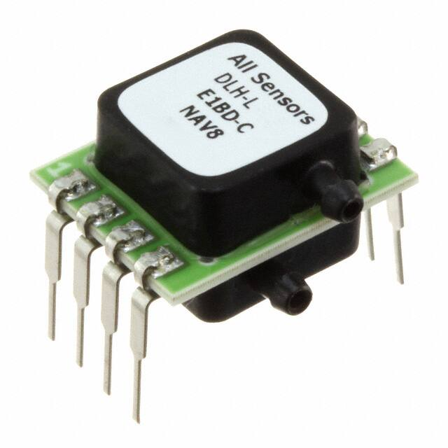

DLH-L05D-E1BD-C-NAV8
    AMPHENOL(安费诺)
    DIP-8
    SENSOR PRESSURE 5" H2O 18 BIT
DLH-L05D-E1BD-C-NAV8 数据手册
Proof Pressure Burst Pressure Nominal Span DLH-L05D ±5 inH2O 200 inH2O 300 inH2O ±0.4 * 224 counts DLH-L10D ±10 inH2O 200 inH2O 300 inH2O ±0.4 * 224 counts DLH-L20D ±20 inH2O 200 inH2O 500 inH2O ±0.4 * 2 counts DLH-L30D ±30 inH2O 200 inH2O 500 inH2O ±0.4 * 224 counts DLH-L60D ±60 inH2O 200 inH2O 800 inH2O ±0.4 * 224 counts DLH-L05G 0 to 5 inH2O 200 inH2O 300 inH2O 0.8 * 224 counts DLH-L10G 0 to 10 inH2O 200 inH2O 300 inH2O 0.8 * 2 counts DLH-L20G 0 to 20 inH2O 200 inH2O 500 inH2O 0.8 * 224 counts DLH-L30G 0 to 30 inH2O 200 inH2O 500 inH2O 0.8 * 224 counts DLH-L60G 0 to 60 inH2O 200 inH2O 800 inH2O 0.8 * 224 counts I2C SDA EOC Gnd 24 - OR Vs SCLK MISO MOSI /SS EOC Gnd Pressure Sensor Maximum Ratings 3.63 Vdc 10 psig 270 °C Temperature Ranges Compensated: Commercial Industrial Operating Storage Humidity Limits (non condensing) All Sensors 0°C to 70°C -20°C to 85°C -25°C to 85 °C -40°C to 125 °C 0 to 95% RH DS-0355 Rev B R Page 1 Signed Original O Lead Temperature (soldering 2-4 sec.) Environmental Specifications www.allsensors.com Original On File SCL SPI Common Mode Pressure R 24 Vs R Operating Range all sensors e www.allsensors.com Device Equivalent Circuit f 408 225 2079 Standard Pressure Ranges p 408 225 4314 These calibrated and compensated sensors provide accurate, stable output over a wide temperature range. This series is intended for use with non-corrosive, non-ionic working fluids such as air, dry gases and the like. A protective parylene coating is optionally available for moisture/harsh media protection. a 16035 Vineyard Blvd. Morgan Hill, CA 95037 R Signed Original On F Signed Original On File The digital interface options ease integration of the sensors into a wide range of process control and measurement systems, allowing direct connection to serial communications channels. For battery-powered systems, the sensors can enter very low-power modes between readings to minimize load on the power supply. Signed Original On File Signed Original On File The DLH Series Mini Digital Output Sensor is based on All Sensors’ CoBeam2 TM Technology. This reduces package stress susceptibility, resulting in improved overall long term stability and vastly improves the position sensitivity. R www.allsensors.com General Description www.allsensors.com R • Medical Breathing • Environmental Controls • HVAC • Industrial Controls • Portable/Hand-Held Equipment Signed Original On File www.allsensors.com Applications www.allsensors.com R www.allsensors.com • 5 to 60 inH2O Pressure Ranges • 1.68V to 3.6V Supply Voltage Range • I2C or SPI Interface (Automatically Selected) • Better than 0.25% Accuracy • High Resolution 16/17/18 bit Output R Features Supply Voltage (Vs) ors.com w.allsensors.com Signed Original On File DLH Series Low Voltage Digital Pressure Sensors R Signed Original On F All parameters are measured at 3.3V ±5% excitation and 25C unless otherwise specified (Note 9). Pressure measurements are with positive pressure applied to PORT B. Parameter Min Typ Max Units Output Span (FSS) LxxD LxxG - - ±0.4 * 2 0.8 * 224 24 - - Notes 1 Dec Count Dec Count Offset Output @ Zero Diff. Pressure (OSdig) - LxxD - 0.5 * 2 - Dec Count LxxG - 0.1 * 224 - Dec Count Total Error Band L01x, L02x - ±0.75 ±1.5 %FSS L05x, L10x, L20x, L30x, L60x - ±0.50 ±1.0 %FSS 2 Span Temperature Shift - ±0.25 - %FSS 3 Offset Temperature Shift - ±0.25 - %FSS 3 Offset Warm-up Shift - ±0.20 - %FSS 4 Offset Position Sensitivity (±1g) - ±0.10 - %FSS - Offset Long Term Drift (One Year) - ±0.30 - %FSS - R www.allsensors.com w.allsensors.com Signed Original On File Performance Characteristics for DLH Series - Commercial and Industrial Temperature Range Supply Current Requirement During Active State (ICCActive) - 1.5 2.0 mA During Idle State (ICCIdle) - 100 250 nA Power On Delay - - 2.5 ms (see table below) ms 5 5, 7 R Signed Original On File www.allsensors.com www.allsensors.com Data Update Time (tDU) 5, 7, 8 Signed Original On File Signed Original On File Temperature Output Resolution - 16 - bit Overall Accuracy - 2 - °C www.allsensors.com R - R Pressure Digital Resolution - No Missing Codes 16-bit Option 15.3 15.5 - bit 17-bit Option 16.3 16.5 - bit 18-bit Option 17.0 17.5 - bit Signed Original On File Linearity, Hysteresis Error 6 LxxD - ±0.25 - %FSS LxxG - ±0.10 - %FSS www.allsensors.com R 24 Original On File ors.com R Page 2 Signed Original O DLH Series Low Voltage Digital Pressure Sensors www.allsensors.com R See the following page for performance characteristics notes. Signed Original On F Symbol Min Typ Max Units Notes Input High Level - 80.0 - 100 % of Vs 5 Input Low Level - 0 - 20.0 % of Vs 5 Output Low Level - - - 10.0 % of Vs 5 I2C Pull-up Resistor - 1000 - - Ω 5 I2C Input Capacitance (each pin) �������� ��  The sensor Full Scale Span in inches H2O  For Gage Operating Range sensors:    Full Scale Pressure  For Differential Operating Range sensors:   2 x Full Scale Pressure.  e www.allsensors.com Is the specified digital offset   For Gage Operating Range sensors:    For Differential Operating Range sensors:    f 408 225 2079 0.1 * 224  0.5 * 224    Temperature Output Transfer Function      ����������� ��� � �       p 408 225 4314 Signed Original On File Signed Original On File �����    ������� ∗ 125 � � ��  2�� Where:  �������     The sensor 24‐bit digital temperature output.  (Note that only the upper 16 bits are significant)  Specification Notes 1: THE SPAN IS THE ALGEBRAIC DIFFERENCE BETWEEN FULL SCALE DECIMAL COUNTS AND THE OFFSET DECIMAL COUNTS. note 2: TOTAL ERROR BAND CONSISTS OF OFFSET AND SPAN TEMPERATURE AND CALIBRATION ERRORS, LINEARITY AND PRESSURE HYSTERESIS ERRORS, OFFSET note 3: SHIFT IS RELATIVE TO 25C. note 4: SHIFT IS WITHIN THE FIRST HOUR OF EXCITATION APPLIED TO THE DEVICE. note 5: PARAMETER IS CHARACTERIZED AND NOT 100% TESTED. note 6: MEASURED AT ONE-HALF FULL SCALE RATED PRESSURE USING BEST STRAIGHT LINE CURVE FIT. note 7: DATA UPDATE TIME IS EXCLUSIVE OF COMMUNICATIONS, FROM COMMAND RECEIVED TO END OF BUSY STATUS. THIS CAN BE OBSERVED AS EOC PIN note 8: AVERAGE CURRENT CAN BE ESTIMATED AS : ICCIdle + (tDU / Reading Interval) * ICCActive). REFER TO FIGURE 2 FOR ACTIVE AND IDLE CONDITIONS OF THE note 9: THE SENSOR IS CALIBRATED WITH A 3.3V SUPPLY HOWEVER, AN INTERNAL REGULATOR ALLOWS A SUPPLY VOLTAGE OF 1.68V TO 3.6V TO BE USED WARM-UP SHIFT, OFFSET POSITION SENSITIVITY AND LONG TERM OFFSET DRIFT ERRORS. LOW- STATE DURATION. SENSOR (THE ACTIVE STATE IS WHILE EOC PIN IS LOW). WITHOUT AFFECTING THE OVERALL SPECIFICATIONS. THIS ALLOWS DIRECT OPERATION FROM A BATTERY SUPPLY. All Sensors DS-0355 Rev B R Page 3 Signed Original O note www.allsensors.com Original On File www.allsensors.com Is the sensor 24‐bit digital output.    R R www.allsensors.com �������   ������� � ����� � � �������� �� 2�� Signed Original On File R ������������� �� � ��2� � � www.allsensors.com ors.com decimal Pressure Output Transfer Function Where:     41 R R I2C Address   CI2C_IN - - 10.0 pF 5 Signed Original On File    - - 200 pF 5 www.allsensors.com      CSDA all sensors I2C Load Capacitance on SDA, @ 400 kHz a 16035 Vineyard Blvd. Morgan Hill, CA 95037 www.allsensors.com Parameter R R w.allsensors.com Signed Original On File I2C / SPI Electrical Parameters for DLH Series R Signed Original On F Output Resolution Calibrated output resolution can be ordered to be 16, 17, or 18 bits. Higher resolution results in slower update times; see the Data Update Time in the Performance Characteristics table. Coating Parylene Coating: Parylene coating provides a moisture barrier and protection form some harsh media. Consult factory for applicability of Parylene for the target application and sensor type. R www.allsensors.com w.allsensors.com Signed Original On File Device Ordering Options Signed Original On File Signed Original On File www.allsensors.com R I/O Interface Configuration: The sensor automatically selects SPI or I2C serial interface, based on the following protocol: If the /SS input is set low by the host (as occurs during a SPI command transaction), the I/O interface will remain configured for SPI communications until power is removed. Otherwise, once a valid device address and command have been received over the I2C interface, the I/O interface will remain configured for I2C until power is removed. NOTE: The four-pin (SIP) packages only support the I2C interface. DLH Series Low Voltage Digital Pressure Sensors R Page 4 Signed Original O Original On File www.allsensors.com For optimum sensor performance, All Sensors recommends that Measurement commands be issued at a fixed interval by the host system. Irregular request intervals may increase overall noise on the output. Furthermore, if reading intervals are much slower than the Device Update Time, using the Averaging commands is suggested to reduce offset shift. This shift is constant with respect to time interval, and may be removed by the application. For longer fixed reading intervals, this shift may be removed by the factory on special request. www.allsensors.com R After completion of the measurement, the result may then be read using the Data Read command. The ADC and DSP remain in Idle state, and the I/O block returns the 7 bytes of status and measurement data. See Figure 2, following. At any time, the host may request current device status with the Status Read command. See Table 1 for a summary of all commands. R Sensor Commands: Five Measurement commands are supported, returning values of either a single pressure / temperature reading or an average of 2, 4, 8, or 16 readings. Each of these commands wakes the sensor from Idle state into Active state, and starts a measurement cycle. For the Start-Average commands, this cycle is repeated the appropriate numper of times, while the Start-Single command performs a single iteration. When the DSP has completed calculations and the new values have been made available to the I/O block, the sensor returns to Idle state. The sensor remains in this low-power state until another Measurement command is received. Signed Original On File The DSP receives the converted pressure and temperature information and applies a multi-order transfer function to compensate the pressure output. This transfer function includes compensation for span, offset, temperature effects on span, temperature effects on offset and second order temperature effects on both span and offset. There is also linearity compensation for gage devices and front to back linearity compensation for differential devices. R The ADC performs conversions on the raw sensor signal (P), the temperature reference (T) and a zero reference (Z) during the ADC measurement cycle. www.allsensors.com ors.com Figure 1 - DLH Essential Model Signed Original On File The DLH is a digital sensor with a signal path that includes a sensing element, a variable- bit analog to digital converter, a DSP and an IO block that supports either an I2C or SPI interface (see Figure 1 below). The sensor also includes an internal temperature reference and associated control logic to support the configured operating mode. Since there is a single ADC, there is also a multiplexer at the front end of the ADC that selects the signal source for the ADC. www.allsensors.com R Operation Overview R Signed Original On F Figure 2 - DLH Communication Model Start-Single Command Command Start-Single Internal State Idle Interal Operation Idle Data Read Active Start-Single Active Idle ADC (Temp, Zero, Pressure) Idle DSP ADC (Temp, Zero, Pressure) Idle Idle DSP R www.allsensors.com w.allsensors.com Signed Original On File Operation Overview New Data Available EOC Interal Operation Idle Active ADC (Temp, Zero, Pressure)1 ADC (Temp, Zero, Pressure)n DSP Start-Average2/4/8/16 Idle Active Idle ADC (T, Z, P)… New Data Available EOC When requesting the start of a measurement, the command length for I2C is 1 byte, for SPI it is 3 bytes. When requesting sensor status over I2C, the host simply performs a 1-byte read transfer. When requesting sensor status over SPI, the host must send the Status Read command byte while reading 1 byte. When reading sensor data over I2C, the host simply performs a 7-byte read transfer. When reading sensor data over SPI, the host must send the 7-byte Data Read command while reading the data. SENDING UNDOCUMENTED COMMANDS TO SENSOR WILL CORRUPT CALIBRATION AND IS NOT COVERED BY WARRANTY. p 408 225 4314 0x00 0xAA 0xAC 0x00 0x00 0xAC Start-Average4 0xAD 0x00 0x00 0xAD Start-Average8 0xAE 0x00 0x00 0xAE Start-Average16 0xAF 0x00 0x00 0xAF Read Sensor Data I2C Read of 7 bytes from device Read of 7 bytes from device SPI Host must send [0xF0], then 6 bytes of [0x00] on MOSI Sensor Returns 7 bytes on MISO Read Sensor Status I2C Read of 1 byte from device. Read of 1 byte from device SPI Host must send [0xF0] on MOSI Sensor Returns 1 byte on MISO All Sensors DS-0355 Rev B R Page 5 Signed Original O Original On File 0x00 Start-Average2 a 16035 Vineyard Blvd. Morgan Hill, CA 95037 Signed Original On File R 0xAA I2C ( 1 byte) R www.allsensors.com Start-Single SPI ( 3 bytes ) www.allsensors.com R Description Signed Original On File Measurement Commands www.allsensors.com f 408 225 2079 See Table 1 below for Measurement Commands, Sensor Data read and Sensor Status read details. e www.allsensors.com Digital Interface Command Formats Table 1 - DLH Sensor Command Set ors.com all sensors Idle R Signed Original On File Data Read Start-Average2/4/8/16 Signed Original On File www.allsensors.com Command Internal State www.allsensors.com R Start-Average2 / 4 / 8 / 16 Commands (Auto Averaging) R Signed Original On F For either type of digital interface, the format of data returned from the sensor is the same. The first byte consists of the Status Byte followed by a 24-bit unsigned pressure value and a 24-bit unsigned temperature value. Unused bits beyond the calibrated bit width are undefined, and may have any value. See the Pressure Output Transfer Function and Temperature Output Transfer Function definitions on page 3 for converting to pressure and temperature. Refer to Table 2 for the overall data format of the sensor. Table 3 shows the Status Byte definition. Note that a completed reading without error will return status 0x40. R www.allsensors.com w.allsensors.com Signed Original On File Digital Interface Data Format Signed Original On File P[15:8] Pressure Byte 1 P[7:0] Pressure Byte 0 T[23:16] Temperature Byte 3 T[15:8] Temperature Byte 1 T[7:0] Temperature Byte 0 Table 3- Status Byte Definition Bit Bit 7 [MSB] 6 5 4:3 2 1 Bit 0 [LSB] Description [Always = 0] Power : [1 = Power On] Busy: [ 1 = Processing Command, 0 = Ready] Mode: [00 = Normal Operation ] Memory Error [ 1 = EEPROM Checksum Fail] Sensor Configuration [ always = 0] ALU Error [1 = Error] R www.allsensors.com P[23:16] Pressure Byte 3 Signed Original On File S[7:0] Status Byte www.allsensors.com R Table 2 - Output Data Format Signed Original On File Original On File www.allsensors.com R R Page 6 Signed Original O DLH Series Low Voltage Digital Pressure Sensors www.allsensors.com ors.com DO NOT SEND COMMANDS TO SENSOR OTHER THAN THOSE DEFINED IN TABLE 1. R The part enters Idle state after power-up, and waits for a command from the bus master. Any of the five Measurement commands may be sent, as shown in Table 1. Following receipt of one of these command bytes, the EOC pin is set to Low level, and the sensor Busy bit is set in the Status Byte. After completion of measurement and calculation in the Active state, compensated data is written to the output registers, the EOC pin is set high, and the processing core goes back to Idle state. The host processor can then perform the Data Read operation, which for I2C is simply a 7-byte Device Read. If the EOC pin is not monitored, the host can poll the Status Byte by repeating the Status Read command, which for I2C is a one-byte Device Read. When the Busy bit in the Status byte is zero, this indicate that valid data is ready, and a full Data Read of all 7 bytes may be performed. Signed Original On File I2C Command Sequence www.allsensors.com R I2C Interface 1. Measurement Commands: Start-Single ( to start reading of single sample): Start-Single C7…C0: 0xAA Start-Average2 C7…C0: 0xAC Start-Average4 C7…C0: 0xAD Start-Average8 C7…C0: 0xAE Start-Average16 C7…C0: 0xAF ST A6 A5 A4 A3 A2 A1 A0 W I ST A6 A5 A4 A3 A2 A1 A0 R I ST A6 A5 A4 A3 A2 A1 A0 R A C7 … C0 N SP I SP I 2. Status Read: Set by bus master: Set by sensor: A S7 … S0 N 3. Data Read: Set by bus master: Set by sensor: Idle: Start: Stop: Ack: Nack: “Read” bit (1): “Write” bit (0): I ST SP A N R W Sensor Address: A6 … A0 Default: 0x78 A S7 … S0 A A P23 … P16 A P15 … P8 A P7 … P0 A T23 … T16 A T15 … T8 N SP I T7 … T0 Data bits: Status: Pressure data: Temperature data: S7 … S0 P23 … P0 T23 … T0 Command Bits: C7 … C0 All Sensors DS-0355 Rev B R Page 7 Signed Original O Original On File I R Set by bus master: Set by sensor: www.allsensors.com R all sensors Figure 3 - I2C Communication Diagram Signed Original On File f 408 225 2079 STOP condition (P): LOW to HIGH transition of the SDA line while clock (SCL) is HIGH indicates a STOP condition. STOP conditions are always generated by the master. Bus states: ors.com e www.allsensors.com DATA valid (Dn): State of data line represents valid data when, after a START condition, data line is stable for duration of HIGH period of clock signal. Data on line must be changed during LOW period of clock signal. There is one clock pulse per data bit. p 408 225 4314 Signed Original On File Acknowledge (A or N): Data is transferred in units of 8 bits (1 byte) at a time, MSB first. Each data-receiving device, whether master or slave, is required to pull the data line LOW to acknowledge receipt of the data. The Master must generate an extra clock pulse for this purpose. If the receiver does not pull the data line down, a NACK condition exists, and the slave transmitter becomes inactive. The master determines whether to send the last command again or to set the STOP condition, ending the transfer. www.allsensors.com Signed Original On File Slave address (An): The I²C-bus requires a unique address for each device. The DLH sensor has a preconfigured slave address (see specification table on Page 3). After setting a START condition the master sends the address byte containing the 7 bit sensor address followed by a data direction bit (R/W). A “0” indicates a transmission from master to slave (WRITE), a “1” indicates a device-to master request (READ). a 16035 Vineyard Blvd. Morgan Hill, CA 95037 Signed Original On F R www.allsensors.com R START condition (ST): A HIGH to LOW transition of SDA line while the clock (SCL) is HIGH is interpreted as START condition. START conditions are always set by the master. Each initial request for a pressure value has to begin with a START condition. R www.allsensors.com Bus not Busy (I): During idle periods both data line (SDA) and clock line (SCL) remain HIGH. Signed Original On File R The I2C interface uses a set of signal sequences for communication. The following is a description of the supported sequences and their associated mnemonics. Refer to Figure 3 for the associated usage of the following signal sequences. R I2C Bus Communications Overview www.allsensors.com www.allsensors.com w.allsensors.com Signed Original On File I2C Interface (Cont’d) Signed Original On F R www.allsensors.com Signed Original On File The sequence of bits and bus signals are shown in the following illustration (Figure 4). Refer to Figure 5 in the Interface Timing Diagram section for detailed timing data. Figure 4 - SPI Communications Diagram Measurement Command SCLK --First Command Byte (0xAA / 0xAC / 0xAD / 0xAE / 0xAF) MOSI XXXX C23 C22 C21 MISO HI-Z S7 S6 S5 Lower Command Bytes (0x00 0x00) C20 C19 C18 C17 C16 C 15 S4 S3 S2 S1 S0 XX ----- S7 … S0 (Status) XX XX HI-Z --- Read Status Command SCLK Command (0xF0) MOSI Don't Care 1 1 1 MISO Hi-Z S7 S6 S5 1 0 0 0 0 S4 S3 S2 S1 S0 Don't care Hi-Z S7 … S0 (Status) SS Data Read Command SCLK --- --- R Signed Original On File Signed Original On File XXXX www.allsensors.com R C0 (Undefined Data) SS www.allsensors.com C1 R R SPI Bus Communications Overview Signed Original On File As with the I2C interface configuration, the part enters Idle state after power-up, and waits for a command from the SPI master. To start a measurement cycle, one of the 3- byte Measurement Commands (see Table 1) must be issued by the master. The data returned by the sensor during this command request consists of the Status Byte followed by two undefined data bytes. On successful decode of the command, the EOC pin is set Low as the core goes into Active state for measurement and calculation. When complete, updated sensor data is written to the output registers, and the core goes back to the Idle state. The EOC pin is set to a High level at this point, and the Busy status bit is set to 0. At any point during the Active or Idle periods, the SPI master can request the Status Byte by sending a Status Read command (a single byte with value 0xF0). As with the I2C configuration, a Busy bit of value 0 in the Status Byte or a high level on the EOC pin indicates that a valid data set may be read from the sensor. The Data Read command must be sent from the SPI master (The first byte of value 0xF0 followed by 6 bytes of 0x00). NOTE: Sending commands that are not defined in Table 1 will corrupt sensor operation. R SPI Command Sequence www.allsensors.com www.allsensors.com w.allsensors.com Signed Original On File SPI Interface Original On File 1 1 0 0 0 0 MISO Hi-Z S7 S6 S5 S4 S3 S2 S1 S0 S7 … S0 (Status) SS 0 0 P23 P22 --- 0 0 --- P1 P0 0 0 T23 T22 --- 0 0 Don't Care --- T1 T0 Hi-Z P23…P0 (Pressure) T23…T0 (Temperature) --- --- DLH Series Low Voltage Digital Pressure Sensors Page 8 R ors.com 1 Signed Original O MOSI 1 www.allsensors.com R Command (0xF0 then 6 bytes of 0x00) Don't Care tSSCLK (HI•Z) tSSSO tDSU all sensors don't care (don't care) tDH SS tSSZ tCLKSS SYMBOL fSCLK tSSCLK tSSSO tCLKD tLOW tHIGH tDSU tDH tCLKSS tSSZ tIDLE MIN 0.05 120 -8 100 100 50 50 0 -250 TYP - MAX 5 20 32 20 - UNITS MHz ns ns ns ns ns ns ns ns ns ns tSUS TA PARAMETER SCL frequency SCL low width SCL high width Start condition setup Start condition hold Data setup to clock Data hold to clock Stop condition setup Bus idle time f 408 225 2079 tSUDAT SYMBOL fSCL tLOW tHIGH tSUSTA tHSTA tSUDAT tHDAT tSUSTP tIDLE All Sensors p 408 225 4314 tH DAT MIN 100 1.3 0.6 0.6 0.6 0.1 0 0.6 2.0 tSUS TP TYP - tIDLE MAX 400 - a 16035 Vineyard Blvd. Morgan Hill, CA 95037 Signed Original On File SDA UNITS KHz us us us us us us us us DS-0355 Rev B Page 9 R Original On File SCL R www.allsensors.com tLOW Signed Original O R tHIGH www.allsensors.com ors.com tH STA Signed Original On File Figure 6 - I2C Timing Diagram www.allsensors.com R (1) Maximum by design, tested to 1.0 MHz. R PARAMETER SCLK frequency (1) SS low to first clock edge SS low to serial out Clock to data out SCLK low width SCLK high width Data setup to clock Data hold after clock Last clock to rising SS SS high to output hi-Z Bus idle time tIDLE Signed Original On File Signed Original On File MOSI (HI•Z) www.allsensors.com R tHIGH SCLK MISO www.allsensors.com tLOW tCLKD e www.allsensors.com R Signed Original On F Figure 5 - SPI Timing Diagram R www.allsensors.com w.allsensors.com Signed Original On File Interface Timing Diagrams R Signed Original On F Refer to Table 4 for configuring a standard base part number which includes the pressure range, package and temperature range. Table 5 shows the available configuring options. The option identifier is required to complete the device part number. Refer to Table 6 for the available device packages. Example P/N with options: DLH-L05D-E1NS-C-NAV6 Table 4 - How to configure a base part SERIES PRESSURE RANGE ‐ E ORDERING INFORMATION Port Orientation Description Dual Port Same Side Dual Port Opposite Side 1   ID N B PACKAGE Lid Style Description Non‐Barbed Barbed TEMPERATURE RANGE ID S D J N Lead Type Description SIP DIP J‐Lead SMT S ID C I ‐ Description Commercial Industrial C Table 5 - How to configure an option identifier ORDERING  INFORMATION Signed Original On File www.allsensors.com DLH ‐ L05D ID 1 2 COATING ID Description N No Coating P Parylene Coating (1) Example  N INTERFACE ID Description A Auto I2C/SPI SUPPLY VOLTAGE ID Description V 1.68V to 3.6V A V ID 6 7 8 RESOLUTION Description 16 Bit 17 bit 18 bit R Example Base ID E Description ±5 inH2O ±10 inH2O ±20 inH2O ±30 inH2O ±60 inH2O 0 to 5 inH2O 0 to 10 inH2O 0 to 20 inH2O 0 to 30 inH2O 0 to 60 inH2O Signed Original On File ID L05D L10D L20D L30D L60D L05G L10G L20G L30G L60G www.allsensors.com R ID DLH R www.allsensors.com w.allsensors.com Signed Original On File How to Order 6 Signed Original On File J Lead SMT Dual Port  Same Side SIP (1) DIP N/A E1NS E1ND E1NJ Dual Port  Opposite Side Single Port  (Gage) Low Profile DIP E1BS E2ND E2NJ N/A N/A N/A N/A Low Profile DIP N/A N/A N/A N/A N/A N/A E1BD N/A E2NS J Lead SMT E2BS E2BD N/A N/A (1) SPI is not available in SIP packages (1) SPI is not available in SIP packages DLH Series Low Voltage Digital Pressure Sensors Page 10 R Original On File DIP R www.allsensors.com SIP (1) Barbed Lid Lead Style Signed Original O R Non‐Barbed Lid Lead Style www.allsensors.com ors.com Port  Orientation Signed Original On File Table 6 - Available E-Series Package Configurations www.allsensors.com R (1) Parylene coating not offered on J‐Lead Configurations Pinout 1) Gnd 2) Vs 3) SDA 4) SCL 2.04 0.080 2.54 0.100 Pin 1 2 3 4 NOTES 1)Dimensions are in inches [mm] 2)For suggested pad layout, see drawing: PAD-01 E1BS Package Pinout 1.14 0.045 Port B 1.68 0.066 10.80 0.425 15.75 0.620 10.80 0.425 0.25 0.010 Port A 2.73 0.107 [9.65] 0.380 (nom) 6.45 0.254 9.80 0.386 www.allsensors.com 0.64 0.025 2.11 0.083 12.70 0.500 4.88 0.192 0.51 0.020 2.54 0.100 Original On File DS-0355 Rev B Page 11 R ors.com All Sensors Signed Original O NOTES 1)Dimensions are in inches [mm] 2)For suggested pad layout, see drawing: PAD-01 www.allsensors.com R Pin 1 2 3 4 R Signed Original On File 9.15 0.360 Signed Original On File 1) Gnd 2) Vs 3) SDA 4) SCL www.allsensors.com R e www.allsensors.com 0.51 0.020 a 16035 Vineyard Blvd. Morgan Hill, CA 95037 0.25 0.010 f 408 225 2079 10.79 0.425 Port A 2.73 0.107 [9.65] 0.380 (nom) 6.45 0.254 9.80 0.386 15.75 0.620 Port B all sensors 2.10 0.082 p 408 225 4314 10.79 0.425 R Signed Original On File 0.64 0.025 Signed Original On File www.allsensors.com 12.70 0.500 4.88 0.192 www.allsensors.com R 7.17 0.282 2.24 0.088 R Signed Original On F E1NS Package R www.allsensors.com w.allsensors.com Signed Original On File Package Drawings 12.70 0.500 10.79 0.425 Port A 2.10 0.082 2.04 0.080 10.79 0.425 [9.65] 0.380 (nom) 2.73 0.107 15.75 0.620 Port B 0.25 0.010 2.54 0.100 0.51 0.020 Pin 1 2 3 4 NOTES 1)Dimensions are in inches [mm] 2)For suggested pad layout, see drawing: PAD-01 2.12 0.084 Port B 2.73 0.107 1.68 0.066 10.80 0.425 15.75 0.620 [9.65] 0.380 (nom) 9.80 0.386 1.14 0.045 10.80 0.425 Port A 0.25 0.010 2.11 0.083 12.70 0.500 2.24 0.088 9.15 0.360 0.64 0.025 0.51 0.020 2.54 0.100 R Signed Original On File 1) Gnd 2) Vs 3) SDA 4) SCL Signed Original On File www.allsensors.com Pinout www.allsensors.com R E2BS Package R Signed Original On File 7.17 0.282 0.64 0.025 2.12 0.084 9.80 0.386 Signed Original On F R www.allsensors.com 1) Gnd 2) Vs 3) SDA 4) SCL Signed Original On File R Pinout R E2NS Package www.allsensors.com www.allsensors.com w.allsensors.com Signed Original On File Package Drawings (Cont’d) Original On File Page 12 R ors.com DLH Series Low Voltage Digital Pressure Sensors Signed Original O NOTES 1)Dimensions are in inches [mm] 2)For suggested pad layout, see drawing: PAD-01 www.allsensors.com R Pin 1 2 3 4 Pinout 2.10 0.082 Pin 1 2 3 4 0.46 0.018 5.72 0.225 www.allsensors.com 0.64 0.025 1.14 0.045 10.80 0.425 NOTES 1) Dimensions are in inches [mm] 2) For suggested pad layout, see drawing: PAD-03 All Sensors 1.68 0.066 10.80 0.425 15.75 0.620 16 0.630 6.45 0.254 8.89 0.350 (min) Port A 2.73 0.107 0.25 0.010 1.48 0.058 9.80 0.386 Port B 2.54 0.100 Pin 1 2 3 4 DS-0355 Rev B Page 13 R Original On File 2.11 0.083 Signed Original O R 12.70 0.500 4.88 0.192 R Pin 8 7 6 5 9.15 0.360 www.allsensors.com ors.com 1) Gnd 2) Vs 3) SDA/MOSI 4) SCL/SCLK 5) EOC 6) MISO 7) Not Connected 8) /SS Signed Original On File Signed Original On File Pinout www.allsensors.com R E1BD Package f 408 225 2079 2.73 0.107 2.54 0.100 8.89 0.350 (min) e www.allsensors.com 2.04 0.080 10.79 0.425 15.75 0.620 6.45 0.254 Port A p 408 225 4314 NOTES 1) Dimensions are in inches [mm] 2) For suggested pad layout, see drawing: PAD-03 0.25 0.010 1.48 0.058 9.80 0.386 16 0.630 Port B all sensors 10.79 0.425 a 16035 Vineyard Blvd. Morgan Hill, CA 95037 0.64 0.025 12.70 0.500 4.88 0.192 R Signed Original On File Pin 8 7 6 5 7.17 0.282 Signed Original On File www.allsensors.com 5.72 0.225 www.allsensors.com R 0.46 0.018 1) Gnd 2) Vs 3) SDA/MOSI 4) SCL/SCLK 5) EOC 6) MISO 7) Not Connected 8) /SS 2.24 0.088 R Signed Original On F E1ND Package R www.allsensors.com w.allsensors.com Signed Original On File Package Drawings (Cont’d) Pinout 1) Gnd 2) Vs 3) SDA/MOSI 4) SCL/SCLK 5) EOC 6) MISO 7) Not Connected 8) /SS 0.46 0.018 10.79 0.425 Port A 2.10 0.082 8.89 0.350 (min) 2.04 0.080 10.79 0.425 2.73 0.107 15.75 0.620 0.25 0.010 9.80 0.386 16 0.630 Port B 1.48 0.058 Signed Original On File 12.70 0.500 2.12 0.084 2.54 0.100 NOTES 1) Dimensions are in inches [mm] 2) For suggested pad layout, see drawing: PAD-03 Pin 1 2 3 4 0.46 0.018 2.12 0.084 1.68 0.066 10.80 0.425 Port B 2.73 0.107 15.75 0.620 16 0.630 0.25 0.010 9.80 0.386 1.48 0.058 NOTES 1) Dimensions are in inches [mm] 2) For suggested pad layout, see drawing: PAD-03 8.89 0.350 (min) 1.14 0.045 10.80 0.425 Port A 2.11 0.083 2.54 0.100 Pin 1 2 3 4 DLH Series Low Voltage Digital Pressure Sensors Page 14 R Original On File 12.70 0.500 0.64 0.025 Signed Original O R Pin 8 7 6 5 9.15 0.360 R Signed Original On File 5.72 0.225 www.allsensors.com ors.com 1) Gnd 2) Vs 3) SDA/MOSI 4) SCL/SCLK 5) EOC 6) MISO 7) Not Connected 8) /SS Signed Original On File www.allsensors.com Pinout www.allsensors.com R E2BD Package R www.allsensors.com Pin 8 7 6 5 0.64 0.025 Signed Original On File 7.17 0.282 www.allsensors.com R 5.72 0.225 2.24 0.088 R Signed Original On F E2ND Package R www.allsensors.com w.allsensors.com Signed Original On File Package Drawings (Cont’d) 1.27 0.050 2.54 0.100 Pin 1 2 3 4 NOTES 1)Dimensions are in inches [mm] 2)For suggested pad layout, see drawing: PAD-10 2.12 0.084 2.10 0.082 12.70 0.500 10.79 0.425 Port A 0.64 0.025 2.04 0.080 10.79 0.425 16 0.630 A 2.73 0.107 DETAIL A SCALE 4 : 1 9.80 0.386 1.51 0.059 3.94 0.155 0.81 R0.032 15.75 0.620 Port B 0.25 0.010 1.27 0.050 2.54 0.100 Original On File ors.com R Page 15 Signed Original O DS-0355 Rev B www.allsensors.com R Pin 1 2 3 4 NOTES 1)Dimensions are in inches [mm] 2)For suggested pad layout, see drawing: PAD-10 All Sensors all sensors Pin 8 7 6 5 7.17 0.282 R Signed Original On File 1) Gnd 2) Vs 3) SDA/MOSI 4) SCL/SCLK 5) EOC 6) MISO 7) Not Connected 8) /SS Signed Original On File www.allsensors.com Pinout www.allsensors.com R E2NJ Package e www.allsensors.com A f 408 225 2079 15.75 0.620 2.04 0.080 Port A 2.73 0.107 DETAIL A SCALE 4 : 1 6.45 0.254 9.80 0.386 3.94 0.155 0.81 R0.032 10.79 0.425 Port B 0.25 0.010 p 408 225 4314 2.10 0.082 10.79 0.425 a 16035 Vineyard Blvd. Morgan Hill, CA 95037 0.64 0.025 12.70 0.500 4.88 0.192 R Signed Original On File Pin 8 7 6 5 7.17 0.282 1.51 0.059 Signed Original On F R www.allsensors.com 1) Gnd 2) Vs 3) SDA/MOSI 4) SCL/SCLK 5) EOC 6) MISO 7) Not Connected 8) /SS Signed Original On File R Pinout R E1NJ Package www.allsensors.com www.allsensors.com w.allsensors.com Signed Original On File Package Drawings (Cont’d) 2.54 0.100 (typ.) 2.54 0.100 (typ.) 1.27 0.050 2.54 0.100 (typ.) Signed Original On F R www.allsensors.com Signed Original On File PAD-10 Product Labeling All Sensors DLH-L05D E1NS-C NAV6 R16J21-14 Company Part Number Lot Number www.allsensors.com Example Device Label Original On File www.allsensors.com R ors.com R Page 16 Signed Original O DLH Series Low Voltage Digital Pressure Sensors www.allsensors.com All Sensors reserves the right to make changes to any products herein. All Sensors does not assume any liability arising out of the application or use of any product or circuit described herein, neither does it convey any license under its patent rights nor the rights of others. R Signed Original On File Signed Original On File PAD-03 PAD-01 14.99 0.590 R R 16 0.630 Signed Original On File www.allsensors.com 2.29 0.090 R 0.035~0.039 inch (Finish Size) 0.035~0.039 inch (Finished Size) www.allsensors.com R w.allsensors.com Signed Original On File Suggested Pad Layout
