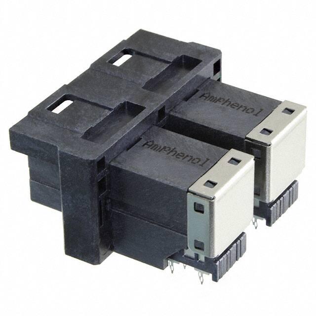

Mini-SAS HD (Internal) Features: tSFF-8643 compliance t.FFUTSAS 3.0 (12Gbps) electrical performance t0.75mm pitch connector system tImproved signal integrity & minimized cross-talk tEliminates need for mechanical key tPinouts map easily with existing Mini SAS product tPress-fit pin design provides one step placement onto PCB Overview: Amphenol’s Mini-SAS High Density connector system is the next generation SAS system that provides faster data rates and more bandwidth. It provides double the port density of current Mini-SAS connectors with 1X1 (4x), 1X2 (8x) and 1X4 (16x) port options. The Mini-SAS HD connector system has a two-row, right-angle connector with 12Gbps of data rate per channel. Each connector (port) handles 4 lanes of data rate for up to 48Gbps. of total bandwidth. Applications: t.FEJDBM t5FMFDPN t/FUXPSLJOH t4FSWFS t4UPSBHF To learn more about Mini-SAS HD connectors: web: amphenolcanada.com email: sales@amphenolcanada.com t5FTU*OEVTUSJBM Mini-SAS HD (Internal) Technical Characteristics: Mechanical Electrical 0.5A max. per contact Operating Current 307 AC(rms)/DC max. Operating Voltage 3007 DC DWV 1000MΩ min. Insulation Resistance 100Ω ±10Ω Differential Impedance Mating Force Unmating Force Durability 100/ max. 50/ max. 250 cycles Series ConĮguraƟon Type TerminaƟon Style Impedance Spec Port Wall Version G40H11 G40H12 G40H13 G40HA1 G40HA2 G40HA3 G40H21 G40H22 G40H31 G40H32 G40H41 G40H42 G40HB1 G40HB2 G40HC1 G40HC2 G40HD1 G40HD2 Right Angle Right Angle Right Angle Right Angle Right Angle Right Angle Press Fit Press Fit Press Fit Press Fit Press Fit Press Fit 100 ohm 100 ohm 100 ohm 85 ohm 85 ohm 85 ohm Single Single Single Single Single Single VerƟcal SMT 100 ohm VerƟcal SMT 100 ohm VerƟcal SMT 100 ohm VerƟcal SMT 85 ohm VerƟcal SMT 85 ohm VerƟcal SMT 85 ohm 1x1 1x2 1x4 1x1 1x2 1x4 1x1 1x2 1x1 1x2 1x1 1x2 1x1 1x2 1x1 1x2 1x1 1x2 Dimensions: Single Dual Four Single Dual Four All drawings are measured in inches (mm). * Please visit amphenolcanada.com to find drawings for other products in this series. To learn more about Mini-SAS HD connectors: web: amphenolcanada.com email: sales@amphenolcanada.com
G40H12331HR
物料型号:Mini-SAS HD
器件简介: - 符合SFF-8643标准 - 满足SAS 3.0 (12Gbps)电气性能 - 0.75mm间距连接器系统 - 提升信号完整性,最小化串扰 - 无需机械键 - 引脚分配与现有Mini SAS产品容易对应 - 压接针设计,一步放置到PCB
引脚分配:文档中未明确列出具体的引脚分配图,但提到引脚分配容易与现有Mini SAS产品对应。
参数特性: - 操作电流:每个接触点最大0.5A - 操作电压:最大30V AC(rms)/DC - 介电强度:300V DC - 绝缘电阻:最小1000MΩ - 差分阻抗:100 ±10Ω
功能详解: - 提供更快的数据速率和更多带宽 - 提供1X1 (4x),1X2 (8x)和1X4 (16x)端口选项 - 每个连接器(端口)处理4个数据通道,总带宽高达48Gbps
应用信息: - 医疗、电信、网络、服务器、存储、测试和工业领域
封装信息: - 提供了多种配置类型、端接样式、阻抗规格、端口和壁版本 - 例如,G40H11是直角、压接、100欧姆阻抗、1x1端口、单壁版本 - 垂直安装的SMT端接也有多种选择,包括单壁、双壁和四壁版本
