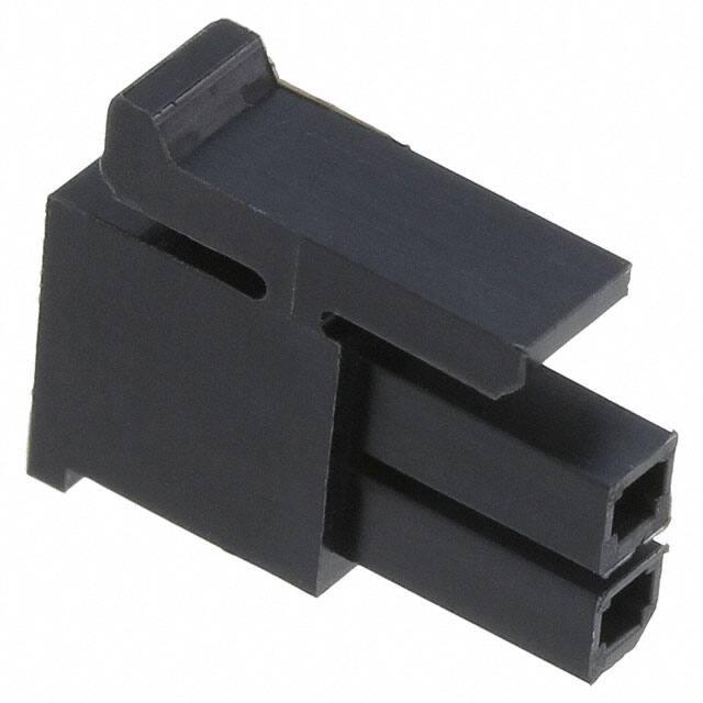

Micro Power 3.0 Connector System - G881 Series MICRO POWER CARRIES 6.5A PER PIN FOR WIRE-TO-BOARD APPLICATIONS Micro Power 3.0 connector system is a 3.00mm pitch power connector designed for wire-to-board applications. It is mainly used for power applications and supports current rating up to 6.5A per pin and wire gauge range from 3020AWG. It comes in 2 to 24 circuits for dual row and 2-12 circuits for single row. Low insertion force and BMI (Blind Mating) versions are also available. §§Current rating up to 6.5A per pin §§2 to 24 circuits for dual row and 2-12 circuits for single TARGET MARKETS row §§BMI and Low insertion force type available §§Boardlock, SMT, Through hole termination options available FEATURES BENEFITS §§Compact power connector with current rating of 6.5A per §§Certified by EIA (Energy Information Administration) and pin §§Single and dual row option §§Through hole and SMT option UL §§Different configurations to meet a variety of application needs §§Scoop-proof housings §§Prevents mismating between header and receptacle §§Fully isolated pins §§Protects contacts against potential damage during handling and mating §§High temperature LCP housing meets UL94V-0 §§Meet safety requirements and able to withstand high temperatures www.amphenol-icc.com Amphenol Information Communications and Commercial Products Micro Power 3.0 Connector System - G881 Series TECHNICAL INFORMATION MATERIAL PACKAGING §§ Housing: High Temperature Thermoplastic, §§ Tape and Reel complies with UL 94V-0, Black and natural option §§ Contact: Copper alloy, selective gold plating on contact area, 100u” tin plated on soldering tail, 50u” min nickel under-plated overall MECHANICAL PERFORMANCE §§ Insertion Force: 8N max. per pin §§ Extraction Force: 2N min. per pin §§ Terminal Retention force in Housing for cable §§ Tray APPROVALS AND CERTIFICATIONS §§ UL §§ EIA SPECIFICATION §§ Amphenol Product Specification: PS-7381 TARGET MARKETS/APPLICATIONS assembly: 24.5N min. ELECTRICAL PERFORMANCE Telecommunications §§ Current Rating: 6.5A per contact §§ Contact Resistance: 30mΩ §§ Voltage: 250V AC ENVIRONMENTAL §§ Humidity: §§ Contact Resistance Drone Data Center Server Storage Industrial §§ R=+20mΩ max. §§ Thermal Aging: §§ No evidence of damage Medical §§ Contact Resistance §§ R=+20mΩ max. §§ Salt Spray: §§ Contact Resistance §§ R=+20mΩ max. §§ Cold Resistance: §§ R=+20mΩ max. www.amphenol-icc.com Disclaimer Please note that the above information is subject to change without notice. Micro Power 3.0 Connector System - G881 Series PART NUMBERS Pitch Part Numbers Micro Power, Header Straight Dip type 3.0 mm G881AXX1X1EU Micro Power, Header Straight Dip type 3.0 mm G881AXX1X2CEU Micro Power, Header Straight Dip type 3.0 mm G881AXX1X2T1EU Micro Power, Header Straight Dip type 3.0 mm G881AXX1X2T3EU Micro Power, Header Straight Dip type 3.0 mm G881AXX1X2T4EU Micro Power, Header Right Angle Dip type 3.0 mm G881AXX0X1C2EU Micro Power, Header Right Angle Dip type 3.0 mm G881AXX0X1TEU Micro Power, Header Right Angle Dip type 3.0 mm G881AXX0X1TRCEU Micro Power, Header Right Angle Dip type 3.0 mm G881AXX0X1TXEU Micro Power, Header Right Angle Dip type 3.0 mm G881AXX001CEU Micro Power, Cable Housing 3.0 mm G881HXX22CEU Micro Power, Cable Terminal 3.0 mm G881C0X32CEU CMIOMICROPWR1017EA4 Description www.amphenol-icc.com Disclaimer Please note that the above information is subject to change without notice.

物料型号: - G881AXX102TEU: Micro Power直插板载焊片,3.00mm间距 - G881AXX102T3EU: Micro Power直插DIP无弯折,3.00mm间距 - G881BXX102KEU: Micro Power直插S/R带弯折型 - G88MPBXX002C1EU: Micro Power Plus双排DIP型 - G88MPXX102CEU: Micro Power Plus直插DIP型 - G88MPXX102KEU: Micro Power Plus直插DIP带弯折型 - G874DXX1202CEU: Mini Power 4.2mm间距直插DIP型 - G881CO232CEU: Micro Power端子,3.0mm间距
器件简介: - Micro Power和Mini Power系列提供小型化、高电流和高密度的电源连接器解决方案。 - Micro Power Plus提供更高的电流承载能力。
引脚分配: - 提供2至24个电路的选项。
参数特性: - Micro Power:最大插入力8N/引脚,最小提取力3.7N/引脚,接触保持力24.5N最小。 - Mini Power:最大插入力15N/引脚,最小提取力1N/引脚,接触保持力20N最小。 - Micro Power和Mini Power的电流额定值分别为5A和9A。
功能详解: - 提供正向锁定的外壳以防止意外断开。 - 极化外壳/插座以防止意外错误配对。 - 端子完全隔离,提供锡和金的接触区域镀层。
应用信息: - 适用于航空、军事、商业、医疗、通信/数据、安全系统等领域。
封装信息: - 提供高温LCP外壳,符合94V-0和94V-2标准。
