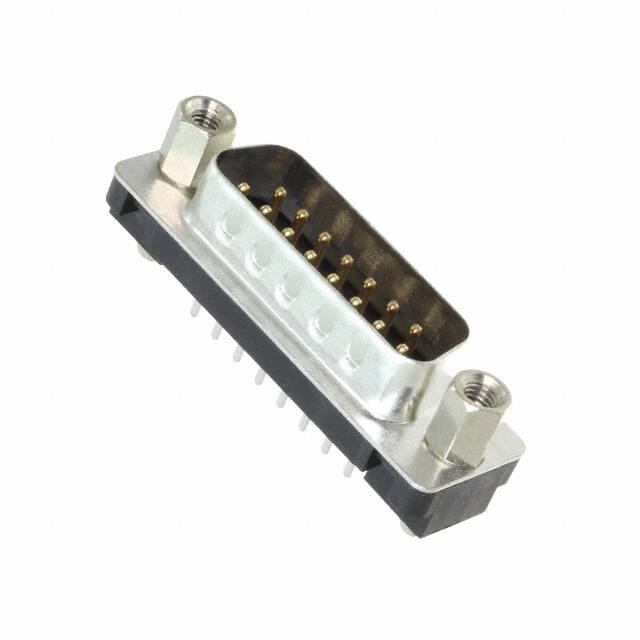

    15 位 D-Sub 插头,公引脚 连接器
L717TSAG15POL2RM8 数据手册
TS D-Sub connectors - Stamped and Formed Contacts DESCRIPTION Specifications • Connectors according to MIL C24308 Materials and Platings Shells Insulator Contacts Boardlock Screwlock Steel, tin over nickel plating Glass-filled thermoplastic, UL 94V-0 Copper alloy, with selective gold plating Brass with nickel plating Brass with nickel plating The one shell D-sub Amphenol series features, stamped and formed contacts. This series gives you Amphenol’s high standards of quality and reliability to meet all of your commercial requirements Electrical Data Current rating Voltage rating Withstanding voltage Insulation resistance Contact resistance 5A 600V AC/rms 50Hz 1000V AC/rms 50Hz for one minute 5000MΩ 10mΩ max Economical straight PCB, one shell connectors Climatic Data Operating temperature -55°C to +125°C Mechanical Data No. of Cts Mate (max) Unmate (min) 9 15 25 37 3.05 (6.74) 5.09 (11.24) 8.44 (18.66) 12.51 (27.65) 0.36 (0.79) 0.46 (1.01) 0.81 (1.8) 1.1 (2.47) Standard plating thicknesses • gold flash • 0.4µm (15µ") gold • 0.76 µm (30µ") gold • Industrial • Telecom • Any industry standard I / O connections TS / E10 Mating and unmating force Unit: kg ( lb) APPLICATIONS CHARACTERISTICS STRAIGHT PCB TERMINATION ONE METAL SHELL CONNECTORS B±0.13 (.005) C±0.13 (.005) D±0.13 (.005) POSITION #1 10° 12.55±0.38 (.494±.015) 7.9±0.13 (.311±.005) A±0.38 (.015) 2.84 (.112) 8.38±0.13 (.33±.005) X SOCKET 3.4 (.134) PLUG 6.1 (.240) 4.8 (.189) L* 7.7 (.303) Ø0.8 (.031) *see chart "how to order" RECOMMENDED P.C.B. LAYOUT 1.42 (.560) B E ø3.2 (.126) CL ø1.0 (.039) 1.385 (.055) X 2.84 (.112) OVERALL DIMENSIONS Shell Size Dimensions DIMENSIONS mm (inch) Nb OF CONTACTS A B C D E X 9 30.84 (1.21) 24.99 (.984) 16.92 (.666) 16.26 (.640) 11.08 (.436) 2.74 15 39.24 (1.54) 33.32 (1.31) 25.25 (.994) 24.56 (.967) 19.39 (.763) 2.74 25 53.04 (2.09) 47.04 (1.85) 38.96 (1.53) 38.30 (1.51) 33.24 (1.31) 2.77 37 69.34 (2.73) 63.50 (2.50) 55.42 (2.18) 54.76 (2.16) 49.86 (1.96) 2.77 #4-40 or M3 6.0 (.236) #4-40 or M3 HOW TO ORDER Panel mounting option ø3.25 (.128) ø3.25 (.128) Boardlock with Threaded Insert RM5 Boardlock with Front Screwlock RM8 ø3.05 (120”) Rear Insert M3 or #4-40 Clear Hole Rear Insert Threaded Blank H or G How to order L ... TS ... ... ... ... ... ... C309 RoHS Compliant gold flash 0.4µm (15µ") plating option valid only for 0.76µm (30µ") 77: tinned shell for receptable 717: tinned shell + dimples for plug part numbers to be written as follow: 77...................C309 or 717.................C309 177: tinned shell for receptable 777: tinned shell + dimples for plug board mounting options Blank = Clear Hole RM5 = boardlock RM8 = boardlock +front screwlock shell size termination mounting options Blank = Clear Hole G = M3 H = 4-40 H,G must also be used to specify the threading of RM5 or RM8 grounding tabs OL2 : L = 6.02mm (.237”) OL2C : L = 11.48mm (.452”) contact type P = pin S = socket configuration 09, 15, 25, 37 Example: L77 TS E H 09 S OL2 RM5 L717 TS E H 09 P OL2 RM8 C309 For special request, please consult factory TS / E10 E, A, B, C Amphenol IT & Communication Products Block A3/A4, The 4th Industrial District of Industrial Headquarters, Dong Keng Road Gong Ming Town, Shen Zhen China Fax:+86(0)755 2754 9955 Technical Support Tel:+86(0)755 2717 7945 Info-dsub@amphenol.com.cn http://www.dsubconnector.com The information given in this document are as a guideline only. We reserve the right to modify our products in any way we deem necessary. Any duplication is prohibited, unless approved in writing. Do not hesitate to contact us for further information E10/E NOTES Memo
