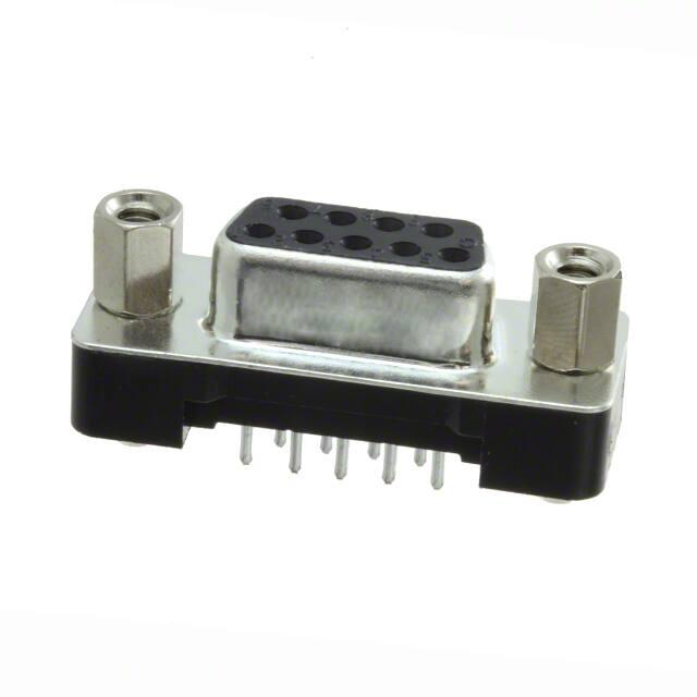

D-Sub connectors - Stamped and Formed Contacts
DESCRIPTION
Specifications
• Connectors according to MIL C24308
Materials and Platings
Shells
Insulator
Contacts
Boardlock
Screwlock
Steel with nickel plating
Glass-filled thermoplastic, UL 94V-0
Copper alloy, selective gold plating
Brass with nickel plating
The one shell D-sub Amphenol series
features, stamped and formed contacts.
This series gives you Amphenol’s high
standards of quality and reliability
to meet all of your commercial
requirements

I / O connections
TS / E10
Mating and unmating force
Unit: kg ( lb)
APPLICATIONS
CHARACTERISTICS
STRAIGHT PCB TERMINATION
ONE METAL SHELL CONNECTORS
B±0.13 (.005)
C±0.13 (.005)
2.84 (.112)
D±0.13 (.005)
POSITION #1
10°
12.55±0.38 (.494±.015)
7.9±0.13 (.311±.005)
A±0.38 (.015)
8.38±0.13 (.33±.005)
X
SOCKET
6.1 (.240)
PLUG
3.18 (.125)
4.8 (.189)
L*
7.7 (.303)
0.8 (.031)
*see chart "how to order"
RECOMMENDED P.C.B. LAYOUT
B
E
ø3.2 (.126)
C L
ø1.0 (.039)
1.42 (.560)
OVERALL DIMENSIONS
Shell Size Dimensions
1.385 (.055)
X
DIMENSIONS mm (inch)
Nb OF
CONTACTS
A
B
C
D
E
X
9
30.84 (1.21)
24.99 (.984)
16.92 (.666)
16.26 (.640)
11.08 (.436)
2.74
15
39.24 (1.54)
33.32 (1.31)
25.25 (.994)
24.56 (.967)
19.39 (.763)
2.74
25
53.04 (2.09)
47.04 (1.85)
38.96 (1.53)
38.30 (1.51)
33.24 (1.31)
2.77
37
69.34 (2.73)
63.50 (2.50)
55.42 (2.18)
54.76 (2.16)
49.86 (1.96)
2.77
#4-40 or M3
6.0 (.236)
#4-40 or M3
