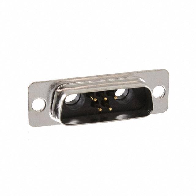

    AMPHENOL(安费诺)
    7(5 + 2 同轴或电源) 位 D-Sub,组合式 插头,公引脚 连接器
L77TWA7W2P 数据手册
TW Electrical Data Current rating Signal contacts 7.5 A. with 10 A. peak Power contacts PCB terminations 10 to 40 A. Solder cup terminations 10 to 40 A. Crimp terminations 10 to 40 A. Shielded contacts 0.5 A. Voltage rating Signal and power contacts 300 V.R.M.S. at 50 Hz Shielded contacts 150 V.R.M.S. at 50 Hz Shielded contacts Frequency range 0-1 GHz Attenuation 0.2dB V. S. W. R. 1.4(+0.04/GHz) Characteristic impedance 50 Ohms Dielectric withstanding voltage ≥ 1000 V.R.M.S. at 50Hz Insulation resistance ≥ 5000 M Ohms at 500 VDC Contact resistance ≤ 5m Ohms Shell resistance ≤ 1m Ohm (electrical grounding) Climatic Data Operating temperature Mechanical data Shells With or without dimples Contact retention force in dielectric material > 40N Maximum mating and unmating force With dimples E size = 70 N A size = 80 N B size = 100 N C size = 150 N D size = 180 N Without dimples E size = 30 N A size = 50 N B size = 80 N C size = 120 N D size = 160 N Compatible with process IR - Air convectioned 260˚ for 20 s. Resistance to solder iron heat 260˚C for 30 s. Mating cycles ≥ 200 (class ll) or 500 (class l) Damp heat Salt spray -55˚C + 155˚C (with peak 180˚C) 56 days (40˚C - 95% HR) 48 hours Amphenol D’Sub TW Hybrid Series permits a mix of contacts including signal, power, shielded, high voltage and fiber optics in the same housing with different contacts arrangements. This economic series was first developed from our military series, and has improved features: - new contacts - new high temperature black thermoplastic insert - PCB configurations come preloaded with fixed contacts and brackets. These connectors are supplied with screw machined contacts fixed in the insulator. A complete range of housings are also available for cable application. A full series of arrangements compatible with reflow process • Commercial • Medical • Industrial • Telecom • Any application requiring optimization of space TW / E1 Materials and plating Shells Steel-Tin plating Insulators High temperature black thermoplastic Signal contacts Female: machined bronze Material Male: machined brass Plating finish 15µ" Au over 79µ" Ni min. Or 30µ" Au over 79µ" Ni min. Shielded contacts Female: machined bronze Material Male: machined brass Plating Inner conductor 15µ" Au or 30µ" Au over 79µ" Ni Outer ring Flash Au over 79µ" Ni Terminations Tinned Except solder cup and crimp terminations gold flash Power contacts Female: machined bronze Material Male: machined brass Plating Contacts 15µ" Au or 30µ" Au over 79µ" Ni Terminations Tinned Except solder cup and crimp terminations gold flash Brackets Steel-Tin plating Front jackscrews Brass-Tin plating Rear clinch nuts Brass-Tin plating Boardlocks Bronze-Tin plating Stand-off Brass-Tin plating DESCRIPTION • Connectors according to: MIL C24308 - NFC93425 - HE507 APPLICATIONS CONTENT Hybrid D’Sub series Additional arrangements Arrangement…… Shell Size………. 2W2 E P2W2 E (polarized) P3W3 A (polarized) F 1.5 10˚ H A B B’ 0.9 J D’ D E G ø 3.1 Shell size Contact P: Pin S: Socket S P A S P B S P C S P D B 0/-0.20 (0/-.008) B‘ +0.20/0 (+.008/0) C D ±0.10 (±.004) 0/-0.25 (0/-.010) 16.8 (.661”) 25.0 30.7 (.984”) 8.0 (1.209”) 16.4 (.315”) (.646”) 25.1 (.988”) 33.3 39.0 (1.311”) 8.0 (1.535”) 24.8 (.315”) (.976”) 38.8 (1.528”) 47.0 52.9 (1.850”) 8.0 (2.083”) 38.5 (.315”) (1.513”) 55.3 (2.177”) 63.5 69.2 (2.500”) 8.0 (2.724”) 54.9 (.315”) (2.161”) 52.7 (2.075”) 61.1 66.8 (2.406”) 10.9 (2.630”) 52.5 (.429”) (2.067”) P E A ±0.25 (±.010) S TECHNICAL DATA Shell size dimensions G D‘ +0.25/0 (+.010/0) 8.2 (.323”) 8.2 (.323”) 8.2 (.323”) 8.2 (.323”) 11.0 (.433”) E ±0.20 (±.008) F F‘ G +0.05/-0.20 +0.10/-0.20 +0.10/-0.20 (+.002/-.008) (+.004/-.008) (+.004/-.008) 12.4 (.488”) 12.4 (.488”) 12.4 (.488”) 12.4 (.488”) 15.2 (.598”) 11.1 (.437) 11.1 (.437) 11.1 (.437) 11.1 (.437) 11.1 (.437) 10.9 (.429”) 10.9 (.429”) 11.0 (.433”) 11.0 (.433”) 11.0 (.433”) 6.2 (.244”) 6.2 (.244”) 6.2 (.244”) 6.2 (.244”) 6.2 (.244”) G‘ J H ±0.10 (±.004) 5.9 (.232”) 5.9 (.232”) 5.8 (.228”) 5.8 (.228”) 5.8 (.228”) 0/-0.50 (0/-.020) +0.10/-0.40 (+.004/-.016) 19.4 11.0 (.764”) (.433”) 27.7 11.0 (1.091”) (.433”) 41.4 11.0 (1.630”) (.433”) 57.9 11.0 (2.280”) (.433”) 55.5 13.8 (2.185”) (.543”) Panel cutouts D E A B 3 C D Mounting method Front Rear Front Rear Front Rear Front Rear Front Rear 10˚ A ±0.20 (±.008) 22.2 (.874”) 20.5 (.807”) 30.5 (1.201”) 28.8 (1.134”) 44.3 (1.744”) 42.5 (1.673”) 60.7 (2.390”) 59.1 (2.327”) 58.3 (2.295”) 56.3 (2.217”) B ±0.20 (±.008) 11.1 (.437”) 10.2 (.402”) 15.3 (.602”) 14.4 (.567”) 22.1 (.870”) 21.3 (.839”) 30.4 (1.197”) 29.5 (1.161”) 29.2 (1.150”) 28.2 (1.110”) 10˚ G H C F D R Rd Rading J C Shell size Standard cutout A B D ±0.20 (±.008) ±0.20 (±.008) 25.0 (.984”) 12.5 (.492”) 33.3 (1.311”) 16.7 (.657”) 47.0 (1.850”) 23.5 (.925”) 63.5 (2.500”) 31.7 (1.248”) 61.1 (2.406”) 30.6 (1.205”) Rd Rading J C E ±0.20 (±.008) 13.0 (.512”) 11.4 (.449”) 13.0 (.512”) 11.4 (.449”) 13.0 (.512”) 11.4 (.449”) 13.0 (.512”) 11.4 (.449”) 15.8 (.622”) 14.1 (.555”) F ±0.20 (±.008) 6.5 (.256”) 5.7 (.224”) 6.5 (.256”) 5.7 (.224”) 6.5 (.256”) 5.7 (.224”) 6.5 (.256”) 5.7 (.224”) 7.9 (.311”) 7.1 (.280”) E G H ±0.20 (±.008) ±0.20 (±.008) 3.0 (.118”) 1.5 (.059”) 3.0 (.118”) 1.5 (.059”) 3.0 (.118”) 1.5 (.059”) 3.0 (.118”) 1.5 (.059”) 3.0 (.118”) 1.5 (.059”) J ±0.20 (±.008) 2.1 (.083”) 3.4 (.0134”) 2.1 (.083”) 3.4 (.0134”) 2.1 (.083”) 3.4 (.0134”) 2.1 (.083”) 3.4 (.0134”) 2.1 (.083”) 3.4 (.0134”) TW / E1 Optimal cutout for rear mounting A B øG TECHNICAL DATA Straight connector footprint 1 A 2 A B 3 A B B Signal tail 0.6 mm Dia. (.024”) 1.6 mm (.063”)PCB For other PCB thickness: consult factory. Dimensions Description a 4.80 mm (.189”) 4.80 mm (.189”) 4.00 mm (.157”) 5.30 mm (.209”) Power 3.2mm(.126”) tail dia 1 Power 2.0mm(.078”) tail dia 1 Shielded 3 Signal 2 b 7.2 mm (.283”) 7.2 mm (.283”) 7.2 mm (.283”) 11.50 mm (.453”) Straight contact combinations Arrangement with signal contacts Arrangement without signal contacts 2W2 - 3W3 - 5W5 - 8W8 See above dimensions Size 8 and 20 Contacts See above dimensions Size 8 Contacts P 3SY Power 3.2 mm DIA. (.126”) (20 to 40 A) and signal P 3Y Power only 3.2 mm DIA. (.126”) (20 to 40 A) P 2SY Power 2 mm DIA. (.078”) (10 to 20 A) and signal P 2Y Power only 2 mm DIA. (.078”) (10 to 20 A) CY Shielded only CSY Shielded and signal SY Signal only No reference Signal (Size 20) with solder cup terminations Housing preloaded with contacts 4 1 2 B C 3 B C B C A A Signal tail 0.6 mm Dia. (.0236”) 1.6 mm (.063”) PCB For other PCB thickness: consult factory. Description TECHNICAL DATA Right angle connector footprint A Europe HE 5 pattern = - Euro height - Euro footprint pitch between 2 rows: .100” Mix Mixed pattern = - MIL height - Euro footprint pitch between 2 rows: .100” a b c a - - - b MIL MIL pattern = - MIL height - MIL footprint pitch between 2 rows: .112” a c b c 10.30mm 6.30mm 10.00mm 10.30mm 6.30mm 10.00mm (.406”) (.248”) (.394”) (.406”) (.248”) (.394”) Shielded 1 Signal 2 10.30mm 7.20mm 11.20mm 10.30mm 6.30mm 9.50mm 8.10mm 6.30mm 9.50mm (.406”) (.283”) (.441”) (.406”) (.248”) (.374”) (.319”) (.248”) (.374”) Power 2.0mm(.078”) tail dia 3 11.57mm 7.20mm 10.50mm 11.57mm 6.30mm 9.50mm 9.52mm 6.30mm 9.50mm (.456”) (.283”) (.413”) (.456”) (.248”) (.374”) (.375”) (.248”) (.374”) Power 3.2mm(.126”) tail dia 3 21.46mm 7.20mm 10.50mm 21.46mm 6.30mm 9.50mm 21.46mm 6.30mm 9.50mm (.845”) (.283”) (.413”) (.845”) (.248”) (.374”) (.845”) (.248”) (.374”) Note: above dimensions correspond to sizes E to C. Consult factory for D sizes. Connector comes equipped with contacts and brackets. Right angle contacts combinations 5 Arrangement without signal contacts 2W2 - 3W3 - 5W5 - 8W8 European footprint Mixed footprint MIL (U.S.) footprint Size 8 and 20 Contacts European footprint Mixed footprint MIL (U.S.) footprint Size 8 contacts only EP3SV HP3SV MP3SV Power 3.2 mm DIA. (.126”) (20 to 40 A) and signal EP3V HP3V MP3V Power only 3.2 mm DIA. (.126”) (20 to 40 A) EP2SV HP2SV MP2SV Power 2 mm DIA. (.078”) (10 to 20 A) and signal EP2V HP2V MP2V - HCSV MCSV Shielded and signal - HCV MCV ESV HSV MSV Signal only Power only 2.0 mm DIA. (.078”) (10 to 20 A) Shielded only TW / E1 Arrangement with signal contacts Right angle version Connectors come equipped with metal brackets BLANK: 3.10mm (.122”) dia mounting hole RM6: metal brackets + boardlock Metal bracket RM6 Straight version BLANK: 3.10mm (.122”) dia mounting hole RM54: 4-40 threaded RM53: M3 threaded 1.5 max. (.059 max.) 7.2 (.283) RM5x RM8x RM84: 4-40 threaded RM83: M3 threaded A514: blind mating system FM: float mounting system ø2.2 (.086) 3.6 max. (.141 max.) + 0.25 3.5 (.137) 19.9 (.783) ø2.25 (.088) ø3 0 (.118) Straight and right angle version 4R: 4-40 rear nut 3R: M3 rear nut 4F: 4-40 front female screwlock 3F: M3 front female screwlock (.1 3.4 34 ) TECHNICAL DATA Mounting options 7.1 9) 7 (.2 6 TECHNICAL DATA 4.80 (.189”) 5.20 (.205”) 5.20 (.205”) 4.80 (.189”) High power contacts 22 (.866”) øA 22 (.866”) øA øB P/N Plug øB 16 (.622”) Solder cup version Current Socket Dimensions A mm (inch) B mm (inch) L 17DM 53745-8 L 17DM 53744-7 10 to 20 Amp. 1.80 (.071”) 2.55 (.100”) L 17DM 53745-7 L 17DM 53744-6 20 to 30 Amp. 2.80 (.110”) 3.70 (.145”) L 17DM 53745-1 L 17DM 53744-1 30 to 40 Amp. 4.80 (.189”) 5.60 (.220”) Trim dimensions: 7.5 mm (.295”) Crimp version Plug P/N øA øB Socket Current Dimensions A mm (inch) B mm (inch) L 17DM 53745-208 L 17DM 53744-207 10 to 20 Amp. 1.80 (.071”) 2.55 (.100”) L 17DM 53745-207 L 17DM 53744-206 20 to 30 Amp. 2.80 (.110”) 3.70 (.145”) L 17DM 53745-201 L 17DM 53744-201 30 to 40 Amp. 4.80 (.189”) 5.60 (.220”) Trim dimensions: 7.5 mm (.295”) Crimping tool for all sizes L17D479SP 7 Extraction tool for sizes 8 cts TW / E1 22 (.866”) øA 16 (.622”) øB 22 (.866”) TECHNICAL DATA Straight shielded contacts Crimp ferrule and inner solder A B B øD øD F Type P/N plug plug plug plug socket socket socket socket L17DM 53740 L17DM 53740-1 L17DM 53740-3 L17DM 53740-5 L17DM 53742 L17DM 53742-1 L17DM 53742-3 L17DM 53742-5 Cable - RG Dimensions (inch) D B A Max 178 B/U 18.8 (740”) 23.6 (.929”) 1.0 (.039”) 18.8 (740”) 23.6 (.929”) 1.7 (.066”) 179 B/U 316 B/U 180 B/U 21.5 (846”) 23.6 (.929”) 2.8 (.110”) 58 C/U 21.5 (846”) 23.6 (.929”) 3.2 (.126”) 178 B/U 18.8 (740”) 23.6 (.929”) 1.0 (.039”) 18.8 (740”) 23.6 (.929”) 1.7 (.066”) 179 B/U 316 B/U 180 B/U 21.5 (846”) 23.6 (.929”) 2.8 (.110”) 58 C/U 21.5 (846”) 23.6 (.929”) 3.2 (.126”) E G Trim dimensions (inch) F G E 7.9 (.311”) 6.3 (.248”) 2 (.078”) 7.9 (.311”) 6.3 (.248”) 2 (.078”) 9.5 (.374”) 7.9 (.311”) 2 (.078”) 9.5 (.374”) 7.9 (.311”) 2 (.078”) 7.9 (.311”) 6.3 (.248”) 2 (.078”) 7.9 (.311”) 6.3 (.248”) 2 (.078”) 9.5 (.374”) 7.9 (.311”) 2 (.078”) 9.5 (.374”) 7.9 (.311”) 2 (.078”) Solder ferrule and inner solder A B B øD øD F Type P/N short plug plug plug plug plug short socket socket socket socket socket L17DM 53740-5000 L17DM 53740-5001 L17DM 53740-5002 L17DM 53740-5005 L17DM 53740-5008 L17DM 53742-5000 L17DM 53742-5001 L17DM 53742-5002 L17DM 53742-5004 Dimensions (inch) A Max 17.0 (669”) 18.8 (740”) 21.5 (846”) 21.5 (846”) 18.8 (740”) 17.0 (669”) 18.8 (740”) 21.5 (846”) 21.5 (846”) L17DM 53742-5006 18.8 (740”) B 21.8 (.858”) 23.6 (.929”) 26.3 (1.035”) 26.3 (1.035”) 23.6 (.929”) 21.8 (.858”) 23.6 (.929”) 26.3 (1.035”) 26.3 (1.035”) 23.6 (.929”) Cable - RG D 178 B/U 1.0 (.039”) 1.7 (.066”) 179 B/U 316 B/U 180 B/U 2.8 (.110”) 58 C/U 3.2 (.126”) 178 B/U 1.0 (.039”) 178 B/U 1.0 (.039”) 1.7 (.066”) 179 B/U 316 B/U 180 B/U 2.8 (.110”) 58 C/U 3.2 (.126”) 178 B/U 1.0 (.039”) E G Trim dimensions (inch) E 7.9 (.311”) 7.9 (.311”) 9.5 (.374”) 9.5 (.374”) 7.9 (.311”) 7.9 (.311”) 7.9 (.311”) 9.5 (.374”) 9.5 (.374”) 7.9 (.311”) F 6.3 (.248”) 6.3 (.248”) 7.9 (.311”) 7.9 (.311”) 6.3 (.248”) 6.3 (.248”) 6.3 (.248”) 7.9 (.311”) 7.9 (.311”) 6.3 (.248”) G 2 (.078”) 2 (.078”) 2 (.078”) 2 (.078”) 2 (.078”) 2 (.078”) 2 (.078”) 2 (.078”) 2 (.078”) 2 (.078”) 8 TECHNICAL DATA Right angled shielded contact Crimp ferrule and inner solder A F E G A Type P/N plug plug plug plug socket socket socket socket L17DM 53741 L17DM 53741-1 L17DM 53741-3 L17DM 53741-4 L17DM 53743-2 L17DM 53743-3 L17DM 53743-5 L17DM 53743-6 Cable - RG Dimensions (inch) Trim dimensions (inch) G F E D B A Max 9.5 (.374”) 5.9 (.232”) 1.6 (.062”) 13.5 (.531”) 18.6 (.732”) 1.0 (.039”) 178 B/U 13.5 (.531”) 18.6 (.732”) 1.7 (.066”) 179 B/U 316 B/U 9.5 (.374”) 5.9 (.232”) 1.6 (.062”) 10.7 (.421”) 7.9 (.311”) 2.4 (.094”) 13.5 (.531”) 18.6 (.732”) 2.8 (.110”) 180 B/U 10.7 (.421”) 7.9 (.311”) 2.4 (.094”) 13.5 (.531”) 18.6 (.732”) 3.2 (.126”) 58 C/U 9.5 (.374”) 5.9 (.232”) 1.6 (.062”) 13.5 (.531”) 18.6 (.732”) 1.0 (.039”) 178 B/U 13.5 (.531”) 18.6 (.732”) 1.7 (.066”) 179 B/U 316 B/U 9.5 (.374”) 5.9 (.232”) 1.6 (.062”) 10.7 (.421”) 7.9 (.311”) 2.4 (.094”) 13.5 (.531”) 18.6 (.732”) 2.8 (.110”) 180 B/U 10.7 (.421”) 7.9 (.311”) 2.4 (.094”) 13.5 (.531”) 18.6 (.732”) 3.2 (.126”) 58 C/U Ferrule and inner solder B B C F E G C øD Type P/N plug plug plug plug socket socket socket socket L17DM 53741-5000 L17DM 53741-5001 L17DM 53741-5003 L17DM 53741-5004 L17DM 53743-5000 L17DM 53743-5001 L17DM 53743-5003 L17DM 53743-5004 øD Dimensions (inch) Cable - RG D A Max B 178 B/U 13.5 (.531”) 18.6 (.732”) 1.0 (.039”) 13.5 (.531”) 18.6 (.732”) 1.7 (.066”) 179 B/U 316 B/U 180 B/U 13.5 (.531”) 18.6 (.732”) 2.8 (.110”) 58 C/U 13.5 (.531”) 18.6 (.732”) 3.2 (.126”) 178 B/U 13.5 (.531”) 18.6 (.732”) 1.0 (.039”) 13.5 (.531”) 18.6 (.732”) 1.7 (.066”) 179 B/U 316 B/U 180 B/U 13.5 (.531”) 18.6 (.732”) 2.8 (.110”) 58 C/U 13.5 (.531”) 18.6 (.732”) 3.2 (.126”) Trim dimensions (inch) F E G 9.5 (.374”) 5.9 (.232”) 1.6 (.062”) 9.5 (.374”) 5.9 (.232”) 1.6 (.062”) 10.7 (.421”) 7.9 (.311”) 2.4 (.094”) 10.7 (.421”) 7.9 (.311”) 2.4 (.094”) 9.5 (.374”) 5.9 (.232”) 1.6 (.062”) 9.5 (.374”) 5.9 (.232”) 1.6 (.062”) 10.7 (.421”) 7.9 (.311”) 2.4 (.094”) 10.7 (.421”) 7.9 (.311”) 2.4 (.094”) Crimping tool 9 RG cables MIL reference Amphenol P/N RG 58 C/U RG 178 B/U RG 179 B/U RG 180 B/U M 22 520/5-05 M 22 520/5-03 M 22 520/5-03 M 22 520/5-05 227 1221-05 227 1221-03 227 1221-03 227 1221-05 Extraction tool Extraction tool for sizes 8 cts L17D429SP dim. between 2 flat surface cavity A cavity B 5.41 2.67 3.25 4.52 TW / E1 Hand crimp tool 227-0944 (without dies) (M 22 520/5-01) ASSEMBLY INSTRUCTIONS Cabling instructions for shielded contacts Straight crimp shielded contacts: inner solder contact outer crimp contact soft solder outer ring coaxial shell outer ring braided shield crimp 3.20 inner sleeve Right angle crimp shielded contacts: inner solder contact outer crimp contact inner sleeve coaxial shell outer ring outer ring soft solder crimp 3.20 soft solder cap into shell after cable assembly on 90˚ type coax Assembly method - Slide the outer ring over the cable jacket. Trim the cable according to the recommended dimensions. - Insert the cable dielectric and the center conductor inside the inner sleeve. - Solder the central conductor to the shielded center contacts. - Slide the outer ring towards the inner sleeve and recover the braid. - Using crimp hand tool equipped with the appropriate dies, crimp in the area defined. Solder straight shielded contacts: soft solder outer ring outer ring braided shield inner sleeve coaxial shell solder Solder right angle shielded contacts: inner sleeve outer ring coaxial shell outer ring solder soft solder soft solder cap into shell after cable assembly on 90˚ type coax Assembly method - Slide the outer ring over the cable jacket. Trim the cable according to the recommended dimensions. - Insert the cable dielectric and the center conductor inside the inner sleeve. - Solder the central conductor to the shielded center contacts. - Slide the outer ring towards the inner sleeve and recover the braid. - Solder by introducing metal through the outer ring hole. 10 Special Deviations RoHS Compliant Shell & Contact Plating Options Shell Tinned Contact Plating Tinned & Indents; Plug only 77 717 0.4µm(15µ”) Au 177 777 0.76µm(30µ”) Au Shell Size and Configuration: E2W2, *P2W2, E5W1, A3W3, *P3W3, A7W2, A11W1, B5W5, B9W4, B13W3, B17W2, B21W1, C8W8, C13W6, C17W5, C21WA4, C25W3, C27W2, D24W7, D36W4, D43W2 Gender: P: S: Pin Socket Terminations: For Straight PCB and Solder-Cup BLANK: Solder-cup signal contacts only P3SY: 20-40 Amp power & signal mix P2SY: 10-20 Amp power & signal mix CSY: Coax & signal mix SY: Signal only P3Y: 20-40 Amp power only (2W2, 3W3, 5W5, 8W8) P2Y: 10-20 Amp power only (2W2, 3W3, 5W5, 8W8) CY: Coax only (2W2, 3W3, 5W5, 8W8) For Right Angle PCB MP3SV: US Footprint, 20-40 Amp power & signal mix MP2SV: US Footprint, 10-20 Amp power & signal mix MCSV: US Footprint, coax & signal mix MSV: US Footprint, signal only MP3V: US Footprint, 20-40 Amp power only (2W2, 3W3, 5W5, 8W8) MP2V: US Footprint, 10-20 Amp power only (2W2, 3W3, 5W5, 8W8) MCV: US Footprint, coax only (2W2, 3W3, 5W5, 8W8) EP3SV: European Footprint, 20-40 Amp power & signal mix EP2SV: European Footprint, 10-20 Amp power & signal mix ESV: European Footprint, signal only EP3V: European Footprint, 20-40 Amp power only (2W2, 3W3, 5W5, 8W8) EP2V: European Footprint, 10-20 Amp power only (2W2, 3W3, 5W5, 8W8) HP3SV: Mixed Footprint, 20-40 Amp power & signal mix HP2SV: Mixed Footprint, 10-20 Amp power & signal mix HCSV: Mixed Footprint, coax & signal mix HSV: Mixed Footprint, signal only HP3V: Mixed Footprint, 20-40 Amp power only (2W2, 3W3, 5W5, 8W8) HP2V: Mixed Footprint, 10-20 Amp power only (2W2, 3W3, 5W5, 8W8) HCV: Mixed Footprint, coax only (2W2, 3W3, 5W5, 8W8) Example: L717 TW B9W4 S MP3V 4F RM6 * indicates polarized inserts Consult Factory Board Mounting Options: For Straight Blank: 3.05mm (.120”) clear hole RM53: M3 Threaded (panel side) standoff with boardlock RM54: 4-40 Threaded (panel side) standoff with boardlock RM83: Non-Removable M3 screwlock, with standoff and boardlock RM84: Non-Removable 4-40 screwlock, with standoff and boardlock For Right Angle Blank: 3.05mm (.120”) clear hole RM6: Metal bracket with boardlock Panel Mounting Options: Blank: 3F: 3R: 4F: 4R: FM: A514: 3.05mm (.120”) clear hole M3 Front screwlock M3 Rear threaded insert 4-40 Front screwlock 4-40 Threaded rear insert Float-mount system Blind mate guide pin Amphenol IT & Communication Products Block A3/A4, The 4th Industrial District of Industrial Headquarters, Dong Keng Road Gong Ming Town, Shen Zhen China Fax:+86(0)755 2754 9955 Technical Support Tel:+86(0)755 2717 7945 Info-dsub@amphenol.com.cn http://www.dsubconnector.com The information given in this document are as a guideline only. We reserve the right to modify our products in any way we deem necessary. Any duplication is prohibited, unless approved in writing. Do not hesitate to contact us for further information E13/C NOTES Memo 12
