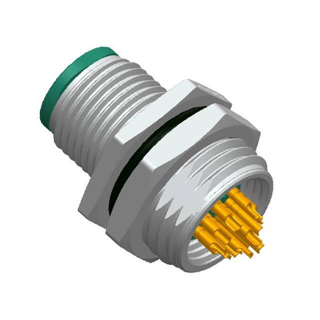

1 2 3 13.6 +0.1 0 B +0.1 0 B #0.1 C 5 ECN NO. LEN1570187~194 LE31570179~182 LEN1680378~389 QC 6 7 8 DATE SIGN 2015/07/18 Yulong_wang Change to Share Drawing. 2016/08/06 Yulong_wang Add 6 PIN A QC DESCRIPTION & IP69K 23.0 B 10.0 20.6 (Ref.) Recommended Panel Cut-Out PG9 or M16*1.5 2.0 45.0 Recommended Panel Cut-Out M 12A - XX P M M S - S H 8 XXX 12A:A-Code D 001:PG9 002:M16*1.5 Liquid Glue 8:IP68/69K(防水等級68/69K) C C 3 Screw Nut 1 2 5 Shield M12*1.0 Panel O-Ring 4 H:Rear Fasten(后鎖式/Enclosure Front Mount) S:Screw(螺紋式) P:Panel(板端) S:Solder Type(焊接式) M:Male Connector(公座) C M12A-03PMMS-SH8XXX M12A-04PMMS-SH8XXX M12A-05PMMS-SH8XXX M12A-06PMMS-SH8XXX M12A-08PMMS-SH8XXX M12A-10PMMS-SH8XXX M12A-12PMMS-SH8XXX Item No. M:Male Pin(公Pin) 2.5 2.5 2.5 2.5 2.5 4.5 2.5 4.5 2.5 A B Pin伸出長度 Note: * Important Dimension. QC C * Waterproof Rate:IP68,IP69K * Housing:Nylon+GF,Black. * Male Pin:Copper Alloy,Gold Plated. * Shield:Zinc Alloy,Nickel Plated. * Screw Nut:Zinc Alloy,Nickel Plated. * Panel O-Ring:Viton,Black. * Rated Voltage: 3 & 4Pin 250V dc. or ac. 5Pin 60V dc. or ac. 6~12Pin 30V dc. or ac. * Rated Current: 3~5Pin 4A 6~8Pin 2A 10~12Pin 1.5A * Operating Temperature: -40~105 $ C * For Panel Thickness Max 4.5mm. * Recommended Nut Torque:4-6 Kgf.cm. T A L W CONFIDENTIAL 2016-08-06 C R&D DEPT. B 3P 4P 5P C 6P 8P 10P 12P Pin Assignment Front View TITLE UNIT:mm TOLERANCE .X # 0.25 .XX # 0.1 .XXX # 0.05 ANGLES # 1 1 SCALE REV. $ 2 Amphenol LTW M12 A-Code Male Conn. Solder Rear Type 2:1 C SIZE SHEET A4 WC-REV. A.7 1 OF 1 Yulong_wang DWG NO M12A-XXPMMS-SH8XXX CUSTOMER Jinhai 5 6 Jerry 7 2016-08-06 DATE APPROVED BY ALTW 4 2016-08-06 DATE CHECKED BY QC :Inspection item 3 DATE DRAWN BY ITEM NO 2016-08-06 8 FMW10702-01-02A1 Amphenol LTW. A Connector PROPERTY OF Amphenol LTW. DISCLOSURE TO THIRD PARTY HAS TO BE AUTHORIZED BY 03:3Pin 04:4Pin 05:5Pin 06:6Pin 08:8Pin 10:10Pin 12:12Pin $ 18.0 (Hex.) E 16.1 15.4 QC QC THIS DOCUMENT IS SUBJECT TO CHANGE WITHOUT NOTICE. IT IS CONFIDENTIAL AND A F REV. (M16*1.5) (PG9) 13.6 4
