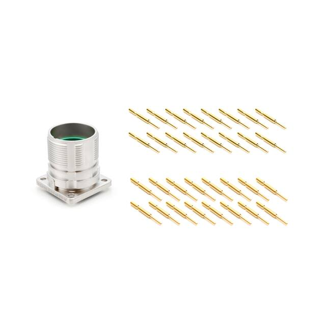

    16 POSITION RECEPTACLE CONNECTOR
MA2LAE1600-KIT 数据手册
REVISIONS REV ECO DESCRIPTION DATE BY APPR A1 - FIRST RELEASE Aug.08,2018 White TOMMY E type, Normal Key 2.5 M23x1.0 25.7 12 1 13 14 3 KIT,M23A,REC.,16POS,E TYPE,FLANGE MOUNT,CHECKMATE 2 4 NOTES: UNLESS OTHERWISE SPECIFIED 19.8 1. MATERIAL: INSULATION INSERT: PA66,UL94 V0 SEAL: VITON HOUSING BODY: ZINC DIE CAST, NICKEL PLATED CONTACT: COPPER ALLOY, GOLD PLATED 27.5 Ø20. 0 25.7 2. SPECIFICATIONS: 2.1 CURRENT RATING: 9 AMPS 2.2 VOLTAGE RATING: 125 V AC/DC 2.3 OPERATING TEMPERATURE: -20°C TO +130°C 2.4 DIELECTRIC WITHSTANDING VOLTAGE: LESS THAN 2 MILLIAMPS CURRENT LEAKAGE @ 2500 VOLTS AC. 2.5 DEGREE OF PROTECTION: IP67 ( MATED CONDITION ) 2.6 DEGREE OF POLLUTION: 3 PER UL840 2.7 OVERVOLTAGE CATEGORY: III PER UL840 2.8 MATING CYCLE DURABILITY: >500 CYCLES 2.9 RoHS COMPLIANT M2.5 MA2LAE1600-KIT 19.8 DWG NO: 19.8 5 TITLE: E 6 19.8 11 16 15 7 AMPHENOL MA2LAE1600 XXXX 10 9 8 Ø19.8 4-Ø 2.7 3. ALL DIMENSIONS ARE FOR REFERENCE USE ONLY. Mounting Holes REV: A1 SH: 3) Note reference = X SIGNATURES DRAWN: CHECKED: Amphenol DATE White Tod Aug.08,2018 Aug.08,2018 Tommy Aug.08,2018 Sine Systems - www.amphenol-sine.com 44724 Morley Drive Clinton Township, MI 48036 ENGINEER: APPROVAL: MATERIAL SPECIFICATIONS: CUSTOMER: KIT,M23A,REC.,16POS,E TYPE,FLANGE MOUNT,CHECKMATE PROCESS SPECIFICATIONS: THIS DRAWING IS SUPPLIED FOR INFORMATION ONLY. DESIGN FEATURES, SPECIFICATIONS AND PERFORMANCE DATA SIZE SHOWN HEREON ARE THE PROPERTY OF THE AMPHENOL CORPORATION. NO RIGHTS OF REPRODUCTION ARE IMPLIED. ALL DIMENSIONS ARE SUBJECT TO NORMAL SCALE: MANUFACTURING VARIATIONS. TYPE B C- NEXT ASS'Y: NONE DWG NO: REVISION MA2LAE1600-KIT SHEET 1 A1 OF 1 1 All dimensions are in metric(mm). Tolerances are as follows: PL DEC ±0.30 Fractions ±1/64 PL DEC ±0.15 Angles ±1° PL DEC ±0.08 OF: UNLESS OTHERWISE SPECIFIED 1) 2) 1 2 3 3 2 1 ITEM SC000146 CONTACT, PIN, Ø1.0mm ,Crimp 28~24AWG SC000035 CONTACT, PIN, Ø1.0mm, Crimp 22~18AWG MA2LAE1600 CONNECTOR DESCRIPTION PART NUMBER MATERIALS LIST 1 16 16 1 QUANTITY
