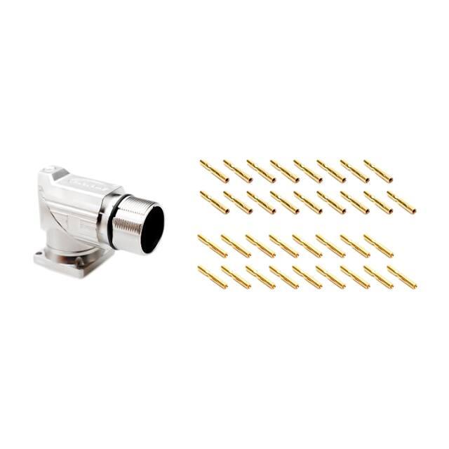

    17 针位圆形连接器 插座,母型插口 压接
MA7RAE1702S-KIT 数据手册
REVISIONS REV ECO DESCRIPTION DATE BY APPR A1 - FIRST RELEASE Jan.12.2018 White Tommy E type, Normal Key 55.1 8 15 7 1 12 2 17 13 3 E 14 4 6 5 41.0 10 16 NOTES: UNLESS OTHERWISE SPECIFIED 4.5 25.0 M23x1.0 11 9 TITLE: MA7RAE1702 XXXX 18.7 KIT,M23A,REC.,RA,17P,E TYPE 1. MATERIAL: INSULATION INSERT: PA66,UL94 V0 SEAL: VITON HOUSING BODY: ZINC DIE CAST, NICKEL PLATED CONTACT: COPPER ALLOY, GOLD PLATED Ø19.6 28.0 22.6 .0 22.6 Ø20 DWG NO: 2. SPECIFICATIONS: 2.1 CURRENT RATING: 9 AMPS 2.2 VOLTAGE RATING: 125 V AC/DC 2.3 OPERATING TEMPERATURE: -20°C TO +130°C 2.4 DIELECTRIC WITHSTANDING VOLTAGE: LESS THAN 2 MILLIAMPS CURRENT LEAKAGE @ 2500 VOLTS AC. 2.5 DEGREE OF PROTECTION: IP67 ( MATED CONDITION ) 2.6 DEGREE OF POLLUTION: 3 PER UL840 2.7 OVERVOLTAGE CATEGORY: III PER UL840 2.8 MATING CYCLE DURABILITY: >500 CYCLES 2.9 RoHS COMPLIANT 22.6 MA7RAE1702S-KIT M 4x 3( 4x ) 22.6 3. ALL DIMENSIONS ARE FOR REFERENCE USE ONLY. .2 Ø3 MOUNTING HOLE 28.0 REV: A1 SH: SIGNATURES All dimensions are in metric(mm). Tolerances are as follows: PL DEC ±0.30 Fractions ±1/64 PL DEC ±0.15 Angles ±1° PL DEC ±0.08 DATE Amphenol DRAWN: CHECKED: White Tod Jan.12.2018 Jan.12.2018 Tommy Jan.12.2018 Sine Systems - www.amphenol-sine.com 44724 Morley Drive Clinton Township, MI 48036 ENGINEER: 3) Note reference = X APPROVAL: MATERIAL SPECIFICATIONS: CUSTOMER: KIT,M23A,REC.,RA,17P,E TYPE PROCESS SPECIFICATIONS: THIS DRAWING IS SUPPLIED FOR INFORMATION ONLY. DESIGN FEATURES, SPECIFICATIONS AND PERFORMANCE DATA SIZE SHOWN HEREON ARE THE PROPERTY OF THE AMPHENOL CORPORATION. NO RIGHTS OF REPRODUCTION ARE IMPLIED. ALL DIMENSIONS ARE SUBJECT TO NORMAL SCALE: MANUFACTURING VARIATIONS. TYPE B C- NEXT ASS'Y: NONE DWG NO: REVISION MA7RAE1702S-KIT SHEET 1 A1 OF 1 1 UNLESS OTHERWISE SPECIFIED 1) 2) 1 2 3 OF: 3 2 1 ITEM SC000030 CONTACT, SOCKET, Ø1.0mm,CRIMP 24~28AWG SC000044 CONTACT, SOCKET, Ø1.0mm,CRIMP 18~22AWG MA7RAE1702 CONNECTOR DESCRIPTION PART NUMBER MATERIALS LIST 1 17 17 1 QUANTITY
