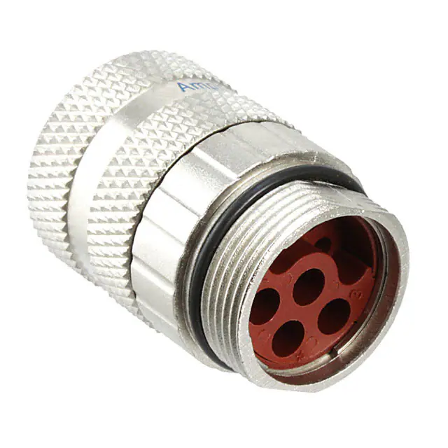

MB1CKN0800 数据手册
REVISIONS REV ECO DESCRIPTION DATE BY APPR B1 - RELEASE NEW DWG FORMAT May.10,2014 Drack Tommy B2 - UPDATE THE DURABILITY Jun.27,2015 Drack Tommy TITLE: DWG NO: Ø23.3 2. SPECIFICATIONS: 2.1 CURRENT RATING: SIGNAL: 10 AMPS POWER: 30AMPS 2.2 VOLTAGE RATING: SIGNAL: 250V AC/DC POWER: 630V AC/DC 2.3 OPERATING TEMPERATURE: -20°C TO +130°C 2.4 DIELECTRIC WITHSTANDING VOLTAGE: LESS THAN 2 MILLIAMPS CURRENT LEAKAGE @ SIGNAL: 2500VOLTS AC. POWER: 6000 VOLTS AC. 2.5 DEGREE OF PROTECTION: IP67 ( MATED CONDITION ) 2.6 DEGREE OF POLLUTION: 3 PER UL840 2.7 OVERVOLTAGE CATEGORY: III PER UL840 2.8 MATING CYCLE DURABILITY: >500 CYCLES 2.9 RoHS COMPLIANT MB1CKN0800 ø27.0 M23x1 1. MATERIAL: INSULATION INSERT:PA66,UL94 V0 SEAL: VITON HOUSING BODY: ZINC DIE CAST, NICKEL PLATED COUPLING NUT: COPPER ALLOY, NICKEL PLATED M23B,PLUG,STR,8POS(4+4) 15/16-20 UNEF NOTES: UNLESS OTHERWISE SPECIFIED 3. ALL DIMENSIONS ARE FOR REFERENCE USE ONLY. REV: B2 9.9 SH: 1 37.5 UNLESS OTHERWISE SPECIFIED 1) 2) 1 2 3 All dimensions are in metric(mm). Tolerances are as follows: PL DEC ±0.30 Fractions ±1/64 PL DEC ±0.15 Angles ±1° PL DEC ±0.08 3) Note reference = X SIGNATURES DRAWN: Drack ITEM Amphenol DATE Jun.27,2015 CHECKED: Sine Systems - www.amphenol-sine.com 44724 Morley Drive Clinton Township, MI 48036 ENGINEER: APPROVAL: MATERIAL SPECIFICATIONS: CUSTOMER: M23B,PLUG,STR,8POS(4+4) PROCESS SPECIFICATIONS: THIS DRAWING IS SUPPLIED FOR INFORMATION ONLY. DESIGN FEATURES, SPECIFICATIONS AND PERFORMANCE DATA SIZE SHOWN HEREON ARE THE PROPERTY OF THE AMPHENOL CORPORATION. NO RIGHTS OF REPRODUCTION ARE IMPLIED. ALL DIMENSIONS ARE SUBJECT TO NORMAL SCALE: MANUFACTURING VARIATIONS. TYPE B C- NEXT ASS'Y: NONE DWG NO: REVISION MB1CKN0800 SHEET B2 1 OF 1 1 QUANTITY OF: SEE PART NUMBER CHART DESCRIPTION PART NUMBER MATERIALS LIST
