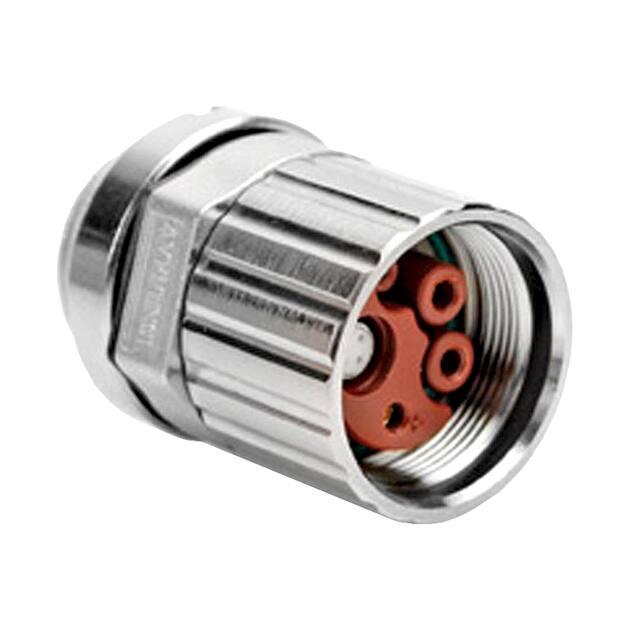

TITLE:
4
M23, PLUG, STRAIGHT, PANEL MOUNT, HYBRID, THREADED
NOTES: UNLESS OTHERWISE SPECIFIED
2
1. MATERIAL:
INSULATION INSERT:PBT,UL94 V0
SEAL: VITON
HOUSING BODY: ZINC DIE CAST, NICKEL PLATED
COUPLING NUT: COPPER ALLOY, NICKEL PLATED
ø29.5
21.5
1
3
15/16-20 UNEF
SH:
M23*1.0
Ø23.4
B2
1
All dimensions are in metric(mm).
Tolerances are as follows:
PL DEC ±0.30
Fractions ±1/64
PL DEC ±0.15
Angles ±1°
PL DEC ±0.08
3) Note reference =
X
SIGNATURES
DRAWN:
Drack
ITEM
1
1)
2)
1
2
3
OF:
21.8
REV:
SEE PART NUMBER
CHART
DESCRIPTION
PART NUMBER
MATERIALS LIST
Ø2
4 .0
MB1WSN8H00
3. ALL DIMENSIONS ARE FOR REFERENCE USE ONLY.
QUANTITY
SECTION A-A
DWG NO:
2. SPECIFICATIONS:
2.1 CURRENT RATING: SIGNAL: 1 AMPS
POWER: 18 AMPS
QUAD ELEMENT:0.5 AMPS
2.2 VOLTAGE RATING: SIGNAL: 850V AC/DC
POWER: 850V AC/DC
QUAD ELEMENT: 30V AC/DC
2.3 OPERATING TEMPERATURE: -20°C TO +130°C
2.4 DIELECTRIC WITHSTANDING VOLTAGE: LESS THAN 2
MILLIAMPS CURRENT LEAKAGE @ SIGNAL: 1500 VOLTS AC.
POWER: 6000 VOLTS AC.
QUAD ELEMENT: 500 VOLTS AC.
2.5 DEGREE OF PROTECTION: IP67 ( MATED CONDITION )
2.6 DEGREE OF POLLUTION: 3 PER UL840
2.7 OVERVOLTAGE CATEGORY: III PER UL840
2.8 MATING CYCLE DURABILITY: >500 CYCLES
2.9 RoHS COMPLIANT
Amphenol
DATE
05/10/14
CHECKED:
Sine Systems - www.amphenol-sine.com
44724 Morley Drive
Clinton Township, MI 48036
ENGINEER:
APPROVAL:
MATERIAL SPECIFICATIONS:
CUSTOMER:
M23, PLUG, ST, PANEL MOUNT, HYBRID, THRD'D
PROCESS SPECIFICATIONS:
MOUNTING HOLES
THIS DRAWING IS SUPPLIED FOR
INFORMATION ONLY. DESIGN FEATURES,
SPECIFICATIONS AND PERFORMANCE DATA SIZE
SHOWN HEREON ARE THE PROPERTY OF
THE AMPHENOL CORPORATION. NO RIGHTS
OF REPRODUCTION ARE IMPLIED. ALL
DIMENSIONS ARE SUBJECT TO NORMAL
SCALE:
MANUFACTURING VARIATIONS.
TYPE
B C-
NEXT ASS'Y:
NONE
DWG NO:
REVISION
MB1WSN8H00
SHEET
B2
1
OF
1
