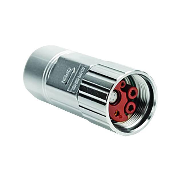

    AMPHENOL(安费诺)
    5(1 + 2 电源 + 1 Quadrax + PE) 针位圆形连接器 插头外壳 自由悬挂 底壳,联接螺母
MB3XSN8HS1 数据手册
REVISIONS REV ECO DESCRIPTION DATE BY A1 - RELEASE NUMBER 20JUN14 ORION A2 - ADDED PIN NUMBERS 08DEC15 MRF APPR 69.0 REF TITLE: 1. MATERIAL: INSULATION INSERT: THERMOPLASTIC SEAL: VITON, EPDM HOUSING BODY: ZINC DIE CAST, NICKEL PLATED COUPLING NUT: COPPER ALLOY, NICKEL PLATED 2 1 4 MB3XSN8HSx 24.0 10.0 DWG NO: 2. SPECIFICATIONS: 2.1 CURRENT RATING: 2.0MM: 18 AMPS; 1.0MM: 1 AMPS; QUAD ELEMENT: 0.5 AMPS. 2.2 VOLTAGE RATING: 2.0MM/1.0MM: 850V AC/DC; QUAD ELEMENT: 30V AC/DC. 2.3 OPERATING TEMPERATURE: -20°C TO +130°C 2.4 DIELECTRIC WITHSTANDING VOLTAGE: LESS THAN 2 MILLIAMPS CURRENT LEAKAGE @ 2.0MM: 6000V; 1.0MM: 1500V; QUAD ELEMENT: 500V. 2.5 DEGREE OF PROTECTION: IP67 ( MATED CONDITION ) 2.6 DEGREE OF POLLUTION: 3 PER UL840 2.7 OVERVOLTAGE CATEGORY: III PER UL840 2.8 MATING CYCLE DURABILITY: >500 CYCLES 2.9 RoHS COMPLIANT REFER TO PART NUMBER CHART FOR CABLE RANGE 24.9 M23, PLUG, STRAIGHT, HYBRID, THREADED Ø27.5 NOTES: UNLESS OTHERWISE SPECIFIED 3 3. ALL DIMENSIONS ARE FOR REFERENCE USE ONLY. REV: A2 SH: 1 SEE PART NUMBER CHART DESCRIPTION PART NUMBER MATERIALS LIST UNLESS OTHERWISE SPECIFIED MB3XSN8HS1 7.5~11.0MM MB3XSN8HS2 11.0~14.0MM MB3XSN8HS3 14.5~17.0MM 1) 2) 1 2 3 All dimensions are in metric(mm). Tolerances are as follows: PL DEC ±0.30 Fractions ±1/64 PL DEC ±0.15 Angles ±1° PL DEC ±0.08 3) Note reference = X SIGNATURES DRAWN: ORION.LI ITEM Amphenol DATE 20JUN14 CHECKED: Sine Systems - www.amphenol-sine.com 44724 Morley Drive Clinton Township, MI 48036 ENGINEER: APPROVAL: MATERIAL SPECIFICATIONS: CUSTOMER: 3D VIEW PROCESS SPECIFICATIONS: M23, PLUG, STRAIGHT, HYBRID, THREADED THIS DRAWING IS SUPPLIED FOR INFORMATION ONLY. DESIGN FEATURES, SPECIFICATIONS AND PERFORMANCE DATA SIZE SHOWN HEREON ARE THE PROPERTY OF THE AMPHENOL CORPORATION. NO RIGHTS OF REPRODUCTION ARE IMPLIED. ALL DIMENSIONS ARE SUBJECT TO NORMAL SCALE: MANUFACTURING VARIATIONS. TYPE B C- NEXT ASS'Y: NONE DWG NO: REVISION MB3XSN8HSx SHEET A2 1 OF 1 1 QUANTITY PART NUMBER CABLE RANGE OF: PART NUMBER CHART
