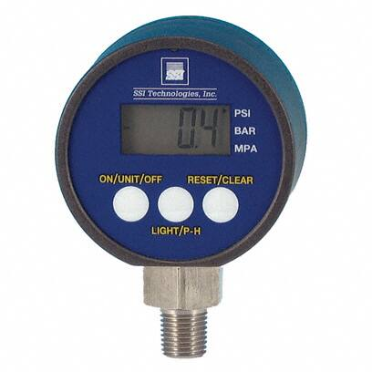

SSI Technologies – Application Note PS-AN6 MediaGauge™ (Model MG1-9V) Digital Pressure Gauge Product Overview Product Description The MediaGauge™ Model MG1-9V is a NEMA 4X rated stand alone 9V battery operated multi-functional digital pressure gauge with a standard input pressure port made of 316L stainless steel which has better pitting corrosion resistance in some media, such as seawater. The MediaGauge™ MG1-9V is well suited for marine applications. The MediaGauge™ MG1-9V contains a media isolated piezoresistive pressure sensing element, signal conditioning circuitry for temperature and calibration compensation, a pressure port and a LCD back lit display. The MG1-9V has an accuracy of ± 1.0% full scale and is a lower cost alternative in the SSI MediaGauge™ family of digital pressure gauges. The MediaGauge™ MG1-9V comes standard with a variety of keypad operated functions – multiple pressure unit display reading (PSI, BAR or MPA); memory storage of maximum peak pressure reading; and zero adjustment. The MediaGauge™ MG1-9V is made of all laser-welded 316L stainless steel for optimal media isolation and usage in a wide MediaGauge™ Model MG1-9V variety of media and corrosion or oxidation resistant applications. These compact 2 ½ inch, robust gauges measure pressures from Product Features 5 PSI to 5000 PSI and are well suited for a variety of industrial and commercial applications such as marine, ▪ Accuracy: ± 1.0 % Full Scale refrigeration, compressors, pumps, hydraulics, pneumatics and waste water. ▪ Pressure Ranges: 5, 30, 100, 200, 500, 1000, 3000, 5000 PSI The MediaGauge™ MG1-9V digital pressure gauge has better accuracy, longer life and standard multiple functions which make it a better choice than mechanical pressure gauges. ▪ Keypad Operated Functions: Auto zero and peak hold ▪ Operating Temperature: -10°C to 60°C SSI TECHNOLOGIES, INC. Controls Division 3200 Palmer Drive Janesville, WI 53548-5011 Phone: (608)758-1500 Fax: (608)758-2491 Copyright April 17, 2018 SSI Technologies Inc. All Rights Reserved Revision 4 1 SSI Technologies – Application Note PS-AN6 MediaGauge™ (Model MG1-9V) Digital Pressure Gauge Product Overview ▪ ▪ Storage Temperature: -20°C to 85°C Typical Applications: General Purpose, Test, Process Measurement Technology Control, MRO, Water, Compressors, Refrigeration; Fuel In general, pressure measurement technology translates a Cells; Pumps; Hydraulics; Spraying Systems; force from an induced pressure into an electrical quantity. In digital pressure gauges, the electrical quantity is then translated into pressure units and digitally displayed. Pneumatics; Flow; Robotics; Agriculture; Hydrogen Storage ▪ NIST traceable certificates available The SSI’s MediaGauge™ MG1-9V digital pressure gauge ▪ NEMA 4X Rating includes an 316L stainless steel input pressure port, a piezoresistive pressure sensing element, signal conditioning circuitry for temperature and calibration compensation, and ▪ ▪ Chemical Compatibilities: Any gas or liquid compatible with 316L stainless steel. For example, Sea Water, Salt Water, Motor Oil, Diesel, Hydraulic fluid, Brake Fluid, Water, Waste Water, Hydrogen, Nitrogen, and Air. a LCD that displays the pressure measured in either PSI, BAR or MPA (kg/cm²) units. The piezoresistive sensing element consists of an oil filled micro-machined 316L stainless steel convoluted diaphragm with a silicon crystal sensor. The silicon crystal sensor is LCD Display Battery Saver Mode: MG1-9V automatically powers down after 3 minutes. ▪ Multiple Pressure Units: PSI, BAR, MPA (kg/cm²) ▪ Compact, Robust Package: 2 ½ inches with black ABS Thermoplastic case mounted on a 304L stainless steel housing and laser welded to the diaphragm. Optimal media isolation is achieved when the media’s pressure acts directly on the 316L stainless steel diaphragm and is then transferred through the oil to the silicon sensor. Strain gauges (resistive elements) in the silicon are used in a Wheatstone Bridge circuit. When pressure is applied, the resistivity of the strain gauges changes proportional to the pressure applied. One leg of the bridge measures the input pressures port. The other leg of the bridge is connected to the reference port (vacuum pressure 0 PSI) the input pressure port is compared to. SSI TECHNOLOGIES, INC. Controls Division 3200 Palmer Drive Janesville, WI 53548-5011 Phone: (608)758-1500 Fax: (608)758-2491 Copyright April 17, 2018 SSI Technologies Inc. All Rights Reserved Revision 4 2 SSI Technologies – Application Note PS-AN6 MediaGauge™ (Model MG1-9V) Digital Pressure Gauge Product Overview To display the pressure reading in a different pressure unit: Continue to depress the ON/UNIT/OFF button until the arrow in the LCD points to the pressure units desired. Since piezo resistive pressure sensors are sensitive to To manually power down the unit: Press the ON/UNIT/OFF changes in temperature, the MediaGauge™ MG1-9V uses signal conditioning to compensate for temperature and calibration. The output signal is then converted into one of 3 user selectable forms (select units with the ON/UNIT/OFF button): button and hold down for 3 seconds until OFF is displayed and then release the button. The LIGHT/P-H (Peak-Hold) button is used to turn the LCD backlight on/off and to display the maximum peak pressure the 1) PSI unit has measured. 2) BAR 3) MPA (kg/cm²) To turn the LCD backlight on: Press the LIGHT/P-H button once. To turn the LCD backlight off: Press the LIGHT/P-H button The MediaGauge™ MG1-9V will display the pressure again. reading after the ON/UNIT/OFF button is depressed. The pressure measurement reading is updated 3 times per second. To see the maximum peak pressure the unit has measured: Press and hold down the LIGHT/P-H button for 3 seconds. The maximum pressure reading will be blinking. If the maximum pressure read was over the unit’s maximum pressure range, o.L MediaGauge™ MG1-9V Panel will be blinking on the display. MediaGauge™ MG1-9V panel has a LCD display and three multi- To return to the current pressure reading: Press the LIGHT/P-H functional buttons – ON/UNIT/OFF; LIGHT/P-H (Peak-Held) and button and hold down for 3 seconds. RESET/CLEAR. The RESET/CLEAR button is used to reset the gauge to The ON/UNIT/OFF button is used to display the pressure whatever pressure is currently applied to the port and to clear the reading; switch between pressure units (PSI; BAR; and MPA) and stored to power down the unit. RESET/CLEAR button only functions when held down for 3 maximum peak pressure reading. Note: The seconds. To power on the unit: Press the ON/UNIT/OFF button. The To reference your MediaGauge™ digital pressure gauge to the input port: Press and hold the RESET/CLEAR button for 3 MediaGauge™ MG1-9V has a battery saver mode and will automatically shut off the display after 3 minutes. seconds. The MediaGauge™ MG1-9V will now be reference to your input port. For example, if you have 20 psi on the display and SSI TECHNOLOGIES, INC. Controls Division 3200 Palmer Drive Janesville, WI 53548-5011 Phone: (608)758-1500 Fax: (608)758-2491 Copyright April 17, 2018 SSI Technologies Inc. All Rights Reserved Revision 4 3 SSI Technologies – Application Note PS-AN6 MediaGauge™ (Model MG1-9V) Digital Pressure Gauge Product Overview then you press and hold the RESET/CLEAR button for 3 seconds LCD Resolution (100, 200,500PSI) 0.1 read as 10 psi on the display. LCD Resolution (1000,3000,5000 PSI) 1 To reset the MediaGauge™ digital pressure gauge: Make sure Proof Pressure 3 X Full Scale Burst Pressure 10 X Full Scale or 15,000 the display will show 0.0 psi. A measurement of 30 psi would then the input port is either disconnected or connected to a 0 psi input. Press and hold down the RESET/CLEAR button for 3 seconds. PSI whichever is less To clear the maximum peak pressure reading: Press and hold down the LIGHT/P-H button for 3 seconds until the maximum Operating Temperature Range -10° to 60°C (14° to 140°F) Storage Temperature Range -20° to 85°C (-4°to 185°F) pressure reading appears on the LCD (it will be blinking). Release the LIGHT/P-H button. Press and hold down RESET/CLEAR button for 3 seconds. Tested Conditions Installation/Mounting 1) 2) Humidity 250 Hours (40°C and 90% to 95% R.H. on a suitable (1/4” NPT) female fitting. Use Teflon tape Pressure/Temperature > 1.8 million Cycles (0 to FS @ 8Hz and or pipe dope to seal the threads. Cycles -20° to 85°C) Do no over tighten. Torque to 150 in lbs +/- 1 in lb Thermal Shock 250 Cycles (85 to -20°C. 0.5 hr soaks at Mount the MediaGauge™ MG1-9V digital pressure gauge Electrical Specifications temperature Vibration Supply Voltage 9V Battery Response Time < 1 ms Accuracy ± 1.0 FS LCD Resolution (5 PSI) 0.001 LCD Resolution (30 PSI) 0.01 144 Hours (100 to 2000 Hz, 20g sinusoidal in 3 axes) SSI TECHNOLOGIES, INC. Controls Division 3200 Palmer Drive Janesville, WI 53548-5011 Phone: (608)758-1500 Fax: (608)758-2491 Copyright April 17, 2018 SSI Technologies Inc. All Rights Reserved Revision 4 4 SSI Technologies – Application Note PS-AN6 MediaGauge™ (Model MG1-9V) Digital Pressure Gauge Product Overview 3 SSI TECHNOLOGIES, INC. Controls Division 3200 Palmer Drive Janesville, WI 53548-5011 Phone: (608)758-1500 Fax: (608)758-2491 Copyright April 17, 2018 SSI Technologies Inc. All Rights Reserved Revision 4 5 SSI Technologies – Application Note PS-AN6 MediaGauge™ (Model MG1-9V) Digital Pressure Gauge Product Overview Digital Pressure Gauge Ordering System The following explains SSI’s MediaGauge™ Digital Pressure Gauge order number sequence. Example Product Family • MG1 MG1 - Pressure Ranges • 5 • 30 • 100 • 200 • 500 • 1000 • 3000 • 5000 • 30/0 ("HG) 500 - A - 9V Port Configuration • Hex A 22mm Connector Port 1/4 - 18 NPT • 9V Battery, Operated Rubber Boot Options: Order P/N 24610.1 for Model MG1 3 SSI TECHNOLOGIES, INC. Controls Division 3200 Palmer Drive Janesville, WI 53548-5011 Phone: (608)758-1500 Fax: (608)758-2491 Copyright April 17, 2018 SSI Technologies Inc. All Rights Reserved Revision 4 6

物料型号:MG1-9V
器件简介:MediaGauge™ MG1-9V是一款符合NEMA 4X标准的独立式9V电池操作的多功能数字压力表,适用于海洋等环境。
引脚分配:文档中未提供详细的引脚分配信息。
参数特性: - 精度:±1.0% 全量程 - 压力范围:5, 30, 100, 200, 500, 1000, 3000, 5000 PSI - 工作温度:-10°C 至 60°C - 存储温度:-20°C 至 85°C
功能详解: - 按键操作功能:自动零点和峰值保持 - LCD背光显示,具备电池节能模式,3分钟后自动关闭 - 支持多种压力单位显示:PSI、BAR、MPA (kg/cm²) - 按键操作包括:开/关、单位切换、背光/峰值保持、复位/清除
应用信息:适用于多种工业和商业应用,如海洋、制冷、压缩机、泵、液压、气动和废水处理等。
封装信息:采用全激光焊接的316L不锈钢材质,具有良好的耐化学腐蚀性,尺寸紧凑,直径为2 ½英寸,带有黑色ABS热塑性外壳。
