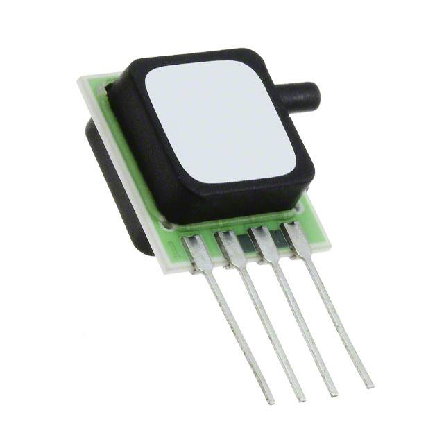

MLV Series Low Voltage Pressure Sensors Features • 1 to 30 inH2O & 5 to 150 PSI Pressure Ranges • 5V Operation • High Output • Low Power Consumption • Excellent Position Sensitivity • Low Warm-Up Shift • Enhanced Front to Back Linearity • Protective Parylene Coating Option These calibrated and compensated sensors give an acurate and stable output over a wide temperature range. This series is intended for use with non-corrosive, non-ionic working fluids such as air, dry gases and the like. A protective parylene coating is optionally available for moisture/harsh media protection. The output is also ratiometric to the supply voltage and designed to operate at 5.0 volts DC. Standard Pressure Ranges Operating Range Proof Pressure Burst Pressure Nominal Span MLV-L01D ±1 inH2O 100 inH2O 300 inH2O 7 mV MLV-L02D ±2 inH2O 100 inH2O 300 inH2O 10 mV MLV-L05D ±5 inH2O 200 inH2O 300 inH2O 15 mV MLV-L10D ±10 inH2O 200 inH2O 300 inH2O 20 mV MLV-L20D ±20 inH2O 200 inH2O 500 inH2O 20 mV MLV-L30D ±30 inH2O 200 inH2O 800 inH2O 20 mV MLV-005D ±5 PSI 10 PSI 30PSI 25 mV MLV-015D ±15 PSI 60 PSI 120 PSI 37.5 mV MLV-015A 0 - 15 PSIA 60 PSI 120 PSI 37.5 mV MLV-030D ±30 PSI 90 PSI 150 PSI 37.5 mV MLV-100D ±100 PSI 200 PSI 250 PSI 41.67 mV MLV-150D ±150 PSI 200 PSI 250 PSI 37.5 mV All Sensors DS-0274 Rev C p 408 225 4314 Device Equivalent Circuit +Vsupply -Vout e www.allsensors.com The MLV Series Compensated Sensor is based on All Sensors’ CoBeam2 TM Technology. The device provides a high output signal at a low operating voltage while maintaining comparable output levels to traditional equivalent compensated millivolt sensors operating at higher voltages. This lower supply voltage gives rise to improved warm-up shift while the CoBeam2 Technology itself reduces package stress susceptibility resulting in improved overall long term stability. The technology also vastly improves position sensitivity compared to conventional single die devices. +Vout -Vsupply a 16035 Vineyard Blvd. Morgan Hill, CA 95037 General Description f 408 225 2079 • Medical Breathing • Environmental Controls • HVAC • Industrial Controls • Portable/Hand-Held Equipment all sensors Applications Pressure Sensor Maximum Ratings Supply Voltage (Vs) Environmental Specifications 12 Vdc Common Mode Pressure InH2O Devices (L01, L02, L05, L10, L20, L30) 10 psig PSI Devices (005, 015, 030, 100, 150) 50 psig Lead Temperature (soldering 2-4 sec.) 270 °C Temperature Ranges Compensated Operating Storage 0°C to 50°C -25°C to 85 °C -40°C to 125 °C Humidity Limits 0 to 95% RH (non condensing) Performance Characteristics for MLV Series (InH2O) All parameters are measured at 5.0 volt excitation and room temperature unless otherwise specified. Pressure measurements are with positive pressure applied to PORT B (the only port for the single port configuration packages). Parameter Min Typ Max Units Notes Output Span L01D @ 1 inH2O L02D @ 2 inH2O L05D @ 5 inH2O L10D @ 10 inH2O L20D @ 20 inH2O L30D @ 30 inH2O 6.0 9.0 14.0 19.0 19.0 19.0 7.0 10.0 15.0 20.0 20.0 20.0 8.0 11.0 16.0 21.0 21.0 21.0 mV mV mV mV mV mV 4 4 4 4 4 4 Span Temperature Shift (0°C to 50°C) - - ±250 uV 1 Offset Voltage @ Zero Diff. Pressure - - ±500 uV - Offset Temperature Shift (0°C to 50°C) L01D, L02D, L05D - - ±250 uV 1 L10D, L20D, L30D - - ±200 uV 1 Offset Warm-up Shift - - ±50.0 uV 2 L01D - - ±20.0 uV 6 L02D - - ±15.0 uV 6 L05D, L10D, L20D, L30D - - ±10.0 uV 6 Offset Position Sensitivity (1g) Offset Long Term Drift (One Year) L01D, L02D, L05D - ±150 - uV - L10D, L20D, L30D - ±100 - uV - Linearity, Hysteresis Error - 0.10 0.30 %FSS 3 Response Time (10% to 90% Pressure Response) - 500 - us - Front to Back Linearity - 0.75 - %FSS 5 Input Resistance - 12.0 - k ohm - Output Resistance - 3.0 - k ohm - MLV Series Low Voltage Pressure Sensors Performance Characteristics for MLV Series (PSI) All parameters are measured at 5.0 volt excitation and room temperature unless otherwise specified. Pressure measurements are with positive pressure applied to PORT B (the only port for the single port configuration packages). Pressure is applied to Port A for absolute devices in A-Package. Parameter Min Typ Max Units Notes mV mV mV mV mV mV 4 4 4 4 4 4 - - ±1.0 %FSS 1 005D @ 5 PSI 015D @ 15 PSI - - - - 125 125 uV uV - 015A @ 15 PSIA 030D @ 30 PSI 100D @ 100 PSI 150D @ 150 PSI - - - - - - - - 208 125 125 125 uV uV uV uV - Span Temperature Shift (0°C to 50°C) Offset Voltage @ Zero Diff. Pressure Offset Warm-Up Shift - ±20 uV 2 Offset Long Term Drift (one year) - ±100 - uV - Linearity, Hysteresis Error - 0.20 0.50 %FSS 3 Response Time (10% to 90% Pressure Response) - 500 - us - Front to Back Linearity - 2.5 - %FSS 5 Input Resistance - 12.0 - k ohm - Output Resistance - 3.0 - k ohm - Specification Notes note 1: Shift is relative to 25°C. note 2: Shift is within the first hour of excitation applied to the device. note 3: Measured at one-half full scale rated pressure using best straight line curve fit. note 4: The span is the algebraic difference between full scale output voltage and the offset voltage.  Span Front  − 1 ⋅100%   Span Back  note 5: Front-Back Linerity computed as: Lin FB note 6: Parameter is characterized and not 100% tested. All Sensors DS-0274 Rev C e www.allsensors.com 25.25 37.88 37.88 37.88 42.08 37.92 f 408 225 2079 25.0 37.50 37.50 37.50 41.67 37.50 p 408 225 4314 24.75 37.13 37.13 37.13 41.25 37.08 a 16035 Vineyard Blvd. Morgan Hill, CA 95037 005D @ 5 PSI 015D @ 15 PSI 015A @ 15 PSIA 030D @ 30 PSI 100D @ 100 PSI 150D @ 150 PSI all sensors Output Span How To Order A Package Example: MLV-L02D-A6BBF-N MLV- Series Pressure Range -A6 Coating Op on L01D 1 i nH2O L02D 2 i nH2O Op on L05D 5 i nH2O A No Port Cut L10D 10 in H2O B Two Ports Cut 0.085" L20D 20 in H2O C Two Ports Cut 0.100" De sc rip on L30D 30 in H2O D Two Ports Cut 0.150" 005 D 5 PSI E One Port (A) Cut 0.080" 015 D 15 PSI F One Port (A) Cut 0.370" 015 A 15 PSIA 030 D 30 PSI 100 D 100 PSI 150 D 150 PSI No Coa ng P Paryle ne Coa ng (See NOTE 1 below) Port Fittings Op on De sc rip on N De sc rip on A No Fi ngs B Ba rb Fi ng Port A Only C Ba rb Fi ng Port B Only D Ba rb Fi ngs Ports A & B Op on F De sc rip on Fl at (Straig ht) Q Ri ght Angl e 0.075" R Rig ht Angle 0.100" J Jogge d Be nd E Package Example: MLV-L02D-E1ND-N MLV- -E - Series Pressure Range Coating Op on Port Orientation L01D 1 i nH2O Op on L02D 2 i nH2O 1 Du al Port Sam e Si de L05D 5 i nH2O Du al Port Oppo si te Sid e L10D 10 in H2O 2 20 in H2O G Si ngle Port (Gag e) L20D L30D 30 in H2O Lid Style 005 D 5 PSI Op on 015 D 15 PSI NN Non-Barbed on -Barbe d 015 A 15 PSIA BB Barbed arbe d 030 D 30 PSI De sc rip on De sc rip on N No Coa ng P Paryle ne Coa ng Lead Type Op on SS De sc rip on De sc rip on SIP IP DD DIP IP JJ J-Lead -Lea d SMT SMT LL Low Profile leDIP DIP ow Pro TABLE 1: Available E-Series Package Configurations Non-Barbed Lid Lead Style Port SIP DIP Barbed Lid Lead Style J Lead SMT Dual Port Same Side SIP DIP N/A E1NS E1ND E1NJ Dual Port Opposite Side E1BS E2ND E2NJ EGNS EGND EGNJ N/A N/A N/A N/A EGBJ EGBL E1BD N/A E2NS J Lead SMT E2BS E2BD EGBS EGBD Single Port (Gage) EGNL NOTE 1) Parylene Coating: Parylene coating provides a moisture barrier and protection from some harsh media. Consult factory for applicability of Parylene for the target application and sensor type. MLV Series Low Voltage Pressure Sensors Package Drawings A6 Package (Without Options) 21.59 0.850 20.32 0.800 Pinout (Gage) (Absolute) 1) N/C 2) Vs 3) +Out 4) Gnd 5) -Out 6) N/C 1) N/C 2) Vs 3) -Out 4) Gnd 5) +Out 6) N/C all sensors 5.33 0.210 3.56 0.140 Port A 0.51 0.020 3.81 0.150 1.27 0.050 e www.allsensors.com 8.74 0.344 2.54 0.100 NOTES 1) Dimensions are in inches [mm]. 2) For suggested pad layout, see drawing: PAD-09 Example: MLV-L10D-A6xAF-N A-Package: Port Cut Options A- No Port Cut Configuration E- Port A cut 0.080" Configuration 4.50 0.177 9.40 0.370 2.54 0.100 B- Two Ports Cut 0.085" Configuration 4.74 0.187 4.76 0.187 2.03 0.080 D- Two Ports Cut 0.150" Configuration 2.16 0.085 4.75 0.187 p 408 225 4314 4.69 0.185 3.81 0.150 Port Cut Options C- Two Ports Cut 0.100" Configuration All Sensors F- Port A Cut 0.370" Configuration DS-0274 Rev C f 408 225 2079 [6.35] 0.250 (min) 0.25 0.010 Pin 1 Identifier a 16035 Vineyard Blvd. Morgan Hill, CA 95037 10.67 0.420 Port B 10.67 0.420 27.43 1.080 4.81 0.189 2.40 0.094 4.42 0.174 13.97 0.550 3.18 0.125 12.19 0.480 Pinout Example: MLV-L10D-A6DxF-N A-Package: Port Fitting Options Port Fitting Options 1.13 0.045 4.75 0.187 A- No Fittings Configuration 2.37 0.093 1.20 0.047 NOTE: Port Cut Configuration "D" Shown As Reference. 2.06 0.081 C- Barb Fitting Port B Only Configuration B- Barb Fitting Port A Only Configuration 1.13 0.045 2.37 0.093 4.73 0.186 2.06 0.081 4.71 0.185 2.06 0.081 2.37 0.093 1.24 0.049 1.12 0.044 1.20 0.047 D- Barb Fitting Ports A and B Configuration Example: MLV-L10D-A6AAx-N A-Package: Lead Bend Options F- Flat (Straight) Configuration R- Right Angle 0.100" Configuration [2.60] 0.100 2.06 0.081 J- Jogged Bend Configuration 0.25 0.010 3.45 0.136 [5.72] 0.225 (min) [4.70] 0.185 Q- Right Angle 0.075" Configuration [3.81] 0.150 (min) 0.25 0.010 [4.45] 0.175 (min) [6.35] 0.250 (min) 3.45 0.136 3.45 0.136 0.25 0.010 Lead Bend Options 0.25 0.010 [1.88] 0.075 MLV Series Low Voltage Pressure Sensors E1NS Package Pinout 1) Gnd 2) +Out 3) Vs 4) -Out 7.17 0.282 12.70 0.500 4.88 0.192 0.64 0.025 10.79 0.425 2.10 0.082 E1BS Package Pinout 1) Gnd 2) +Out 3) Vs 4) -Out 1.68 0.066 10.80 0.425 Port B 0.25 0.010 Port A 2.73 0.107 [9.65] 0.380 (nom) 6.45 0.254 9.80 0.386 1.14 0.045 10.80 0.425 15.75 0.620 0.64 0.025 2.11 0.083 12.70 0.500 4.88 0.192 0.51 0.020 2.54 0.100 Pin 1 2 3 4 NOTES 1)Dimensions are in inches [mm] 2)For suggested pad layout, see drawing: PAD-01 All Sensors DS-0274 Rev C 2.24 0.088 9.15 0.360 e www.allsensors.com NOTES 1)Dimensions are in inches [mm] 2)For suggested pad layout, see drawing: PAD-01 f 408 225 2079 2.54 0.100 Pin 1 2 3 4 p 408 225 4314 0.51 0.020 a 16035 Vineyard Blvd. Morgan Hill, CA 95037 0.25 0.010 all sensors 2.04 0.080 10.79 0.425 Port A 2.73 0.107 [9.65] 0.380 (nom) 6.45 0.254 9.80 0.386 15.75 0.620 Port B E2NS Package Pinout 1) Gnd 2) +Out 3) Vs 4) -Out 7.17 0.282 0.64 0.025 2.12 0.084 12.70 0.500 10.79 0.425 Port A 2.10 0.082 2.04 0.080 10.79 0.425 2.73 0.107 [9.65] 0.380 (nom) 9.80 0.386 15.75 0.620 Port B 0.25 0.010 2.54 0.100 0.51 0.020 Pin 1 2 3 4 NOTES 1)Dimensions are in inches [mm] 2)For suggested pad layout, see drawing: PAD-01 E2BS Package Pinout 1) Gnd 2) +Out 3) Vs 4) -Out 2.12 0.084 Port B 2.73 0.107 1.68 0.066 10.80 0.425 15.75 0.620 [9.65] 0.380 (nom) 9.80 0.386 1.14 0.045 10.80 0.425 Port A 0.25 0.010 2.11 0.083 12.70 0.500 2.24 0.088 9.15 0.360 0.64 0.025 0.51 0.020 2.54 0.100 Pin 1 2 3 4 NOTES 1)Dimensions are in inches [mm] 2)For suggested pad layout, see drawing: PAD-01 MLV Series Low Voltage Pressure Sensors EGNS Package Pinout 1) Gnd 2) +Out 3) Vs 4) -Out 3.90 0.154 10.79 0.425 0.64 0.025 2.10 0.082 EGBS Package Pinout 1) Gnd 2) +Out 3) Vs 4) -Out Absolute devices are without port hole 2.11 0.083 12.70 0.500 0.64 0.025 1.14 0.045 10.80 0.425 Port B 0.25 0.010 10.80 0.425 2.73 0.107 0.51 0.020 1.68 0.066 15.75 0.620 [9.65] 0.380 (nom) 8.13 0.320 9.80 0.386 0.81 0.032 2.54 0.100 Pin 1 2 3 4 NOTES 1)Dimensions are in inches [mm] 2)For suggested pad layout, see drawing: PAD-01 All Sensors DS-0274 Rev C all sensors 2.24 0.088 4.41 0.174 f 408 225 2079 NOTES 1)Dimensions are in inches [mm] 2)For suggested pad layout, see drawing: PAD-01 p 408 225 4314 Pin 1 2 3 4 e www.allsensors.com 2.54 0.100 0.51 0.020 a 16035 Vineyard Blvd. Morgan Hill, CA 95037 0.25 0.010 2.04 0.080 10.79 0.425 Port B 2.73 0.107 8.13 0.320 9.80 0.386 0.81 0.032 12.70 0.500 15.75 0.620 Absolute devices are without port hole. 2.12 0.084 [9.65] 0.380 (nom) 4.41 0.174 E1ND Package Pinout 0.46 0.018 1) Gnd 2) +Out 3) Vs 4) -Out 5) Do Not Connect 6) Do Not Connect 7) Do Not Connect 8) Do Not Connect 5.72 0.225 Pin 8 7 6 5 7.17 0.282 0.64 0.025 12.70 0.500 4.88 0.192 10.79 0.425 2.10 0.082 NOTES 1) Dimensions are in inches [mm] 2) For suggested pad layout, see drawing: PAD-03 2.04 0.080 10.79 0.425 15.75 0.620 6.45 0.254 Port A 2.73 0.107 0.25 0.010 1.48 0.058 9.80 0.386 16 0.630 Port B 2.54 0.100 8.89 0.350 (min) Pin 1 2 3 4 E1BD Package Pinout 0.46 0.018 1) Gnd 2) +Out 3) Vs 4) -Out 5) Do Not Connect 6) Do Not Connect 7) Do Not Connect 8) Do Not Connect 5.72 0.225 Pin 8 7 6 5 9.15 0.360 0.64 0.025 12.70 0.500 4.88 0.192 2.11 0.083 1.14 0.045 10.80 0.425 NOTES 1) Dimensions are in inches [mm] 2) For suggested pad layout, see drawing: PAD-03 8.89 0.350 (min) 1.68 0.066 2.24 0.088 10.80 0.425 15.75 0.620 16 0.630 6.45 0.254 Port A 2.73 0.107 0.25 0.010 1.48 0.058 9.80 0.386 Port B 2.54 0.100 Pin 1 2 3 4 MLV Series Low Voltage Pressure Sensors E2ND Package Pinout 0.46 0.018 1) Gnd 2) +Out 3) Vs 4) -Out 5) Do Not Connect 6) Do Not Connect 7) Do Not Connect 8) Do Not Connect 5.72 0.225 7.17 0.282 Pin 8 7 6 5 0.64 0.025 12.70 0.500 2.10 0.082 2.04 0.080 10.79 0.425 Pin 1 2 3 4 E2BD Package Pinout 0.46 0.018 1) Gnd 2) +Out 3) Vs 4) -Out 5) Do Not Connect 6) Do Not Connect 7) Do Not Connect 8) Do Not Connect 5.72 0.225 Pin 8 7 6 5 9.15 0.360 12.70 0.500 0.64 0.025 NOTES 1) Dimensions are in inches [mm] 2) For suggested pad layout, see drawing: PAD-03 All Sensors DS-0274 Rev C 1.68 0.066 10.80 0.425 15.75 0.620 Port B 2.73 0.107 0.25 0.010 1.48 0.058 9.80 0.386 16 0.630 Port A 8.89 0.350 (min) 1.14 0.045 10.80 0.425 Pin 1 2 3 4 2.54 0.100 2.24 0.088 2.12 0.084 2.11 0.083 f 408 225 2079 NOTES 1) Dimensions are in inches [mm] 2) For suggested pad layout, see drawing: PAD-03 p 408 225 4314 2.54 0.100 e www.allsensors.com 2.73 0.107 8.89 0.350 (min) 1.48 0.058 15.75 0.620 0.25 0.010 9.80 0.386 16 0.630 Port B all sensors 10.79 0.425 Port A a 16035 Vineyard Blvd. Morgan Hill, CA 95037 2.12 0.084 EGND Package Pinout 0.46 0.018 5.72 0.225 1) Gnd 2) +Out 3) Vs 4) -Out 5) Do Not Connect 6) Do Not Connect 7) Do Not Connect 8) Do Not Connect Pin 8 7 6 5 3.90 0.154 2.12 0.084 4.41 0.174 Absolute devices are without port hole. 12.70 0.500 0.64 0.025 10.79 0.425 2.10 0.082 Port B 2.04 0.080 10.79 0.425 15.75 0.620 2.73 0.107 8.89 0.350 (min) 0.25 0.010 1.48 0.058 8.13 0.320 9.80 0.386 16 0.630 0.81 0.032 2.54 0.100 NOTES 1) Dimensions are in inches [mm] 2) For suggested pad layout, see drawing: PAD-03 Pin 1 2 3 4 EGBD Package Pinout 0.46 0.018 5.08 0.200 1) Gnd 2) +Out 3) Vs 4) -Out 5) Do Not Connect 6) Do Not Connect 7) Do Not Connect 8) Do Not Connect Pin 8 7 6 5 2.12 0.084 Absolute devices are without port hole. 12.70 0.500 0.64 0.025 2.11 0.083 10.80 0.425 Port B 1.68 0.066 10.80 0.425 15.75 0.620 16 0.630 9.80 0.386 8.13 0.320 0.81 0.032 2.24 0.088 4.41 0.174 4.28 0.169 NOTES 1) Dimensions are in inches [mm] 2) For suggested pad layout, see drawing: PAD-03 2.73 0.107 0.25 0.010 1.14 0.045 8.89 0.350 (min) 2.54 0.100 Pin 1 2 3 4 MLV Series Low Voltage Pressure Sensors E1NJ Package Pinout 1) Gnd 2) +Out 3) Vs 4) -Out 5) Do Not Connect 6) Do Not Connect 7) Do Not Connect 8) Do Not Connect Pin 8 7 6 5 7.17 0.282 2.10 0.082 1.27 0.050 e www.allsensors.com A 2.54 0.100 Pin 1 2 3 4 NOTES 1)Dimensions are in inches [mm] 2)For suggested pad layout, see drawing: PAD-10 E2NJ Package Pinout 1) Gnd 2) +Out 3) Vs 4) -Out 5) Do Not Connect 6) Do Not Connect 7) Do Not Connect 8) Do Not Connect 2.12 0.084 Pin 8 7 6 5 7.17 0.282 2.10 0.082 12.70 0.500 10.79 0.425 Port A 0.64 0.025 f 408 225 2079 15.75 0.620 2.04 0.080 Port A 2.73 0.107 DETAIL A SCALE 4 : 1 6.45 0.254 9.80 0.386 1.51 0.059 3.94 0.155 0.81 R0.032 10.79 0.425 Port B 0.25 0.010 all sensors 10.79 0.425 p 408 225 4314 0.64 0.025 12.70 0.500 4.88 0.192 1.27 0.050 2.54 0.100 Pin 1 2 3 4 NOTES 1)Dimensions are in inches [mm] 2)For suggested pad layout, see drawing: PAD-10 All Sensors DS-0274 Rev C a 16035 Vineyard Blvd. Morgan Hill, CA 95037 2.04 0.080 10.79 0.425 16 0.630 A 2.73 0.107 DETAIL A SCALE 4 : 1 9.80 0.386 1.51 0.059 3.94 0.155 0.81 R0.032 15.75 0.620 Port B 0.25 0.010 EGNJ Package Pinout 0.25 0.010 0.81 R0.032 1.51 0.059 3.94 0.155 DETAIL A SCALE 4 : 1 Pin 8 7 6 5 3.90 0.154 10.79 0.425 0.64 0.025 Absolute devices are without port hole. 2.10 0.082 12.70 0.500 2.12 0.084 4.41 0.174 1) Gnd 2) +Out 3) Vs 4) -Out 5) Do Not Connect 6) Do Not Connect 7) Do Not Connect 8) Do Not Connect Port B 2.04 0.080 2.73 0.107 A NOTES 1)Dimensions are in inches [mm] 2)For suggested pad layout, see drawing: PAD-10 10.79 0.425 16 0.630 9.80 0.386 8.13 0.320 15.75 0.620 0.81 0.032 1.27 0.050 2.54 0.100 Pin 1 2 3 4 EGBJ Package Pinout 0.25 0.010 0.81 R0.032 1.51 0.059 3.94 0.155 1) Gnd 2) +Out 3) Vs 4) -Out 5) Do Not Connect 6) Do Not Connect 7) Do Not Connect 8) Do Not Connect DETAIL A SCALE 4 : 1 4.28 0.169 12.70 0.500 0.64 0.025 Absolute devices are without port hole. 2.11 0.083 1.14 0.045 10.80 0.425 Port B NOTES 1)Dimensions are in inches [mm] 2)For suggested pad layout, see drawing: PAD-10 2.24 0.088 10.80 0.425 2.73 0.107 A 15.75 0.620 16 0.630 9.80 0.386 8.13 0.320 0.81 0.032 1.68 0.066 4.41 0.174 Pin 8 7 6 5 2.12 0.084 1.27 0.050 2.54 0.100 Pin 1 2 3 4 MLV Series Low Voltage Pressure Sensors EGNL Package Pinout 0.46 0.018 1) Gnd 2) +Out 3) Vs 4) -Out 5) Do Not Connect 6) Do Not Connect 7) Do Not Connect 8) Do Not Connect 2.67 0.105 Pin 8 7 6 5 3.90 0.154 12.70 0.500 10.79 0.425 2.10 0.082 Port B 2.04 0.080 10.79 0.425 2.54 0.100 Pin 1 2 3 4 NOTES 1) Dimensions are in inches [mm] 2) For suggested pad layout, see drawing: PAD-03 EGBL Package Pinout 0.46 0.018 1) Gnd 2) +Out 3) Vs 4) -Out 5) Do Not Connect 6) Do Not Connect 7) Do Not Connect 8) Do Not Connect 2.03 0.080 Pin 8 7 6 5 2.12 0.084 Absolute devices are without port hole. 12.70 0.500 0.64 0.025 2.11 0.083 10.80 0.425 Port B 1.68 0.066 10.80 0.425 15.75 0.620 16 0.630 9.80 0.386 8.13 0.320 0.81 0.032 2.24 0.088 4.41 0.174 4.28 0.169 NOTES 1) Dimensions are in inches [mm] 2) For suggested pad layout, see drawing: PAD-03 All Sensors 2.73 0.107 0.25 0.010 1.14 0.045 8.89 0.350 (min) Pin 1 2 3 4 DS-0274 Rev C 2.54 0.100 e www.allsensors.com 2.73 0.107 15.75 0.620 0.25 0.010 8.89 0.350 (min) 1.48 0.058 8.13 0.320 9.80 0.386 16 0.630 0.81 0.032 f 408 225 2079 Absolute devices are without port hole. all sensors 0.64 0.025 p 408 225 4314 4.41 0.174 a 16035 Vineyard Blvd. Morgan Hill, CA 95037 2.12 0.084 Suggested Pad Layout 2.54 0.100 (typ.) 1.27 0.050 2.54 0.100 (typ.) 2.29 0.090 2.54 0.100 (typ.) 0.035~0.039 inch (Finish Size) 0.035~0.039 inch (Finished Size) 14.99 0.590 16 0.630 PAD-10 PAD-03 PAD-01 Package Characteristics Package ID Approximate Port Volume Port A Port B Units Notes Weight Units Notes A6AAx 132 33.6 mm3 1 9.3 Grams 2 A6BAx 119 20.3 mm3 1 8.7 Grams 2 A6CAx 119 20.5 mm3 1 8.8 Grams 2 A6DAx 120 21.3 mm3 1 8.8 Grams 2 A6EAx 119 33.6 mm3 1 8.9 Grams 2 A6FAx 125 33.6 mm3 1 9.2 Grams 2 E1Nx 174 168 mm3 - 1.2 Grams - E2Nx 174 168 mm3 - 1.2 Grams - EGNx 1.4 168 mm3 - 0.9 Grams - Package Notes Note 1: Add 4.5 mm3 per port with barb fitting. Note 2: Add 0.15 gram per barb fitting. Product Labeling All Sensors MLV-L02D A6AAF-N R9J21-3 Company Part Number Lot Number Example Device Label * 5 PSI to 150 PSI devices may not be assembled with CoBeam2 TM Technology. All Sensors reserves the right to make changes to any products herein. All Sensors does not assume any liability arising out of the application or use of any product or circuit described herein, neither does it convey any license under its patent rights nor the rights of others. MLV Series Low Voltage Pressure Sensors
