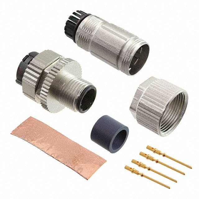

M12 D Code Crimp Assembly Instruction 5 Easy Steps Make Your Field Installation Secured And Reliable !!! 1 1 2 5 Prepare components 1 Connector、 2 Terminals、 3 Clamp Ring、 4 Seal、 5 Sealing Nut. 3 2 4 Assemble all components in the order( A  B  C  D ). Make sure 1 Connector & 2 Terminals、 4 Seal、 5 Sealing Nut been assembled properly (See figure A 、 C 、 D ). 1 3 4 5 2 5 Follow the order from 5 to 3 and put components through cable accordingly, no need to assemble here. A handling feedback while assembling, and pull cable to make sure. Installation Side 3 4 X C A Audio and 4 Seal D 4 X D Too Loose 5 V 3 C B V 4~6 kgf Seal 5 4 Follow suggested stripping length of outer jacket (L3) and insulation (L1). And fold the braid backward (L2). Dimension L1 4mm ± 1 L2 4mm ± 1 L3 19mm ± 1 Tips A 5 For Reworking, press the latches on the housing of 1 Connector (pointed by red arrows), and pull cable to disassemble (See figure A ). Disassemble 2 Terminals from the housing and put housing back into 1 Connector (See figure B ). B Use crimping tool to crimp all the 2 Terminals with wires. 2 Housing 2 Housing 1 1
