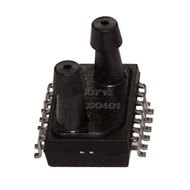

NPA Surface-Mount Pressure Sensor Series The NPA Series of Surface-Mount Pressure Sensors is provided in a miniature size as a cost effective solution for applications that require calibrated performance. Packaged in a SOIC14 pin surface mount, the NPA Series is available in gauge, absolute and differential pressure ranges with either mV, amplified analog or digital outputs. The sensor is intended for printed circuit board mounting and delivered in tape and reel form to simplify manufacturing handling. Features • Surface-mountable • Differential, gauge, absolute and low pressure • 10” H2O to 30 PSI full scale • Output Options: Amplified Analog, Digital Serial (14bit), Digital I2C, Uncalibrated mV • On chip temperature sensor in digital mode • Operating temperature range of -40°C to 125°C • Total Error Band < ±1.5% FSO • Up to 60 psi proof pressure Amphenol Advanced Sensors General NPA Specifications Parameter Value Units Notes Operating -40 to +125 °C -40 to +257°F Compensated 0 to 60 °C +32 to +157°F Storage -40 to +125 °C -40 to +257°F ~1 grams Environmental Temperature Range Mechanical Weight Media Compatibility Positive differential and gauge ports Compatible with exposed materials Negative differential ports Dry gases only 1 Notes: 1. Exposed materials are thermoset plastic, silicon, epoxy, RTV, pyrex and silicone Parameter Units Min Typ Accuracy (Total Error Band) %FSO -1.5 Proof Pressure (10”H2O to 1 psi) psi 5 Proof Pressure (5 psi to 30 psi) psi 60 Max Notes Common Parameters Maximum Package Pressure 60 Pressure Ranges Series 2 Excitation Voltage 1.5 10” H2O Min/Max 30 psi Notes NPA-100 1.5mA NPA Uncompensated, mV NPA-300 3.3V 3.135 V to 3.465 V NPA Compensated, low power amplified analog NPA-500 5.0V 4.75 V to 5.25 V NPA Compensated, amplified analog NPA-600 5.0V 4.75 V to 5.25 V NPA Compensated, digital serial NPA-700 5.0V 4.75 V to 5.25 V NPA Compensated, digital I2C NPA-730 3.3V 3.135 V to 3.465 V NPA Compensated, digital I2C Output Option: Amplified Analog Parameter Units Min Max Analog Performance Parameters 5 volt Excitation Offset Volts Span (Absolute/Gauge) Volts 0.44 0.56 4 Analog Performance Parameters 3.3 volt Excitation Offset Volts Span (Absolute/Gauge) Volts 0.46 0.54 2.5 Typical Analog Circuits Circuit layout same as “Ratiometric Voltage Output” V supply +2.7 to +5.5V V supply +5 to +5.5V J107 1 NP A 2 3 S ens or 14 1 13 2 12 3 4 11 5 V gate 10 6 VS S 7 V DD 9 S IG 8 0.1µF NP A 13 S ens or 12 4 11 5 V ga gate te 10 6 VS S V out 14 7 V DD 9 S IG 8 0.1µF V out G round Ratiometric Voltage Output - Standard NPA G round Ratiometric Voltage Output with Over-Voltage Protection - Request Required V supply +5.5 to +30V NPA Pinout MMBF 4392 1 3 14 NP A 2 13 S ens or 12 4 11 5 V gate 10 6 VS S 7 V DD 9 S IG 8 0.1µF V out G round Absolute Voltage Output - Request Required Pin # Amplified Analog Function Notes 1 -- 2 -- 3 NC Do Not Connect 4 NC Do Not Connect 5 -- 6 VSS 7 -- 8 SIG Analog Out, Calibration Interface 9 VDD Supply Voltage 10 -- 11 NC Do Not Connect 12 NC Do Not Connect 13 -- 14 -- Ground Supply 3 Output Option: Digital Serial (14 bit) Parameter Units Min Typ Max Notes Digital Performance Resolution ADC 14bit Sampling Rate kHz 1 16383 steps Digital Output Options Streaming serial output is a 14 bit number proportional to the full scale. Zacwire—Digital Output (NOM) Bridge Readings Zacwire—Digital Output (NOM) Bridge Readings with Temperature Option NPA Pinout 4 Pin # Amplified Digital Serial Function Notes 1 -- 2 -- 3 NC Do Not Connect 4 NC Do Not Connect 5 -- 6 VSS 7 -- 8 SIG Digital Out, Calibration Interface 9 VDD Supply Voltage 10 -- 11 NC Do Not Connect 12 NC Do Not Connect 13 -- 14 -- Ground Supply Output Option: Digital I2C Parameter Units Min Typ Max Notes Digital Performance Resolution (ADC) bit 14 I2C Slave Address 16383 steps 0x28 Sampling Rate kHz I2C Bit Rate kbits/s 2 100 I2C Mode 400 Update Digital I2C Update Mode Output Options I2C Circuit NPA Pinout Pin # Digital I2C 1 -- 2 -- 3 NC Do Not Connect 4 NC Do Not Connect 5 -- 6 VSS Ground Supply 7 VDD Supply Voltage 8 SDA Serial Data, Calibration Interface 9 SCL Serial Clock, Calibration Interface 10 -- 11 NC Do Not Connect 12 NC Do Not Connect 13 -- 14 -- Function Notes I2C Circuit NPA Pinout 5 Output Option: Uncalibrated mV NPA Uncalibrated Performance 10 “H20 to 1 psi Min Typ Max Notes Units Pressure Range psi 0.36 to 1 10”H2O = 2.5KPa 5 to 30 Excitation mA 1.5 10 VDC Maximum 1.0 Input Impedance Ω 5000±20% 5000 ±20% Output Impedance Ω 5000±20% 5000 ±20% Zero Offset mV ± 75 ±10 Full Scale Output mV 40 to 120 10°H20 75 to 135 1 psi Min Typ BFSL 100 to 166 Linearity %FSO ±0.25 Pressure Hysteresis %FSO ±0.20 ±0.15 Temperature Coefficient of Zero μV/ V / °C ±30 ±20 Temperature Coefficient of Resistance % /°C 0.29 0.38 Temperature Coefficient of Sensitivity %FSO/°C -0.2 -0.19 Thermal Hysteresis of Zero %FSO ±0.15 ±0.2 Position Sensitivity %FSO 0.2 N/A NPA Pinout Pin # 6 5 psi to 30 psi Parameter Uncalibrated mV Function Notes 1 -- 2 -- 3 VN Sensor Interface Negative Output 4 VSSP Sensor Interface Ground 5 -- 6 NC 7 -- 8 NC Do Not Connect 9 NC Do Not Connect 10 -- 11 VP Sensor Interface Positive Output 12 VDDP Sensor Interface Positive Excitation 13 -- 14 -- Do Not Connect ±0.25 Max Notes 10 VDC Maximum 5 psi to 30 psi Manifold Design (All measurements given in mm) No Port Design (All measurements given in mm) Barbed Design Recommended tubing size of 3/32” ID, 7/32” OD, 1/16” wall thickness (All measurements given in mm) 1 Barb Port — Request Required Suggested PCB Land Pattern Package Leadframe Material: Alloy 194, NiPdAu Plated 7 Ordering Information Model NPA Code Description 100 mV Output, Ratiometric Uncalibrated Sensor*** 300 Analog Amplified Output, 3.3Vdc Excitation, Calibrated Sensor 500 Analog Amplified Output, 5Vdc Excitation, Calibrated Sensor 600 Zacwire —Digital Serial Output, Calibrated Sensor, 2 byte 601 Zacwire —Digital Serial Output, Calibrated Sensor, 3 byte 700 I2C - Digital Output, 5Vdc Excitation, Calibrated Sensor, 2 byte 730 I2C - Digital Output, 3.3Vdc Excitation, Calibrated Sensor, 2 byte Code Port Type M 1 manifold port for Gauge and Absolute pressure types B 2 barbed ports for Gauge, Absolute and Differential pressure types** N Non ported *** Code Pressure Range 10W 10”H2O (2.5 KPa) 001 1 PSI (7 KPa) 005 5 PSI (35 KPa) 015 15 PSI (100 KPa) 030 30 PSI (200 KPa) Code Pressure Type G Gauge D Differential A * Absolute NPA - - Note: * Absolute pressure ranges are available in 15 PSIA and 30 PSIA only. ** 1 barbed port available upon request. *** Order NPA-100N-XXXG in place of NPA-100N-XXXD. • • • • Contact NovaSensor for custom pressure ranges. Refer to application guide 910-289 for more information. Product is RoHS:2010 compliant. For low pressure version, see datasheet AAS-920-644E. NPA Product Dual/Single Barb Manifold No Port Qty/Tube 42 Units 42 Units 42 Units Qty/Reel 300 Units 448 Units 896 Units Qty/Reel/Carton 6 Reels 6 Reels 6 Reels Qty/Carton 1800 Units 2688 Units 5376 Units Warranty NovaSensor warrants its products against defects in material and workmanship for 12 months from the date of shipment. Products not subjected to misuse will be repaired or replaced. NovaSensor reserves the right to make changes without further notice to any products herein. NovaSensor makes no warranty, representation or guarantee regarding the suitability of its products for any particular application. NovaSensor does not assume any liability arising out of the application or use of any product or circuit and specifically disclaims, and all liability, without limitation consequential or incidental damages. The foregoing warranties are exclusive and in lieu of all other warranties, whether written, oral, implied or statutory. No implied statutory warranty or merchantability or fitness for particular purpose shall apply. Amphenol Advanced Sensors www.amphenol-sensors.com © 2019 Amphenol Corporation. All Rights Reserved. Specifications are subject to change without notice. Other company names and product names used in this document are the registered trademarks or trademarks of their respective owners. AAS-920-477H - 02/2019

物料型号:NPA系列
器件简介:NPA系列表面贴装压力传感器提供微型尺寸,是一种成本效益高的解决方案,适用于需要校准性能的应用。该传感器采用SOIC14引脚表面贴装封装,提供表压、绝对压力和差压范围,并提供mV、放大模拟或数字输出选项。传感器适用于印刷电路板安装,并以胶带和卷轴形式交付,以简化制造处理。
引脚分配:NPA系列有14个引脚,其中一些引脚被标记为NC(请勿连接),具体的引脚功能包括模拟输出、数字输出、地线、供电电压等。
参数特性:包括工作温度范围-40°C至125°C,存储温度范围-40°C至125°C,重量,媒体兼容性等。精度(总误差带)为±1.5% FSO,校验压力从5psi至60psi不等,最大封装压力为60psi。
功能详解:NPA系列提供多种输出选项,包括放大模拟输出、数字串行输出、I2C数字输出和未校准的mV输出。每种输出选项都有其特定的参数和性能指标。
应用信息:适用于印刷电路板安装,简化制造处理,适用于多种压力测量应用。
封装信息:采用SOIC14宽体封装,引脚框架材料为Alloy 194,表面镀NiPdAu。
订购信息:提供了不同输出选项和压力范围的型号代码,以及订购时的端口类型和压力类型代码。
