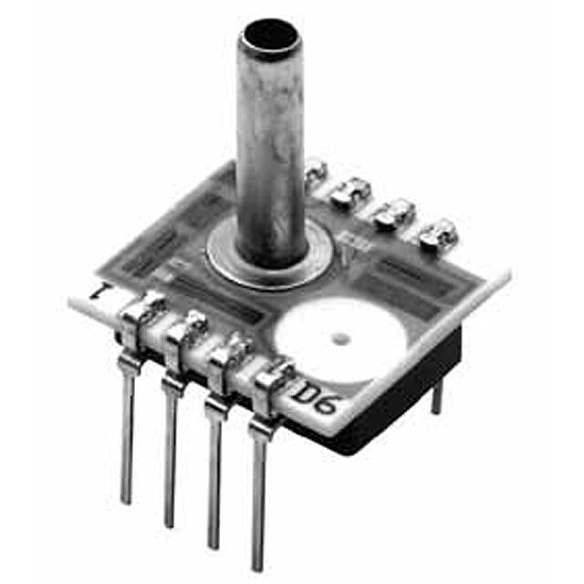

NPC-1210 Series NovaSensor Medium/Low Pressure Sensors Features • High sensitivity • High accuracy • Interchangeable • Temperature compensated 0°C to 60°C (32°F to 140°F) Applications • Industrial automation • Air flow monitors • Process control • Medical equipment • PCB mountable package • DIP package • Underground cable leak detection • Solid-state reliability • Ventilation • Individual device traceability • Respirator monitoring Amphenol Advanced Sensors NPC-1210 Series Specifications Description Pressure Sensor 1 -Out The NPC-1210 series of solid-state pressure sensors are designed to provide a cost effective solution for applications that require calibrated performance over a wide temperature range. Packaged in a dual-in-line configuration, the NPC-1210 Series is intended for printed circuit board mounting. Optional pressure port and lead configurations provide superior flexibility in low profile applications where pressure connection orientation is critical. + - A2 - R 1.5 mA +In 4 5 Gain Set 6 100 kW 3.012V Amplified FSO 100 kW R - +Out I 3 A3 + + -In The NPC-1210 series is based on NovaSensor’s advanced SenStable® piezoresistive sensing technology. Silicon micromachining techniques are used to ion implant piezoresistive strain gages into a Wheatstone bridge configuration. The NPC1210 Series offers the added advantage of superior temperature performance over the temperature compensated range of 0°C to 60°C (32°F to 140°F). A gain set resistor is included to normalize the FSO for field interchangeability. 7 8 2 NC NC Ground Lead Connection 1 -Out 2 -In 3 +Out 4 +In 5,6 Gain-Set Resistor 7,8 No Connection NPC-1210 Series Schematic Diagram 0.60 in (15.24 mm) 0.15 in (3.8 mm) 0.1 in (2.54 mm) 8 7 6 5 0.6 in (15.24 mm G6 1 2 3 0.2 in (5.1 mm) 0.32 in (8.1 mm) 4 0.12 in (3.05 mm) 0.37 in (9.4 mm) Used for positive differential (P2) L, S (See Notes) Not used for absolute 0.167 in (4.2mm) Diameter 0.127 in (3.23 mm), Two tubes Not used for gauge (P1) Ceramic substrate (1) 8X 0.07 in (1.78mm) 8X 0.34 in (8.6 mm) (3) 8X 0.02 in (0.51 mm) 1. All dimensions are for reference only. 2. Tube length: L = 0.49 in (12 mm), S = 0.33 in (8.3 mm), N = No tube 3. Lead pins can be either in the same or the opposite direction of the pressure tube. Option (1) has the leads in the "Up" position, the same direction as the tube. Option (3) has the leads in the "Down" position, the opposite direction from the tube. 4. Gauge and differential pressure devices are calibrated by applying pressure to the positive differential port (P2) and venting to atmosphere the reference port (P1). Absolute pressure devices use only P1 to apply vacuum or pressure. NPC-1210 Series Package Diagram NPC-1210 Series Specifications Medium Pressure Sensors Low Pressure Sensors Pressure Ranges Pressure Ranges • Gauge and differential: • 5 psi (34 kPa, 0.34 bar) • 15 psi (100 kPa, 1.0 bar) • 30 psi (210 kPa, 2.1 bar) • 50 psi (340 kPa, 3.4 bar) • 100 psi (690 kPa, 6.9 bar) • Absolute: • 15 psi (100 kPa, 1.0 bar) • 30 psi (210 kPa, 2.1 bar) • 50 psi (340 kPa, 3.4 bar) •100 psi (690 kPa, 6.9 bar) • For other pressure ranges, please contact NovaSensor. • Gauge and differential: • 10 in H20 (2.5 kPa, 0.025 bar) • 1 psi (6.9 kPa, 0.069 bar) Parameter Value Units Notes Environmental Temperature Range Operating –40 to 125 °C (-40° to 257°F) Compensated 0 to 60 °C (32°F to 140°F) Storage –55 to 150 °C (–67 to 302 °F) Weight 2.5 g (0.005 lb) Media Compatibility Compatible with exposed materials Positive differential and gauge ports Dry gases only Absolute. negative differential ports Dry gases only Parameter Units Mechanical Parameter Value Units Notes Environmental Temperature Range Operating –40 to 125 °C (-40° to 257°F) Compensated 0 to 60 °C (32°F to 140°F) Storage –55 to 150 °C (–67 to 302 °F) Mechanical Weight 2.5 g Media Compatibility Compatible with exposed materials Positive differential and gauge ports Dry gases only Absolute. negative differential ports Dry gases only Parameter Units Minimum (0.005 lb) 7 Typical 7 Minimum Typical Maximum Notes Performance Parameters * Maximum Notes Performance Parameters * FSO 10 inH2O mV 25 50 70 2, 3 FSO 1 psi mV 50 75 110 2, 3 Zero Pressure Output mV -2 — 2 3 Linearity %FSO -0.5 — 0.5 4 Pressure Hysteresis %FSO -0.1 — 0.1 Input Impedance W 2500 4000 6000 FS Output (FSO) mV 75 100 150 2, 3 Zero Pressure Output mV -2 — 2 3 Output Impedance W 4000 5000 6000 Linearity %FSO -0.1 — 0.1 4, 8 Thermal Accuracy–Span %FSO -1.0 — 1.0 3, 5 Pressure Hysteresis %FSO -0.1 — 0.1 Thermal Accuracy–Zero %FSO -1.25 — 1.25 3, 5 Input Impedance W 2500 4000 6000 %/°C — 0.22 — 5 Output Impedance W 4000 5000 6000 Temperature Coefficient– Resistance Thermal Accuracy–Span %FSO -0.5 — 0.5 3, 5, 8 Thermal Hysteresis–Zero %FSO — 0.1 — 5 Thermal Accuracy–Zero %FSO -0.5 — 0.5 3, 5, 8 Input Excitation mA — 1.5 2.0 psi (bar) 5 (0.34) — — Temperature Coefficient– Resistance %/°C — 0.2 — 5 Pressure Overload Thermal Hysteresis–Zero %FSO Input Excitation Pressure Overload — 0.1 — mA — 1.5 2.0 Rated — — 3X 5 6 6 * 1. Supply current = 1.5 mA and ambient temperature = 77°F (25°C), unless otherwise noted. Gauge and differential pressure devices are calibrated by applying pressure to the positive differential port (P2) and venting to atmosphere the reference port (P1). 2. Output span of unamplified sensor. 3. Compensation resistors are an integral part of the sensor package; no additional external resistors are required. Pins 7 and 8 must be kept open. The NPC-1210 is interchangeable only when used with the gain set resistor shown in the schematic diagram. Maximum gain-set resistor mismatch is 2%. 4. Best fit straight line. 5. Temperature range 32°F to 140°F (0°C to 60°C), reference to 77°F (25°C). 6. 3X or 200 psi (13.78 bar) maximum, whichever is less. 7. Exposed materials are pyrex, ceramic, silicon, epoxy, RTV, and stainless steel. 8. 5 psi (0.34 bar) spec.: Linearity: 0.25 ±%FSO, TC-span: 0.75 ±%FSO, TC-zero: 0.75 ±%FSO. otherwise noted. NPC-1210 Series Specifications Ordering Information The code number to be ordered may be specified as follows: NPC-1210 (Medium Pressure) Code Pressure Range 005 5 psi (0.3 bar) 015 15 psi (1 bar) 030 30 psi (2 bar) 050 50 psi (3.4 bar) 100 100 psi (7 bar) Code Type D Differential A Absolute G Gauge Code Lead Configurations 1 Up 3 Down Code Tube Options L Long S Short N None * NPC-1210 - ___ number ___ - ___ - ___ Typical model * Order NPC-1210-XXXG-XN in place of NPC-1210-XXXD-XN Warranty Amphenol Advanced Sensors warrants its products against defects in material and workmanship for 12 months from the date of shipment. Products not subjected to misuse will be repaired or replaced. Amphenol Advanced Sensors reserves the right to make changes without further notice to any products herein. NovaSensor makes no warranty, representation or guarantee regarding the suitability of its products for any particular application, nor does Amphenol Advanced Sensors assume any liability arising out of the application or use of any product or circuit and specifically disclaims and all liability without limitation consequential or incidental damages. The foregoing warranties are exclusive and in lieu of all other warranties, whether written, oral, implied or statutory. No implied statutory warranty of merchantability or fitness for particular purpose shall apply. The code number to be ordered may be specified as follows: NPC-1210 (Low Pressure) Code Pressure Range 10W 10 in H2O (25 mbar) 001 1 psi (69 mbar) Code Type D Differential G Gauge Code Lead Configurations 1 Up 3 Down Code Tube Options L Long S Short NPC-1210 - ___ number ___ - ___ - ___ Amphenol Advanced Sensors Typical model www.amphenol-sensors.com © 2017 Amphenol Corporation. All Rights Reserved. Specifications are subject to change without notice. Other company names and product names used in this document are the registered trademarks or trademarks of their respective owners. AAS-920-303D - 11/2017

物料型号:NPC-1210系列
器件简介:这是一系列固态压力传感器,旨在为需要在宽温度范围内校准性能的应用提供成本效益高的解决方案。这些传感器基于NovaSensor的SenStable®压阻式传感技术,采用硅微加工技术将压阻应变计植入惠斯通电桥配置中。
引脚分配:传感器采用双列直插式配置,具有8个引脚,其中2个用于正负压力输入,5和6引脚为增益设定电阻,7和8引脚无连接。
参数特性: - 工作温度范围:-40°C至125°C - 补偿温度范围:0°C至60°C - 存储温度范围:-55°C至150°C - 满量程输出(FSO):75至150mV - 零压力输出:-2至2mV - 线性度:±0.1%FSO至±0.5%FSO - 压力滞后:±0.1%FSO - 输入阻抗:2500至6000Ω - 输出阻抗:4000至6000Ω - 热零点温度系数:0.1至0.22%/°C - 输入激励电流:1.5至2.0mA - 压力过载:额定值的3倍
功能详解:NPC-1210系列传感器适用于工业自动化、气流监测、过程控制、医疗设备、地下电缆泄漏检测、通风和呼吸器监测等多种应用。
应用信息:传感器适用于多种应用,包括工业自动化、气流监测、过程控制、医疗设备等。
封装信息:传感器采用PCB安装封装和DIP封装,具有固态可靠性和单个设备可追溯性。
