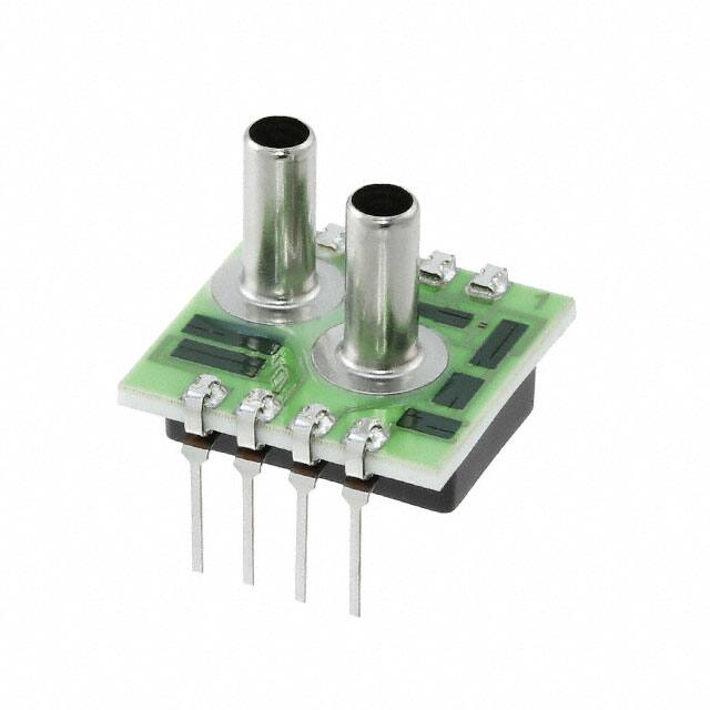

NPC-1220 Series Medium Pressure Sensors Applications Features • • • • • • • • • Industrial automation Air flow monitors Process control Medical equipment Underground cable leak detection • • • • Amphenol Advanced Sensors 50 mV full scale output (FSO) ±0.1% accuracy Interchangeable Temperature compensated 32°F to 140°F (0°C to 60°C) PCB mountable package DIP package Solid state reliability Individual device traceability NPC-1220 Specifications Description The NPC-1220 Series of solid state pressure sensors are designed to provide a cost effective solution for applications that require calibrated performance over a wide temperature range. Packaged in a dual-in-line configuration, the NPC-1220 Series is intended for printed circuit board mounting. Optional pressure port and lead configurations give superior flexibility in low profile applications where pressure connection orientation is critical. The NPC-1220 Series is based on NovaSensor’s advanced SenStable® piezoresistive sensing technology. Silicon micromachining techniques are used to ion implant piezoresistive strain gages into a Wheatstone bridge configuration. The NPC1220 Series offers the added advantage of superior temperature performance over the temperature compensated range of 32°F to 140°F (0°C to 60°C). A current set resistor is included to normalize the FSO for field interchangeability. Additionally, the NPC-1220 Series is available in pressure ranges from 0 psi to 5 psi (0 bar to 0.34 bar) through 0 psi to 100 psi (0 bar to 6.89 bar). Please contact NovaSensor or other pressure ranges. PRESSURE SENSOR 1 - OUT 1.235 V 0.60 in (15.24 mm) Vref 0.15 in (3.8 mm) 0.1 in (2.54 mm) 8 7 + A1 4 +IN -IN Vout (FSO = 50mV) 6 5 + OUT 0.6 in (15.24 mm 3 G6 1 2 3 0.2 in (5.1 mm) 7 N.C. 0.32 in (8.1 mm) 4 0.12 in (3.05 mm) 0.37 in (9.4 mm) Used for positive differential (P2) L, S (See Notes) Not used for absolute 0.167 in (4.2mm) Diameter 0.127 in (3.23 mm), Two tubes 8 N.C. 2 6 Lead Connection 1 2 3 4 5, 6 7, 8 – OUT – IN + OUT + IN Current Set Resistor No Connection 5 CURRENT SET RESISTOR NPC-1220 Series schematic diagram Not used for gauge (P1) Ceramic substrate (1) 8X 0.07 in (1.78mm) 8X 0.34 in (8.6 mm) (3) 8X 0.02 in (0.51 mm) NPC-1220 Series package diagram 1. Tube length; L = 0.490, S=0.325, N = No tube. 2. Lead pins can be in either the same or the opposite direction of the pressure tube. Option (1) has the leads in the “Up” position, the same direction as the tube. Option (3) has the leads in the “Down” position, the opposite direction of the tube. 3. Gauge and differential pressure devices are calibrated by applying pressure to the positive differential port (P2) and venting to atmosphere the reference port (P1). Absolute pressure devices use only P1 to apply vacuum or pressure. GND NPC-1220 Specifications Pressure Ranges Warranty • Gauge and differential: 5, 15, 30, 50 and 100 psi (0.34, 1.03, 2.06, 3.44 and 6.89 bar) • Absolute: 15, 30, 50 and 100 psi (1, 2, 3.4 and 7 bar); 5 psi (0.34 bar)—call NovaSensor NovaSensor warrants its products against defects in material and workmanship for 12 months from the date of shipment . Products not subjected to misuse will be repaired or replaced. NovaSensor reserves the right to make changes without further notice to any products herein. NovaSensor makes no warranty, representation or guarantee regarding the suitability of its products for any particular application. NovaSensor does not assume any liability arising out of the application or use of any product or circuit and specifically disclaims, and all liability without limitation, consequential or incidental damages. The foregoing warranties are exclusive and in lieu of all other warranties, whether written, oral, implied or statutory. No implied statutory warranty of merchantability or fitness for particular purpose shall apply. Parameter Value Units Notes –40° to 257° 32° to 140° –67°F to 302° °F °F °F (-40°C to 125°C) (0°C to 60°C) (–55°C to 150 °C) Weight 0.005 lb (2.5 g) Media Compatibility Compatible with exposed materials Environmental Temperature Range Operating Compensated Storage Mechanical Positive differential and gauge ports Absolute. Negative differential ports 7 Compatible with exposed materials Dry gases only Parameter Units Min. Typical Max. Notes Performance Parameters (1) FS Output (FSO) mV 49.5 50 50.5 2, 3 Zero Pressure Output mV -2 — 2 3 Linearity ±%FSO -0.1 — 0.1 4, 8 Pressure Hysteresis ±%FSO -0.1 — 0.1 Input Impedance Ω 2500 4000 6000 Output Impedance Ω 4000 5000 6000 Thermal Accuracy–Span %FSO -0.5 — 0.5 3, 5, 8 Thermal Accuracy–Zero %FSO -0.5 — 0.5 3, 5, 8 Temperature Coefficient–Resistance %/°C — 0.2 — 5 Thermal Hysteresis–Zero %FSO — 0.1 — 5 Maximum Pressure Rated — — 3X 6 1. Ambient temperature = 77°F (25°C), unless otherwise noted. Gauge and differential pressure devices are calibrated by applying pressure to the positive pressure port (P2) and venting to atmosphere the reference port (P1). 2. Output span of unamplified sensor using the current set resistor and the circuit shown in the schematic drawing. 3. Compensation resistors are an integral part of the sensor package; no additional external resistors are required. Pins 7 and 8 must be kept open. The NPC-1220 is interchangeable only when used with the current set resistor shown in the schematic diagram. 4. Best fit straight line. 5. Temperature range 32°F to 140°F (0°C to 60°C), reference to 77°F (25°C). 6. 3X or 200 psi (13.78 bar) maximum, whichever is less. 7. Exposed materials are pyrex, ceramic, silicon, epoxy, RTV, and stainless steel.. 8. 5 psi (0.34 bar) spec.: • Linearity: 0.25 ±%FSO • TC-span: 0.75 ±%FSO • TC-zero: 0.75 ±%FSO NPC-1220 Specifications Ordering Information The code number to be ordered may be specified as follows: NPC-1220 Code Pressure Range 005 005 psi (0.3 bar) 015 015 psi (1 bar) 030 030 psi (2 bar) 050 050 psi (3.4 bar) 100 100 psi (7 bar) Code Type D Differential A Absolute G Gauge Code Lead Configurations 1 Up 3 Down Code Tube Options L Long S Short N None * NPC -1220 - ____ - ____ - ____ - ____ Typical model number * Order NPC-1220-XXXG-XN in place of NPC-1220-XXXD-XN Amphenol Advanced Sensors www.amphenol-sensors.com © 2017 Amphenol Corporation. All Rights Reserved. Specifications are subject to change without notice. Other company names and product names used in this document are the registered trademarks or trademarks of their respective owners. AAS-920-276C-11/2017
